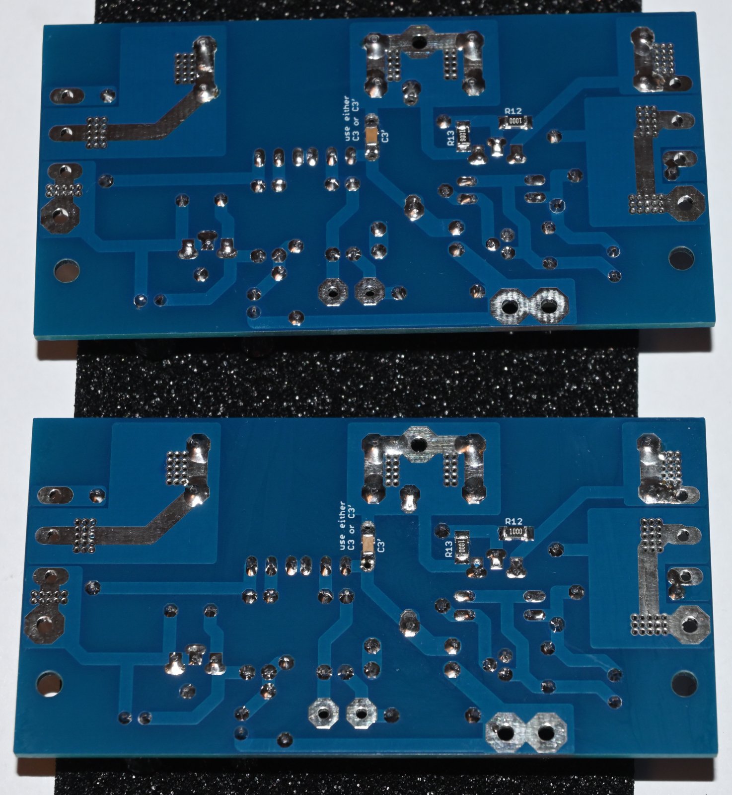

Now the project is ready for the next phase.
The F8 boards will go into my M2X mono blocks.
Then the M2X boards will be put at the shelf for a while.....
The project will be a bit faster (and cheaper) this way instead of building new PSUs from scratch.
It hurts a bit to pull out the M2X boards but I have no room for more large chassis.
M2X was (is) a nice amp. Here configured with Cedarburg.
Hope F8 likes its new "home".

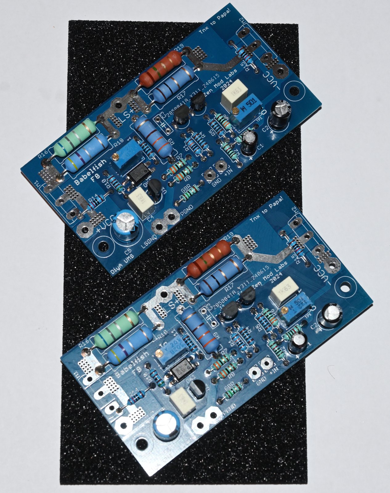

Had to come back, been listening to this amp for the last 3 days. Sounds absolutely incredible, there is something about the imaging of this amp. I was never a fan of my previous backup speakers(B&W 602) and I cant believe how incredible they sound with the miro ad1862 dac, iron pre and babelfish f8. I could honestly be happy(is that a thing for audiophiles) with this setup. Now I just have to rebuild my previous favorite XA252, I love this amp, but there is just something about it sending 40VDC to speakers that bothers me, LOL.
Thank you Zen Mod for making this version, been waiting for a F8 something for awhile.
A quick question for you ZM. What is the recommended pot settings for initial start up?
For the offset pot TP1 (500R for Semisouths), I assume mid position for the wiper would be a good starting point.
For the bias Iq pot TP2 (200R) - where should the wiper be for the initial start up?
Apologies if you have answered this, but I could not find details in the thread.
Have resistors loaded so far.
mid is OK for both trimpots

Thanks for the reply ZM, yep have 6 Fluke DMM's - so I can monitor everything. Close as possible to OVDC across the output and 1.8 Adc through R17//R19 (0R6 total) = 1.08VDC. Slowly adjust to let the channel warm up, then final adjustment after a good hour or so.
yeah, that in short, numbers checking
Iq is dead stable from start, DC Offset benign slide in temperature domain
