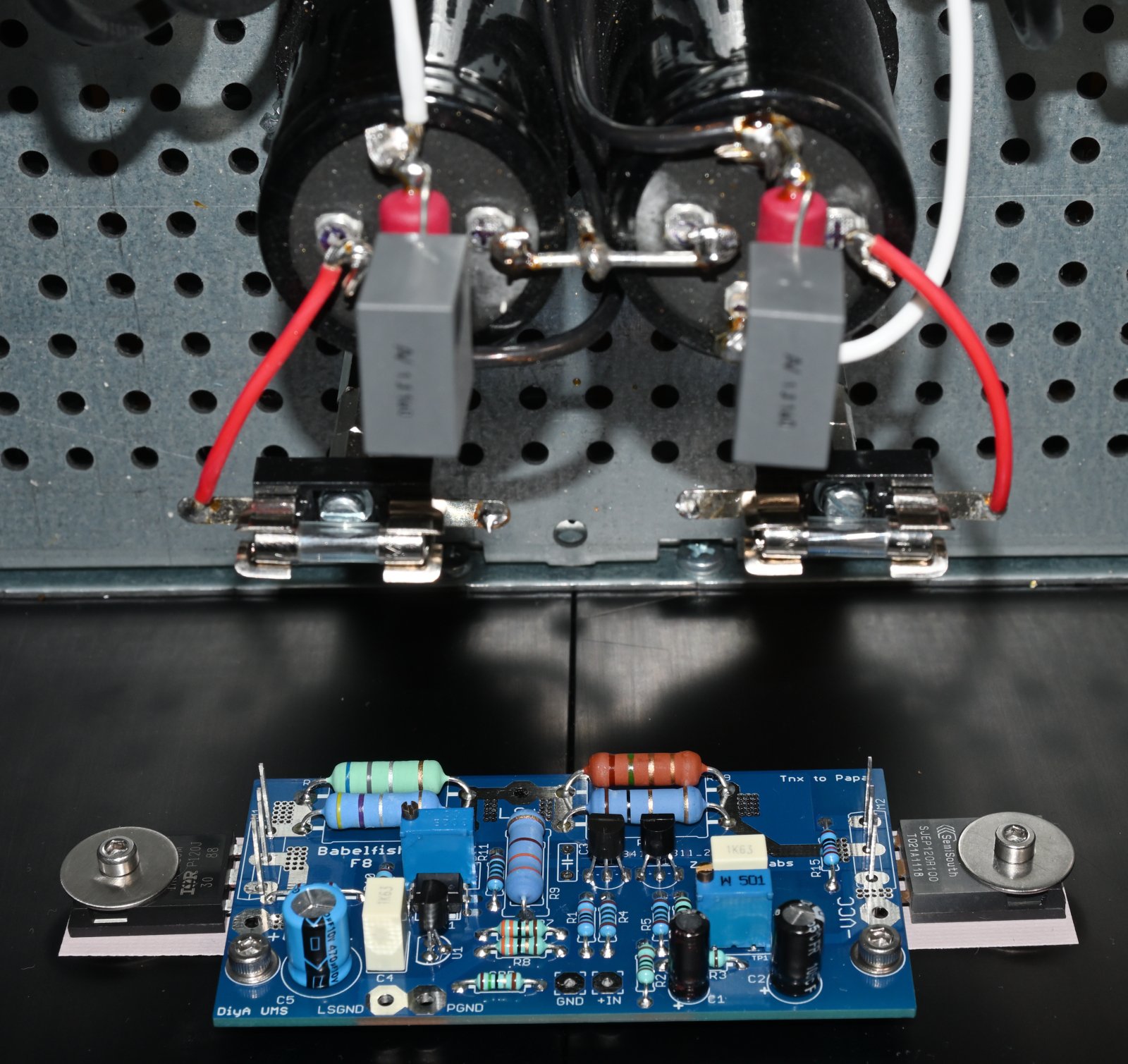

A little bit of progress. M1 and M2 not soldered yet.
For speaker return I will probably use the solder terminal at the board (instead of at caps). Will probably not make much of a difference. The distances are very shot. A short trimmer for the Bourns is necessary. Will se if I can find something non-conducting that can work. But we are not there yet.
I will not cut the M1/M2 legs short as usual but have something I can clamp a wire for a DMM.

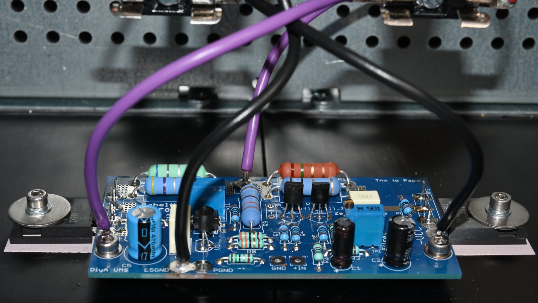

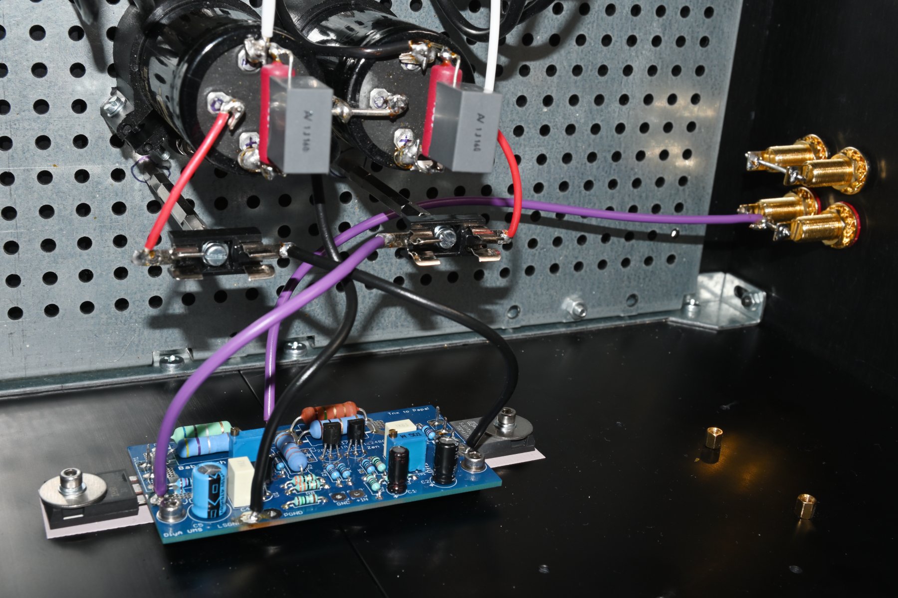

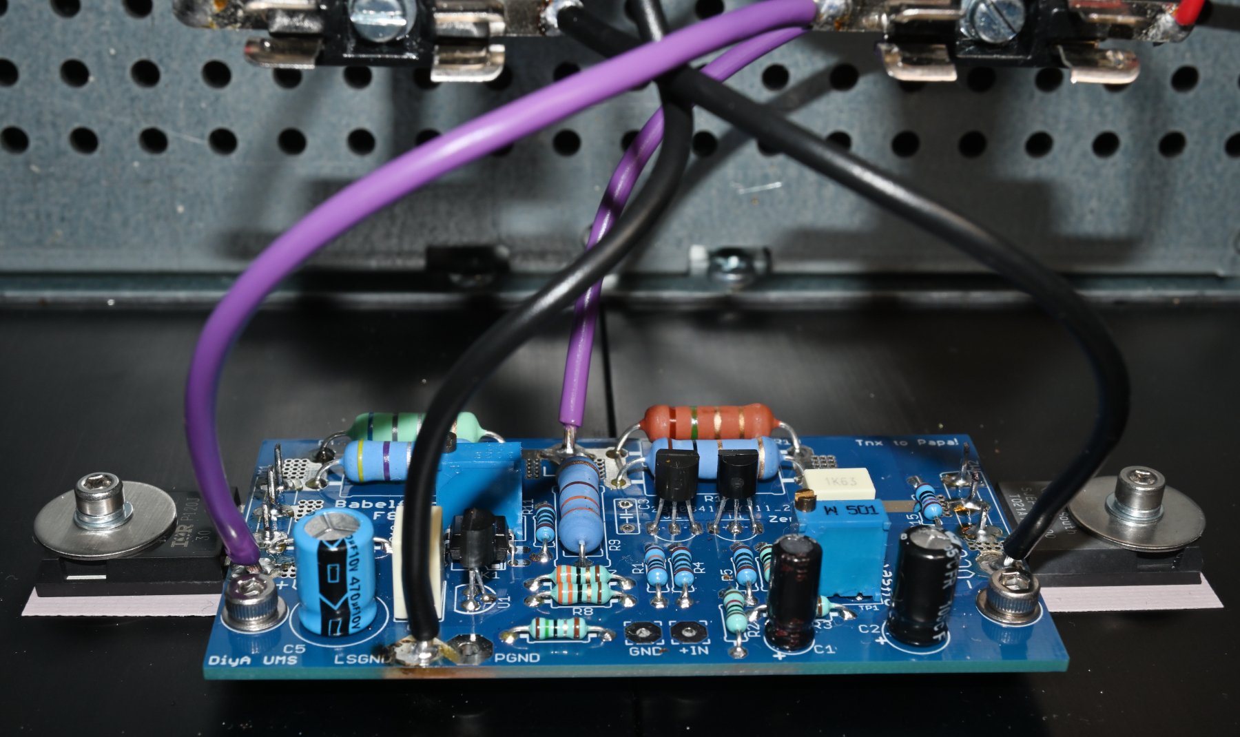

In principle one channel is now read for first initial test. Speaker return wire and input wires will be installed if initial test passes.
I will try to make a trimmer for the Bourns pots. It needs to be a small one. After that I plan to power it up slowly using my vario-trafo.
To secure the two power transistors I added extra small shims and split washers......just to have a little more confidence.
I also tested that isolation pads works. For that I always use DMM set to highest ohm setting (e.g. 20M) and not the "bip-setting".
At 20M setting the DMM is more sensitive and it should display "Infinity".

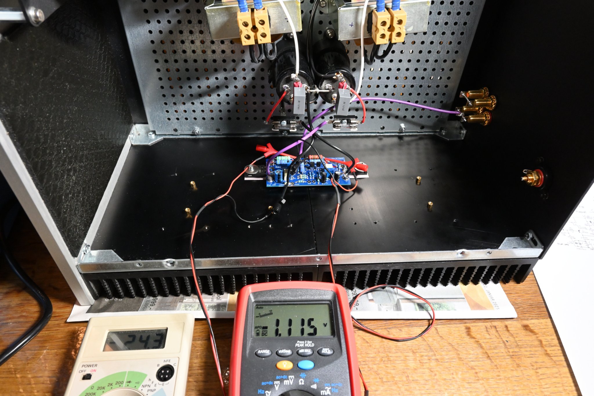

I powered up one channel and made a rough adjustment of offset and bias.
Left DMM is offset (24 mV) and the other is bias (voltage over 1R || 1R5 = 0R6). So 1.1V is a bit more than 1.8A.
Rails are approx. +-24 VDC. Should I settle for 1.1V or can I go for 1.2V if possible?
Next time I power up without vario-trafo as I did not see any smoke or bad smells of something getting very hot.
The goal for offset is just to be below 50 mV?
Probably less than 30 mV is possible. Maybe less than 10 mV.
1A8 is nice figure, do not insist on more, IRFP150 is a beast, but still caged in TO247, so think of dissipation; SSouth is in same case, but much sturdier, heat-wise
DC Offset - 50mV is same good as 30mV as 10mV; shoot that in temperature equilibrium
power them both (channels) and listen; and then cry, because you were Babelfish-F8-less for all these years
