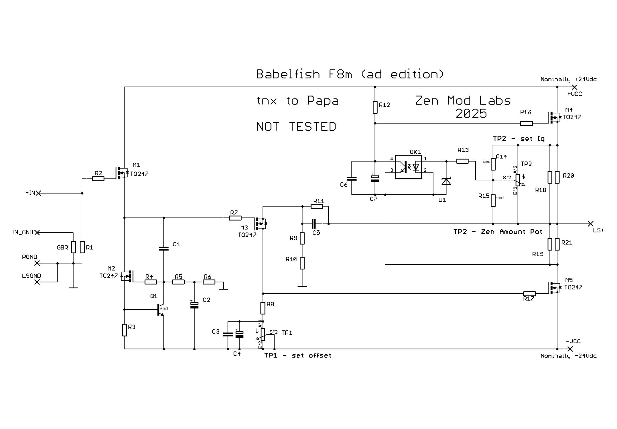

I'm going to make Babelfish F8m
all parts mosfets, all in TO247 case, well, except optocoupler
ZM asking Pa, is it allowed to make Babelfish F8m, with 5pcs of TO247 mosfets on board, one opto and one smd bjt
All I can imagine at the moment is ZM on a Guzzi wearing pink polka dotted spielhosen going door-to-door convincing people he's selling encyclopedias... when his real motive is to sneak in and install proper audio gear.
OK, as usual, ZM is cheating, big
There is Babelfish 8m edition, but one with TO247 I'm going to keep only for my self, as supperduperwakoo specimen
What is adequate for public is sane version , made with nice parts
