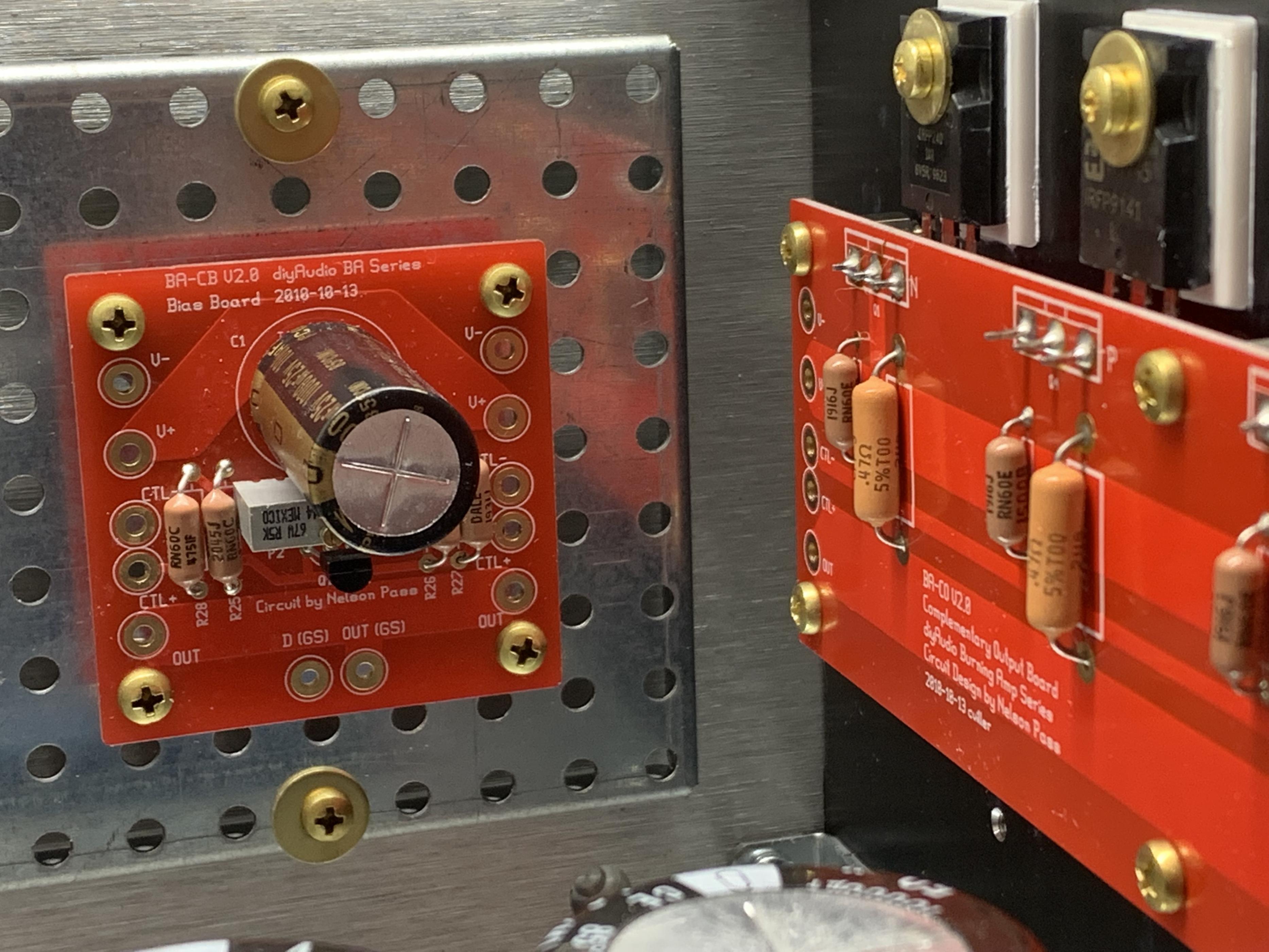

Mostly out of curiosity, what is the rational behind the labels “Ctl+/-“, “D”, and “(GS)” (as in “D (GS)” (or is that supposed to be a six?)

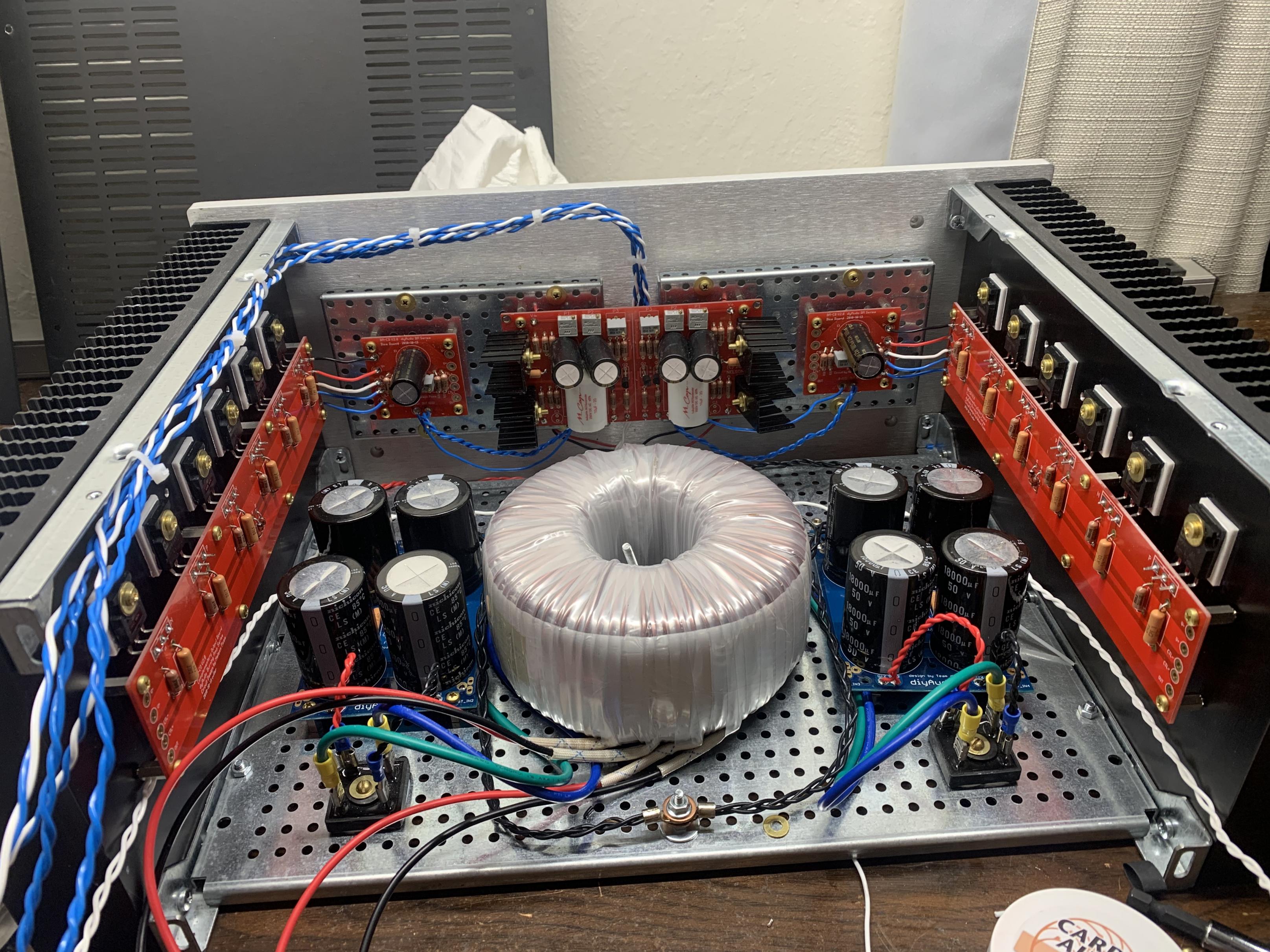

Ok, here's my build, I have yet to attach the back cover, but that's basically it. I'm happy to upload more pics if there are things you want to see.
All wires are 18awg solid core. Blue is signal, white is signal return, red is V+ and Black is V-/ground.
Input wires are twisted together and the pairs bundled and run on the left side to the input board. Speaker output are one pair each, twisted, bundled with the input wires. Transformer is AnTek 6224.

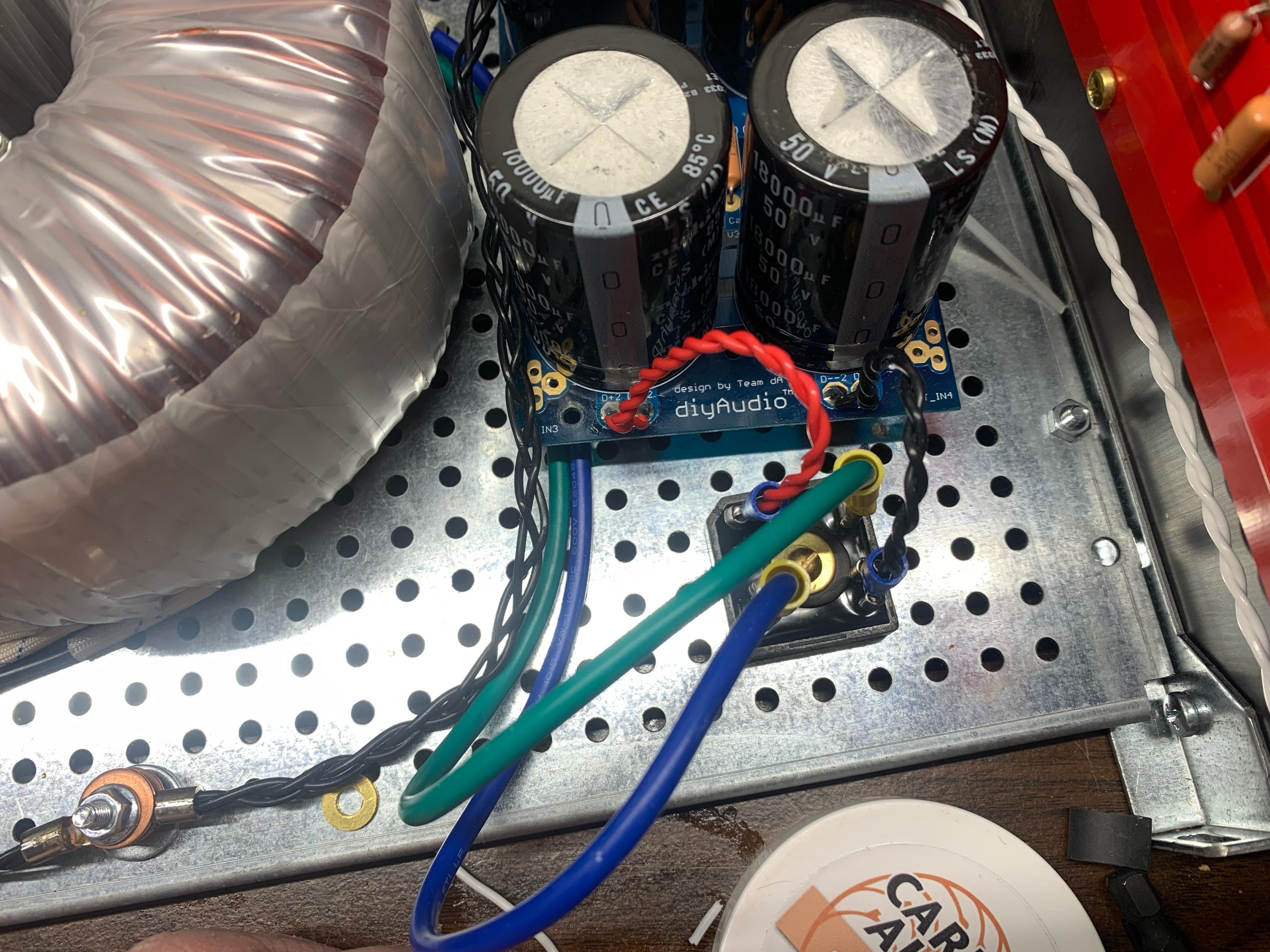

I split the power supplies for space/layout reasons. They are joined by three ground wires, braided, connected above the transformer. V+ comes off the left supply, V- comes off the right. Signal ground from the input board goes to the ground points on the rectifier boards (I split it because why not, symmetry). Speaker grounds come off the same rectifier ground points as a twisted pair each. Power grounds come off the inner ground pins and go to the star ground.
I wired the bridge rectifiers the same for each channel. I hope that's right, because the boards themselves are reversed (I should double check the schematic to confirm). On both boards, + goes to D++ and - goes to D--.
I need to add the thermistors, I forget them in my initial order.
Thoughts, comments, snide remarks, please! My motto is "I have no idea what I'm doing" 😀

There does not appear to be any screws/standoffs holding up the V- PSU board.
Also don't attach the PSU to the rest of the amp until it’s properly wired and tested.
Yes, I had that board unscrewed to do some soldering. I'll screw it back down before I fire it up.
Ok, I'll disconnect the V+/V- rails and test the PSU first. Good tip. Is it ok to leave the grounds wired up, or should it be "no contact"?
I see you have made two connections from PSU to safety earth/star gnd/chassis gnd. I would disconnect one of them, right away. I fear, either way, you might have some issues with your current gnd scheme wrt how quiet it will be/is. But you never know with grounding 🙂
