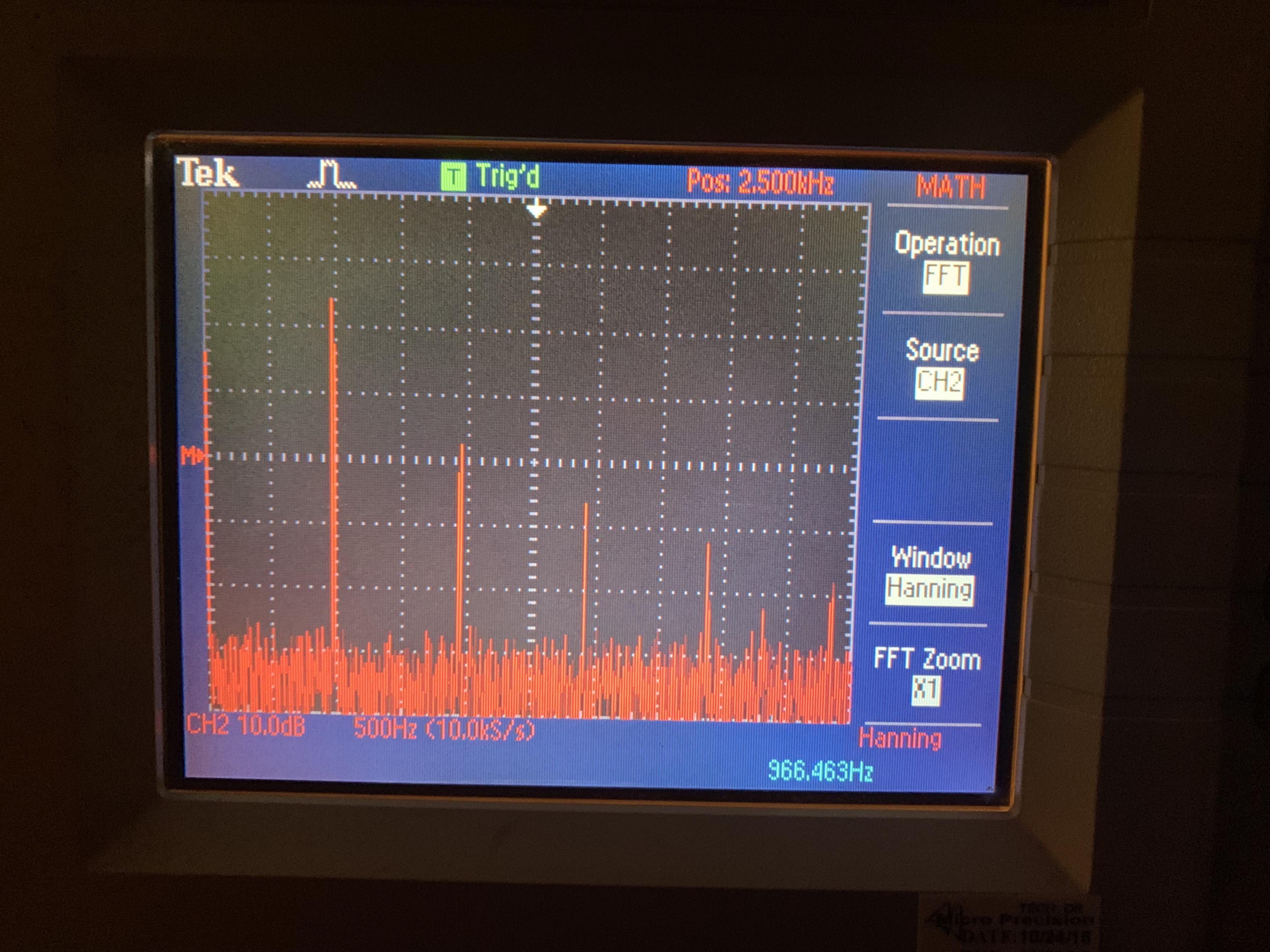

I'm having trouble measuring the adjustments I make to P3. I can absolutely hear differences as I blindly turn the pot while music is playing. But I'm having trouble quantifying those changes when examining the harmonic products.
Attached is what I see when I run 1w into a resistor (2.65v into 7ohms). My source signal is "1 KHz" (9.66 because I need to calibrate my generator). I observe harmonics at nicely decreasing magnitude at ~2 KHz, 3 KHz, 4 KHz, and 5 KHz.
When I adjust the P3 pot from minimum to maximum values, the magnitude of the 2nd and 3rd harmonic barely change. The 2nd is always ~7 dB higher than the 3rd. (and about 20 dB down from the primary signal) At most they might vary up and down by ~ 2dB together, and at most they might vary between each other by 1 dB.
I don't think it's a resolution issue, as each harmonic is clearly delineated above the noise floor. I'm doing this with one channel driven, but I didn't think that should make a difference.

You probably should be careful adjusting while playing. Adjusting P3, changes current through the JFETs, affecting the MOSFETs current in turn, measurable with one DMM at each of the 22R resistors. These changes can be significant. I would recommend you rebias/adjust offset after each P3 adjustment, and then take your measurements.
That said, I have never succeeded in adjusting P3 the pro way, as my old HP distortion analyzer turned out to need recap and a service. Needless to say, that is still pending.
Please wait for others to chime in, but as far as I am concerned, and referring to the manual by Papa: adjust P3, readjust P1 and P2, then you’ll know what you have.
Edit: due to C3, there is no danger to the OS, like on the F5T. Possible danger if one of your FE MOSFETs pop. But that pop will be smaller than one on the OS. Just saying.

Do you measure whole amps output or only the front end? Try measuring only the front end. The OS will overwhelm the FE.
Yes Offset+Bias change with each P3 turn.
At least my Oscilloscope (TEK TDS 724A) sucks at THD measurements being 8 bit and all. I much prefer soundcard with ARTA or my Keithley 2015 THD multimeter.

I'm getting clear harmonic frequencies at easily measurable levels. Is the low-resolution of my scope still causing an issue? I was expecting changes with regard to the levels of the 2nd and 3rd harmonic, and I would be able to tell easily which one was dominant at 1W output. Unless there's something I don't understand about FFT resolution?

Without a notch filter a 8 bit oscilloscope can meaure up to the 1/256 th part of maximum input. This translates to 0,39% distortion. Your BA-3 is better than that.
If you have a 16 bit scope or soundcard you can measure 0.0015% THD and so on. With a notch filter you can knock the fundamental down say a 1000 times or more and then your 8 bit oscilloscope measuring the much lower signal (knocked down fundamental + harmonics) can resolve properly. You then have to calculate how much the notch filter filtered the fundamental and most of the times also some of the harmonics.
So you can use a notch filter and adjust for minimum and give a damn about calculation. Or you can use a cheap soundcard without a notch filter or a proper function analyser with built in notch filter. With a low distortion source signal, I found the Keithley 2015 to be as precise as my soundcard - so thats what I use for convenience.
