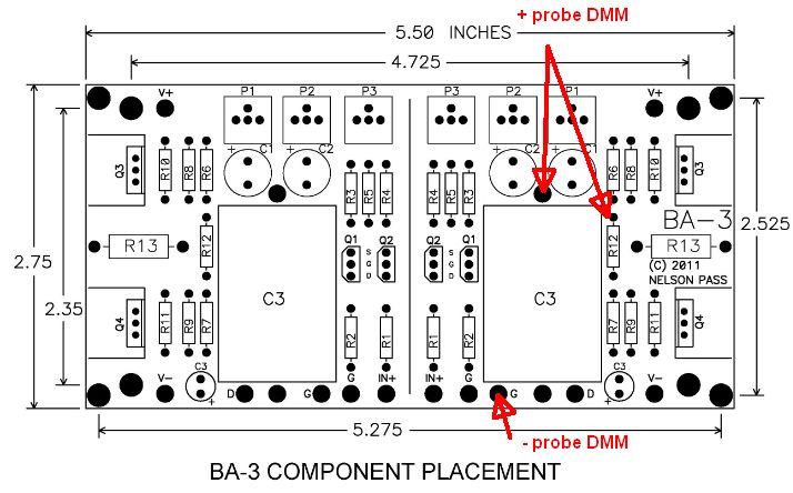

to SoaDMTGguy #976
Hello SoaDMTGguy,
do you want to measure the DC-offset of your BA-3 frontend -
this is measured in front of the outputcap (between R12 and C3) referenced to ground. Is adjusted with P1 and P2 on the frontendboard.
Or do you want to measure your DC-offset at speakeroutput?
P1 and P2 (Pot 101 and 102 in the schematic) on the bias-boards of the outputstage do this.
Cheers
Dirk

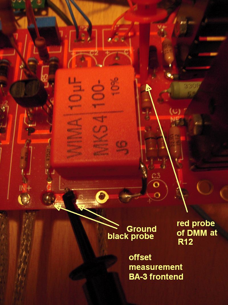

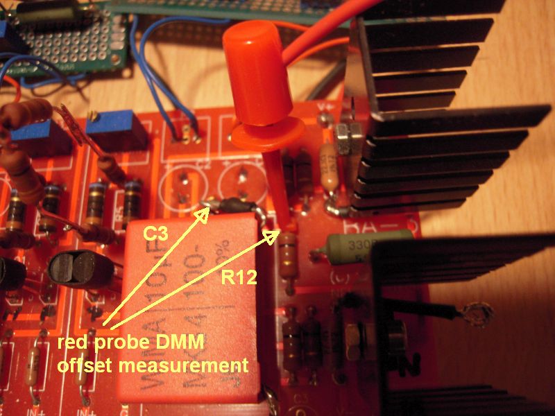

to SoaDMTGguy
This is where you measure the DC-offset of the BA-3 fronentboard.
Also keep an eye on your bias over R10 and R11. Shouldn:t be much higher than 1V. If you have enough heatsink perhaps higher.
Greets
Dirk
