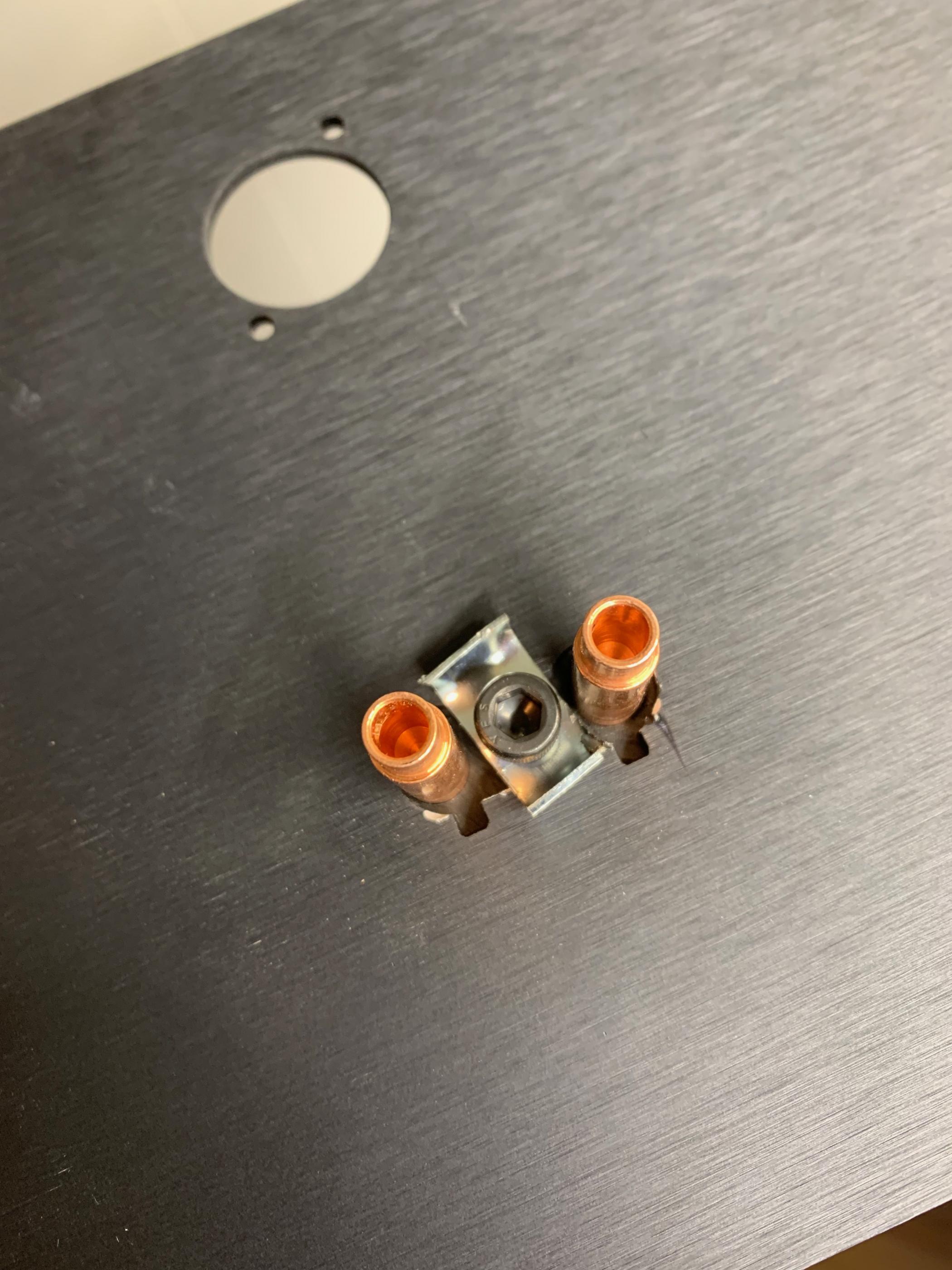

Oh, I'm not worried about that. This is how I attached my non-standard speaker binding posts (not seen is the janky Dremel cut between the two pre-drilled openings). That metal piece is part of the handle of a spring-clamp I cut off 🙄

Is it reasonable to rely on the anodized film on panels to insulate them from plugs/etc, or should I take special precautions do maintain isolation?
If I touch my multimeter leads to the black anodized surface of my back panel, I don't get continuity to other points on the panel. If I put an uninsulated plug through that panel, I do not get continuity between the plug and the panel (example: BA-3 Amplifier illustrated build guide) (Yes, I see the exposed spots from my shitty Dremel work, I'm going to cover those)
Should I add some sort of insulating ring between those copper posts and the black anodized surface of the panel? Even if the anodization is insulating now, could it get scratched off during normal use?
Thanks, will do. While we’re on the subject, are screw connections sufficient to ground panels to each other? IE, if panel A is screwed to bracket B which is screwed to panel C, and I have continuity from a screw in panel A to a screw in panel C, can I connect a screw in panel A to ground and consider all panels grounded, even if the panel face to pane face connection is not conductive?
(I assume the answer is yes)
It depends on the finish on your panels. If the panels are bare metal then there should be continuity.
If your panels are painted or anodized, then there may not be continuity. Although anodization should not be counted on for electrical isolation/insulation when it is required, it can prevent electrical conduction. So it is best to check for continuity between panels. When in doubt, sand the panels at one screw location minimum per joint to ensure continuity between panels.
