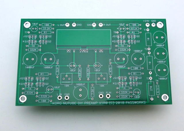

I recently completed the build and everything went well in the initial power up, balanced to recommended voltages then let it continue to warm up and rebalanced to the recommended 9.5v. However after about 20 minutes of operation one channel dropped significantly and the best t7 measurement is 4v even with the pot maxed out. Your expertise and insight is requested. Do I have a bad/faulty part? What other things can I do to troubleshoot?
The other channel remains stable at the set 9.5v
I didn't get any responses to my original post so thought I might try one more time. I have gone ahead and ordered another NuTube from the store - hopefully will be here tomorrow and I can swap the part out.
Does anybody have any other theories as to what I might check? All the other measurements from the FirstWatt article mentioned are within spec.
Also - what would be the best way to implement an LED to indicate power on/off?
voltages at H and B ?
Sorry for my ignorance, where do I measure H and B voltages at?
if you read article , you'll see them at schematic
or go back one page in this very thread , look at schmtc with voltages I posted

That would be page 180.
In case you have not seen the article.
http://www.firstwatt.com/pdf/art_diy_nutube_preamp.pdf

Thank you for pointing me in the correct direction, H and B voltages measure 8.99
