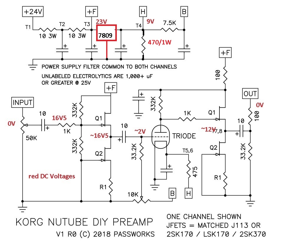

A quick question on the 475R resistor on the Christmas board that I have. Can I use a 470R 0.125W resistor instead of 475R? Does the difference of 5R makes an impact as 475R is not a regular resistor easily available locally and I had to order them either from RSDELIVERS or some other overseas site.
answer to manniraj #1788
Hello manniraj,
shouldn´t make a big difference. If you buy a 475 Ohm resistor with a tolerance
of 1% it will be anywhere inbetween 472 and 477 Ohm (approximately).
I think Nelson Pass mentioned that 0.6 W resistors should be used?
But perhaps our Professor Nelson can answer this? Or anybody of the experienced members here. 😕
Greets
Dirk
It looks like you need something with a higher wattage. Per Papa's document,
the 475 ohm resistor is across T4 and T5/T6. T4 should be at round 9.1V
and T5/T6 around 0.6V. The 8,5V drop works out to a bit over 0.15W.
So you'll definitely want something rated somewhat higher than that.

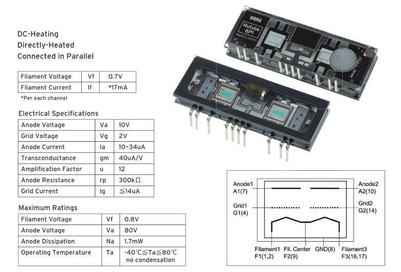

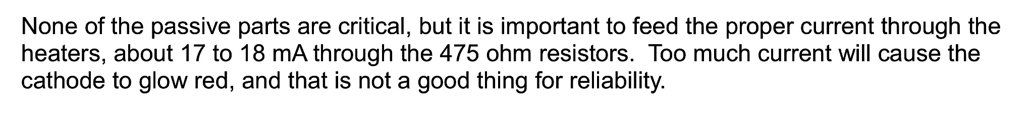

B1 Triode filaments heaters current need precise resistors 475R equivalent can be 470R+5R connected in series.
See extract about and why from FW article.
🙂 Best regards
Right! I would not worry much about the 475 Ohm resistor.
I had more problems with the 9.1V Zener. I bought 10 of them and they turned out to be between 9.41 and 9.7 V (checked with two DMM)
This is a bit much and the filament current is a over 18ma
Consequently it might be better to check the Zeners first and then choose the right value for the resistor...

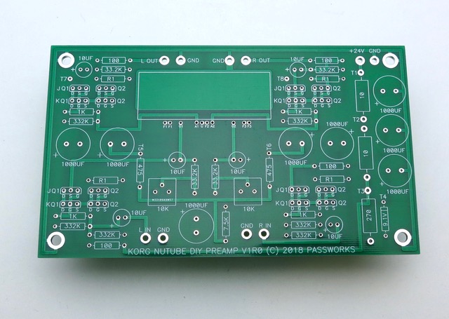

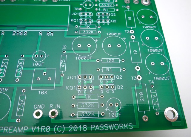

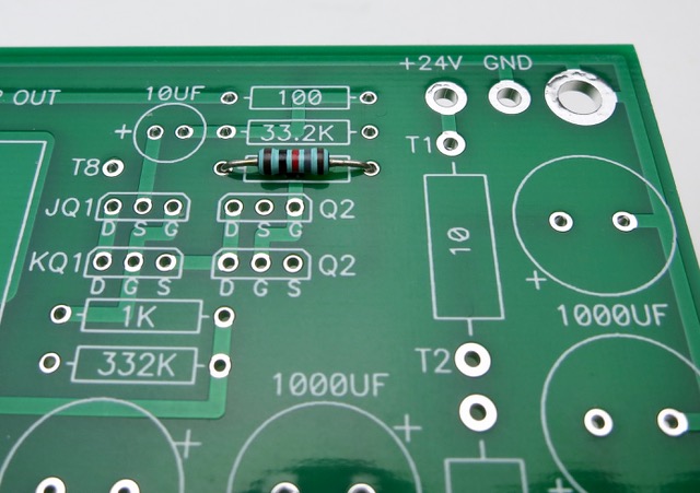

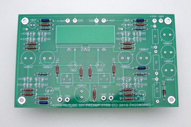

Stuffing a STORE style PCB
attachment.php

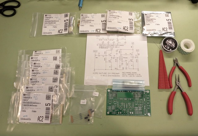

Gathering tools and components
attachment.php

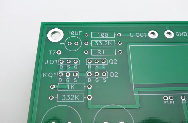

STORE board. (instead of XMAS board). This is the "R0" that has the need for the jumper on the back as shown in Nelson's guide. Later revisions will not need it.
attachment.php
STORE version has 2 sets of pads to accommodate Toshiba/Linear Systems Jfets, marked "KQ" and Farchild Jfets marked "JQ"
attachment.php
attachment.php

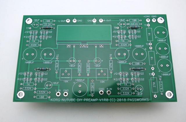

There are 4 locations for resistors all marked "R1", this is for the matched resistors that mate to the Q2's - these resistors are included with the kit. We will stuff them first
attachment.php
attachment.php

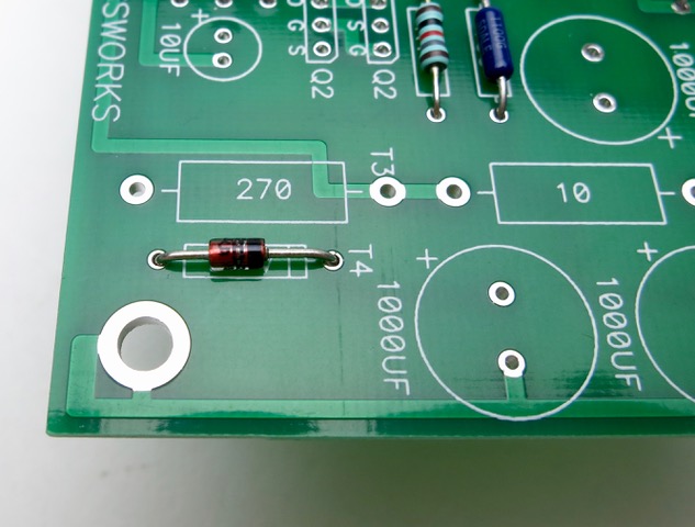

The rest of the small resistors and the Zener diode should be stuffed now.
attachment.php
Note that the zener diode has a black line that should be on the same side with the line on the silkscreen
