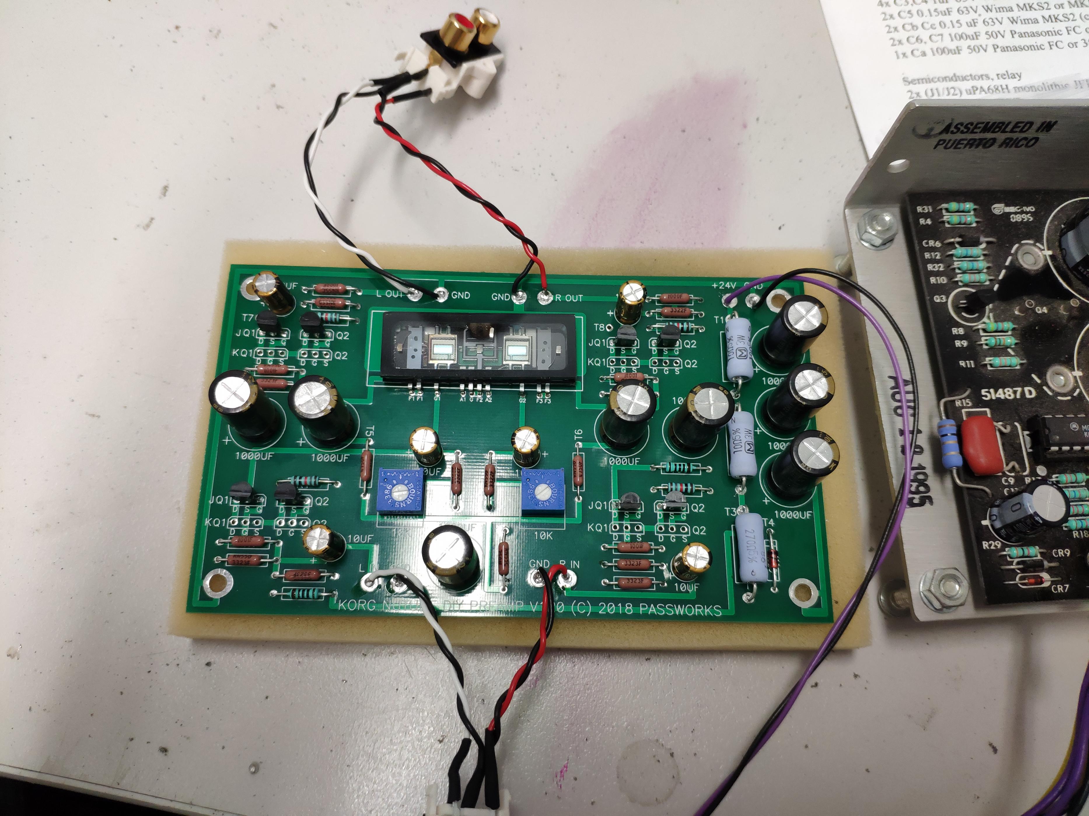

When you put the top on these Galaxy chassis......you don't find the applied screws a bit on the short side to be able to grab the nut every time?
I have sliced in a piece of cardboard to raise the nuts a bit......and this solved the issue.

I recently completed the build and everything went well in the initial power up, balanced to recommended voltages then let it continue to warm up and rebalanced to the recommended 9.5v. However after about 20 minutes of operation on channel dropped significantly and the best t7 measurement is 4v even with the pot maxed out. Your expertise and insight is requested. Do I have a bad/faulty part? What other things can I do to troubleshoot?
The other channel remains stable at the set 9.5v

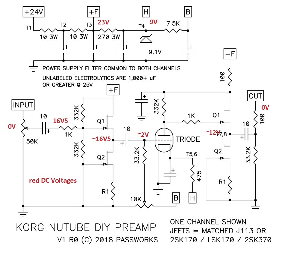

Would someone be kind enough to give me some clues regarding the few questions I have for this built ? I read Papa’s papers but sadly I have no experience with pres and Class A – but I do have with power amps and Class A/B, where caps decoupling and no caps in signal path are of interest IMHO.
CAPS IN SIGNAL PATH
There are 3 caps (10uF) in the signal path : At the entry, between 2 stages and at the output. I read one can play with values at least in the entry (trade off bandwith I guess), but I would like to understand what these caps are for and if they are really required in my very own case.
1. Entry cap, I guess this is only to protect from DC at the input, right? If my sources don’t have large DC, is it OK to leave it out… or am I missing something ? Further, if I leave this cap out, I understand I take though a risk if an « unknown » source is plugged in, but in that case, wouldn’t the second cap (between the 2 stages) simply block any amplified DC by the first stage, end of story ? Or in that case should there nevertheless be an entry cap to protect that first stage that might not like DC ? Very confused, sorry…
2. Cap between the stages. I understand that one is mandatory regardless, right ? Now does it really have to be 10uF or can it be a lower value? Thinking quality PP 4.7uF cap, but perhaps there is a trade off going for 4.7 (or whatever lower) instead of 10uF ?
3. Output cap… Do I really need it there if there is already an entry cap at the input of my following power amp, isn’t that redundant in my very own case ?

have no time now for proper answer , will do later
in a meantime , just think of DC levels at both sides of each cap in signal path, and you'll know reason for each
remember - single rail supply

no dumb questions
this is it ; all voltages in red strictly DC
Not to nit pick but the output of the first buffer should be ~16.5V, not ~0V.
Otherwise very clear and concise explanation.

I am not sure I understand it all, but this is what I understood...
- The 3 caps in the signal path are indeed required to block DC, regardless my input and output as otherwise boom!
=> However, why 10uF? Can I get away with 4.7uF on these 3 locations, I intend to use Wima MK10s... note these PPP aren't polarised, but that shouldn't be an issue in our case, or am I missing something? Or are these 10uF critical values, or the recommended caps carefully chosen (I thought that was just VFM choice)

NP stated in literature that caps down to one microfarad would work with only a small fall off in low frequency i.e. lose 2Hz. Polypro types are fine. I used 2.25 microfarad polypros, and they seem to do the trick.
on input , there is 332K/2 for Rin
as F=1/(2 x Pi x R x C) , if you choose safe 5Hz as lowest proper F , then you can go even with 220nF for input cap , and 1uF being more than generous
reason why Pa put 10uF in all 3 positions is most probably to unify things , 10uF Elna Silmic being already by Greedy Boyz officially approved syrupy part
second one need to be roughly 5 times bigger than first one , taking in account 33K or smidge more as Rin of toob part
output cap size really depends of Rin of next stage (amp or whatever) , so calc it by your self
Thanks cjfrbw...
Yes, I did read that indeed aswell... but I thought that comment from NP would only apply to the first cap in the signal path and not necessarly to the 2 others. Do you confirm that comment applies to all 3 caps in the signal path?
Note: I was under the possibly wrong impression it was only the first cap and that cap value would have been in conjunction with the volume pot, forming an input RC high pass filter. But I do understand... that I probably understood nothing LOL!

Ah, thanks again Zen Mod... post crossings but at least you confirm I wasn't completely wrong on the input and output caps dimensioning... thanks!
That closes hopefully the topic caps in signal path... what about my comment re bypassing some of the PS caps, should I forget about that as useless?

if you're going to sleep better , bypass those caps
Papa is sometimes lazy same as stubborn (at least we can have that impression
) , but never underestimate his sense - what is important and what isn't
