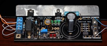

I'm thinking of using a linear supply, specifically a Salas SSLV1.1 to power the circuit. Is there any changes needed to the board (omit or jumper)?
This is how I'm driving my board, it works great. No changes needed, just build according to the instructions for the regulator. A 20R power resistor produces about 147mA of current. I used 4 green LEDs, 2 red ones, and put a jumper in for the diode. I think I used a 10k pot. The input to the board is from a 24v 2A linear wall wart that provides about 30v without a load and about 28.5v when connected to the BiB regulator.

Do you have a part number for the wall wart you're using?
I don't, so I went back the MPJA website to see if I could find it, but it appears they are no longer in stock. It has a cord that plugs into the AC socket, an enclosed transformer (plus diode/cap) in the middle of the cord, and a 5.5/2.1mm plug at the other end. It is rated at 24v 2A and cost me about $12. I think it was a "clearance" item when I picked it up a few months ago. While there were ones with lower output current, I chose the higher rating figuring it would way overshoot the 24v mark, thus giving the regulator some headroom to work well. This turned out to be true as its unloaded voltage is just about 30v.
I'm not using the sense wires right now, I was thinking I'd probably hook them up "properly" in the finalized chassis. Still waiting for a few parts to arrive...

This power supply is not regulated. Reading NP's article it is important to have a regulated PS to insure 24V's no matter the AC voltage variances.
"The preamp can be made to work with other supply voltages, but you will find yourself adjusting resistors and also needing a distortion analyzer to set the Nutubes for the desired distortion character. Easier to use 24V. If you use a linear power supply, you will want to have it regulated, as we need a constant DC value regardless of AC line voltage."
This one is regulated for about the same price.
GST25U24-P1J MEAN WELL | Mouser
This is the one NP has listed in the article. WSU240-0500-13 Triad Magnetics | Power Supplies - External/Internal (Off-Board) | DigiKey
It is regulated in the data sheet.

You are correct 😀. This is why I'm using it with the Salas BiB regulator I posted an image of just a few posts up 😉. The linear supply gives the regulator some voltage headroom to work well.This power supply is not regulated.
