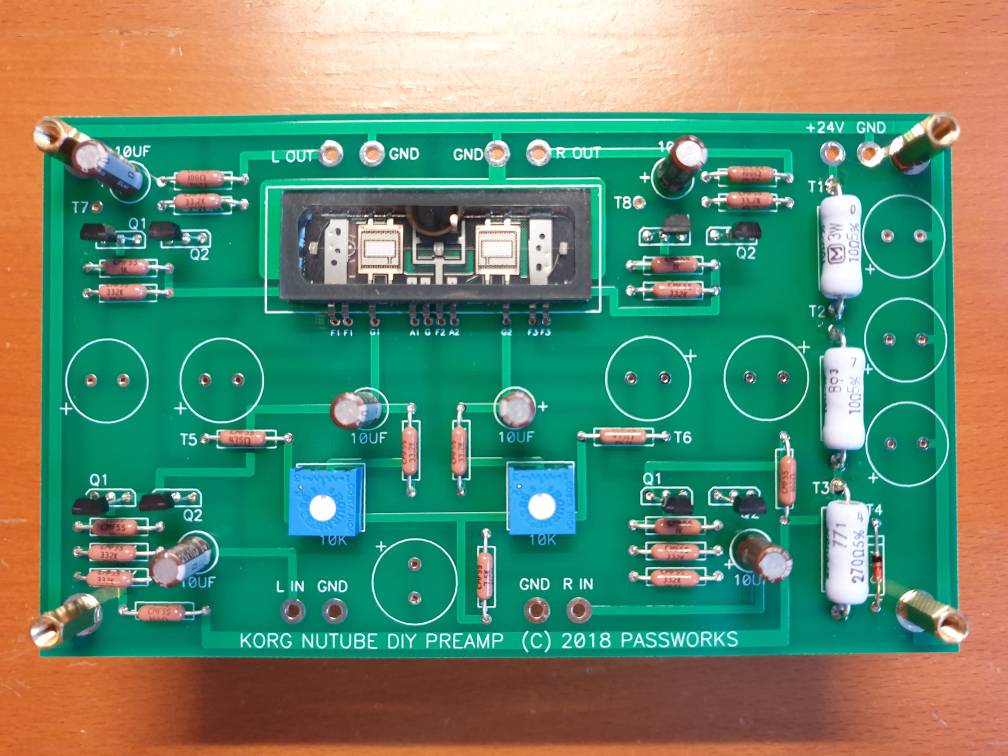

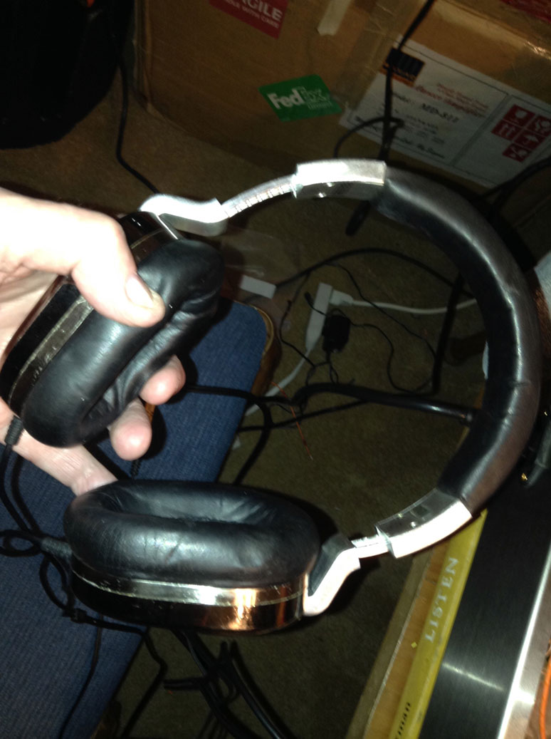

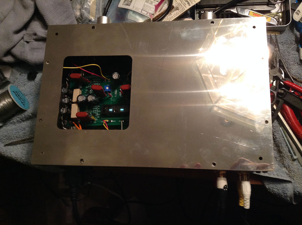

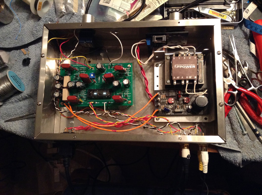

OK, it's making music. At first, I attached headphone adaptor to outputs just to check and make sure there was through put. There seemed to be some intermittent crackling, but I can't tell yet if it lousy cables and connections to headphones.
However after a bit, it played music steadily through both channels. I used Ultrasone Edition 8 (36 ohms) and Sony Z7 (80 ohms). Impedance match isn't ideal, but the NuTube has plenty of gain with these to make sound louder than I want.
So, the JFETs survived my soldering skills and seem to be 'correct' as far as I can tell.
I would recommend for those still building to get the 10Kohm potentiometers that have more turns and sweep, as making fine adjustments is really touchy with the one turn model. I settled on 9.4 Volts for T7 and T8 after some warmup.
It sounds really nice using an ipod as source with compressed music and my patchwork headphone rig. It definitely sounds like 'tubes' rather than SS, quite lovely so far, but I am sure it needs some run in to optimize. I am also not using it for it's intended purpose with headphones, so I will try it later with a proper amplifier.

Oh, I put surgical silastic under the NuTube and also under the board. I also gave the power supply some degree of motion and have silastic under that, too. No microphonics so far either tapping on the tube, turn on, playing the music. I can't hear any noise with the volume turned all the way up and no source, but maybe it would be different with speakers.

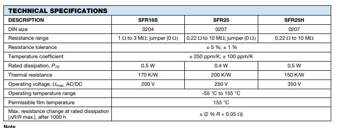

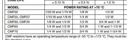

RN55 are 100% derated to meet a US Mil-spec.
That means that they are a 1/4w resistor that says 1/8W on the data sheet.
They are identical to CMF55 except the leads of the RN must be non-magnetic, where the CMF sometimes are steel, and the tinning on the leads is not lead-free, because the US milspec absolutely positively will never be lead-free, because they understand the metallurgy behind stable solder joints.
(Research “tin whiskers” for more data. Want to stop tin whiskers? Use leaded solder. 🙂 )

Ho ho ho, I am almost there. Waiting for the Mouser delivery to complete the build.View attachment 741158
..except the leads of the RN must be non-magnetic..
Interesting thanks 6L6 for clarification 🙂 Greetings

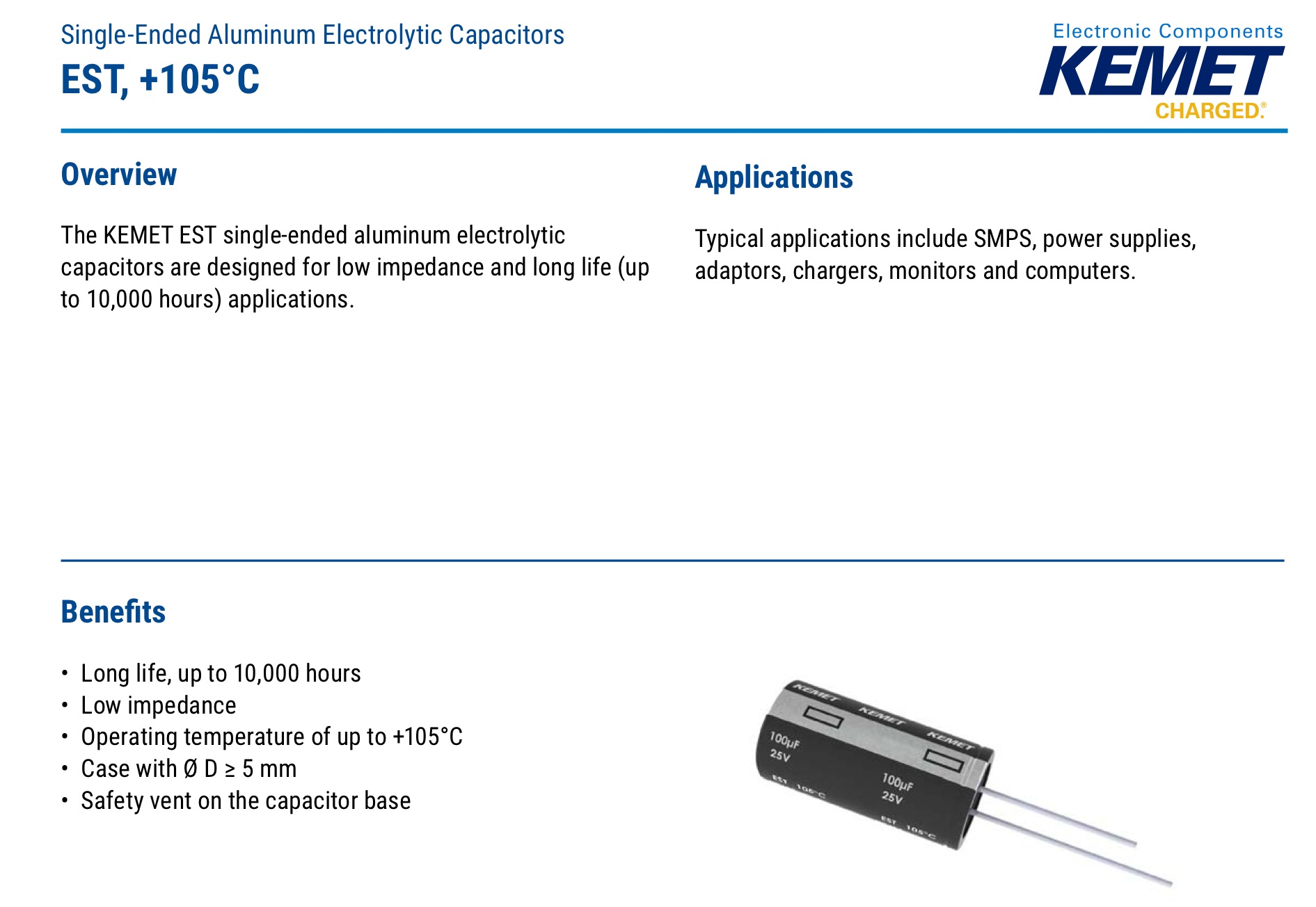

I am also awaiting the large capacitors.
Kemet Company capacitors are long life 10000 or 5000 hours , low impedance, high ripple current
EST108M035AL4AA KEMET | Mouser France
https://www.mouser.fr/ProductDetail...=sGAEpiMZZMtZ1n0r9vR22XqtLh5sbTzGJXGU9nA/DVY=

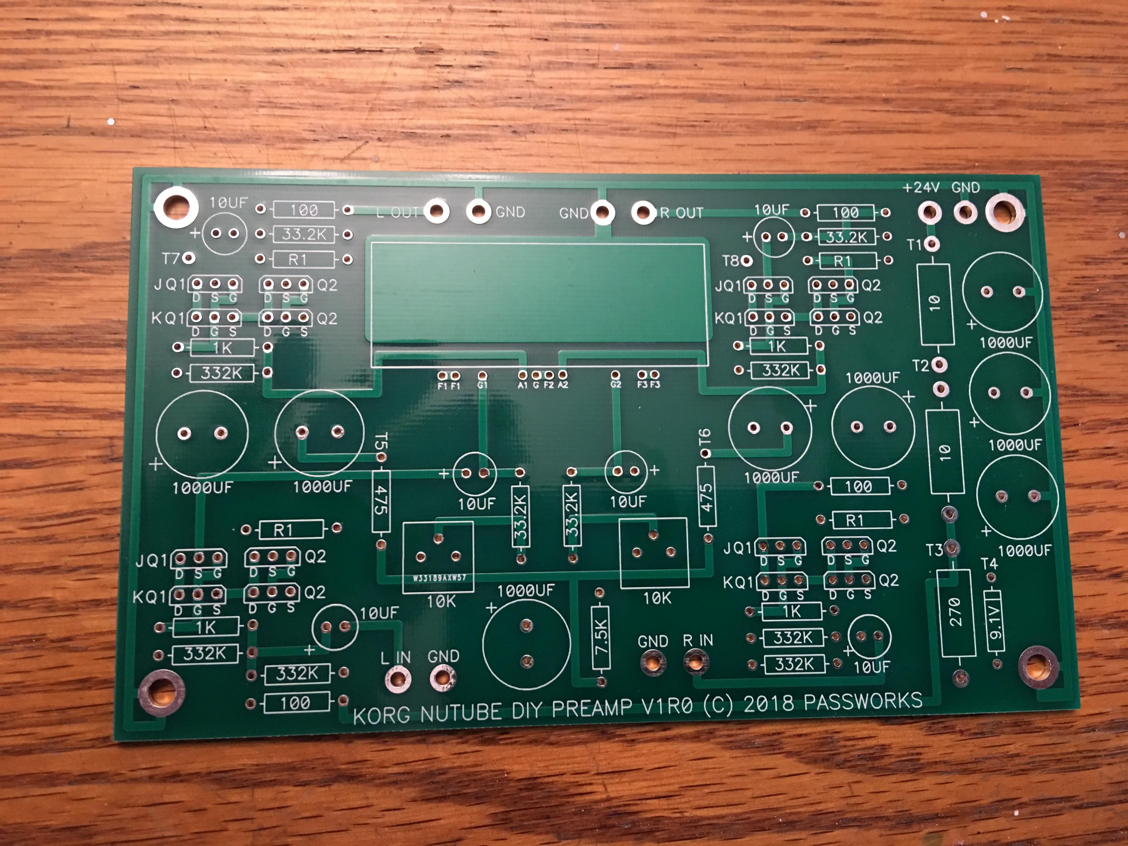

Apparently I'm using a different iteration of the PCB. It comes from the DiyAudio store...but what are all the slots for Jfet's for on mine?
You can use different JFets with your board. Look at the pinout. DSG versus DGS. If you've Toshibas then use the J- and if you've Fairchilds use the K-slots.

Hey Kevin,
Papa has a revised doc for this version.
http://www.firstwatt.com/pdf/art_diy_nutube_preamp.pdf
"The PC board is set up to accommodate a variety of Jfets and has corresponding holes for
the parts, being that they have different pin-outs. The JQ1,Q2 is used for the Fairchild J113's
and the KQ1,Q2 fits the 2SK170, 2SK370, and LSK170 Jfets." (see page 3)
Also there is a trace missing in the V1R0 version of the PCB ( see p7):

Also, page 6 parts list shows qty=2 100 ohm resistor. Qty=4 are required.
