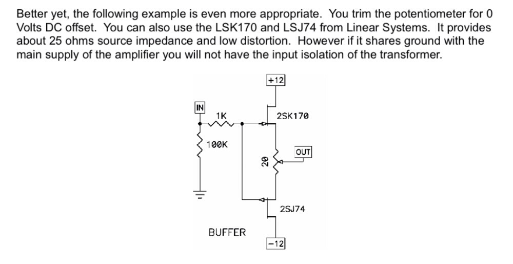

Schade 50W have 20 dB of gain so Korg preamp is interesting candidate.
One important parameter is B1 Triode output impedance = 140 to 170 Ohms is nice low but not ideal for this specyfic amp.
Schade need 25 Ohms at the input for the best wide frequency response bandwith.
Perfectly on more buffer 2SJ74/2SK170 stage keep input always at 25 Ohms after that You can try connect all preamps you get.
B1Triode pre is very flexible , trimmer on H3 low distortion position if Schade 50W have lot of H2.
Other candidate imho can be Wayne LineStage BAF2018 this one have very low output impedance few ohms without use of rare vintage jfets. Preamp distortion are H2 second harmonic
so this time Schade 50 W CCS load 0.1R + 0.1R + 0.1R + 0.1R resistances position modification can bring low distortion and third H3.
Avoid too much H2 and keep in equilibre Modify sound to Your taste

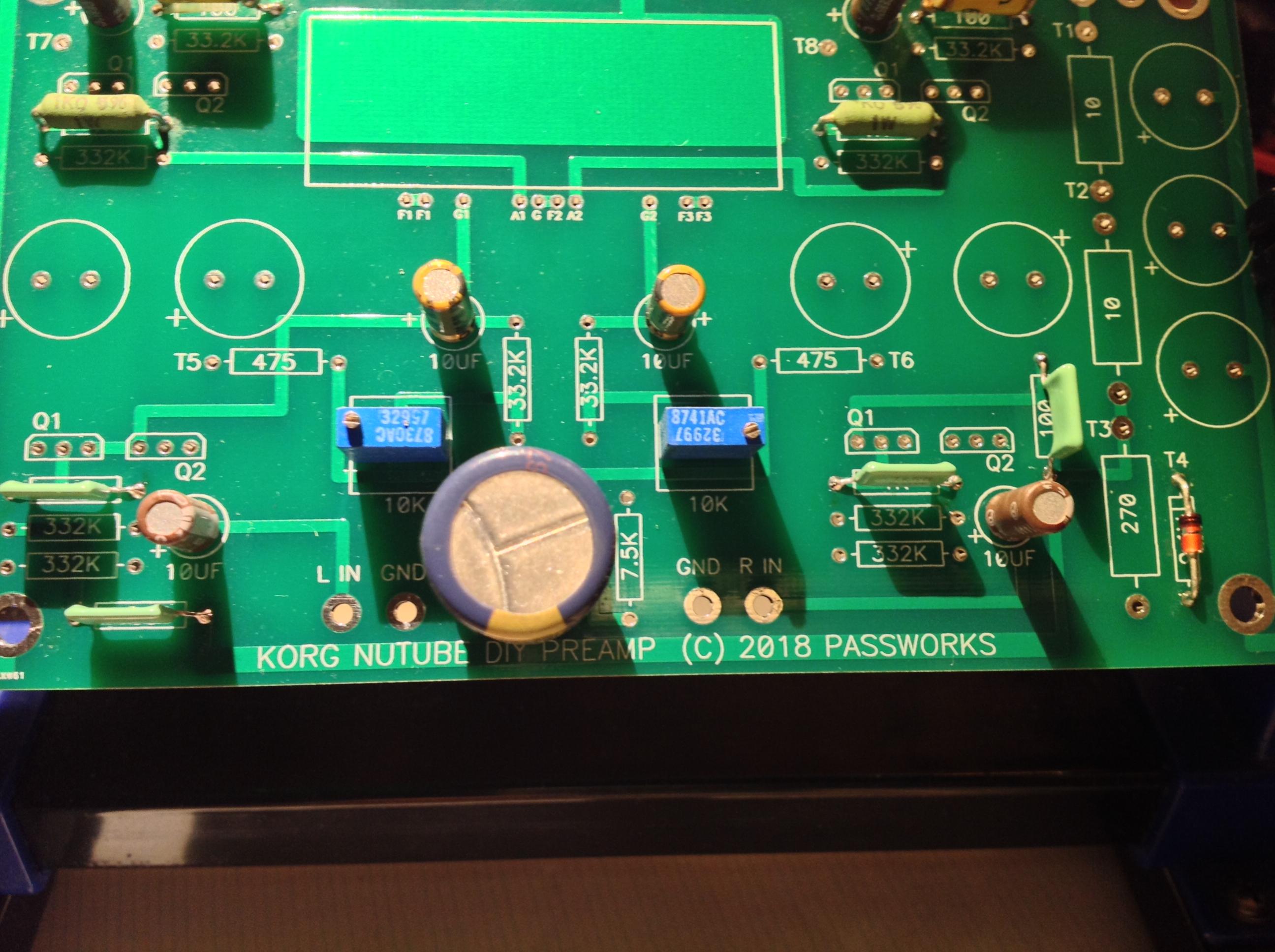

Got the board. Yup, definitely an amateur. I soldered all of the resistors I had from the pack. The .pdf cites (2) 100 ohm resistors, which I ordered, making it two 100 ohm resistors short of the actual board, so if anyone orders from the .pdf, order (4) 100 ohm resistors. Soldered the 'Pass Bypass' segment on the leg of one of the caps for the V1R0 version board. 10 ohm resistor are back ordered, 9.1V zener ordered, so I guess I need two 100 ohm resistors.
I am fearing the transistor solder because the pins are so close. Maybe the two sides from the top and the middle lead from the bottom of the board. My solder technique improved as I went along doing the resistors, from weird to reasonably nice, so hopefully I can get the JFETs in without a botch. I tested everything as I went along values, connection points etc.
I will do JFETs last, hoping my solder technique gets less suck-y as I go along further.
For a first DIY, this stuff is harder than it looks until some practice is attained.

Got the board. Yup, definitely an amateur. I soldered all of the resistors I had from the pack....I am fearing the transistor solder because the pins are so close....For a first DIY, this stuff is harder than it looks until some practice is attained.

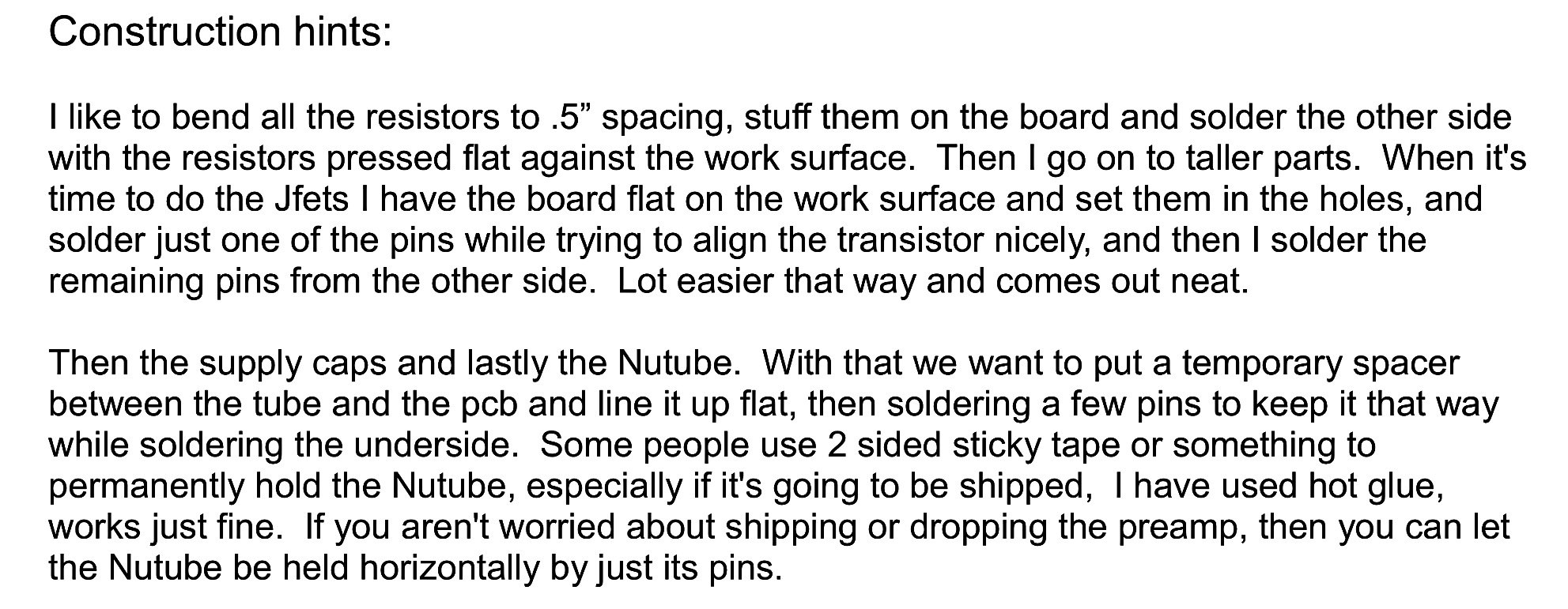

Relax it's easy
Touch only jfets plastic case with your fingers but not the metal pins.
Body can be charged by static electricity and damage transistors.
Soldering training on some old boards with components can be useful and watch the video's

Mr Pass write for us construction hints Have a good time

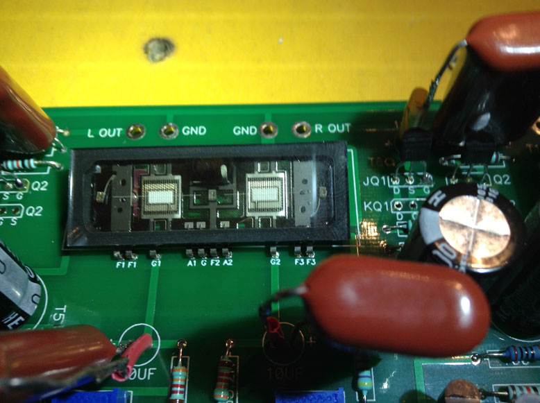

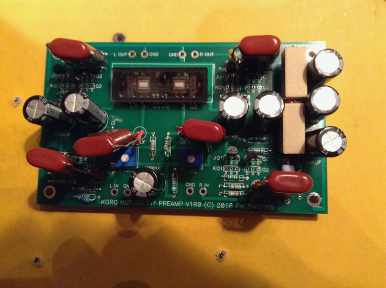

Well, I stuffed the board with everything but the 9.1V zener, which is on order. I used some 10 ohm large resistors that I had for PS, and got two extra 100 ohm resistors from another item, though smaller watt rating.
I have to admit it was scary soldering those transistors. The NuTube was even scarier, but I think????? all is in order. NuTube picture shows surgical gel under tube for microphonics, it can easily be removed and replaced by something else.
Yeah, board looks terrible. 2.25 microfarad polypro caps, strange components, lousy but adequate solder.
After 9.1 zener comes in, its attach the PS and it's all over but the smoke and tears. I give it a 50-50 chance of working.

Do Q1 jfets are in good positions ? They are not interchangeable with Q2.
Good luck
