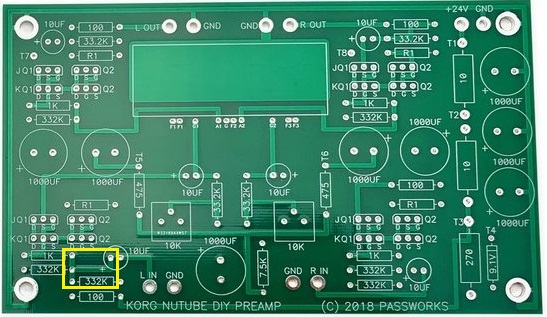

I'm building up a store version PCB, here's the part numbers (Mouser) I'm using if anybody is interested -
10ohm 3W 603-FMP300JT-73-10R
221ohm 71-RN55C-F-221/R
270ohm 3W 594-5093NW270R0J
475ohm 71-RN55D4750F/R
1K 71-RN55D-F-1.0K
7.5K 71-RN55C7501F/R
33.2K 71-RN55D-F-33.2K
332K 71-RN55D-F-332K
10K trimmer 652-3386F-1-103LF
10uF 647-UFG1K100MEM
1000uF 647-UKW1E102MPD
9.1v Zener 512-1N4739A
Remember that R1 and the transistors are included with the PCB

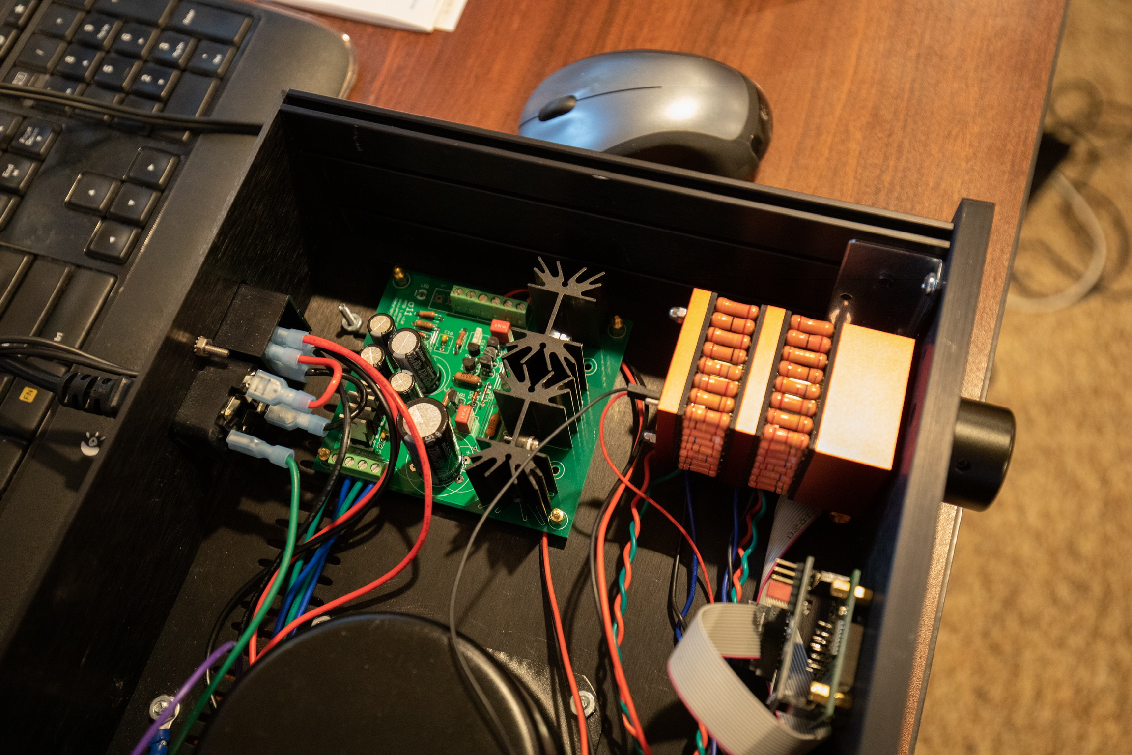

Yes, I am. I was just about to order parts, thanks a lot. I went for russian PIO caps for the 10uf caps.
I am using four of the Sigma11 in a DIY Naim dual HiCap to power my NAC 82 preamp. I started with just a pair to replace a factory Olive era HiCap, and the improvement over the Naim implementation was very worthwhile. Adding the second HiCap worth of regulators took the preamp to a whole new level.

I love clean power ... sigma11 (clone) from amb.org with active rectifier.

Can I use "Fairchild - 12V 1W - Zener Diode" product code "BZX85C12" instead of Mouser part "9.1v Zener 512-1N4739A"?
If you did, you would have to adjust the resistors that depend on the 9
volts to higher values.
Thank you Nelson, I will stick to the 9.1V Zener then as I do not want to fiddle with the resistor values. The only reason being that the 9.1V Zener is available in India only on RS Delivers and they seem to sell only in the lot of 100 and no other site other than Mouser India or element14 has those but they all charge a hefty shipping.
Coming to the capacitors does 80v recommended ones or can I go lower like 1000uf 25v or 10uf 50v of Nichicon Muse which are available easily here rather than the higher voltage ones.
thanks
One quick question: How sensitive is the 10k pot with respect the adjustment needed. I found the 5k pot on the ACA workable but excessively touchy when trying to trim the voltage by small amounts. I used 8 turn pots after the first boards and was more relaxed thereafter. Any thoughts are most welcome!

It's a 24v supply so the capacitors will never see more than 24v.
25v rated will work perfectly.
Thanks Jim, as can procure 1000uf 25v Nichicon FW series and 10uf 50v Nichicon Muse here in India easily. Will go with that but the 25v is the one which is sitting on the edge even though the power supply is 24v max rated. Let me see if I can procure slightly higher voltage just to be satisfy myself

Skip Pack - using a multi-turn pot is totally fine if you'd like.
Manniraj - I wouldn't worry about it, they have surge ratings to about 34v if memory serves, but if you'd like to use a higher rating, it certainly will not hurt.
Rhing - that's not complete, you'll still need a volume pot, any switching you'd like and a chassis, obviously, but it should get you started.
