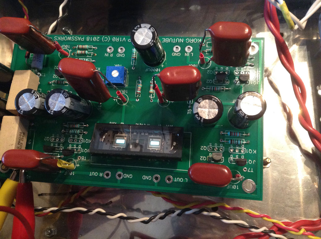

My B1 Nutube PCB and Nutube arrived today. Can't wait to get soldering and listening started.

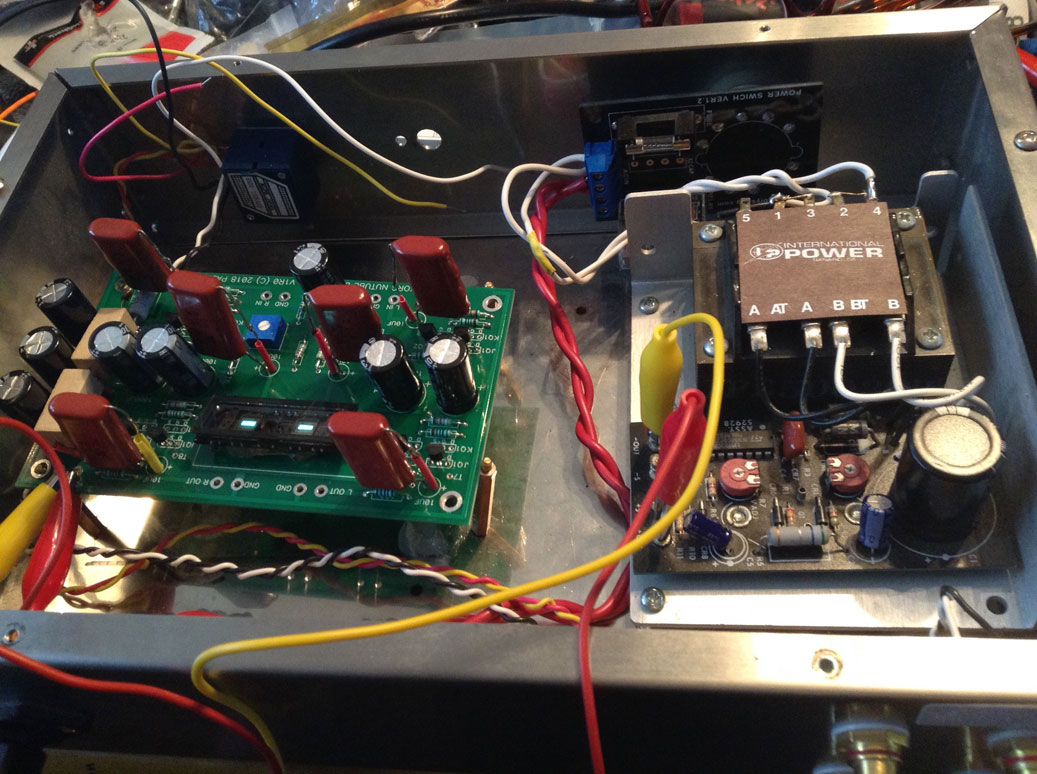

IT LIVES! MY MONSTER LIVES!
T7 and T8 easily mark around 9 to 11 volts each! Pretty blue glow on NuTube!
Woooda Thought!
Now, have to hook things up to see if the signals go through and the buffers are intact.

Congratulations Cjfrbw

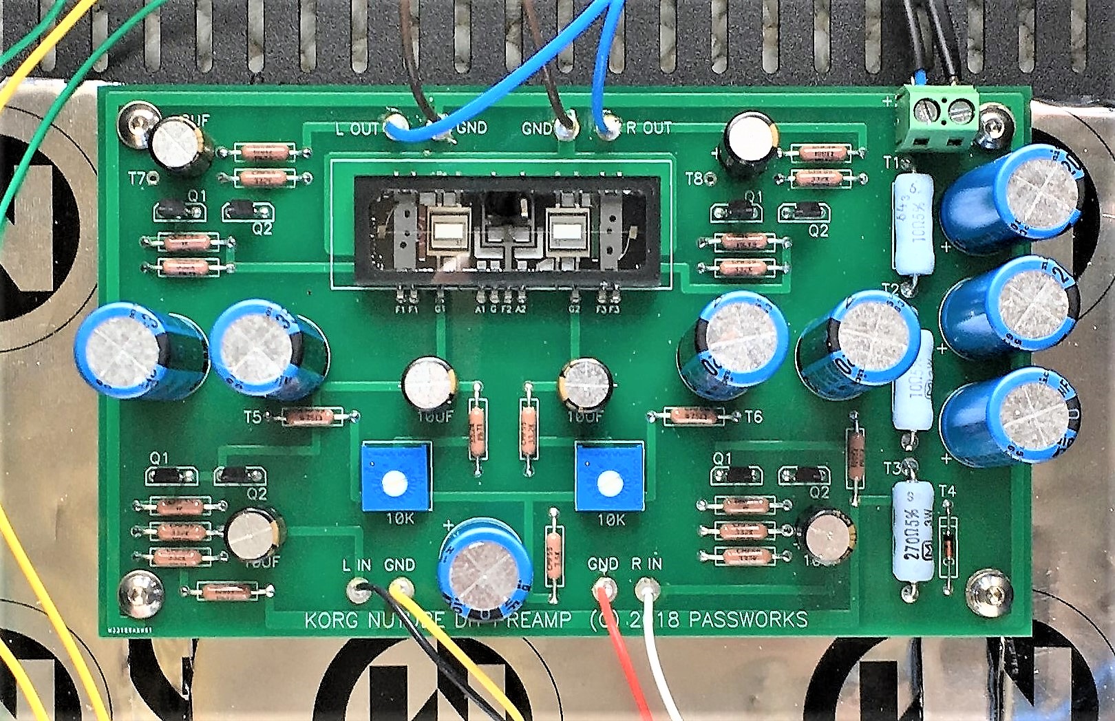

Do You tested voltages at T1 to T8 points from article ?
What about music ?
Congratulations Cjfrbw What about music ?
NuTube looks good to go. I still have to connect signal inputs and outputs/volume control and finesse the board on it's altar. It's still only part way there. Maybe I will get it done tonite and tested.
NuTube looks good to go..Maybe I will get it done tonite and tested.
How much is Your filaments voltages at T5, T6 ?
Me too I need back on the work bench Have a good time
What about music ?
T1 is 24V DC, very close.
T3 is 23V DC, very close to NP's article
T4 is 9.16V DC, pretty close to NP's article recommendation.
As stated, T7 and T8 both bias easily without warm up to the 9-11 V DC range.
PerfectAnd T5,T6 ?
Without much warm up, T5 and T6 measure about .62 V DC to .63 V DC without adjustments. It looks like everything is on spec for the NuTube, at least.

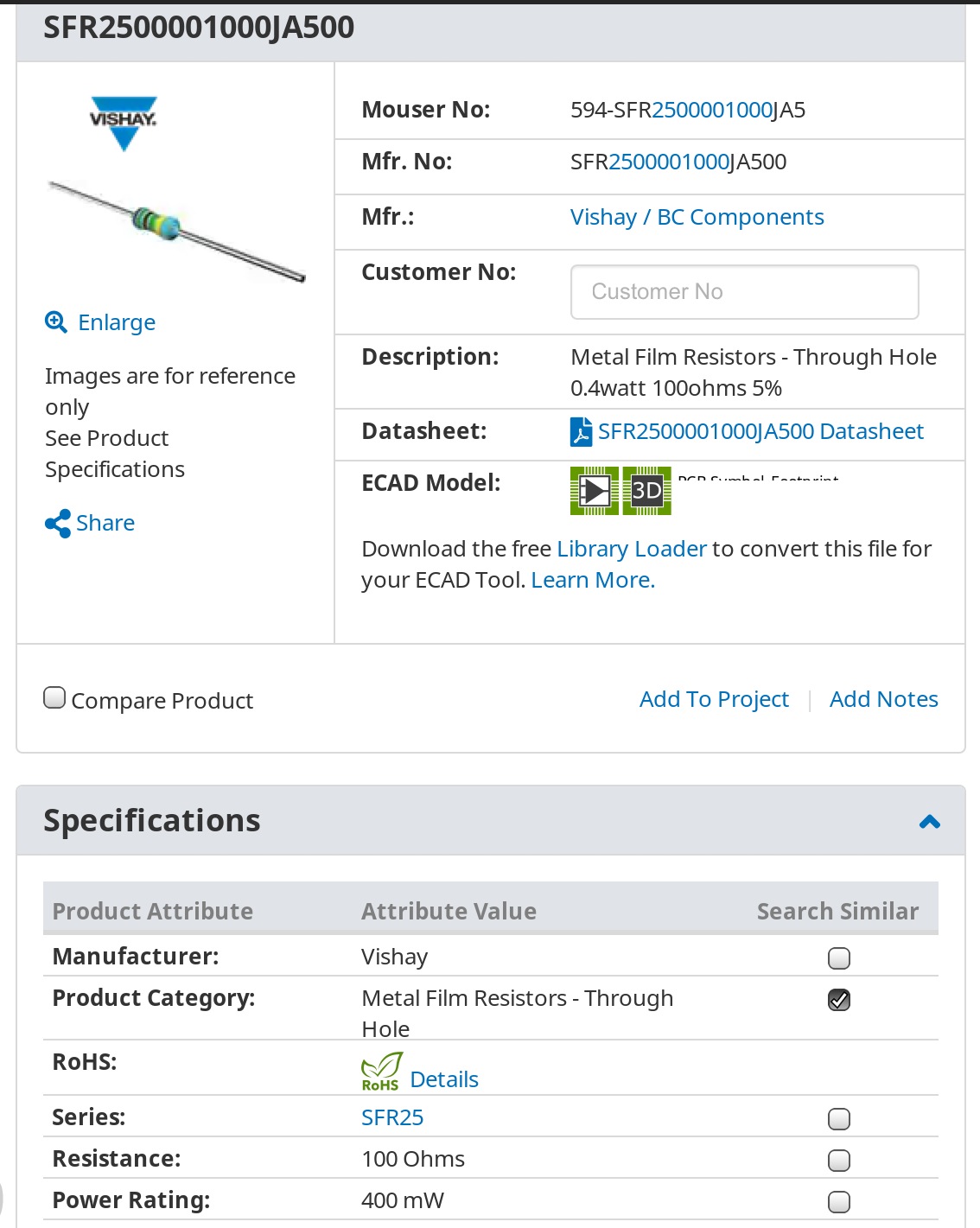

From First Watt article resistors reference are SFR25 made by Vishay BC
https://www.mouser.fr/datasheet/2/427/sfr16s25-239894.pdf

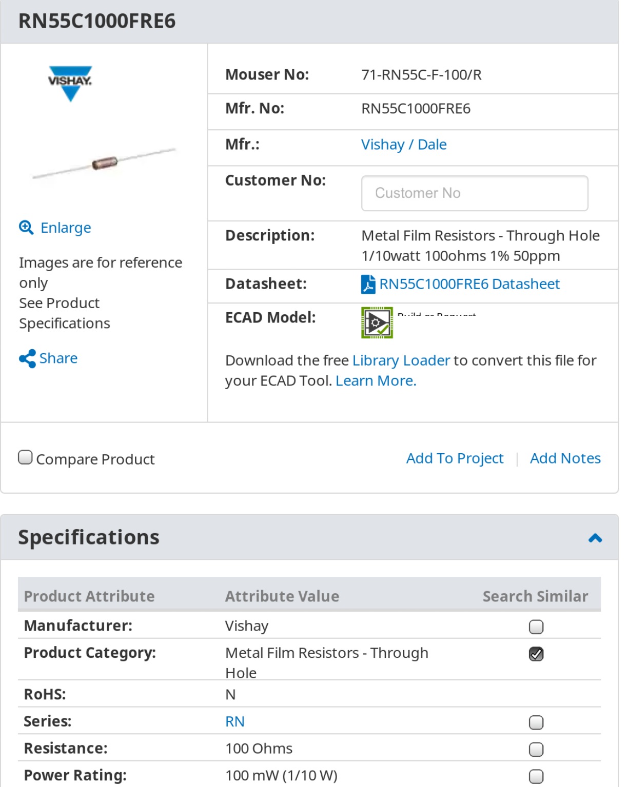

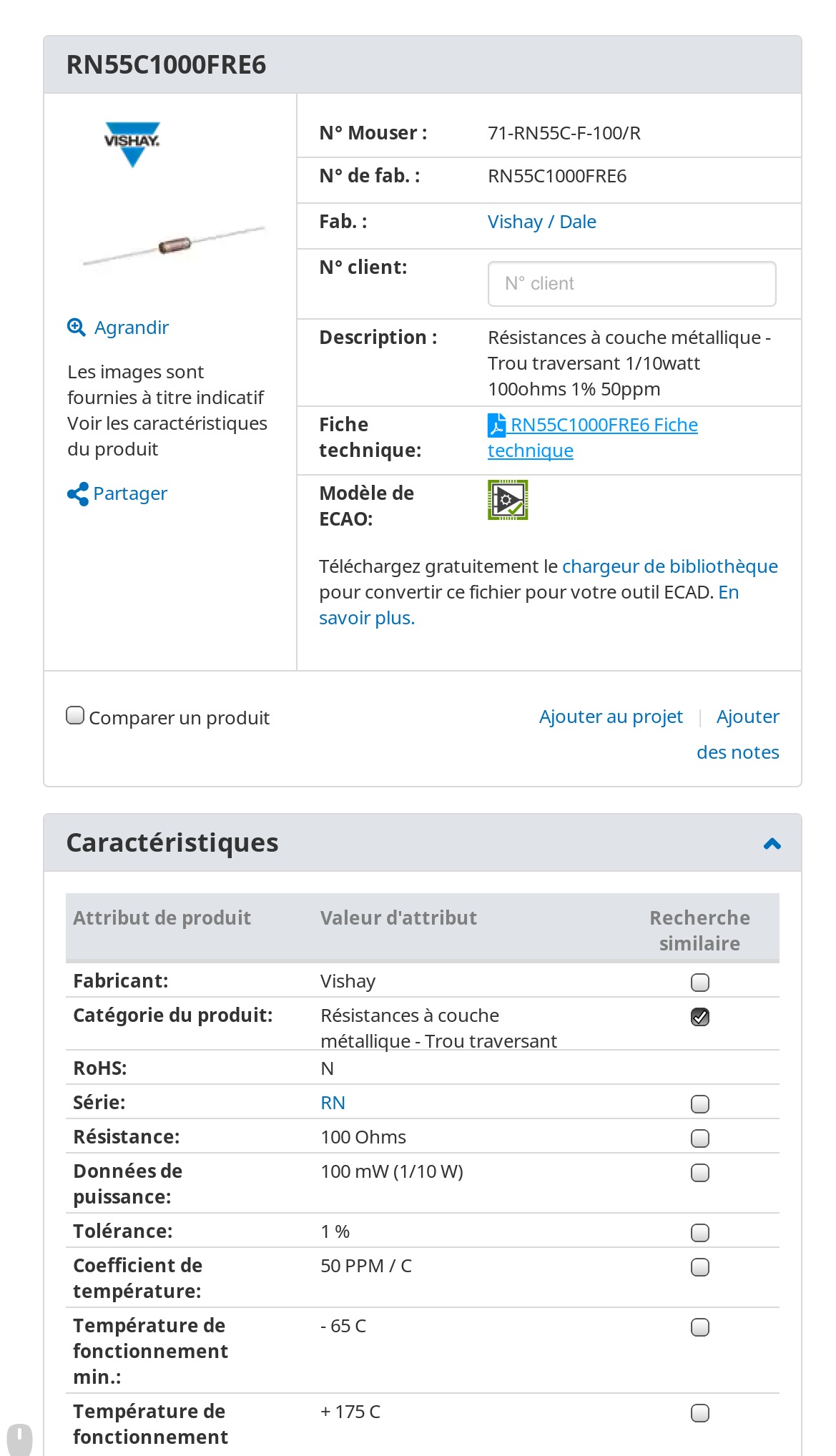

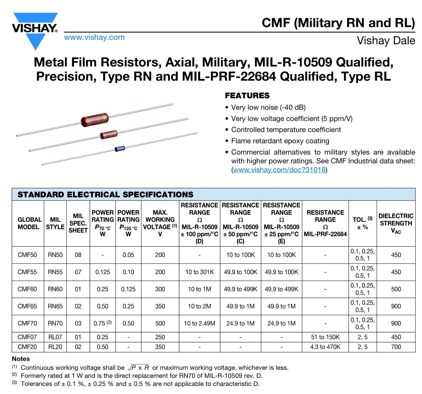

I believe RN55 series resistors are fine, and those are mil-spec'ed ratings;
CMF55 is the industrial counterpart.
According to http://www.vishay.com/docs/31018/cmfind.pdf
the mil-spec'ed and industrial versions are the same except for markings.
And CMF55 is rated at 0.25 to 0.5W depending on ambient temperature:

Vishay BC SFR25 on actual Mouser page are 1/4 watts but CMF55 , RN55 are not..
Yes, but the RN55 are severely underrated for military and aerospace and work just fine with light loads they see in the B1 Korg.
