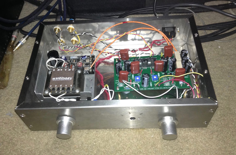

I had some time to put Pass NuTube through some paces. System: ancient Yamaha B2 amplifier, digital source, NuTube, and crossover-less panel speakers. Bias is set to 9.4 V, close to NP’s project target of 9.5V ( I got tired of messing with the 10K pots and just left them at 9.4 V).
I had some pre-conceptions if I got this to work: 1. it could sound nice, but perhaps too sweet/syrupy and would obscure details 2. it would compress a bit.
Neither has been the case. It enhances detail with a velvet glove, and it does very well with dynamically complex material i.e. it does not crush the voltage swings that I can hear.
I tried switching the polarity of the speakers, and will confirm within the limitations of expectation bias that the H2 ‘negative’ position ?(speaker reverse polarity) does have a bit more dimensional character, sort of pushing the emphasis down a bit into the midrange. The H2 ‘positive’ position without reversing the speaker leads has a somewhat more gathered, incisive character, sort of pushing the emphasis a bit into the upper midrange.
If I put a polarity switch on the NuTube, I would probably label the H2 negative as 300b, and the H2 positive as 45, as those are the DHT tubes that they kind of remind me of.
I don’t find either position superior to the other, they both sound great. You might want to listen to Cafe Blue with H2 negative and Ozzy Ozborne with H2 positive.

Here is my build:
Xmas Board w/ matched Toshiba JFETS (thank you Papa!)
DIY store Galaxy 1U 230X230 chassis
Glassware Audio "Select 2" 3-input switch
Alps 50K "Blue Velvet" audio taper pot
Kemet PS caps (1000ufd)
Elna Silmic II signal caps (10ufd)
Vishay CMF-series resistors
Mean Well PS w/ CUI jack
Military-style knobs (EHC and Grayhill)
REAN NYS367-series RCA jacks
