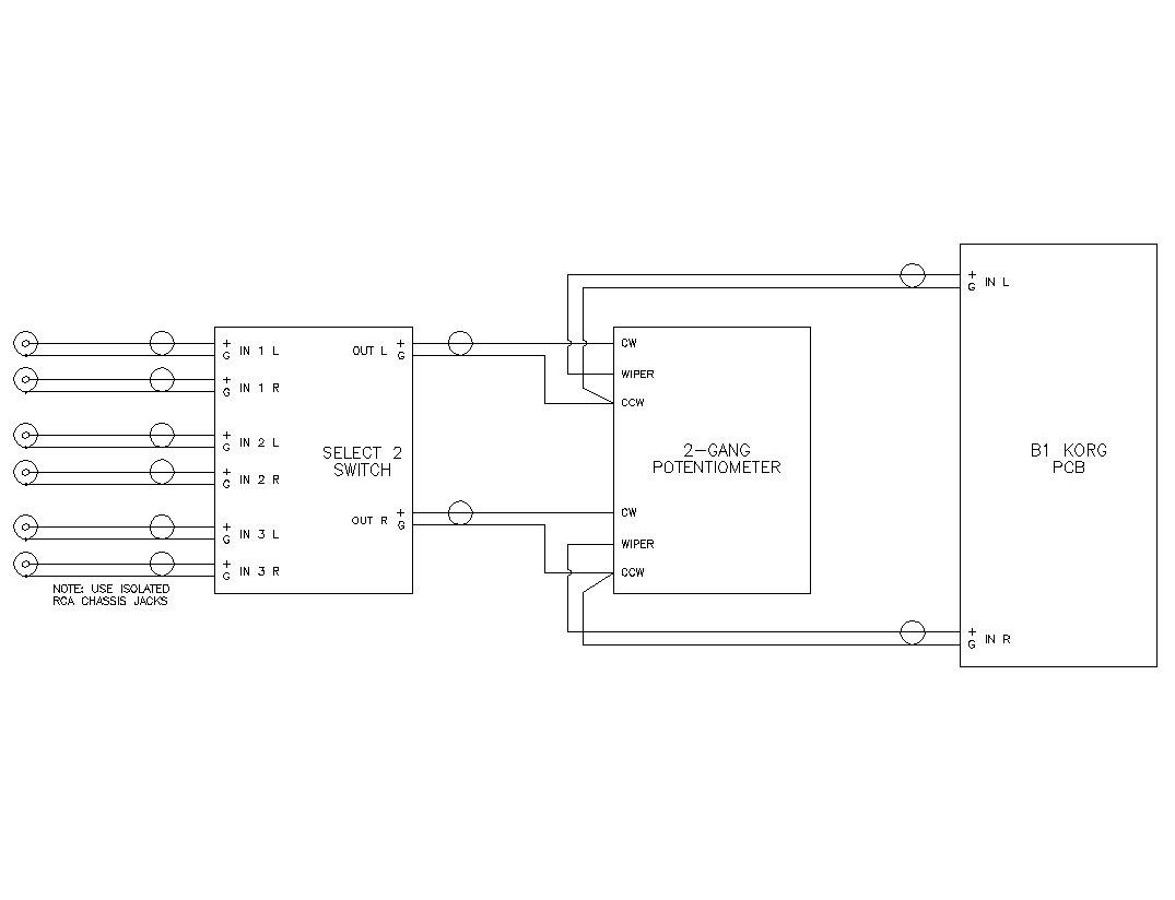

Excellent and clean build. I am almost done with mine but using Salas 1.3 PSU with a 0-23v trafo to power the buffer. How did you connect the Alphs pot to the buffer board along with the Select 2 switch? Fortunately I have the same switch but with DACT type 50K log pot from eBay. Let me know the connections if you can via a simple diagram.
thanks
Sorry for the late reply, I have been caught up in many projects. Diagram is attached.

Thank you, so you are using the original Alps 50k pot right? So the wiring diagram from your pic is for the first row 3 pins and then followed by next row of 3 pins on the potentiometer.

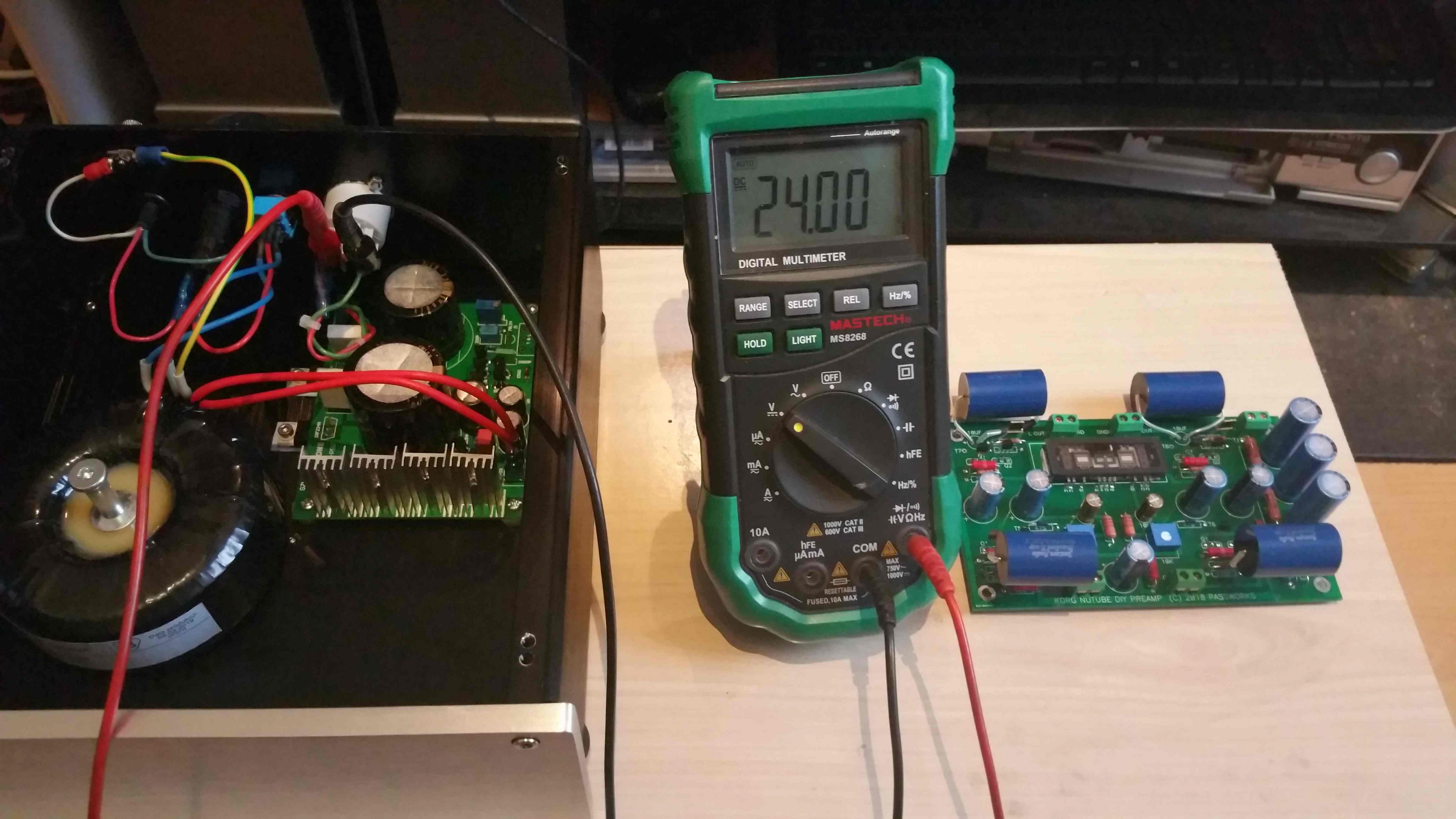

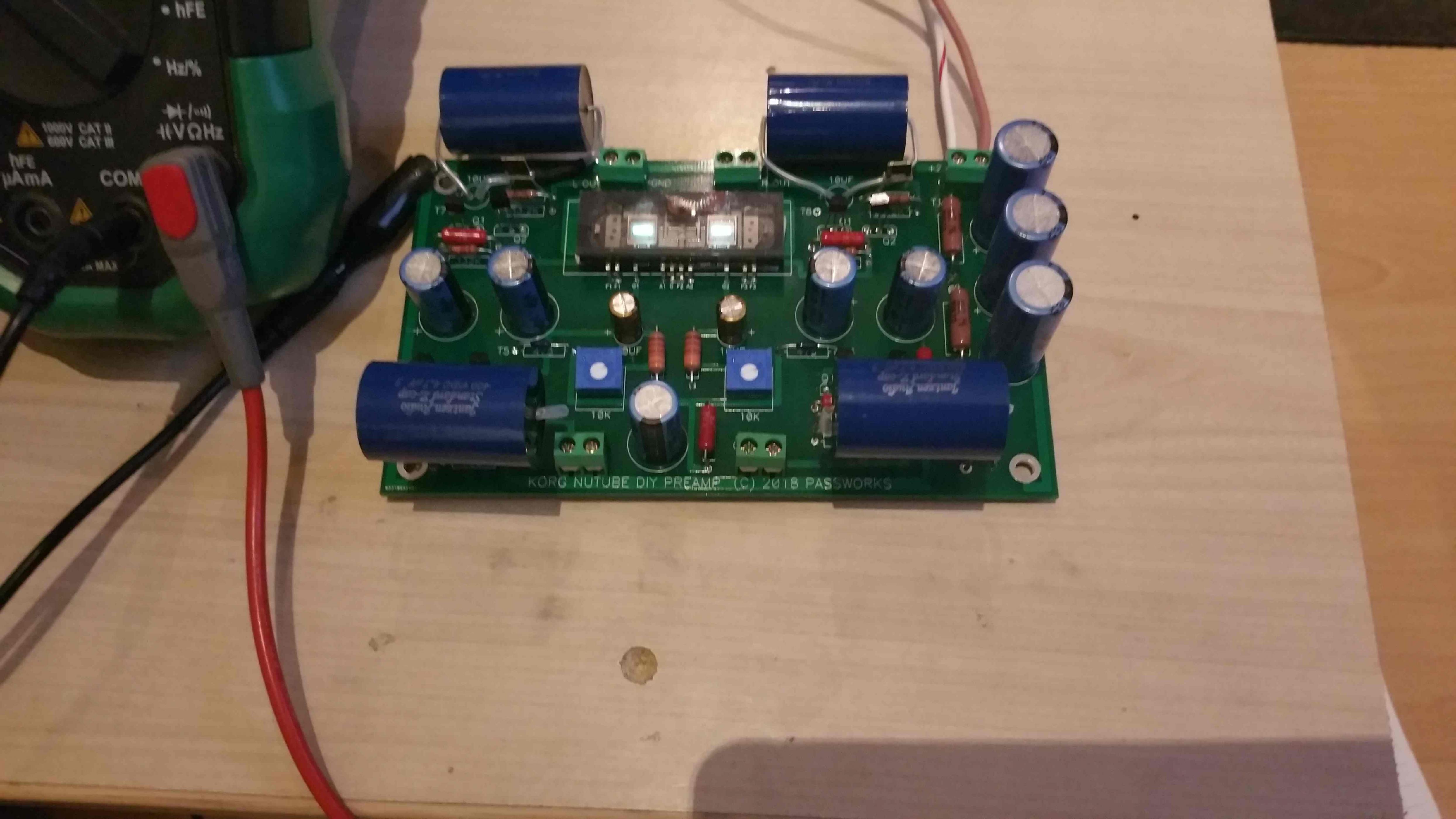

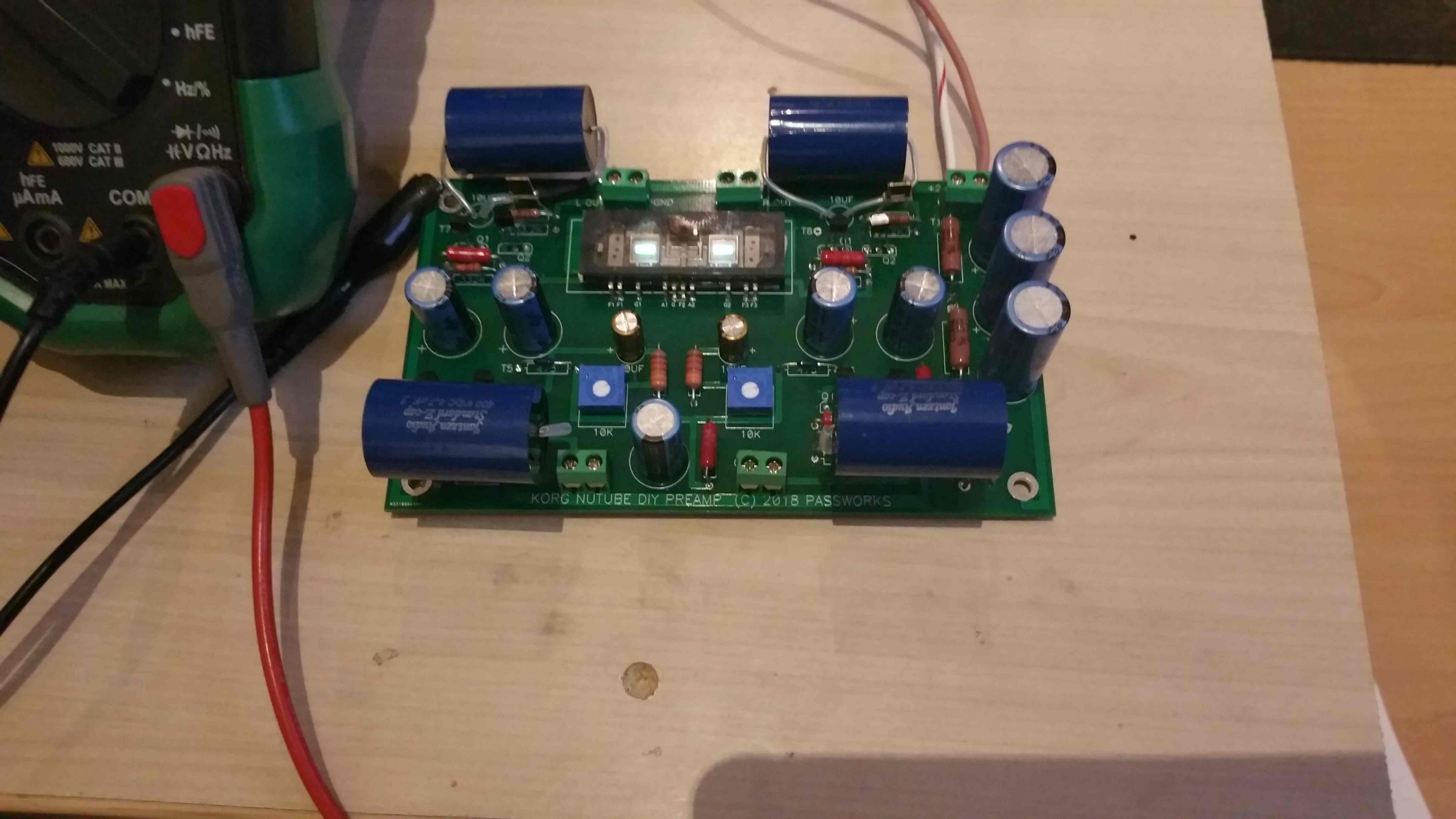

Finaly built and tested the christmas b1korg numbers are as follows
T1 24.00 vdc
T3 23.00vdc
T4 9.07 vdc
T5 0.6 vdc
T6 0.6 vdc
T7 9.49-9.51 vdc (after 10 minutes)
T8 9.49-9.51 vdc (after 10 minutes)
These numbers appear to fall within accepted limits. Have played no music yet as have to dissamble b1 to put b1 korg in .All info suggest that volume pot has to be 50k is it possible to use pots i have now ie 20k pots or a 100k pot that a have lying around this is an original arek kallas pot in silver plated cotacts when h e first bought them out some years ago. One other query is there anywhere on the board a led can be attache led indicate power on. Anyway thanks again to nelson for giving us this gift as well as to anybody that can help with the queries that i have hope to appreciate all it can do soon.Regards Spades

answer to spades #1855
Hello SPADES,
steel the 24V from the power input of your pcb.
Resistor value depends on your LED you want to use.
My blue LEDs I most often use run between 20mA and 30mA.
(Check datasheet of your LEDs!)
U = 24V
I (Led) = 20mA - 30mA
U:I= R
24 V : 0,020A = 1.200 Ohm
24 V : 0,025A = 960 Ohm
24 V : 0,030A = 800 Ohm
Greets
Dirk

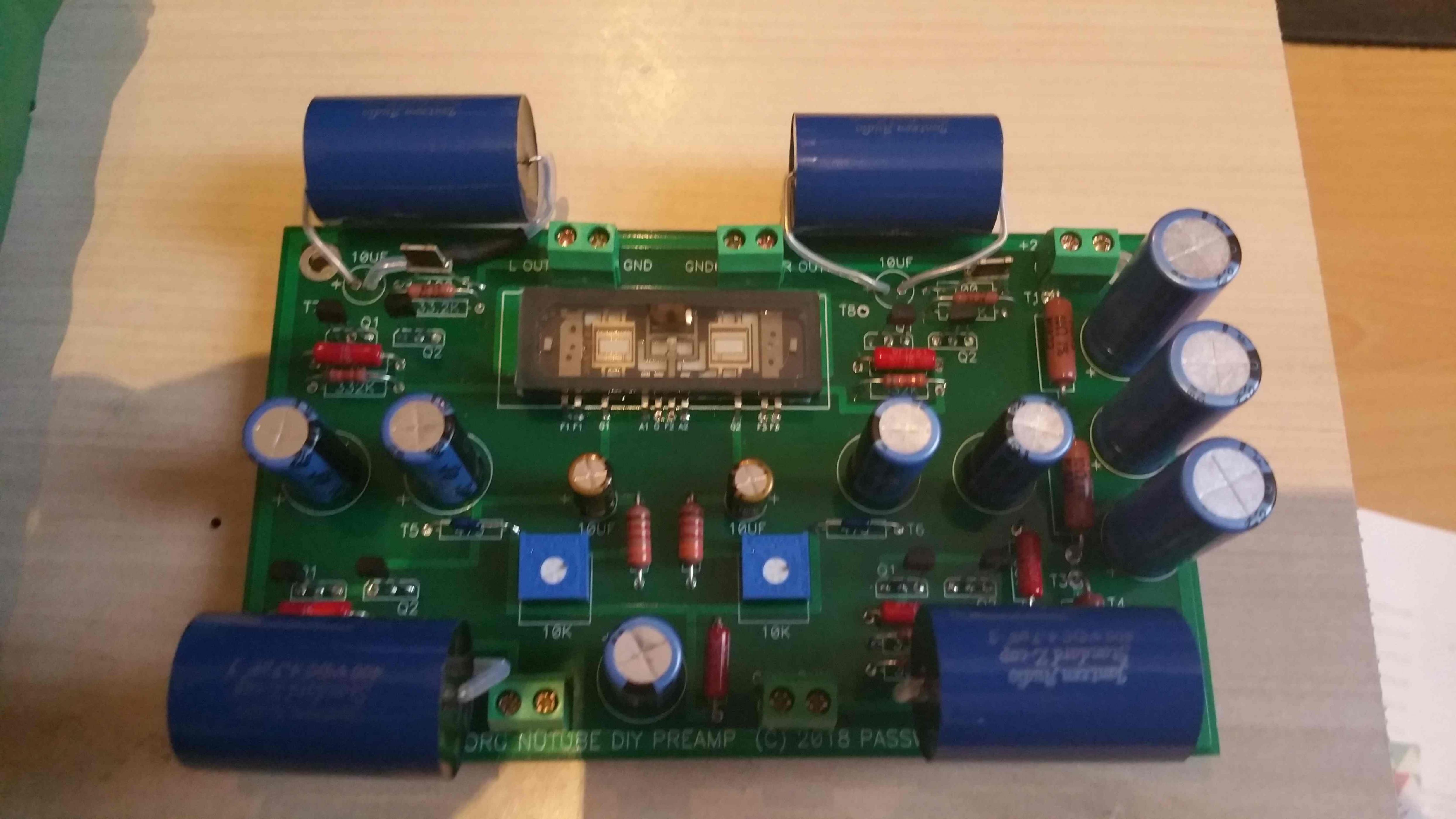

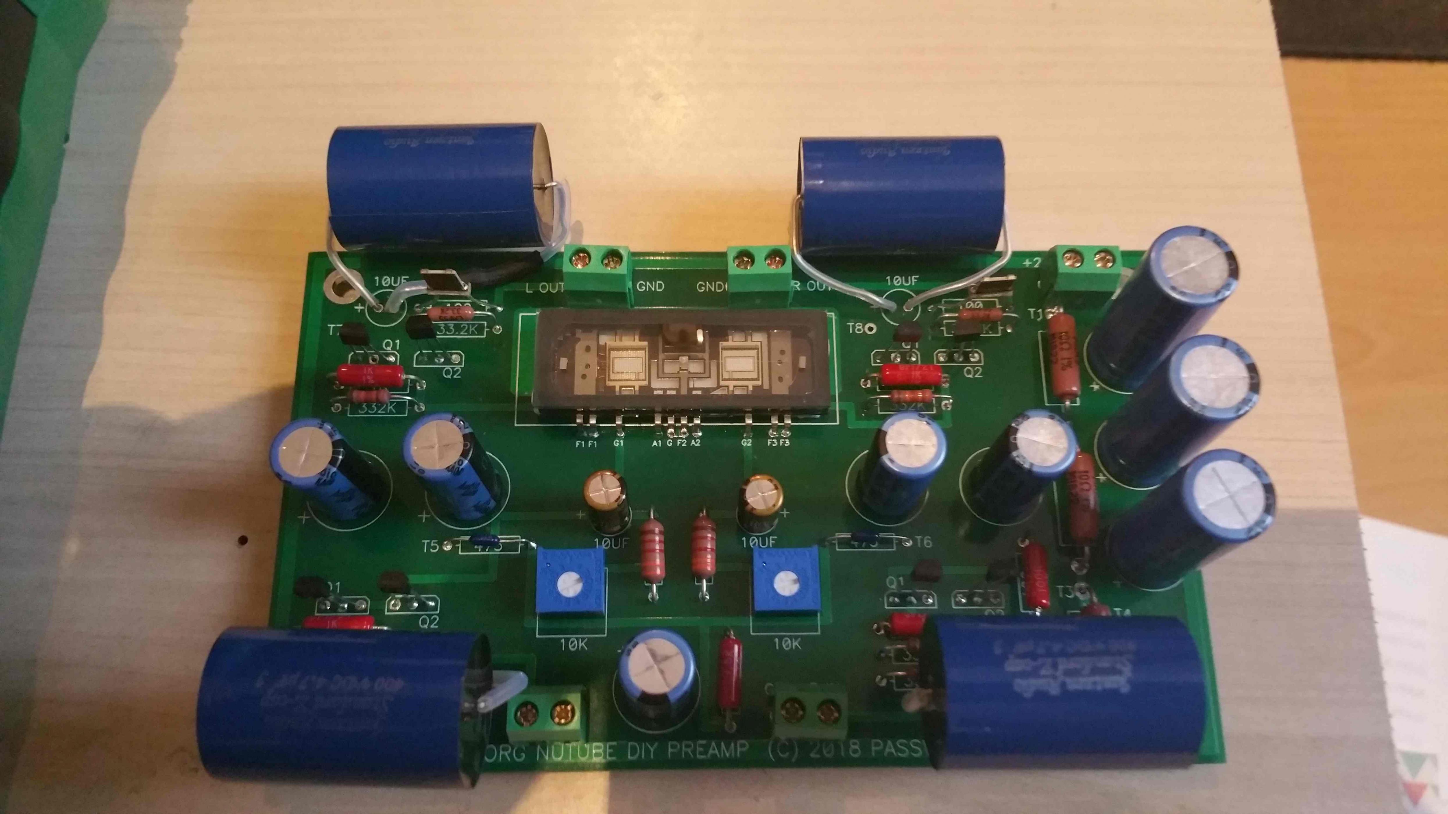

I didn't get any responses to my original post so thought I might try one more time. I have gone ahead and ordered another NuTube from the store - hopefully will be here tomorrow and I can swap the part out.
Does anybody have any other theories as to what I might check? All the other measurements from the FirstWatt article mentioned are within spec.
Also - what would be the best way to implement an LED to indicate power on/off?
Thank you for pointing me in the correct direction, H and B voltages measure 8.99
The replacement NuTube I ordered arrived. I carefully replaced it. Same result. Much frustration, rechecked measurements, checked another time for cold solder joints, remeasured everything and was writing down the measurements to start another post asking for help when I noticed that I had the input buffer 10uf capacitor installed with the incorrect polarity - switched it around and bingo - everything specs out great and problem solved.
