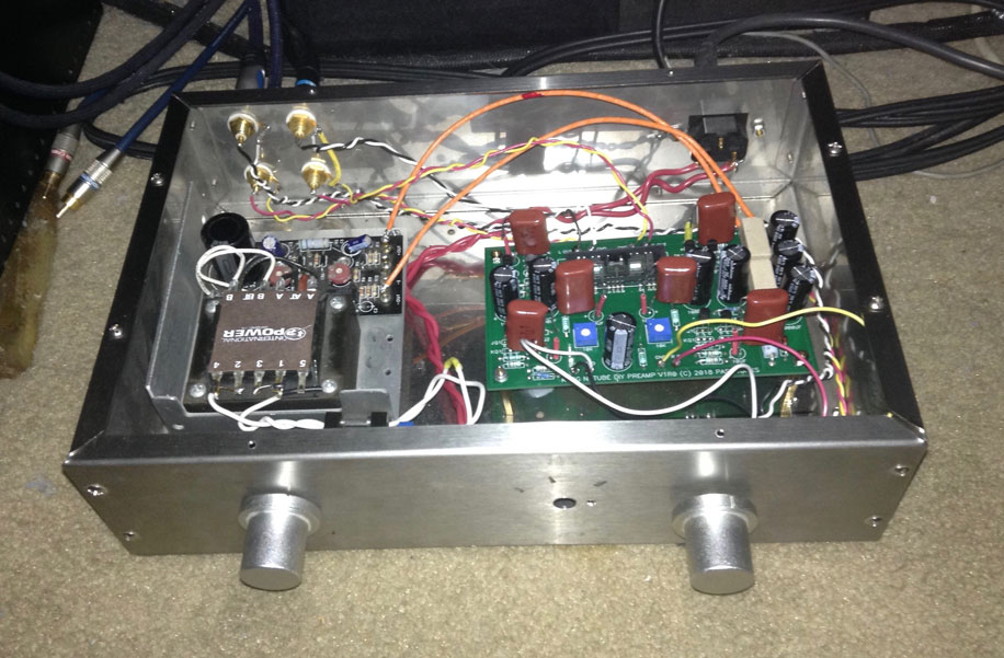

Help ! ...wrong voltages measured !
I built up my xmas pcb with all parts except the korg/nutube.
I measure 24v in from a reg
T2 = 23v5
T7 = 21v87
T8 = 21v74
10v85 at L in
10v79 at R in
T2 = 23v5
T7 = 21v87
T8 = 21v74
10v85 at L in
10v79 at R in
I believe that's close enough.
T7 and T8 are at rail voltage because no tube.
Thank you!
Will put the nutube in now! Stand back!
Oh yeah!
It's up and it's the bomb! Thumbs up
to infinity!
All hail Mr. Pass
Thank you for the xmas present!

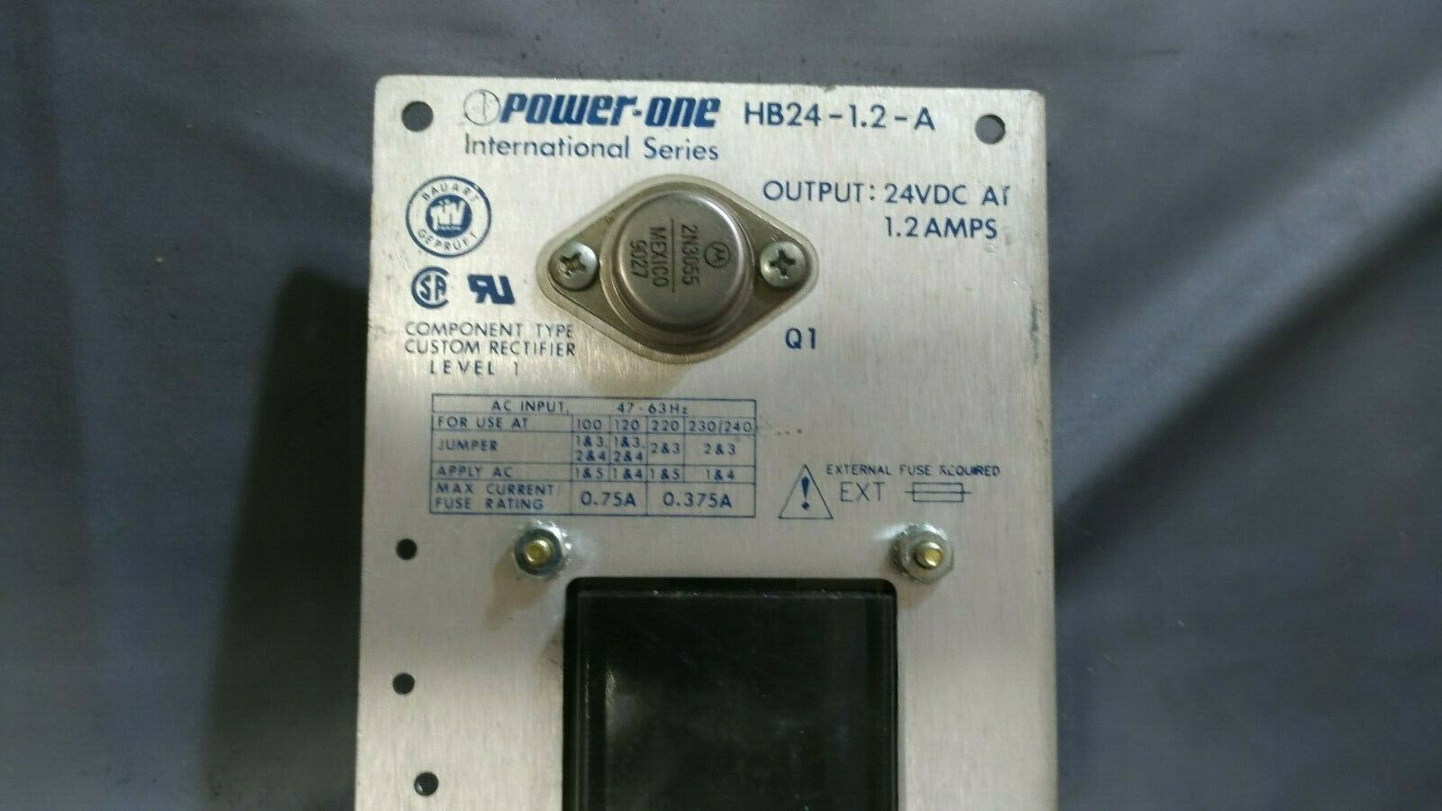

Just curious on this one. For folks using a regulated linear PSU, how close to 24.0v DC are you? I've built a sigma11 for my B1 Korg, but after testing literally 100 12v zener diodes, closest I can get is 23.8 or 23.9v. I'm sure it will be fine, but wondering what others have observed if they are not using a finely adjustable regulator (LM317, etc) or a wall wart that dials in right at 24.0.
It's not critical. Most of these are within about .2V, and the variation
it causes in performance is negligible once you adjust the T7 and T8
voltages for the common values or by THD measurement.
I just used one of these prefab ones. I prefer a linear supply if possible. They can be bought used to new on ebay for $30 to $60.Just curious on this one. For folks using a regulated linear PSU, how close to 24.0v DC are you? I've built a sigma11 for my B1 Korg, but after testing literally 100 12v zener diodes, closest I can get is 23.8 or 23.9v. I'm sure it will be fine, but wondering what others have observed if they are not using a finely adjustable regulator (LM317, etc) or a wall wart that dials in right at 24.0.
It measured spot on at 24V. The spec on ripple noise was 5mV, but I measured it lower than that at 1-2 mV. The final build is silent as far as I can tell with 88DB sensitive speakers. All of the circuit voltages check out quite close to NP's document.
Wonderful -- thank you for the response!
Neat PSU -- I'll check those out.
I have had really good luck with the sigma11 with my Graham Slee phono stage so I wanted to build another one for my B1/Korg. I love how it fits perfectly into the small Hammond case that Amb recommends, so I don't need to make any changes to my existing B1/Korg build.
I've powered the B1/Korg with a wall wart and a LM317 dialed to 24v. Both sound great, but I've been so happy with the preamp that I figured I'd build a high quality dedicated PSU and be done with it.
