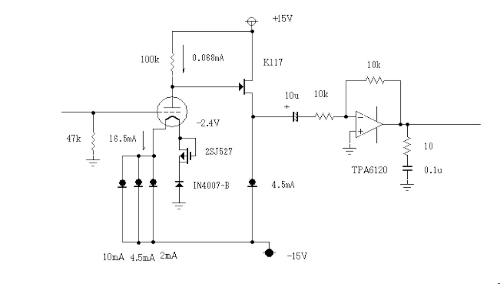

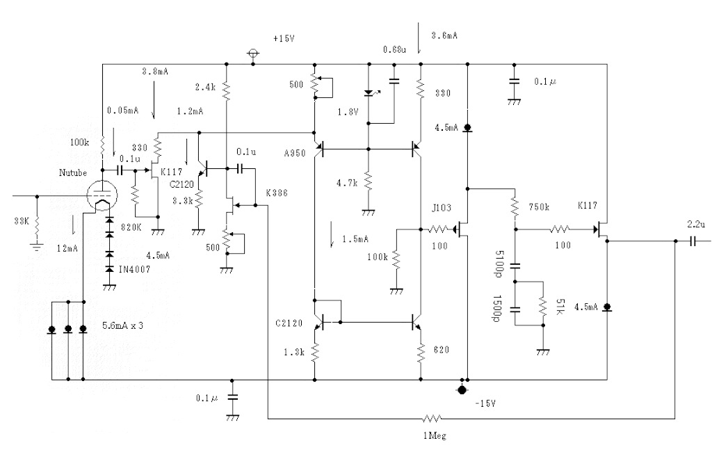

Modification of Cathode subcircuit without capacitor
I was curious about alternative filaments=cathodes circuits.
Diyers example from Japan make something with diodes and transistor.
Could be fun

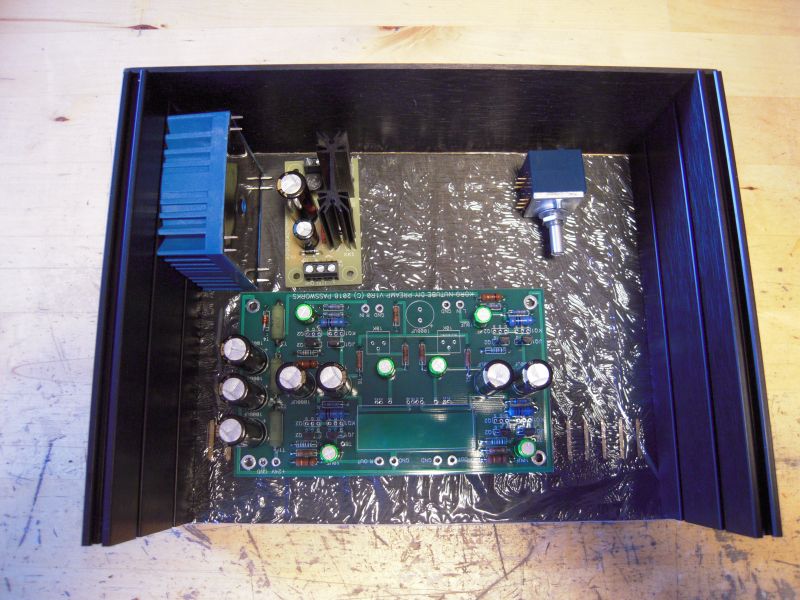

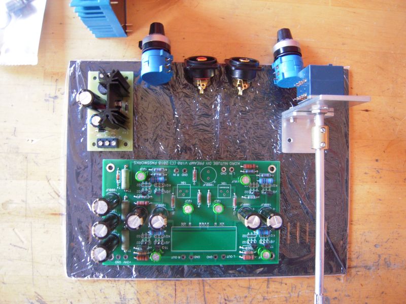

Hello NUTUBE / B1 with KORG TRIODE-builders,
I am still moving around parts in my modushop case -
playing TETRIS with parts - funny!
And waiting for my frontpanel to come back home. It was running away to
SCHAEFFER AG (front panel express in Germany).
If you need your front panel then it decides to make 'vacation' in Berlin....:rofl:
But Dirk is patient...

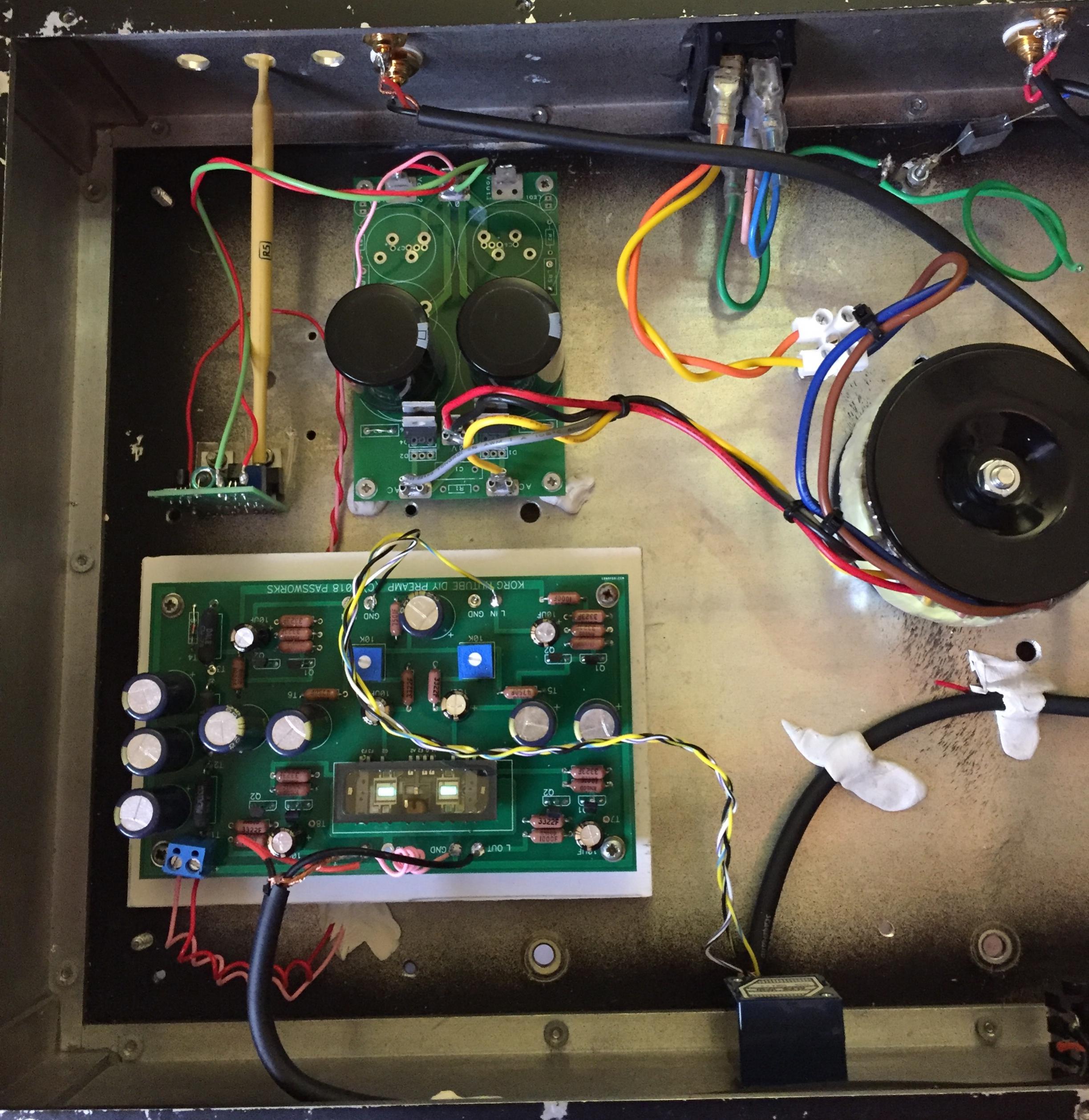

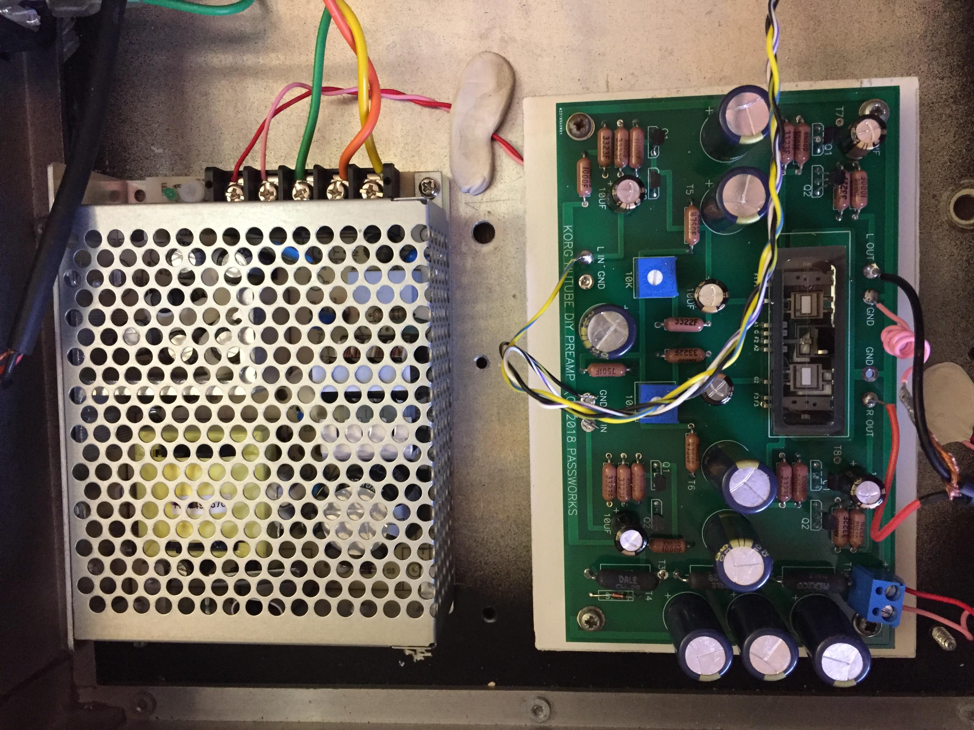

Just putting this out here.... I've been having a play with different PSUs and what effect these have on the presentation.
The MeanWell 75-24 smps is great value for money at 12-15UKP and is easy to implement as there's nothing else to think about as a internal/chassis mount PSU. Almost a plug and play.
A MeanWell wall wart device, didn't try this as I couldn't find one in 24v knocking about in my bins. But I did try a lap top computer type PSU, I have a Chinese 24v supply. 10-15UKP Almost a plug and play.
ALW super reg... now getting on in years but always does a good job in the digital domain. But with this or any other stand alone reg you have to factor in the associated raw supply bits, transformer/rectifier/smoothing cap etc. 80-100UKP. Quite a few hours build time, test, setup and install.
SupperTeddy reg... (I know I know they don't measure well) again now getting on in years but has its fans with Naim pre amp circuits. With this or any other stand alone reg you have to factor in the associated raw supply bits, transformer/rectifier/smoothing cap etc. 80-100UKP. + Quite a few hours build time, test, setup and install. next in test..
I have yet to try my Russ White shunt reg. Like the ALW s/reg quite a few hours build time, test, setup and install. Anyone??
A bog standard 317 or preset reg 7824 type....yet to try this also. Has anyone??
This is on going trial as I like to listen for quite some time before changing to a new reg type.
The winner thus far for me is the MeanWell 75-24 the super regs add a softness to the edges which is OK but for me, to soft.

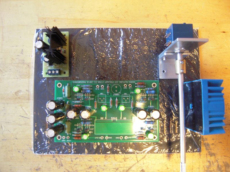

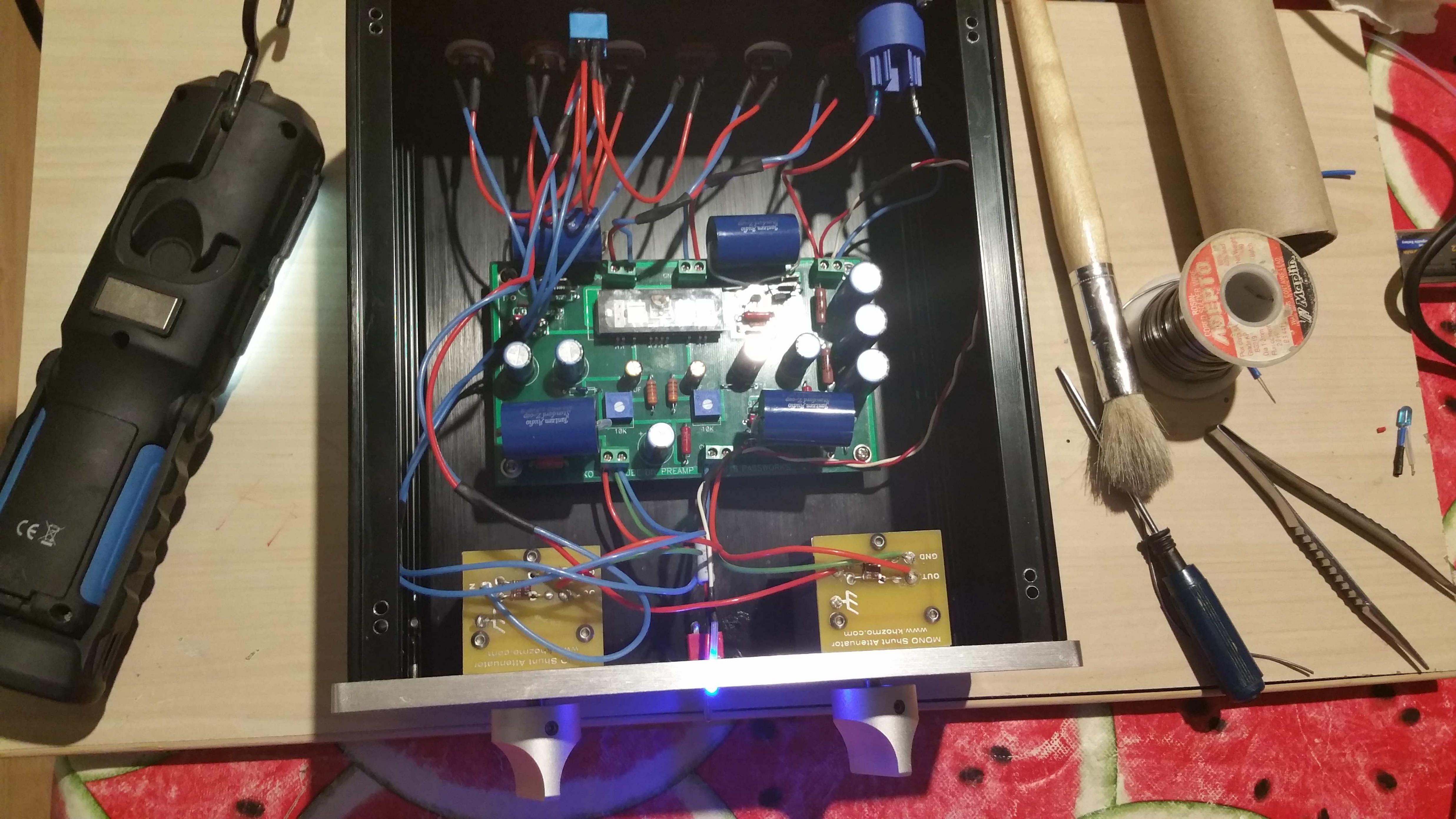

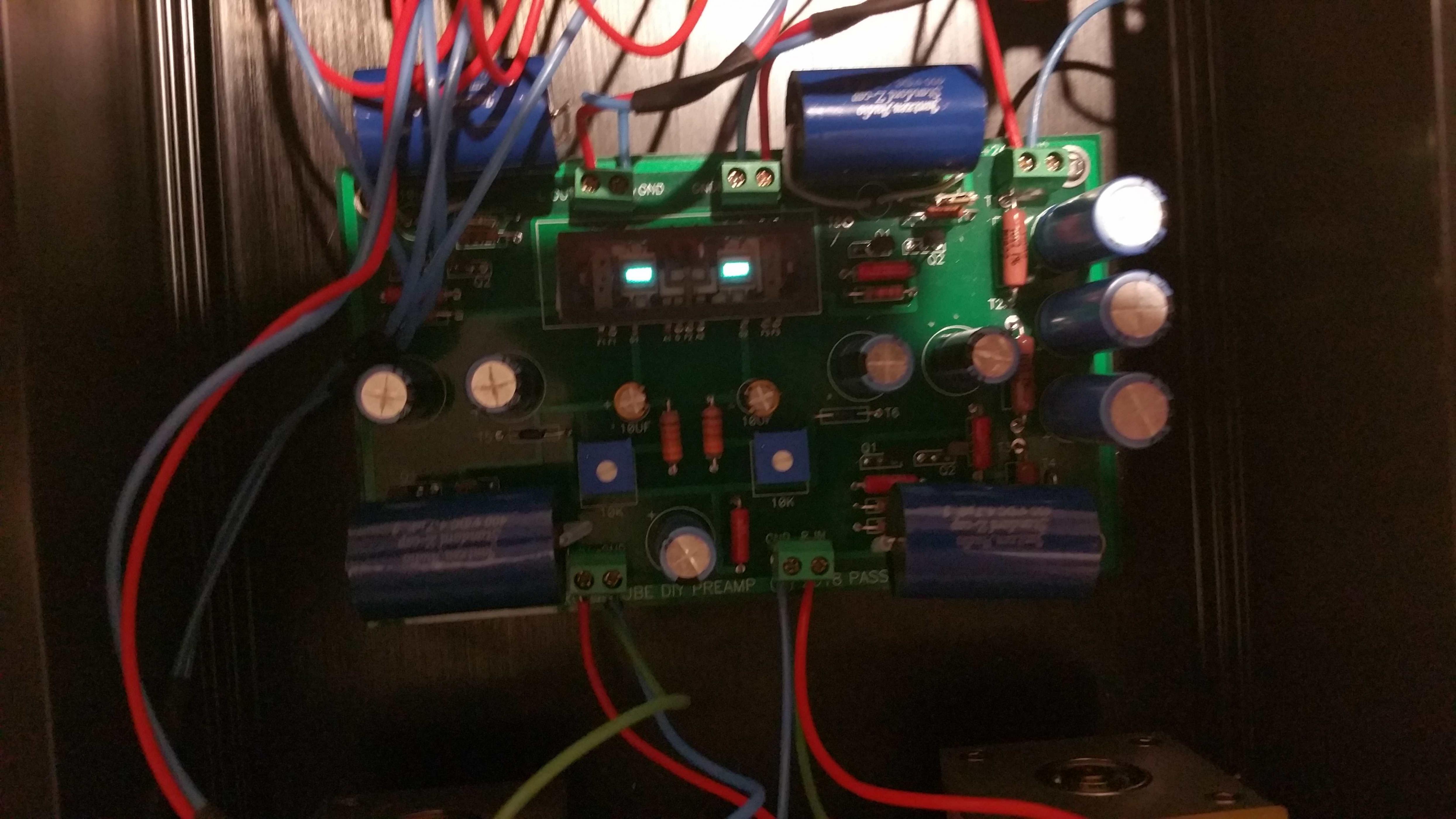

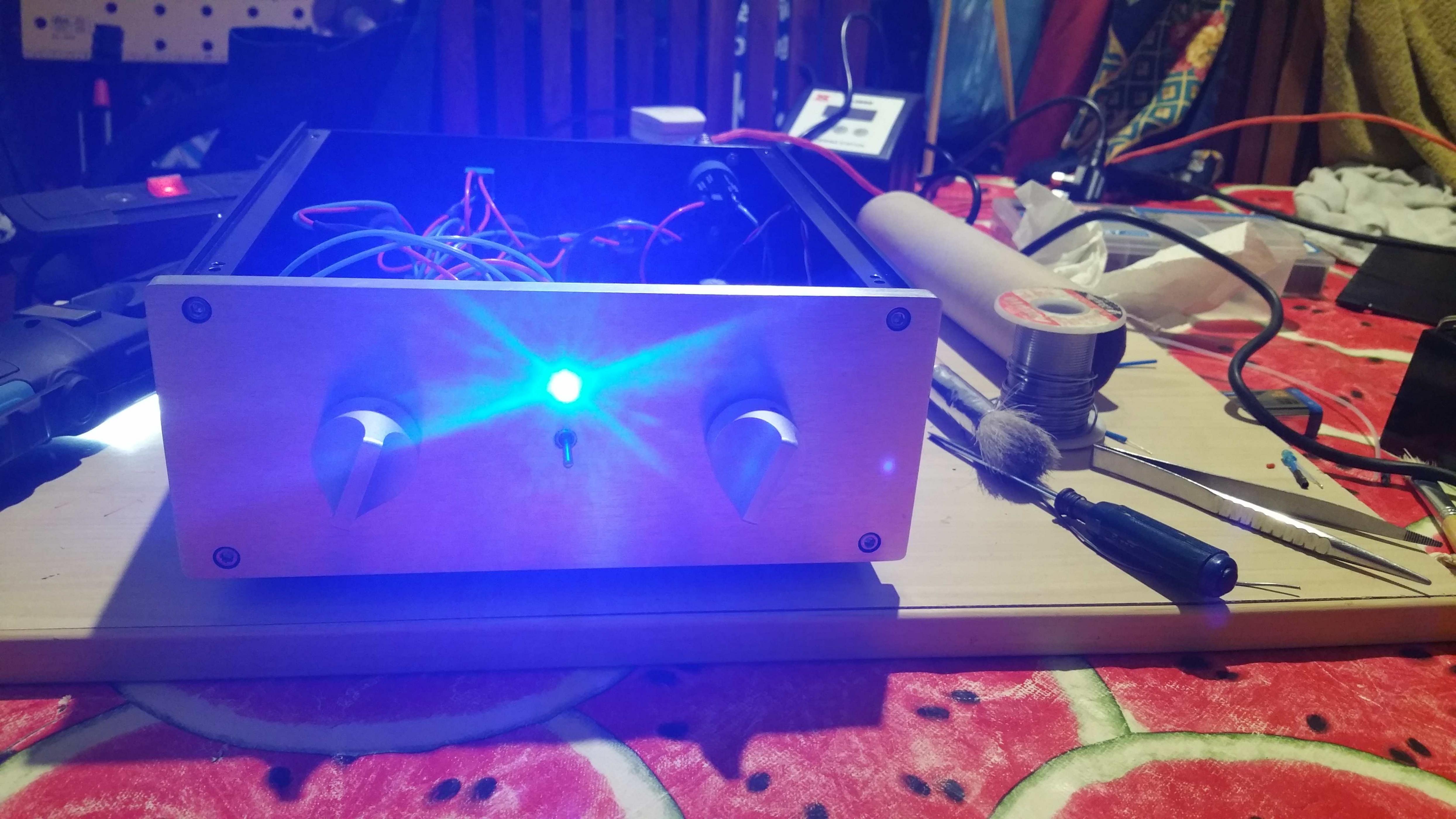

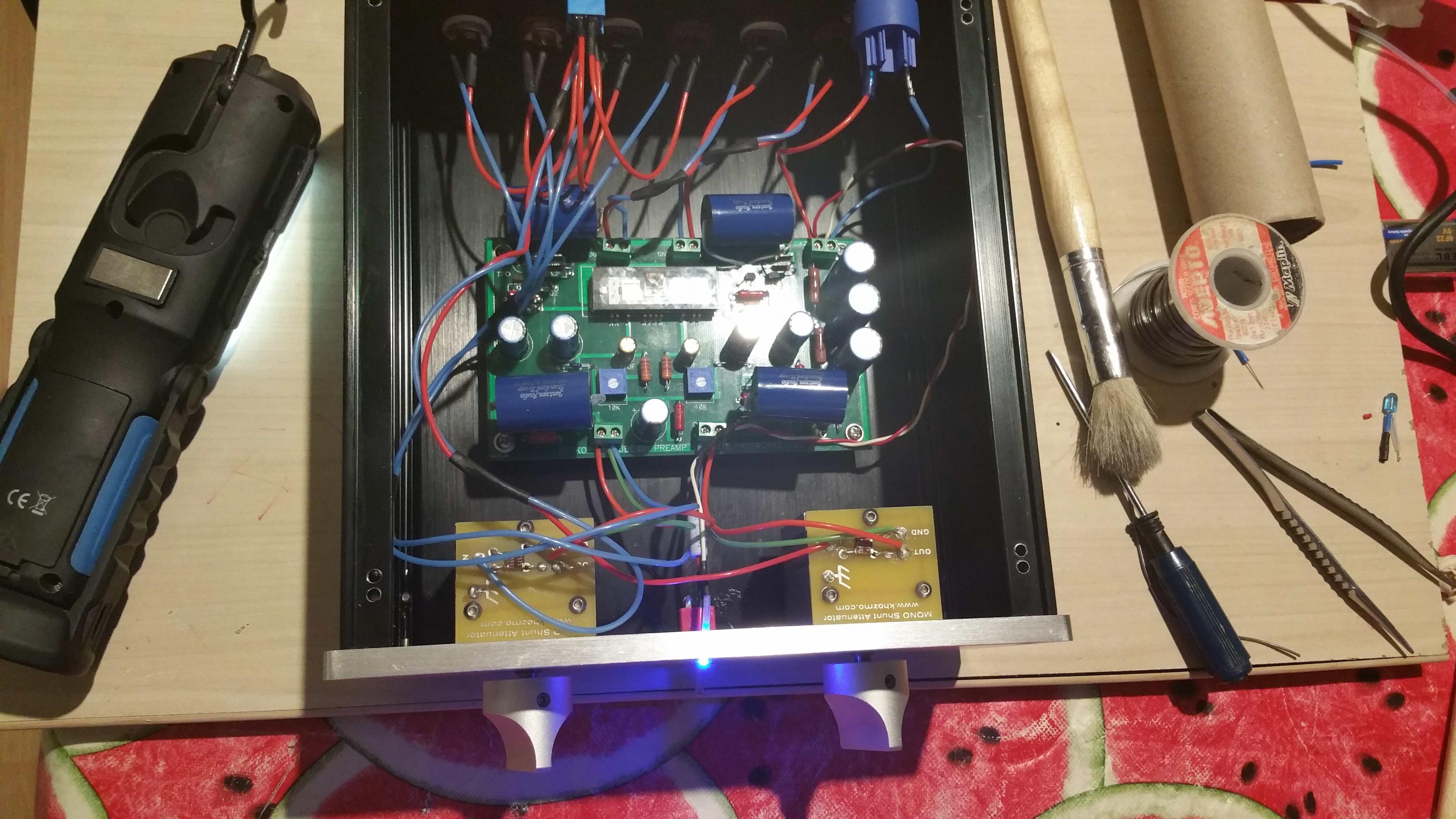

Korg b1 Built
Finished b1 korg today added an led which is a bit bright will play around with the resistor value to get it not so bright.Wiring is a little messy but works as for sound quality feeding the f2j monoblocks iam using informative with plenty of depth sightly warm but very musical sat listening with my wife to some classical music on radio ulster,wife chips in very refined i could listen to this all day..As a classically trained pianist i take any praise from my wife happily.Nelson has done it again anyone who has not tried a korg b1 may be missing out on a superb piece of equipment .I look forward to trying it with my f1j once i get the parts to complete the other channel.Regards Spades.
