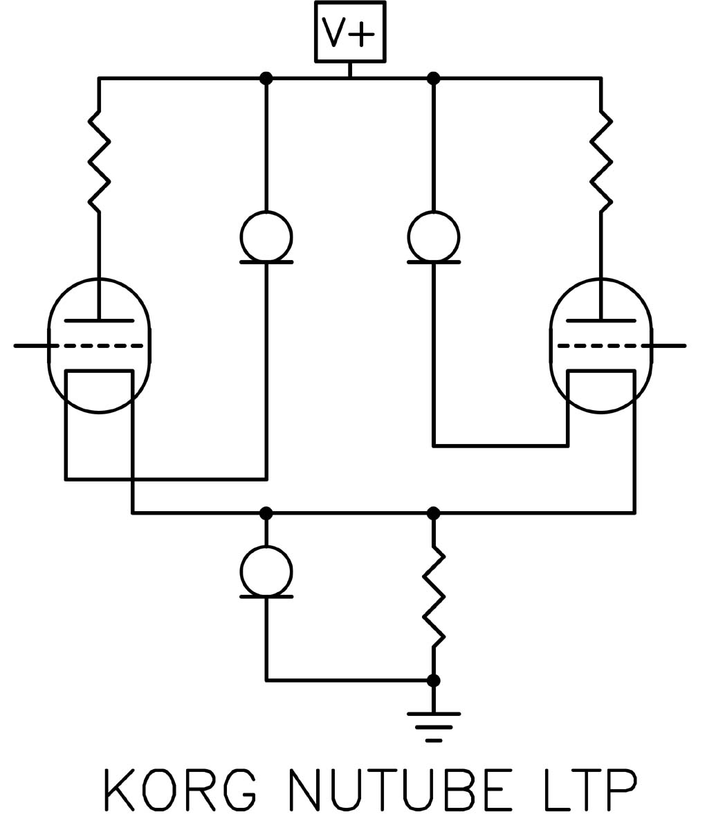

I believe we could make an LTP with the Korg tube(s) if that's what you want,
in fact I think it would be easy using a CCS on the Cathodes.
"LTP" as in Leslie Tube Preamp?
Long Tailed Pair - I guess you knew!!!
I would propose a JFET constant current source.
NuTubes don't have cathodes. You could tie the heaters together, but the heater supply will have to float with very little capacitance to ground. At $50USD each for a NuTube, I think I'll stick with a 12AX7 or 12AT7.

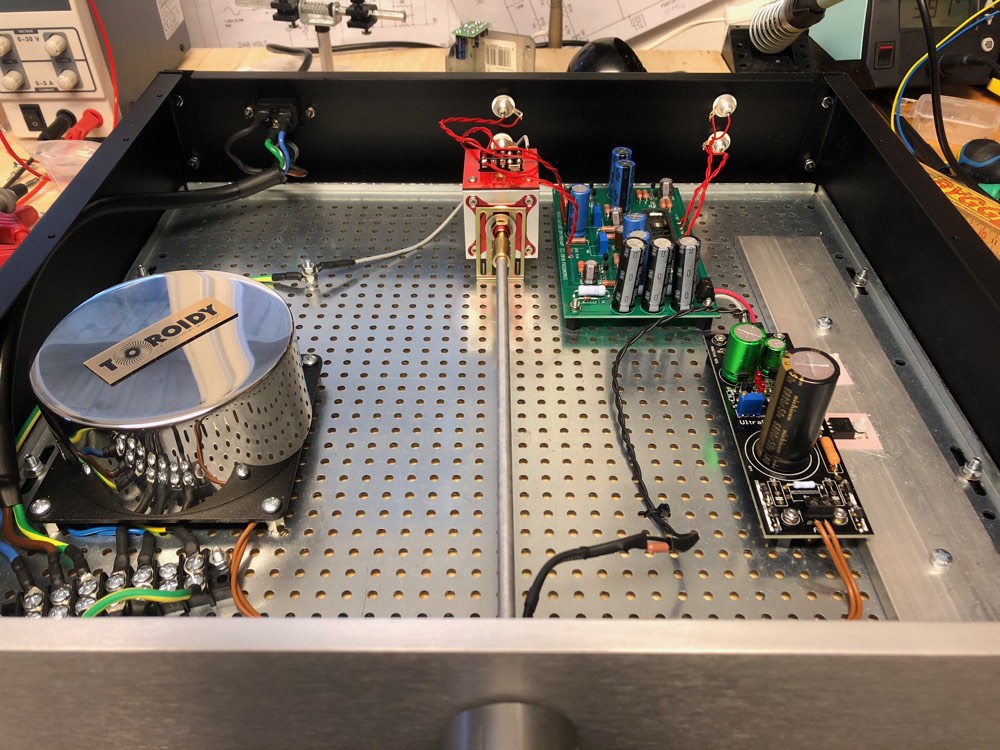

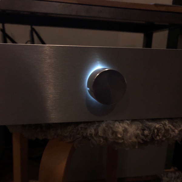

The Korg Nutube in a big box with an awful amount of nothing and some bling-bling. A led hidden behind the volume knob is a tip from someone here but I forgot who should have the credit. Shifting the B1 buffer with 25k Alps pot to B1 Korg triod it’s finally time for sound check. It’s very(!) clear, distinct and pleasant from high to low but with several clicks on the knob a bit hard. It’s fine since I never turn the volume to 11. Perhaps it’s the 10k pot speaking? Tips, tweaks and suggestions are welcome.
Nutube makes its presences when switched off with a slight ringing. No input switch due to the one source, DAC.
- Consider a change of attenuators load resistor to 20k.
- When is it applicable to shift speakers polarity?
- Fantastic base and mid but would like softer treble, perhaps too much gain for my speakers.
Transformer 50VA
Salas ultra bib
XMAS Korg Nutube PCB with 2sk370 (big thanks to Mr Pass(!) and qwertyl)
10k Stepped Attenuator w Z-foil
T1: 24,0V
T5/T6: 0,620/0,618V
T7/T8: 10V/10V
Multibit Gungnir - B1 triod - M2 - Cornwall III
