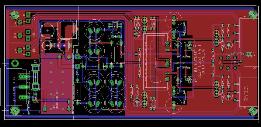

Hi. I'll make myself a pcb for the B1-Nutube, check the picture. It is the Firstwatt circuit, with optional on board power supply using a Meanwell 24V supply and additional CLC filtering, before the original B1 CRC filtering. There are pad on the board to still connect an external dc power supply if you wish. It still support 2 inputs and two separate volume pot.
The PCB size fits the Hammond 1455N2201 chassis.
I can make just one pcb for me, or if there is enough interest I can arrange a small GB. Let me know by private email.
SB
SB
