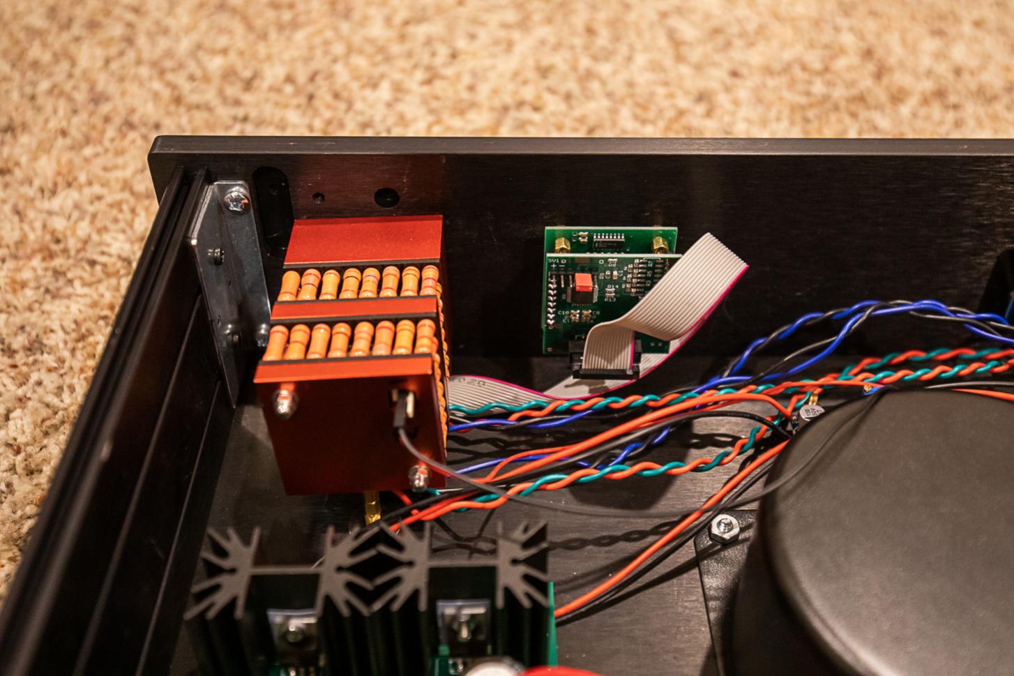

B1 with Korg Triode
The muses pot itself should be installed as a normal pot... no doubt here. Regarding the LED display, I can see from the picture that there are mounting holes on the pcb (at least the 2 that I can see). You can use those with small standoffs as support?
Rewind: as far I can see it’s just a pot, no opamp installed
I was mistaken. There is apparently a attenuation section and a gain section. The Passlabs XP-30 does not use the gain section according to Wayne Colburn.

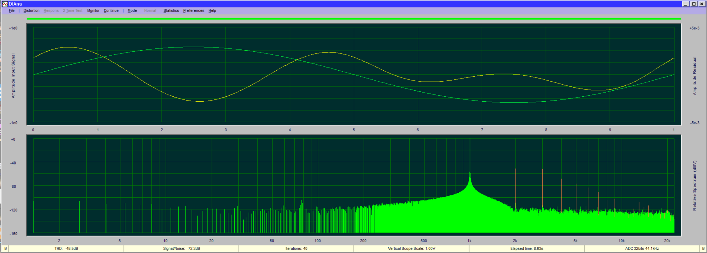

I was able to get Diana working recently and this is one channel of the Nutube preamp at 11.4v.
Can one of you wizards help tell me what this means? I think I know but at the expense of sounding dumb, I'm just going to ask 🙂
Thanks,
Kevin

Hi, if the calibration is correct you have a THD of 0.53% (-45.5dB) @ 0.6Vp (0.42Vrms). The residue and the harmonics show that there ii not second harmonic that predominat. I'm sorry not to be of more help. Also I am interested in know more.
Thanks,
Kevin
BTW - It sounds awesome and I have a couple things to do before I post some pics.
See post 994. It explains which setting yields 2nd harmonic.

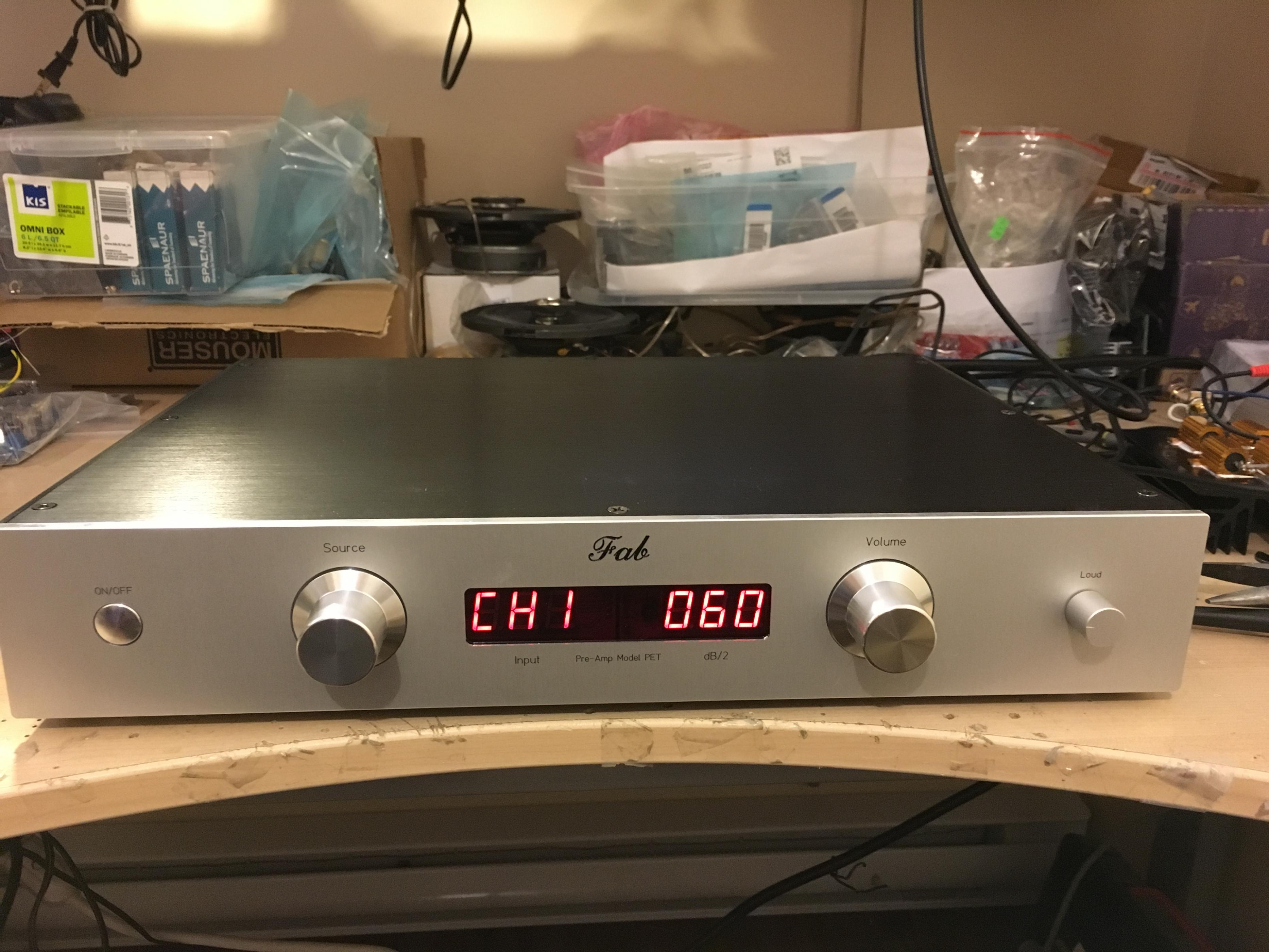

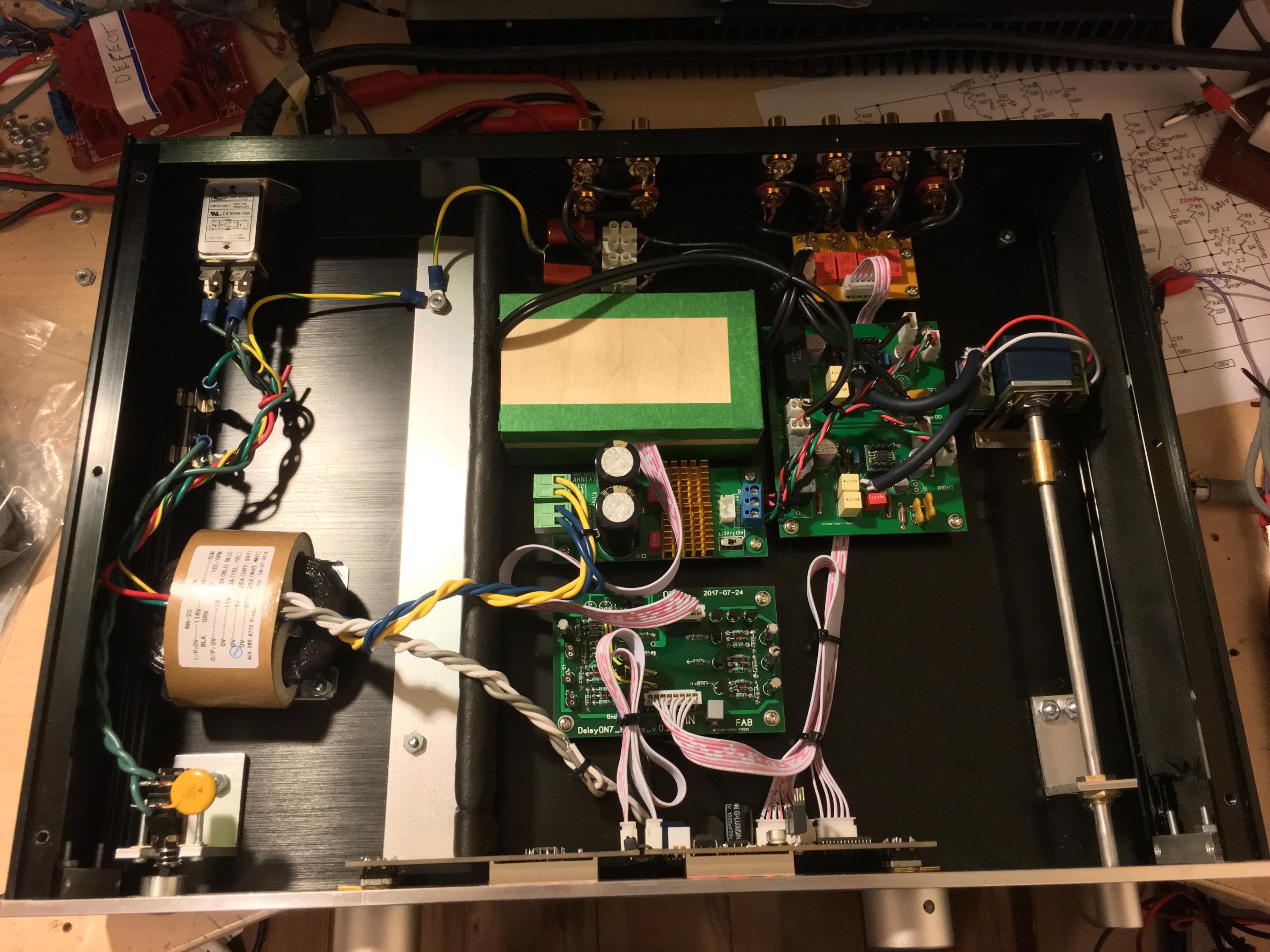

Hi Bassivus
I have built a preamp for a friend using the same kit. It pay attention to a few things:
1) when changing from 64 to 65 dB there could be a high pitch sound while music is playing because there is no delay to prevent relay contact swithcing wrong sequence. Also, happens from 96 to 97 dB and so on....There is a thread on that issue. I could provide a reasonable fix by adding a new board creating delay between relays and preventing all of them at the same time. I have a few spare if you need one.
2) the circuit tends to be sensible to EMI. My friend had an issue with a defective remote control extender (radio wave) where the volume changed by itself.... once he turned off the defective device it has fixed the issue.
3) relay mechanical clicking can be annoying...so I have build a sound isolation cage using damping material inside a wood box.
But the sound is quite good.
Fab

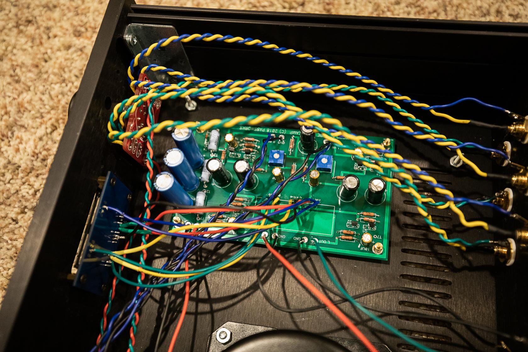

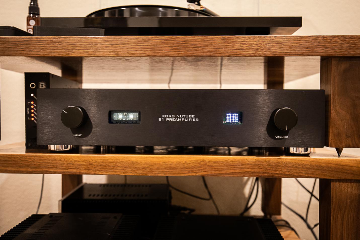

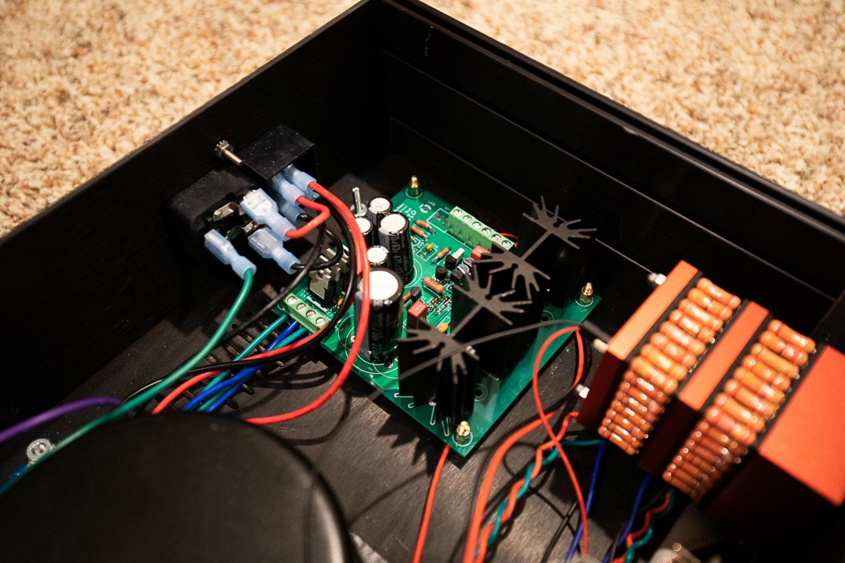

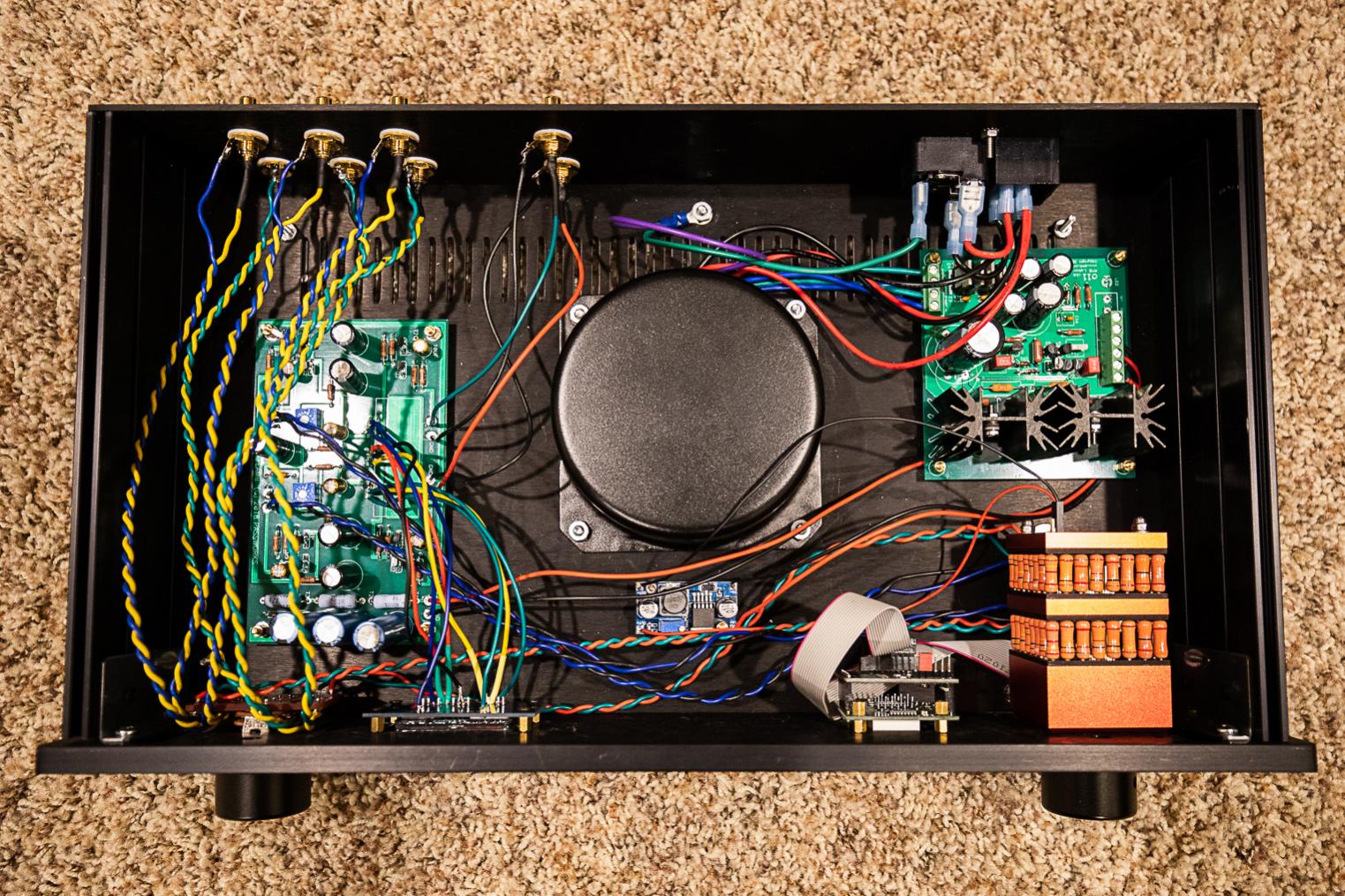

Here are some pics of the final build. I went a little overboard on this one so it's a bit of overkill but I'm sure nobody minds that.
The PSU is a Sigma 11 24v regulated supply.
The volume control is a Khozmo remote controlled attenuator
I got the Nutube and carrier board from Pete Millet
The input selector is the Select-2 from Tubecad
I still need to glue the plexiglass inserts on the front panel but haven't gotten there yet but it will be smoked glass on the front.
A couple things I need to work out - My input selector pops. The other thing is that I have an Intel NUC -> DAC -> preamp and I can hear a slight buzz when the CPU is working. It wasn't there before but now I can hear it. I can't hear it while playing music but can when nothing is playing. Probably some sort of grounding thing.
Anyways, it sounds great. I have it hooked up to an F5 and it makes the bass much stronger (didn't expect that) and almost 3 dimensional but has a slight echo in my ears on the low end.
Thank you Mr. Pass !
Kevin

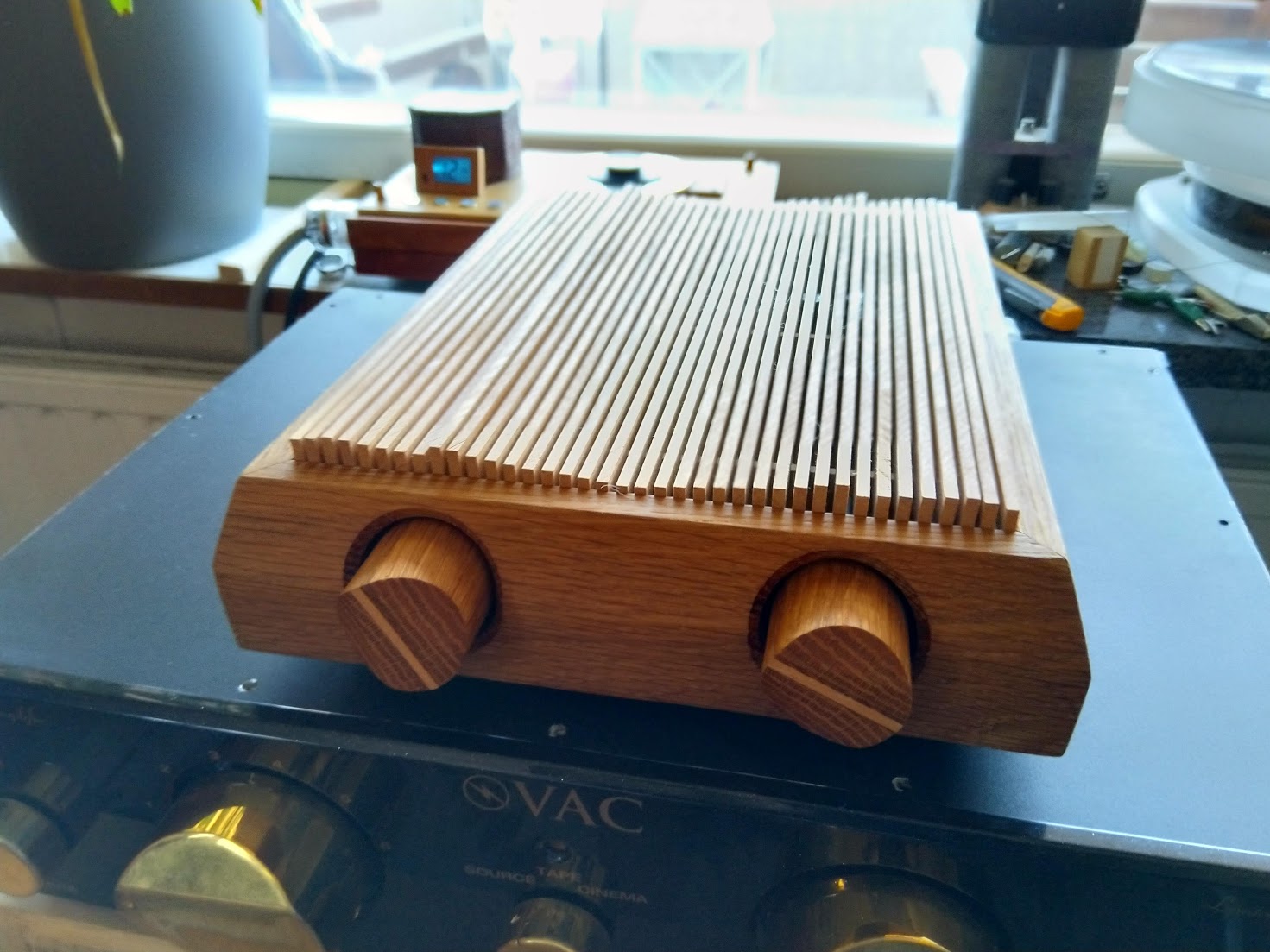

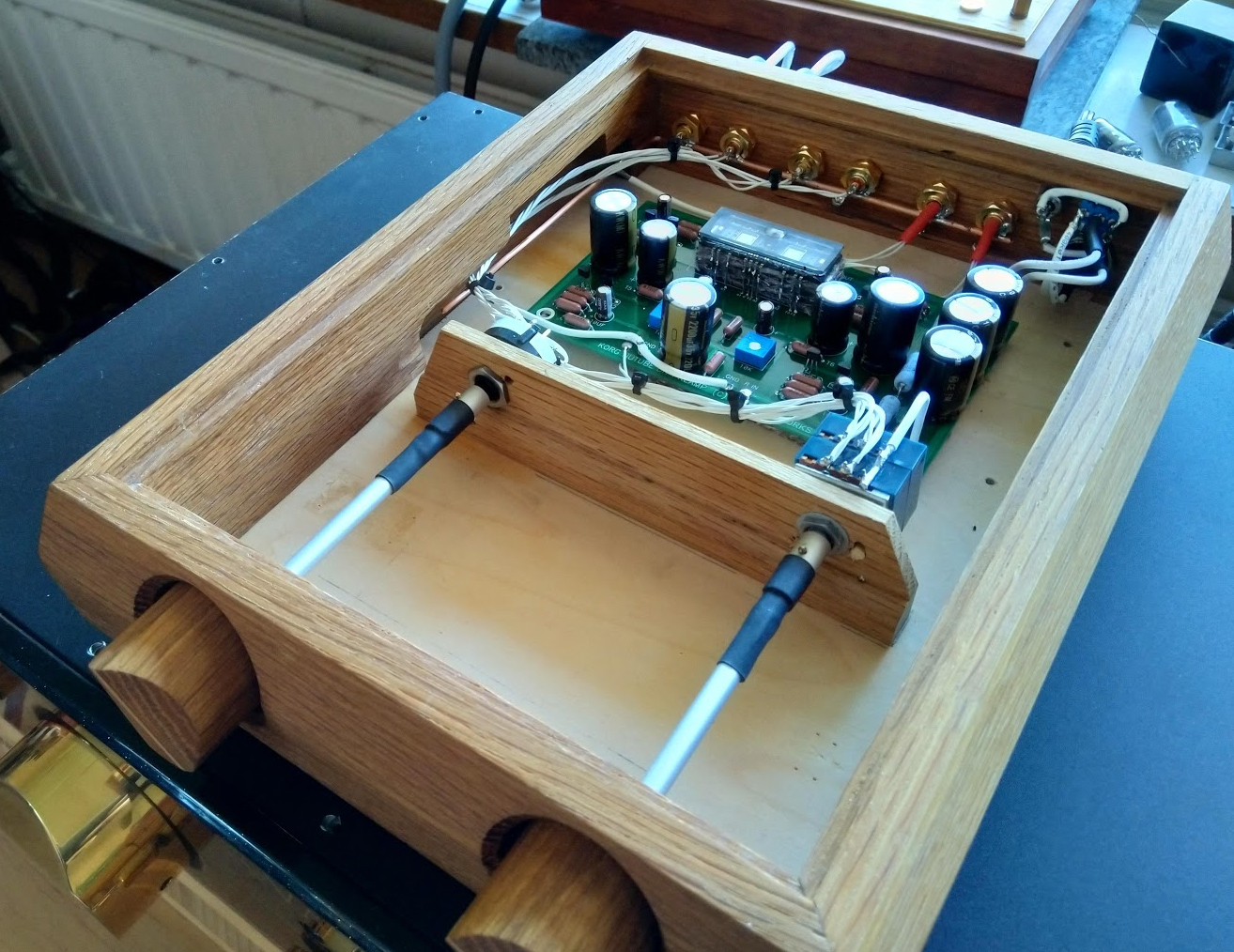

Here is my version. 😀
Does sound very good. Have a VAC (tube) preamp and the sound is very similar - the B1 Nutube maybe being a bit more articulate and having tighter bass. It definitely is in par, even with the basic switching power supply. No critical listening done yet though.
A big thanks, Nelson! :spin:
Oh yes… no ringing here - only if one taps on the Nutube directly. Took Nelsons advice and used hot glue. Lifted the Nutube up a bit and made a kind of a hotglue acustical felt sandwich. Seems to work fine.
And Still.. didn't fasten the pcb to the cassis directly. Also put Felt underneath the PCB and just the wires holdin the PCB in place.
