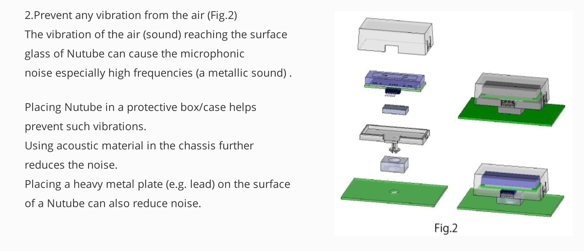

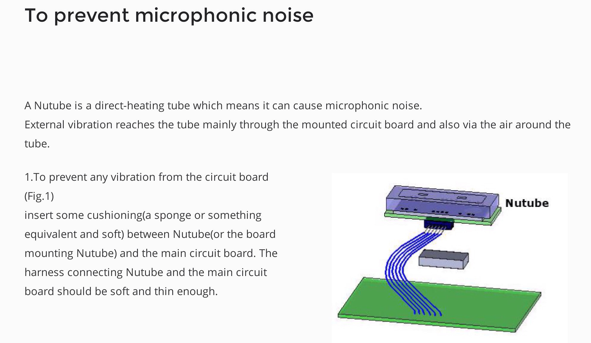

Is the vibration caused by the chassis vibrating or also air pressure from sound?
Chassis vibrating can be solved by making the chassis heavy and well dampened inside. If it is also the air moving caused by sound pressure then the chassis should also be almost airtight?
It can be both. An interface can absorb from both directions i.e. board to chassis and chassis to board. If there is tons of energy from the air directly on the elements of the tube, probably they will sing, but that generally is not the case.
I think I will put small springs on the screw mounts of the PCB alter, as suggested by the contributor who cited Naim gear, and surgical silastic under the board. The silastic is non conducting.
I have been using stuff to isolate other types of microphonic directly heated triode stages using various methods for a while.
Silastic is nice because you can 'see' that the Hz sink of the twanged component is less than 5Hz by finger poke, and you can also 'see' the decay rate of less than a second. The gel also operates 360 degrees. With the energies involved, that is usually adequate.
Pete Millett (USA Nutube distributor) supplies sticky foam with the tubes, as received by the USA participants.
Fancy DACs with fancy crystals often employ orings on the standoffs, or even oring-suspended PCB sections.
Bitumen or similar on sturdy case panels seems like a good idea. Like speaker building.

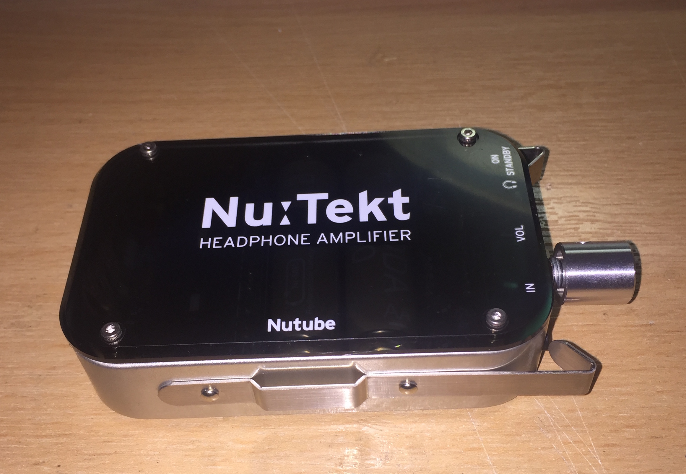

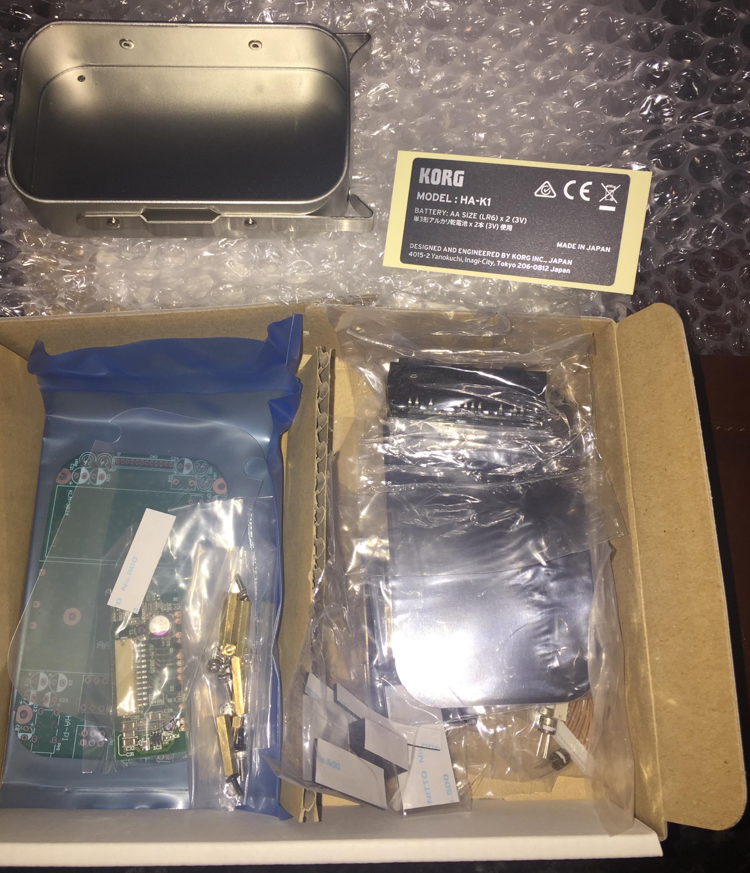

nu tube Headphone amp..
Sorry to intrude with this...bit off topic but I am so impressed with the NP B1 Triode I thought I'd have a go at the Korg HA K1 headphone amp...it really is very good. And absolutely no ringing what so ever. All for a bit of foam in the right places.
