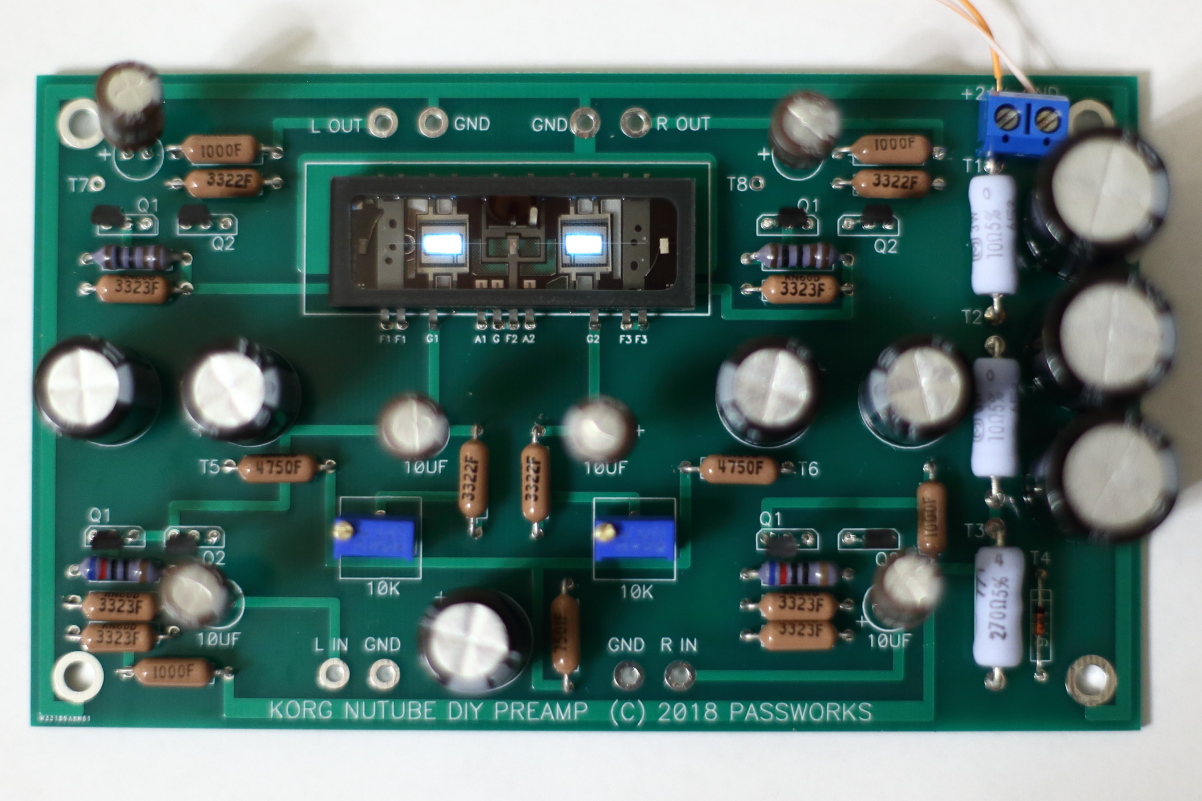

Actually it's an error in the schematic, but it is not consequential.
So just to be clear - the schematic has the error, but the PCB has it right. So no correction needed? 😱
I built mine off the PCB screen print values as it all looked OK (I ignored the schematic/s)
I's an easy build really, populate the PS and check voltages at TP's prior to populating the rest of the board and set up... worked first time and sounds superb.

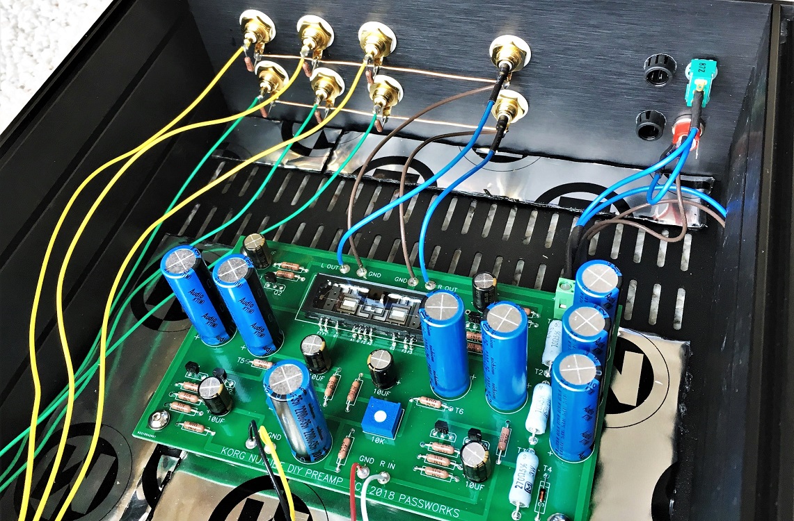

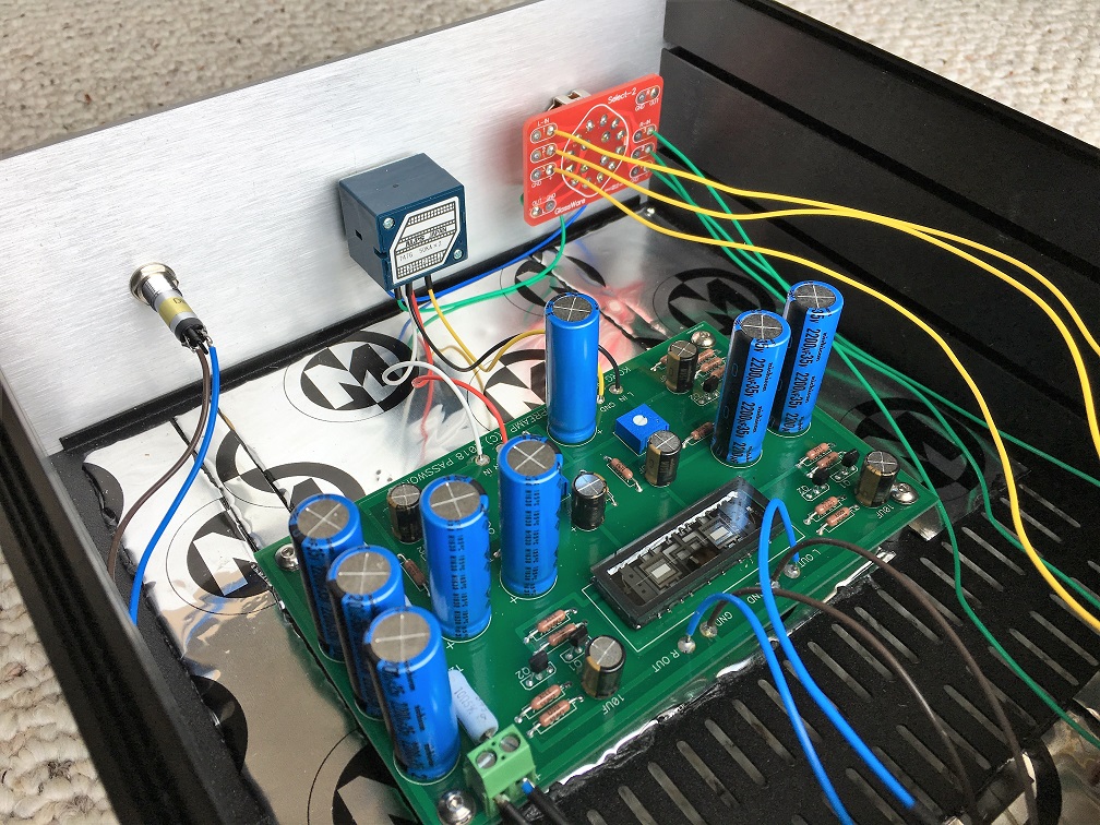

Wired inputs to volume pot, have separate external potentiometer to use for tube bias pots. Prepared PCB alter. Have poly caps for signal path. May change volume pot to better precision later if I can get this to circuit to work.
Figured out how to use oscilloscope to measure power supply. It's spec'd at 5mV Ripple. My little handheld osci goes down to (lowest) 5mv per division and measured 24 V DC perfect, AC at 1mV, which is better than spec.
Question is if the power supply vibrates too much or radiates noxious fields to PCB when mounted. Have silicon gel under PS and a piece to put under PCB when done with loose screw mounts.
Again, this is my first DIY project, so if it succeeds, it will be cool. If not, I guess I can just keep chipping away at it.

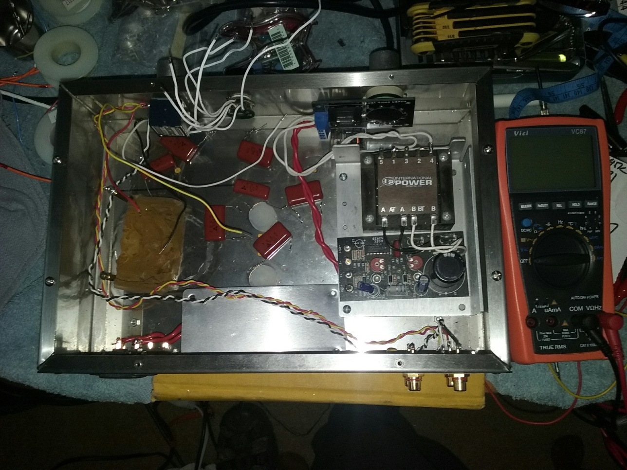

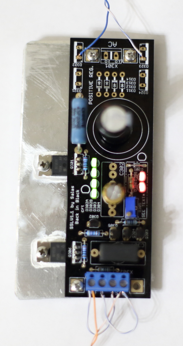

I just finished testing a Salas BiB v1.1 regualtor to use with my Korg build. I picked up a 24v 2A linear plug-in transformer from Jameco a short while ago that puts out 31v unloaded and about 28.5v loaded with the regulator set to 400mA of current delivery. I'll start soldering parts in the Korg PCB tonight. It will have to live for a little while without a chassis...

Because I didn't have that specific power resistor laying around 😉 Right now I'm in "make it work with parts on hand" mode...
no use of burning more than twice load's current in shunt part of reg
more is just useless heat**
and ..... that's speaking World's Greatest Proponent of shunt regs ...... 🙂
**at least when we are dealing with A class load ...... (why even bother with something not being A class , in first place
Pass DIY Addict
Joined 2000
Yep, once it's working, it'll get a more permanent home and I'll dial things down a bit. For now, I just wanted to make it work. No sense making *ALL* of the little black boxes space heaters.

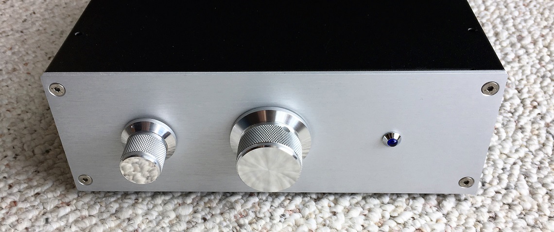

Nice work, it's shaping up really well. Is that a Galaxy case?
Can I ask a newb question?
What are the resistors for between live and ground on the RCA inputs?

Thanks! Yes, the case is a Galaxy 2U with steel covers. The 1 meg resistors on the RCA jacks are to reduce clicks, pops and thumps when switching inputs.
I'm extremely happy with this preamp and it mates very well with my M2x. No rough edges but plenty of extension at both ends of the spectrum with excellent definition and imaging. Oh, and reversing speaker polarity did make a slight improvement on soundstage depth. Thank you Nelson!

I have a working Nutube and PSU now. Still trying to decide what kind of a nice volume pot to use and what type of a case to put it in.
The regulator is a Salas BiB v1.1 biased to about 200mA. After letting it warm up a little and adjusting it to 24.00v, I get the following measurements on the board:
T1=24.00v, T2= 23.3v, T3=22.63v, T4=9.67v, T5=0.704v, T6=0.706v, and T7 & T8 are presently adjusted to 10.0v. It looks like T4, T5, and T6 are reading a bit high.
The CRCRC are 2200uF and the remaining ones are 1,000uF. The signal resistors leading to the first jFet buffer are 620R tantalum left over from a previous project and the signal resistors from the NuTube into the second jFet buffer are 1k tantalum.
Haven't had the chance to listen to anything yet...
