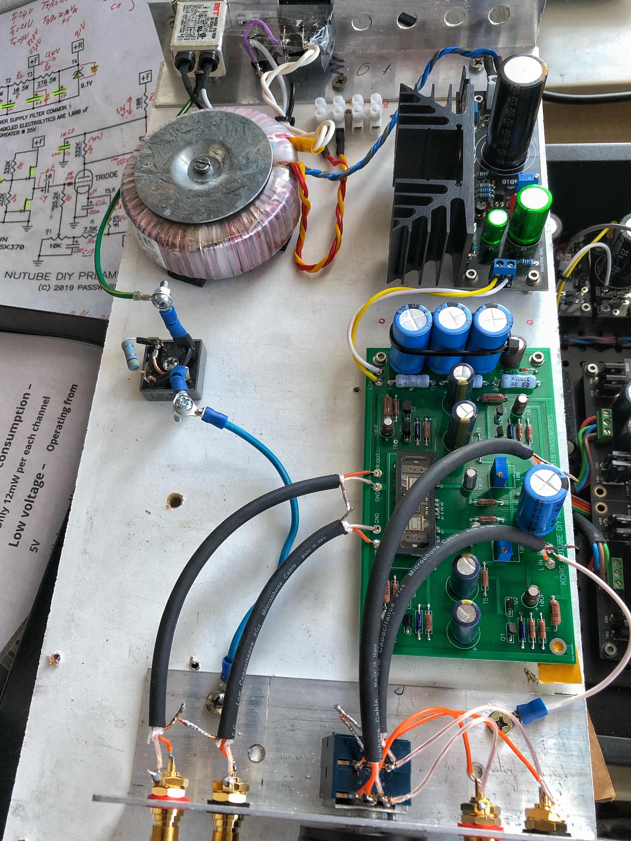

B1 with Korg Triode
Hello WKCox,
is that a vibration dampening mat on your case floor?
(I used that a lot in my 'extreme' car hifi days years ago)
Against microphonic influences / vibrations?
Greets Dirk
Exactly! The steel panels of the enclosure ring like a bell. I bought some damping material from a local autosound store and applied to the bottom and top panels -- very effective in squelching the vibration. It's also very heavy which gives added mass to the total enclosure helping to reduce vibration and microphonics.
I'm interested to know why you (and otheres I see) connect all of the RCA input gronds together and then link them to the output ground.
I was going to ask about the resistor but someone beat me to it 🙂
From past experience, common ground seems to work best in most cases, reducing the possibility of ground loops. I was considering running all input grounds to the selector switch, since it's built to switch both signal and grounds, but decided against it, knowing that would result in switching transients (clicks and pops). Suggest experimentation to find the best approach in any given situation.
Another newb question please - are those tantalums the only resistors in the signal path?
The 1K gate resistors and the 100R output resistors next to the 10uF caps are the ones that are most "directly" in the signal path. Someone will probably correct me here, saying that the resistors to ground are also part of the signal path. Since the gate resistors are mostly there for stability, it is my understanding that their specific values are not critical. Since the signal will be smaller following the volume pot, I used smaller value 620R there and 1K values following the nutube. I didn't have any tantalums that are close to 100R for the outputs. Don't know that I'll actually hear a difference with them, but I had a few laying around from years ago, so I used them here.

Have my Pass B1 nutube running! It certainly deserves a nice chassis later on!
I used an ultrabib PSU I had on hand, nice 3300uf caps laying in the drawer. Lowered the two filtering resistors from 10R to 3R33 because of the shunt PSU. Bypassed the silmic II 10uf caps with mkp1837. PTF for the 1K resistors.
Used a leftover matched 2sk170 set for the output buffer, idss 8.5mA is probably just over the edge.
I have no noticeable ringing issues, it needed proper grounding to eliminate idle noise. My 9.1v zener gives 9.5v which give 0.7v on the heaters.
So overall a very very enjoyable preamp. A keeper...
The soundstage is indeed more upfront which is nice.
Thanks Nelson for your generous offer!, Qwerty for distribution!
