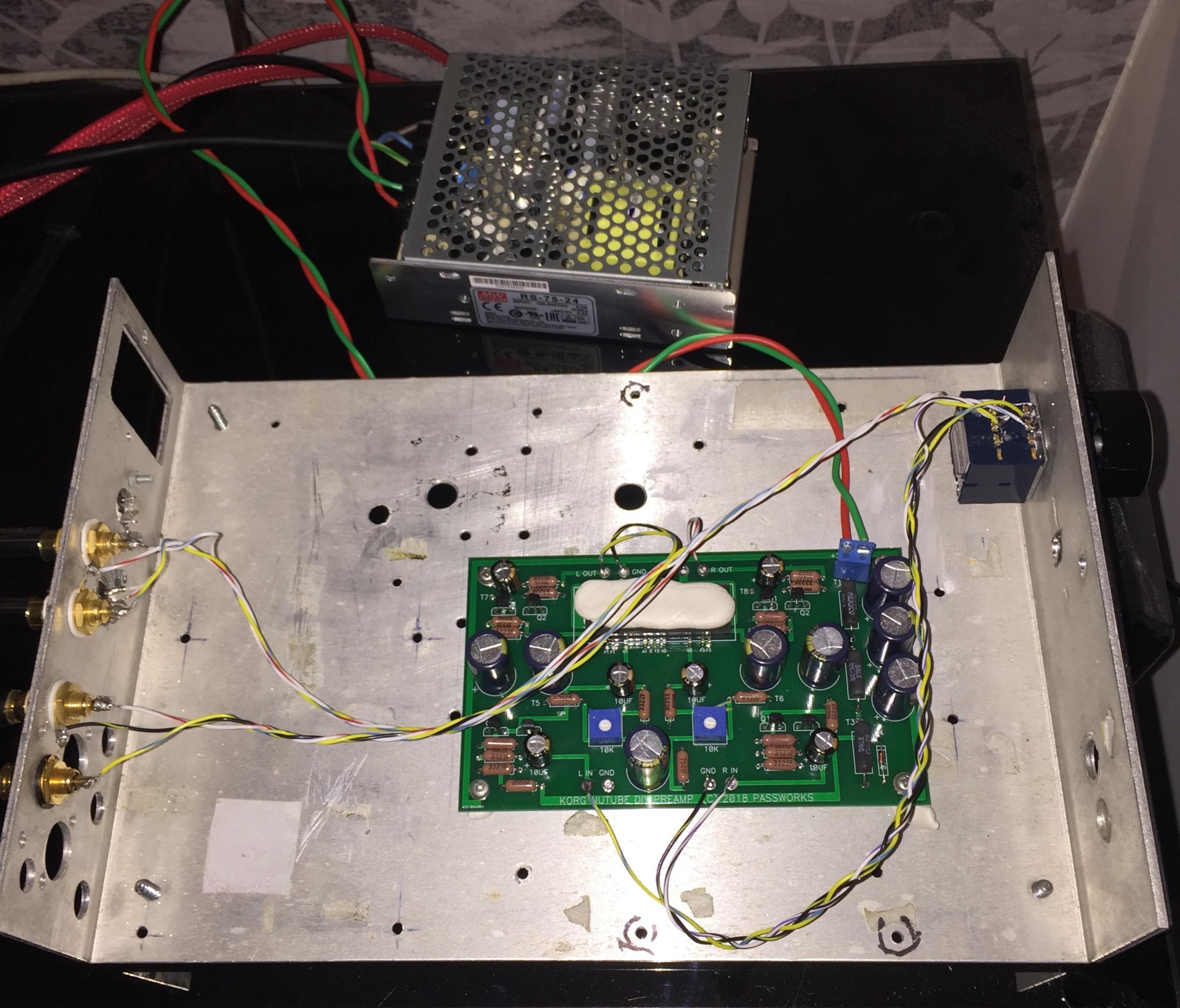

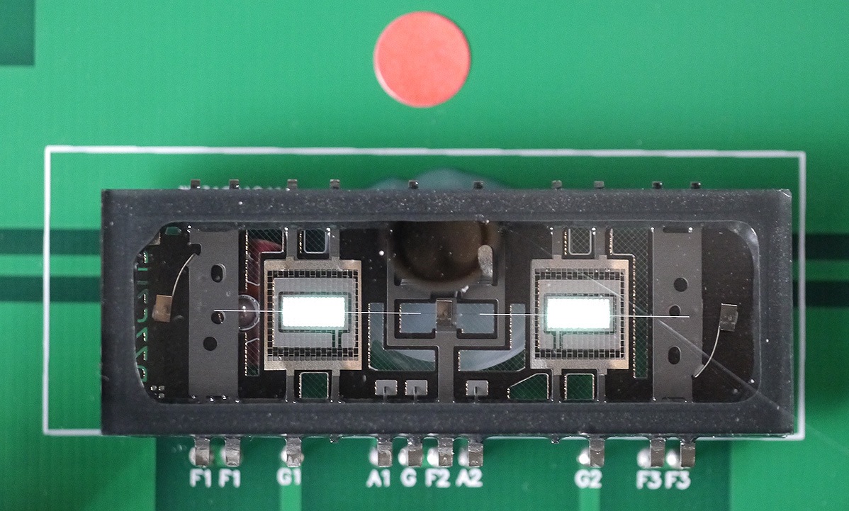

Built into a test bed chassis 'just to see' rather listen...very very nice indeed but I do have an issue with ringing errrr. I have tried double sided foam beneath as per Jim's build notes but Ive had to resort to blue tac under and a slab on top of the nutube though this has cured 90% of the issue at higher vol levels it creeps in..I know the answer is to listen at lower vols levels but.... Any ideas guys.
In addition to the foam, I am going to try use rubber grommets as stand offs rather than metal ones. That may add a little dampening. For my turntables in past years when the floor and rack were too sensitive, I have built an open bottom wooden platform and placed inside it a partially inflated inner tube. Works wonderfully. Of course this unit is so small, but maybe float it on some kind of air filled or gel pad or bubble wrap. It really comes down to devising a vibration absorbing suspension system. Some type of springs under the board may help.

I had zero ringing when I kept the the PCB standoffs relatively loose. Once I tightened them up, the Nutube started ringing when the case jostled — specifically when I pressed the power button or changed the input. Anything that gives the PCB some give should help.

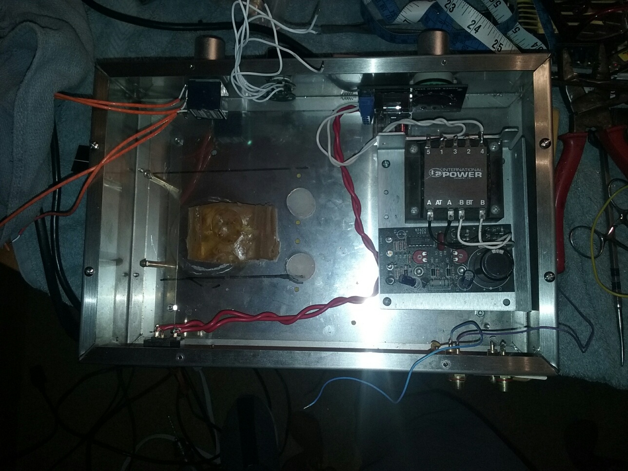

I installed the linear power supply to the chassis and attached it to the fuse/ on-off switch assembly. It measures a perfect 24V DC at the output. AC by a voltmeter drops below the spec'd 5 mV spec, though I think I will attempt to look at it with my little handheld oscilloscope to see how to use that.
I put surgical silicon gel under the transformer and gave it some degree of motion. It wobbles a bit on the gel, so it has some vibration protection. I'll put the same gel under the circuit board when in hand.
