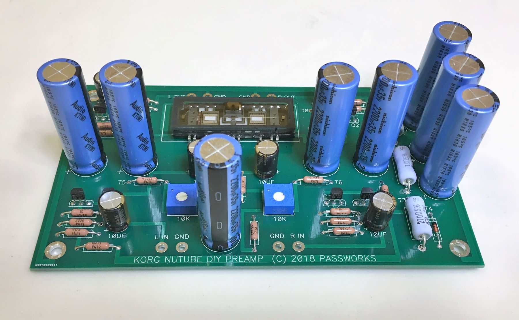

Does anybody have the precise distances for the screw hole mounts on the Pass Xmas board/DIY Store board?
I thought I would drill chassis holes for the board alter in preparation.

See post #381 by Nelson Pass:
“Board is 5.5" x 3.25" mounting holes 5.0" x 2.75"

Has anyone created a BOM yet (not that it is hard making a list from the schematic)? With Mouser part order numbers? Am I lazy or just wanting to conserve futilities?
6L6: I am curious, did you slide the foam pads under the NuTube after you had slipped its pins into the board holes? I noticed that the stickiness factor of them is extreme and was wondering what is the best approach. Lots of pins, which are easily bent, and lots of stickum make for an interesting dance of one's digits.

See post #1268 by Nelson Pass.
http://www.firstwatt.com/pdf/art_diy_nutube_preamp.pdf
His BOM references Digi-Key part numbers.
Following BOM is based on the PCB silk screened values, not the schematic:
Mouser Electronics
Re: Two-sided tape and pins, the NuTube was already installed in the board, floating as it were, about the same thickness of 2 layers of the foam tape. I bent the NuTube up a bit and placed the tape under, on the board, and stuck the NuTube down on it.
