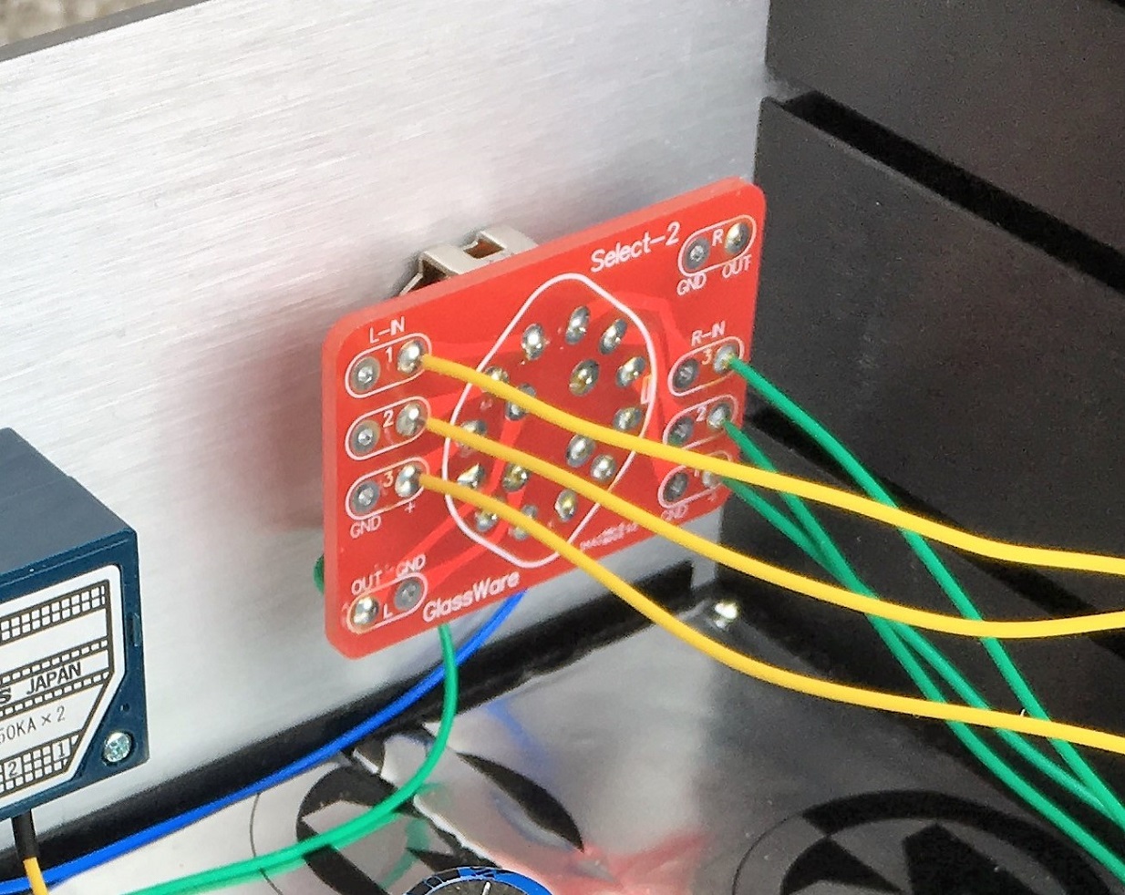

Here are some pics of the final build. I went a little overboard on this one so it's a bit of overkill but I'm sure nobody minds that.
The PSU is a Sigma 11 24v regulated supply.
The volume control is a Khozmo remote controlled attenuator
I got the Nutube and carrier board from Pete Millet
The input selector is the Select-2 from Tubecad
I still need to glue the plexiglass inserts on the front panel but haven't gotten there yet but it will be smoked glass on the front.
A couple things I need to work out - My input selector pops. The other thing is that I have an Intel NUC -> DAC -> preamp and I can hear a slight buzz when the CPU is working. It wasn't there before but now I can hear it. I can't hear it while playing music but can when nothing is playing. Probably some sort of grounding thing.
Anyways, it sounds great. I have it hooked up to an F5 and it makes the bass much stronger (didn't expect that) and almost 3 dimensional but has a slight echo in my ears on the low end.
Thank you Mr. Pass !
Kevin

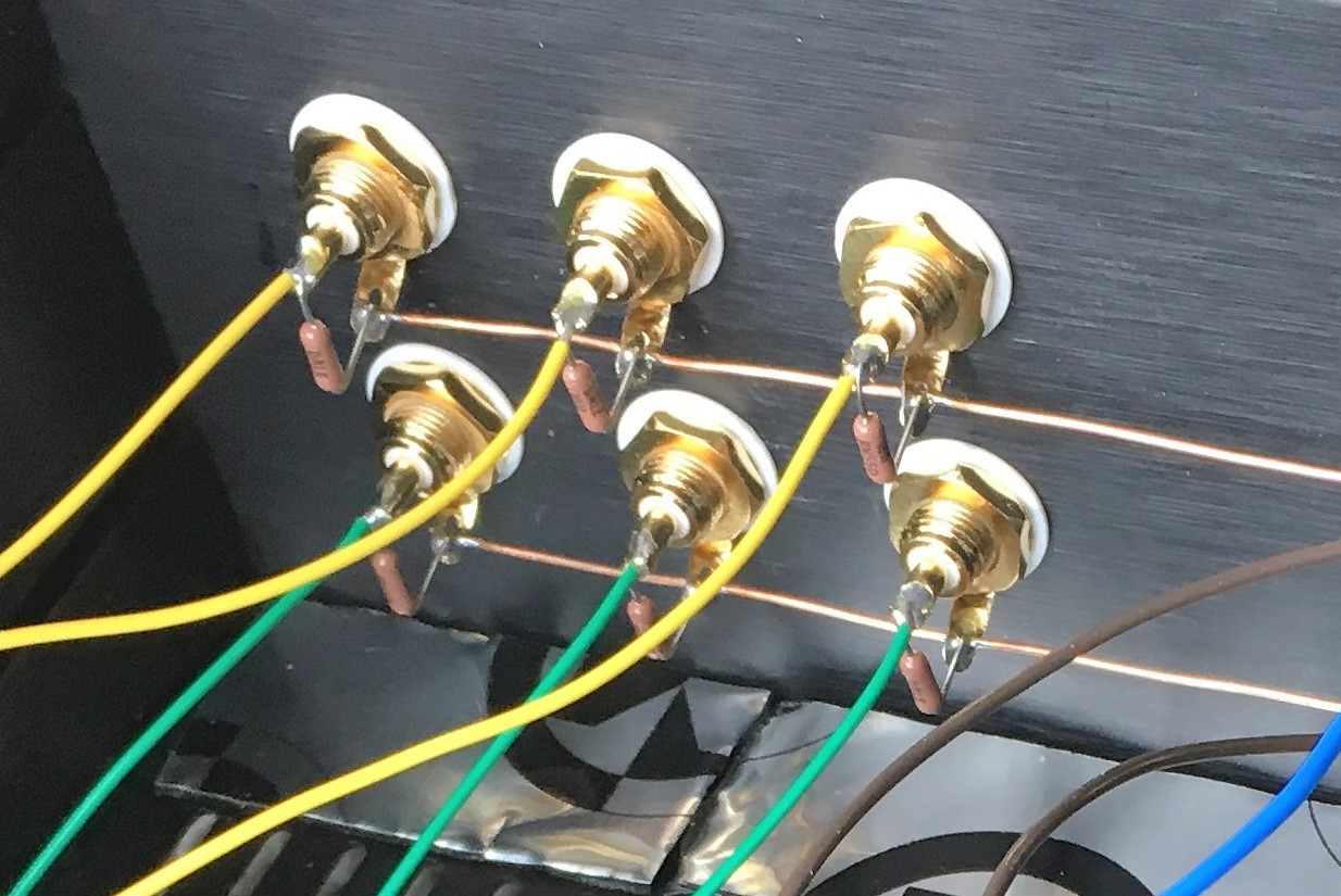

Nelson addressed the input selection pop on the original B1 by adding 1 megohm resistors across each input. Like you, I too used the Glass-Ware Select-2 but decided to tie all the input grounds together, rather than switching grounds individually, and adding the 1 meg resistors to avoid the pop.
Just turn down the volume before changing inputs and everything should be great. 😛
Enjoy!

A Lorin Electronics silver plated contact switch. Something like this: CK – Lorlin Electronics
Nice build Kevin!
Enjoy!
just use shorting one (Make Before Break) and no PoP
trick old as Earth
each Lorlin , if shorting , is having big letter S somewhere between pins
read datasheet for more specific info about S and non-S

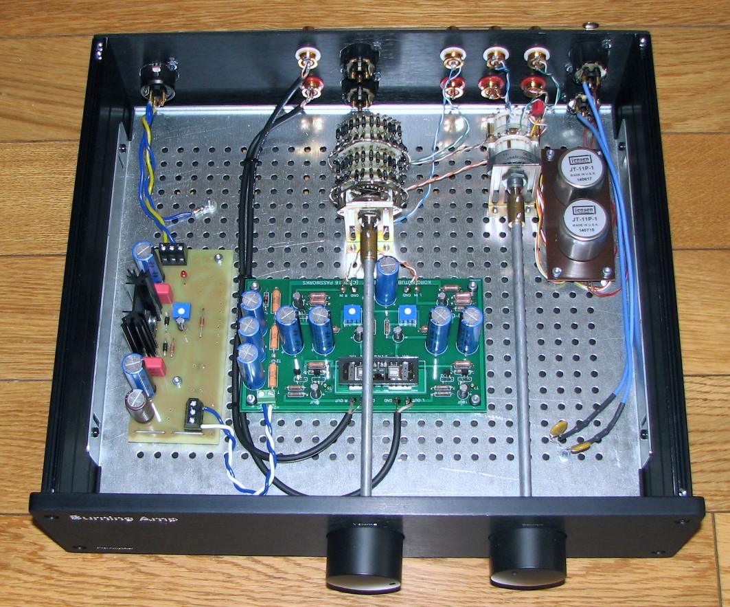

Tell us more about those Jensen transformers. Is it really a good idea? Is the goal to make them balanced? Is this the best way to do it?
Jensen transformers... It's a long story. Ages ago I built 2 F4s and I was planning to use them as mono blocks driven by Impasse preamp. I started collecting parts, bought Jensen transformers, etc, but then I converted one of my F4s into Aleph J. I used balanced output of my DAC to drive Aleph directly. The second F4 was converted to BA-3 power amp and I built BA-3 preamp in a separate chassis. I had an idea to use Jensen transformers, which were gathering dust for a few years, as balanced to unbalanced converters on the input of my BA-3 preamp. It worked fine, but then I converted BA-3 power amp into Sony VFET. And so on and on and on... What used to be BA-3 preamp is now B1 Korg preamp. Jensen transformers are still there, and they probably work fine as balanced to unbalanced converters, but I don't use XLR connectors at the moment.
