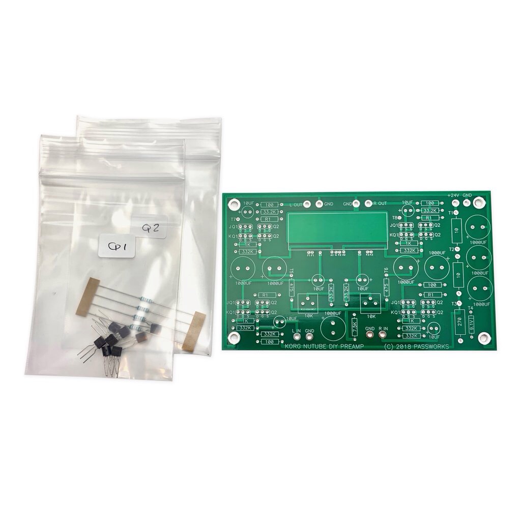

Does anyone have any recommendations for how best to jury-rig a simple socket for the Nutube that works well with the B1 PCB? There don't appear to be any commercial sockets for the Nutube.
(I know it has a phenomenally long life, but if one tube turns out to be excessively microphonic it would be nice to be able to easily swap it out.)

OK, I got it. Grand traditional Toshibas in the K slots and R1 is shorted with a wire if you can obtain the unobtanium in matched pairs.
The kit Fairchilds are specific, different Q1 and Q2 for the J slots and the included R1 resistors are necessary.
I have to make sure I plug those suckers into the right slots.
