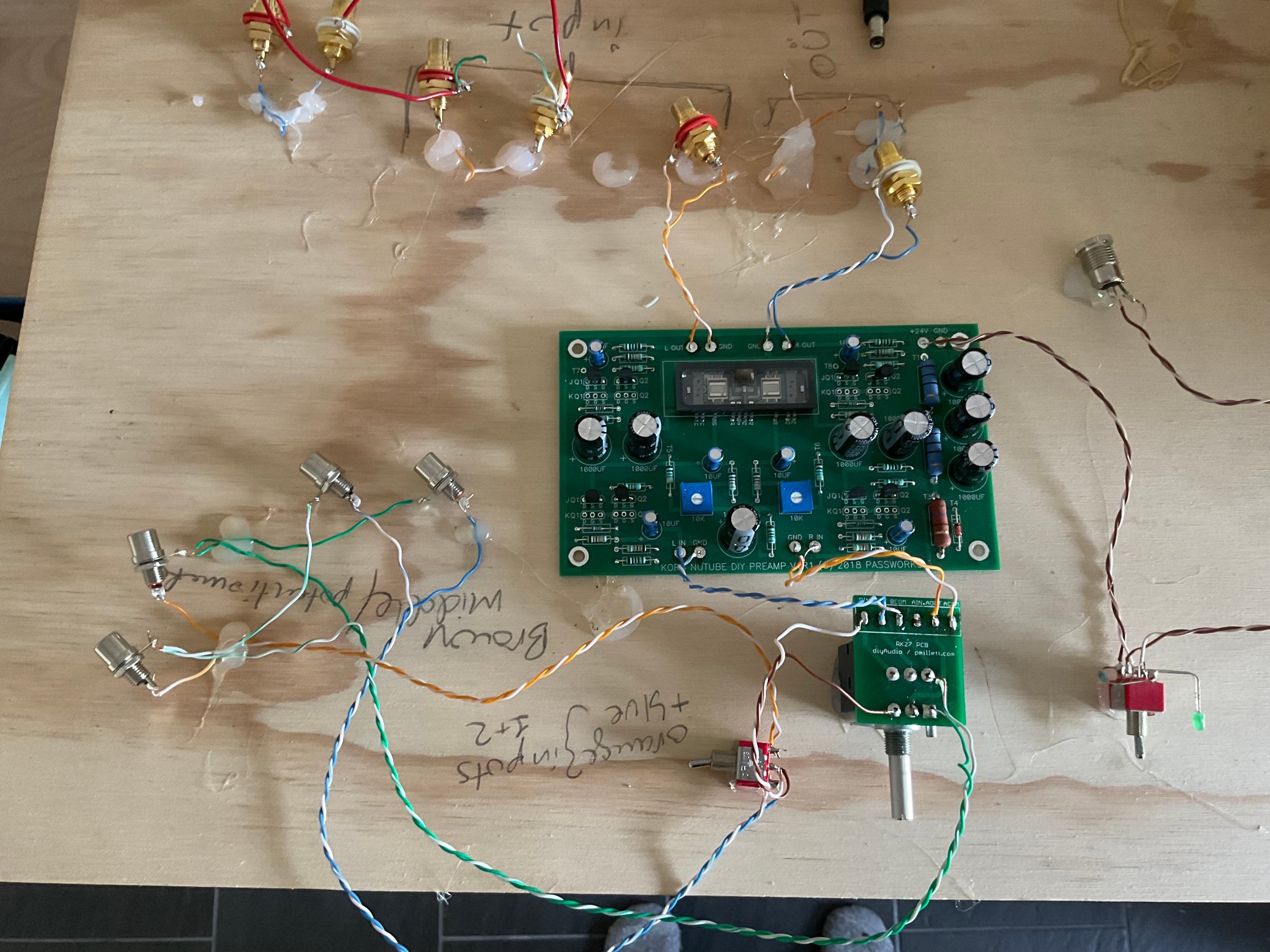

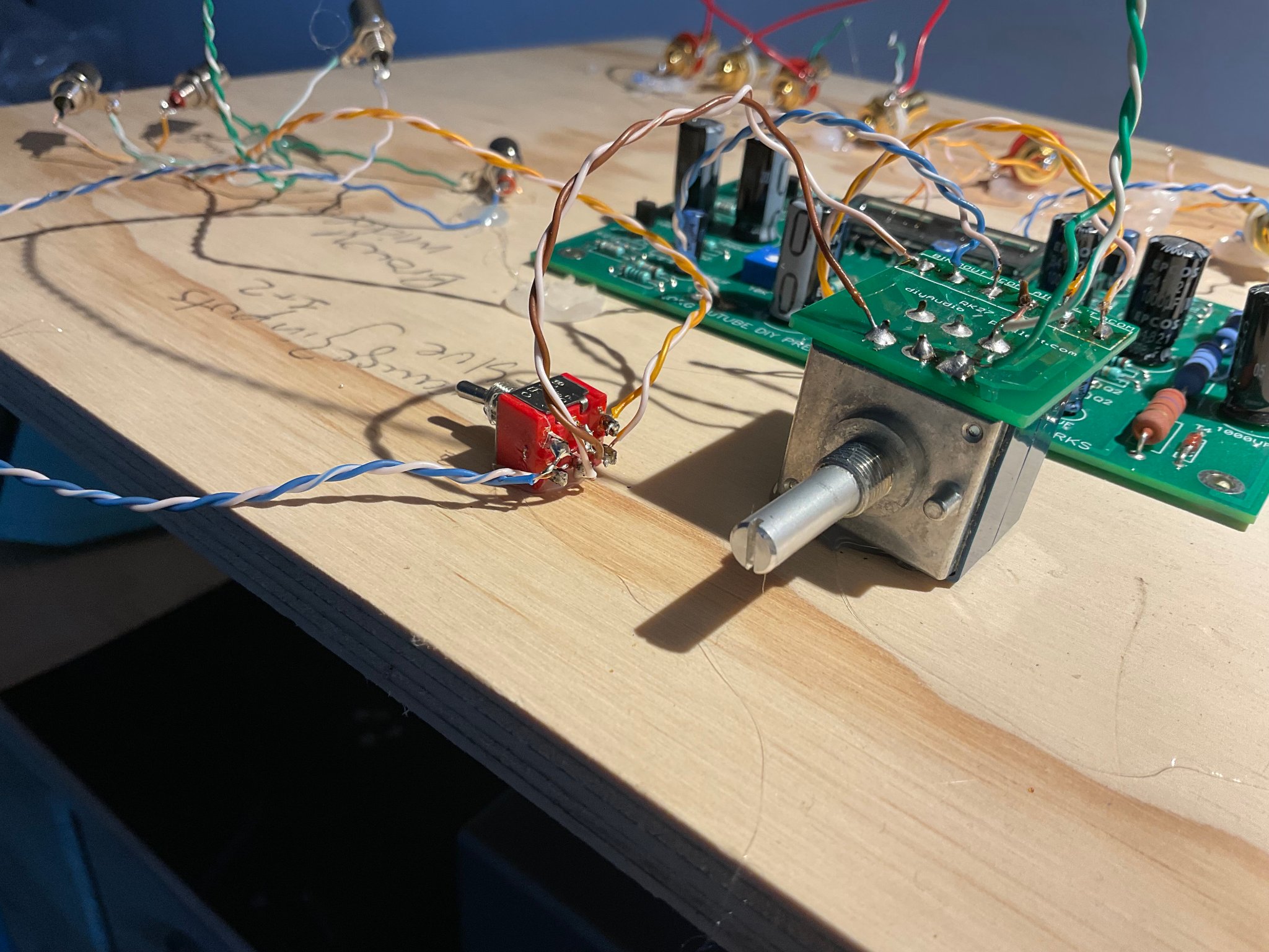

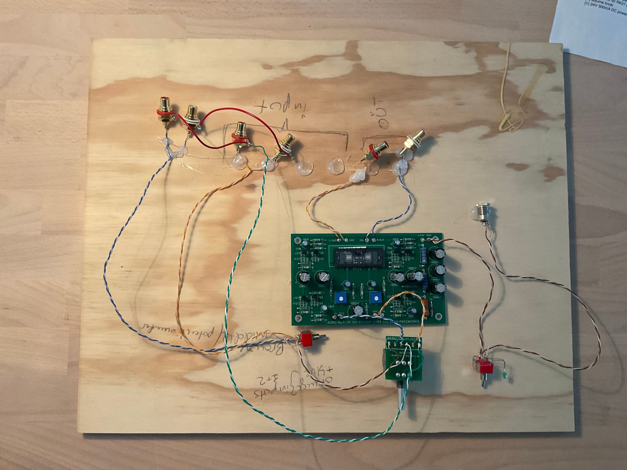

pics? sure, pictures attached in the below. I usually assemble on a wooden board first and the transfer to housing. I have (re)-checked that all components are mounted where they should and simply can not find the error. The problem remains: no sound from either channel except humming. humming can be adjusted with the potentiometer. Any advice is GREATLY apprechiated!

Perhaps you have a problem with the wiring of the input RCAs to the input selector to the volume pot.
Double check that wiring.
Post detailed pictures of the RCA wiring, the input selector switch wiring, and the volume pot wiring. Show closeup shots of all of the solder connections, with all wiring connections visible.

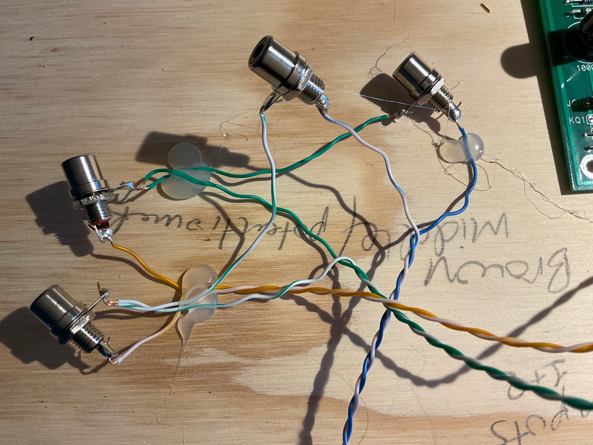

I think that I see potential problem with the input RCA jacks. With each jack, I am noticing that the ground tab connector is between the plastic washers. If, just by chance the washers have a shoulder to them, then this means that those tabs are NOT in contact with the ground, and that tab should be under the mounting nut just to be sure of this important contact. Sure would explain the hum.

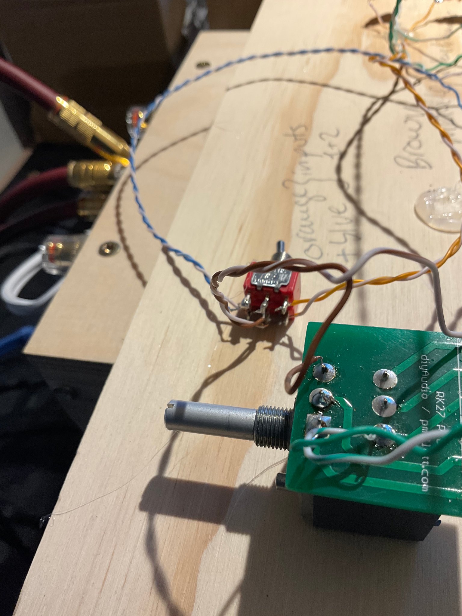

THANK YOU-- I checked the wireing and all seemed good- as suggested by Ixnay the hum problem was the washers - I did not know that that could have eben the problem andreplaced them "just to see" - now the hum is gone and it plays....... from one channel (music comes out from one speaker)....ha ha, oh man..... however when I disconnect the output cable from the RCA that works, sound appears from the other speaker....ay..... I assume this means (?) that some of the wireing must be wrong. I looked at the PCB for the potentiometer and did not see a clear connection from the "Ain" pin and moved the cable to the potentiometer instead-- did not help...im not smart enough to figure out how this works.....but its good fun! can anyone figure out what could be wrong based on this?

You are welcome. I make mistakes like this very often. Let's go back to the RCA input jacks again. On one of them, I see what appears to be an input wire unintentionally touching the ground. It may be something else, dunno. If there is no problem there, then we can move on to the selector switch.
Reactions: Haze Head

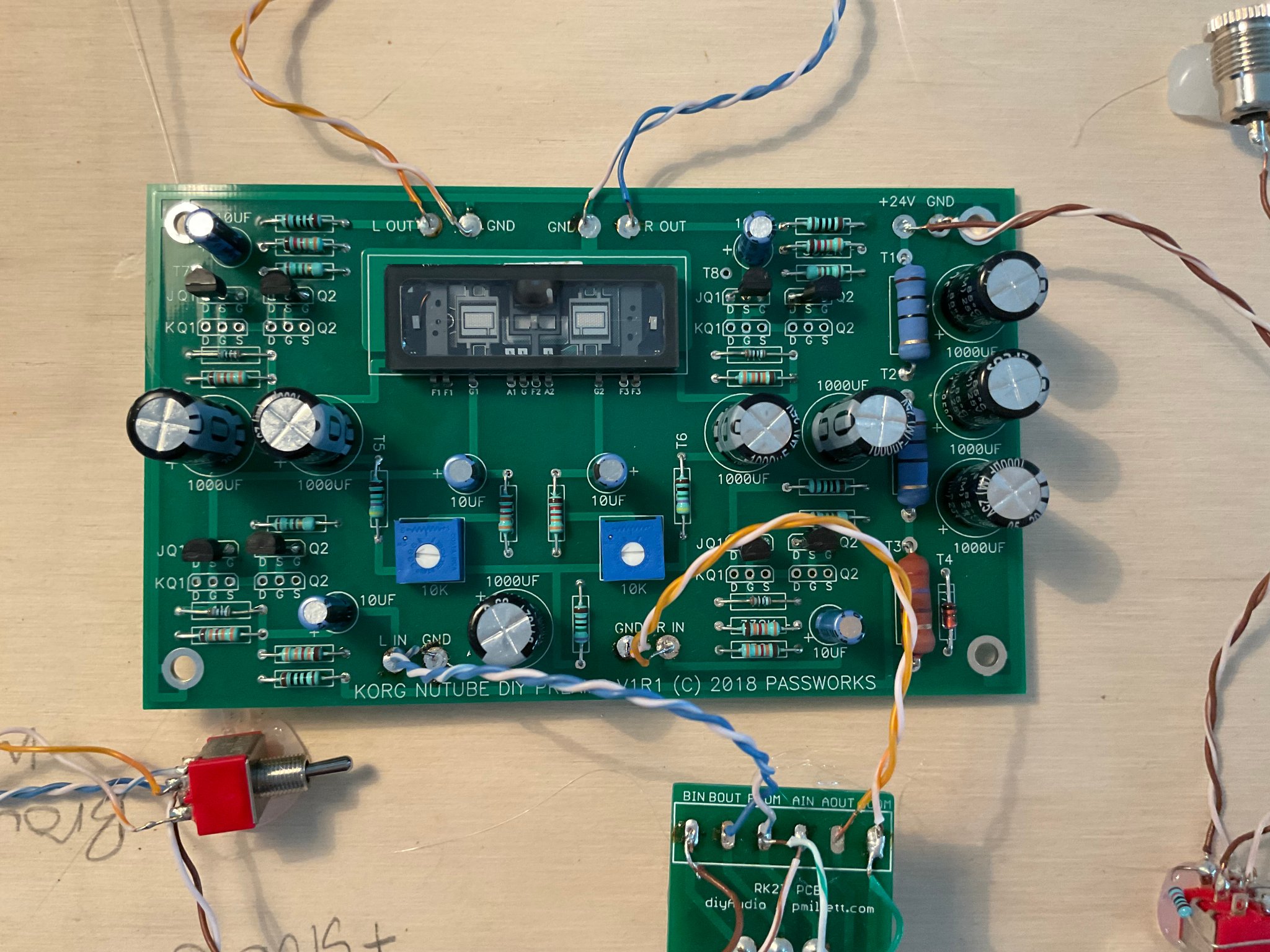

Looking at the second photo again, I see the brown wire going to the wrong connection. Move it from where it is now to "A in" on the same circuit board. Yes, the same that you had it originally was correct. You cannot see all of the traces on this board. Fools me too every once in a awhile.

Thanks again! I have moved the brown wire back. The ground wires do not touch the input wire on the RCA. Regarding the input selector I have tested with mulitimeter that there is connection in the two positions, i.e. the swich works and the "left" wires are all soldered on one side and all the "right" wires on the other side - should be ok I think? (but I realize that somewhere something is not connected right....)
You're doing fine. I would like to see a different view of the selector switch so that I can verify from the switch posts, what wire goes where. Make the view just large enough so that I can tell what color wire goes to each post of the switch. Right now with the photo that you have provided one cannot tell this.
Until you catch up, I have one last observation. As a sort of test, you should swap the green and white wires that you now have tied to ground on the pins sticking out on the board of the RK27 pot. You could also see if combining both of these 'common posts' on the pot will solve your fiasco.
What it seems that you have at the moment, are separate grounds from each input to the RK27 circuit board. That is alright unless the grounds got mixed up. Catch up with the last post that I made first and then continue to this post.

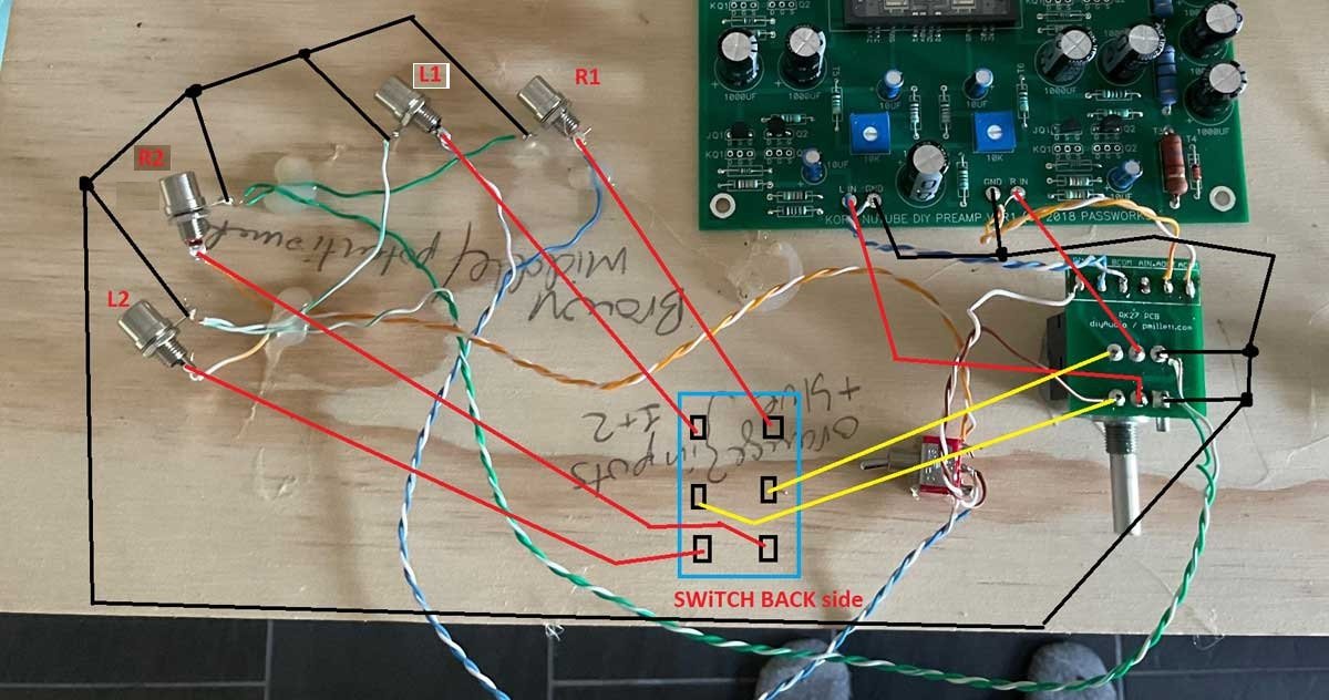

principle how it needs to be
remove all wiring, do it again by this sketch
take care of fast soldering pins of switch - necessary because plastic is fragile and easy to melt
if you have helper solder flux ( usually used for smd etc.) or calophone, use that to ease/make soldering faster

In other words, get rid of RK27 circuit board, tie all grounds together, and run separate leads for inputs/outputs. Color coding helps you along as well. For example, make all ground leads black, all right signal leads red, and all left signal leads blue.

these pictures are from before i put the brown wire back to the "A in" on the potentiometer board. i included a close up of the RCAs also. I sometimes use hotglue to keep the wires from moving around.
