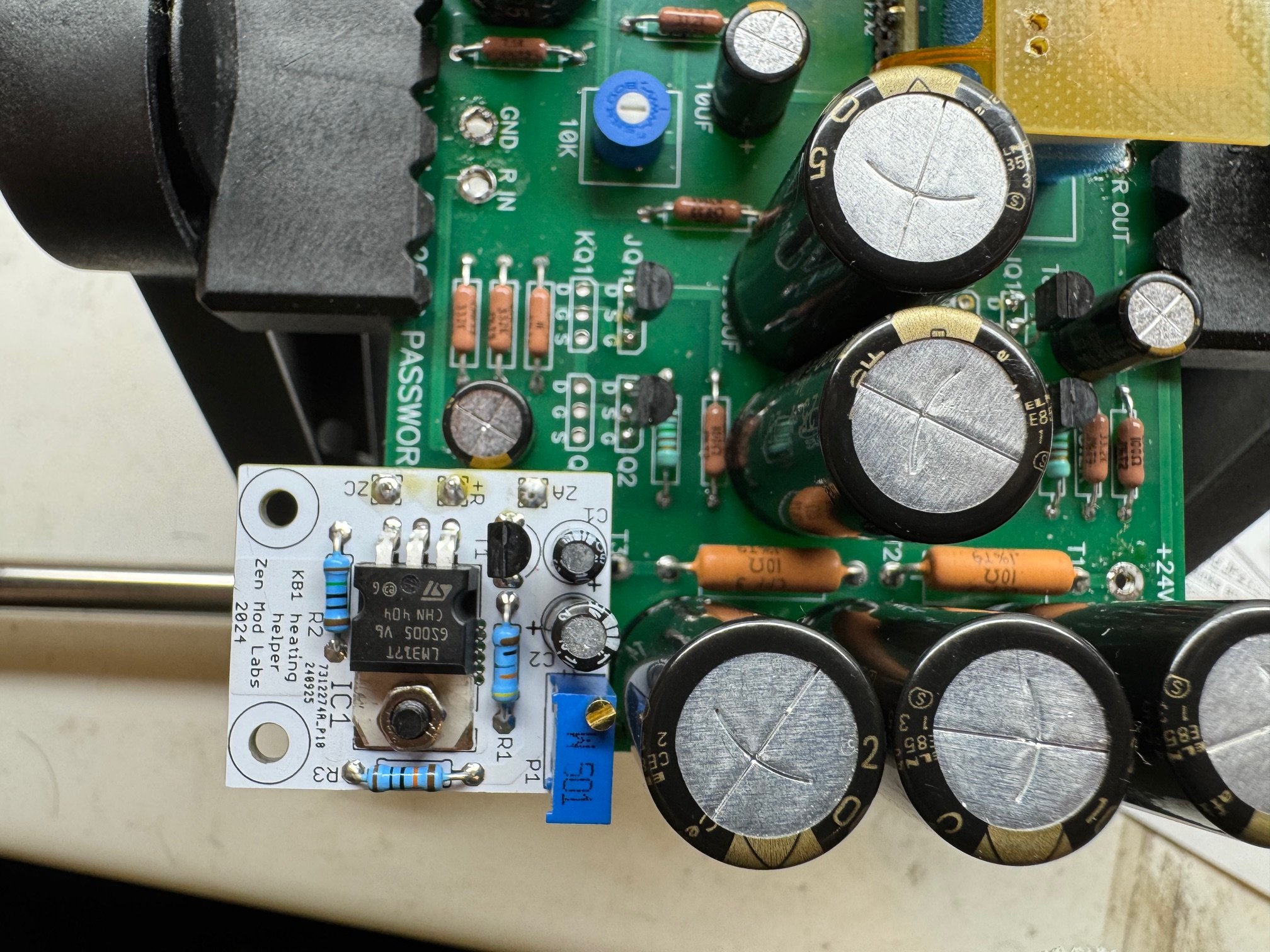

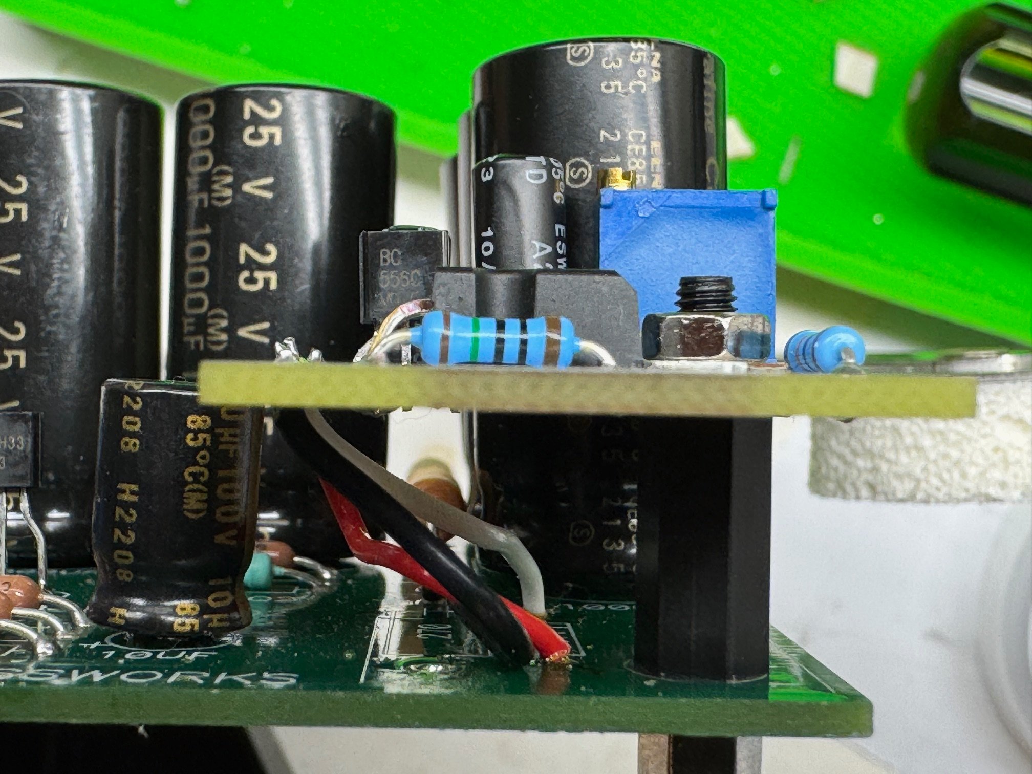

Could use a little help here - Not sure what to make of it. I got my new nu tube installed, also the soft heat board (thanks birdbox and ZenMod!). Everything working as it should and adjusted to spec. The KorgB1 sounds great as before but I've noticed 2 times now the left channel started blipping in and out. When I look at the tube you can see the glow on the left side going out as well. I'm just worried something weird could be going on and don't want to toast another nu tube. Just not sure where to go - the power supply is good. All voltage measurements are perfect. When it's working fine it sounds excellent. What the heck else could it be that would cause the left side to blip out ? All solder joints are good. I measured all resistors and caps before install. Any other component worth looking at or replacing? Could it possibly be the nu tubes are weak on the left side? I've read a few others having similar issues with left channel specifically.
Side note - the soft heat board went on nicely using a fiber standoff and nut over the existing corner standoff. Had 2 wires that have to criss cross but otherwise no big deal and easy install.

The soft heat is a good idea in any case. They are easy to install and I have committed myself to using them from now on. If this is your second tube and it is the same filament side, checking the heater voltage might be in order. Sorry to hear of your trouble. No one sets out to make trouble from a kit or purchase. It gets very old quickly. Fortunately out of all the SP1 projects that I have had, only 2 tubes had any trouble.
