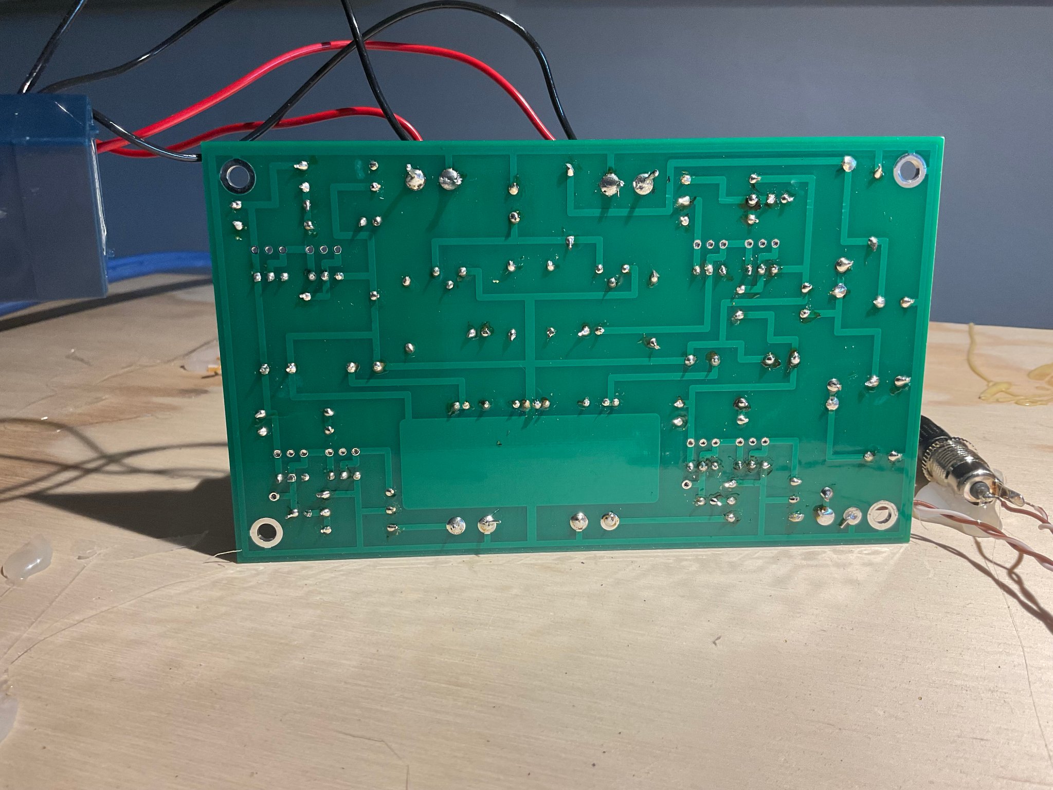

@Avance Concrete Fan can you give us a photo from below the board as well? More detailed/sharp the better.

Hi guys,
Sorry for the hold-up. Actual work came in the way...... I have gone through the component lists and the placements on the board 4 times and find nothing wrong. I have also touched-up all solderings. To me they look good. Still it doesn't play on the right channel and I have ZERO idea why. Any suggestions for a next step?

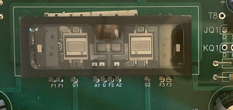

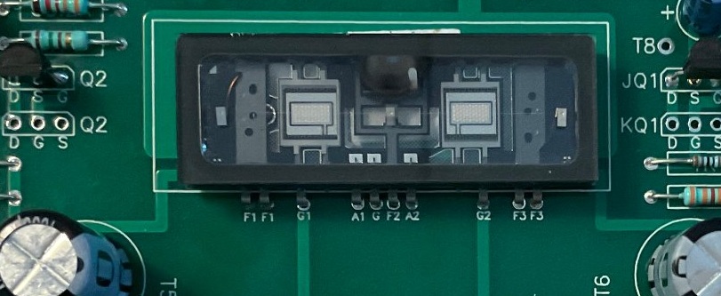

It looks to me that the filament is now broken.
Picture from post #8,869 shows a good filament. Picture from post #8,905 shows what looks to me to be a broken filament.

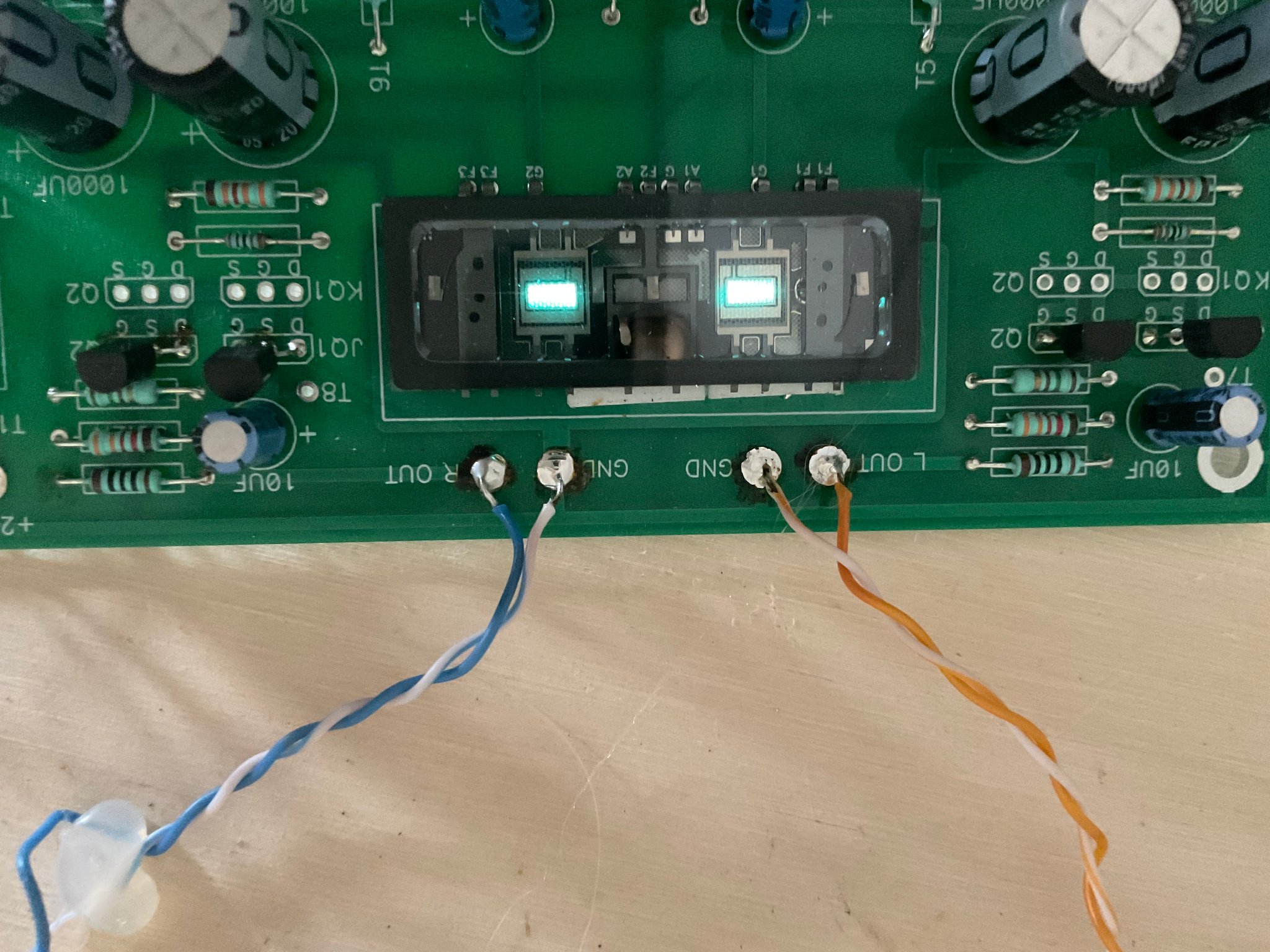

That's about the only way to prove it to me since these filaments are so very fine, and the second photo just doesn't quite the resolution that I would want. In the second photo, I can see neither filament, and we know that the two filaments are attached in the center. Light 'em up!
I am very happy that I am wrong. The filament looks good. 🙂

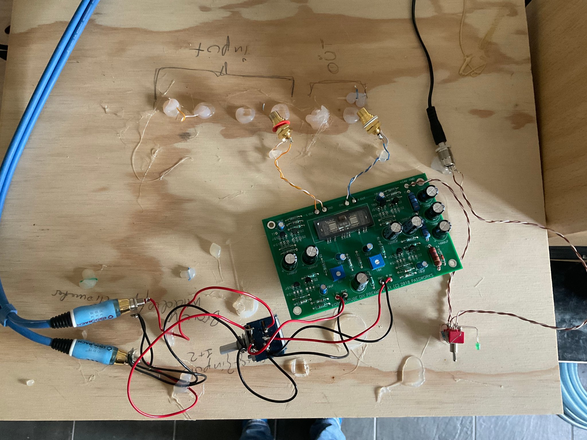

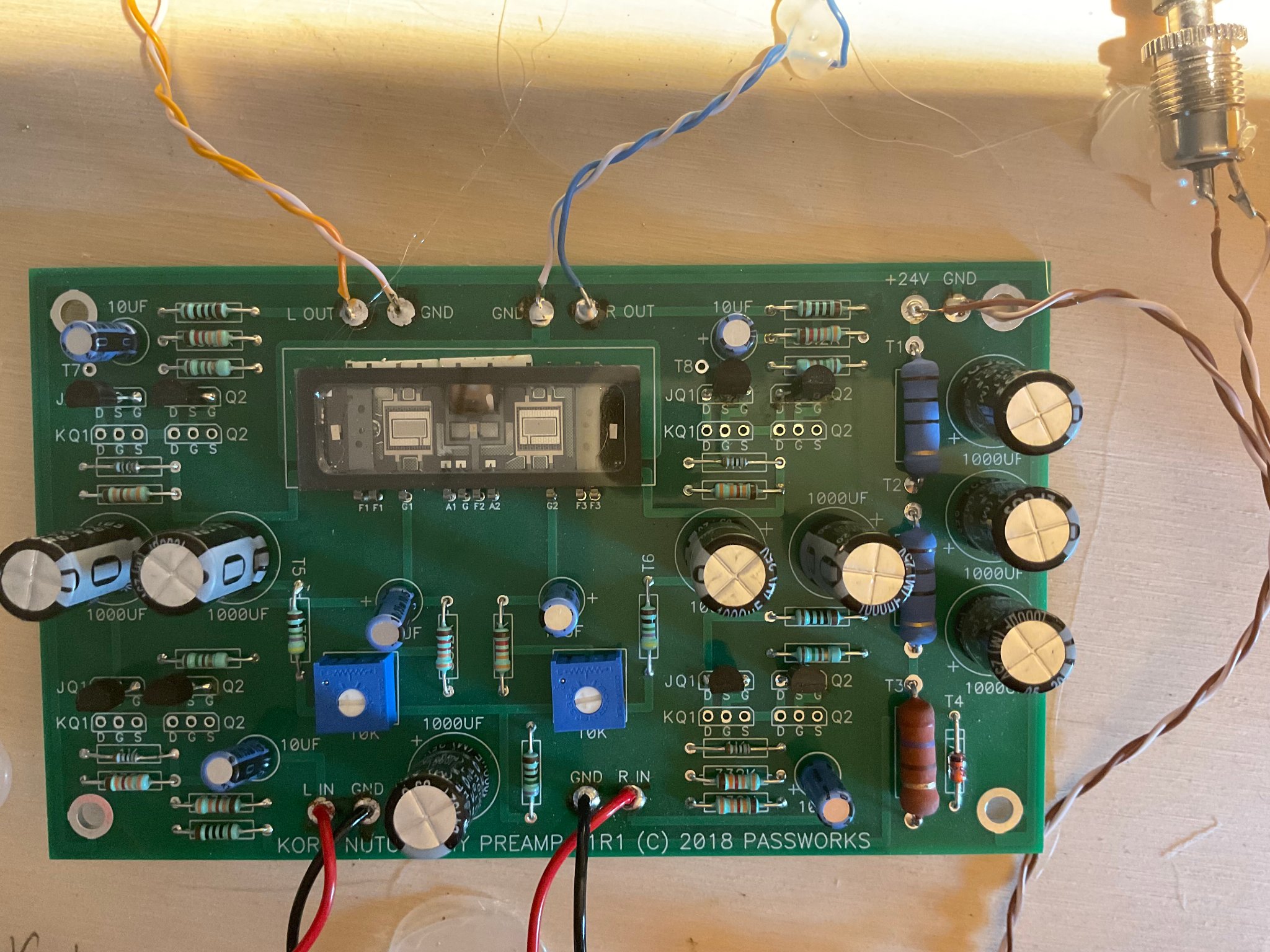

Please post pictures that show the board with all of the wiring and jacks.
And please let us know exactly what works and doesn't work.
Also confirm that the voltages at the Test Points are as they should be , or not.
Glad the filament is still intact. ACF...what I was suggesting is that the particular interaction between the B1K and the amp you are using may be strange , not that the amp doesn't work properly. If you have another functioning amp try the B1K with the second amp and see if the channel issue still exists.i simply assumed that when there was light, everything would be ok?
(The amplifier works and plays on both channels, it is something with the pre-amp)
when both out RCAs on the preamp are connected only one speaker plays, then when I disconnect the Left RCA cable then the working speaker stops playing and sound appears in the other speaker (which did not play before).
In previous post we tryed to remove the input selector but which did not help. The pictured volume potentiometer is also a second one tested.
