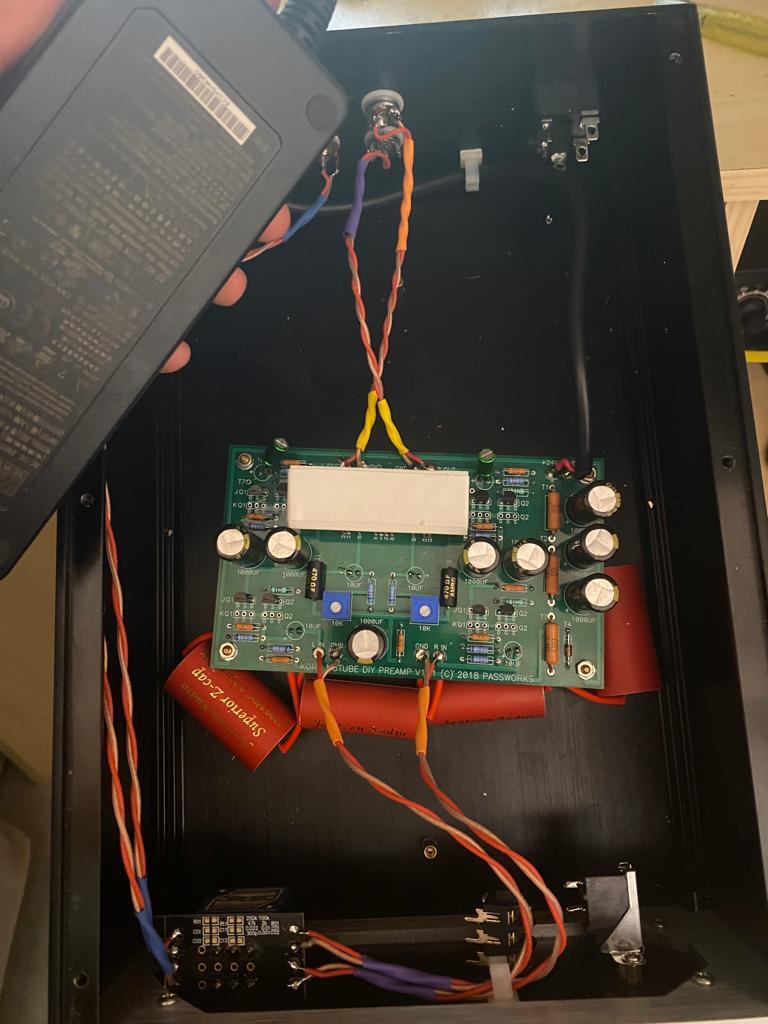

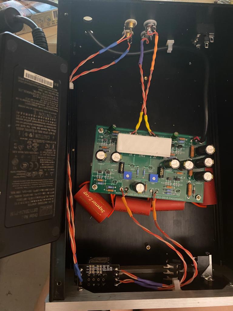

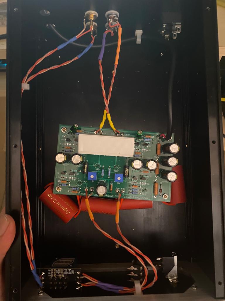

I have some problem when building the B1K pre amp. I am trying to use just 1 set of RCA input and output to simplfy the wiring at this moment. When this preamp is connected. It buzz very loudly and continiously. I think that is because of some silly mistake exist.
Also, music are only coming out from right channel, where the left channel remaing no sound. I originally tried to use the 0.33uf, 1uf abd 3.3uf (ppp) cap. Then I thought 3.3uf may be too low for my power amp and causing the buzz. So i change it back to 10of bp cap shown in the pic below. The power supply is 24v smps from diystore. I did try to browse throght this thread and doing debug by myself. But i really have no clue now.
T1 to ground +23.9v
T2 to ground +23.15v
T3 to ground +22.39v
T4 to ground +8.89v
T5 to ground no reading 🙁
T6 to ground no reading 🙁
T7 to ground +9.5v
T8 to ground +9.5v
I did double check that there's no cold solder joint and the compoents are at the right position(I think)
Any suggestion?😢

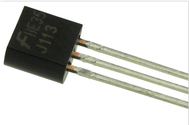

If the J113 were part of the diyAudio B1 Korg kit, then they should be ok.
You said that the preamp buzzed. Does it still buzz after you swapped capacitors? Were both channels buzzing or just the left channel?
Does the Korg tube light up?

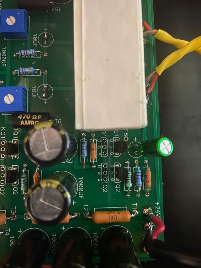

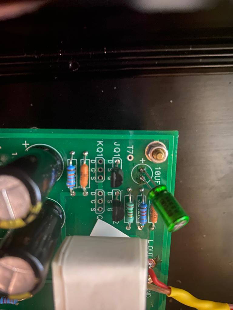

You are getting good voltages at T7 and T8, but no reading at T5 and T6. That is strange. Is your meter autoranging or do you manually set the range? It should be about 0.6 VDC at T5 and T6 relative to Ground.

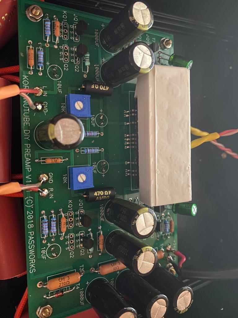

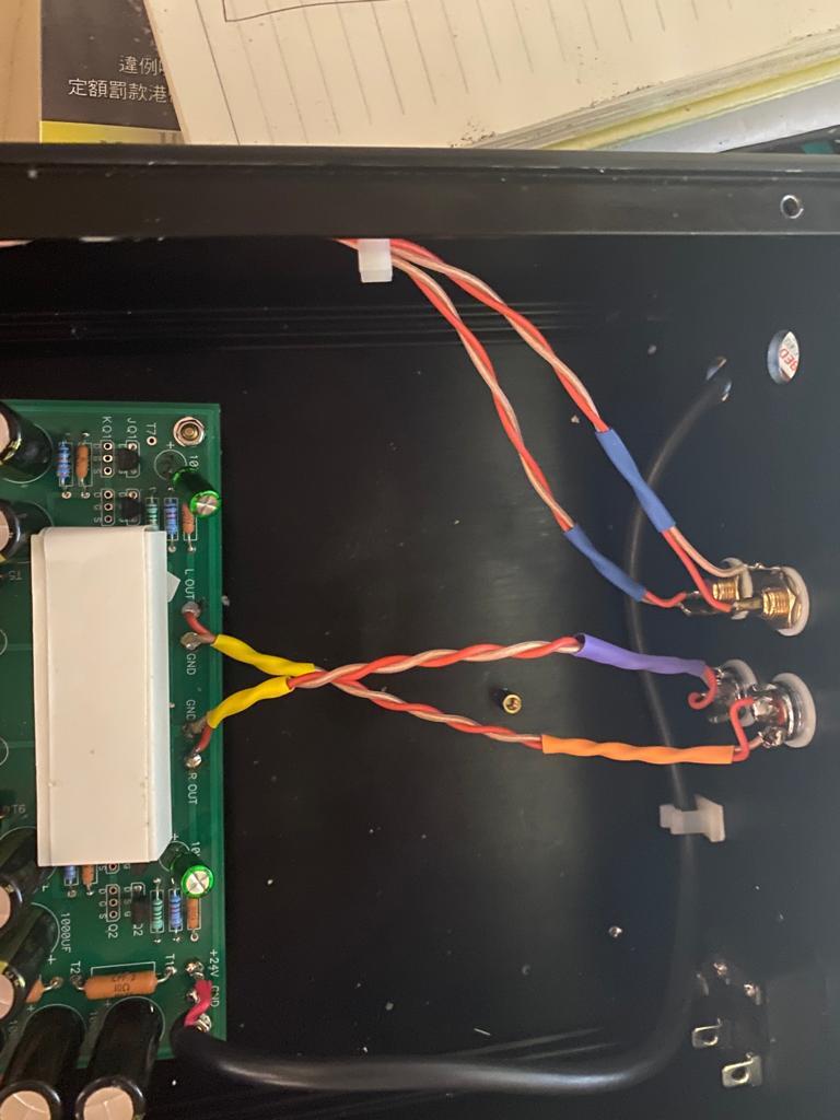

Your pictures are not very high definition so it is difficult to zoom in and examine the board. From what I can see it looks like some of the solder joints have either too much solder or not enough heat, or both. Then some joints look like they do not have enough solder. For instance, the left channel output wires at the pcb (signal and ground with yellow at the end of the wires) look like not enough solder.
FYI, I sent two B1 Korgs in FW chassis to BAF for distribution...
I dont know whether it is just one channel buzzing or both share the same problem. left channel has no music coming out.If the J113 were part of the diyAudio B1 Korg kit, then they should be ok.
left channel no sound at all
right channel 70% buzzing noise and 30% music I play.
The parts are either from diyaudio or mouser, so the quality are probably fine.
The Korg tube is lit up successfully.
I use autoranger to measure the reading.
Is it possible that my nutube is not functioning as it should br? having some kind of defect?

14071466d,Please measure the voltage across the following resistors of both channels:
- all R1
- 332K on either side of the Nutube
- 475R next to T5 and T6

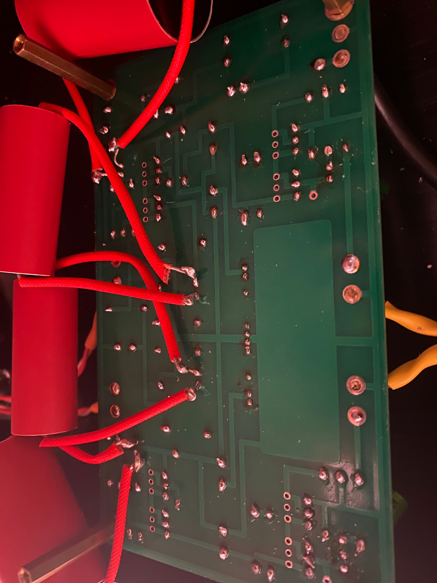

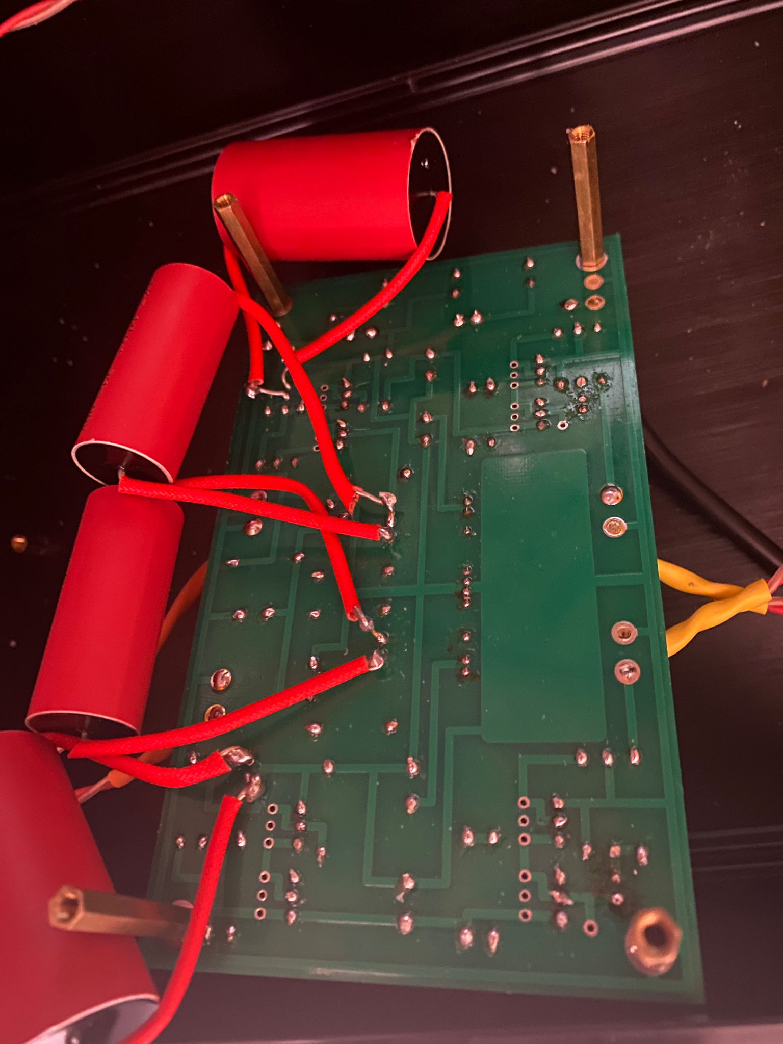

As mentioned previously, many of the solder joints do not look good, although I cannot tell for sure since the picture quality appears low when zoomed in. Good solder joints should be shiny and smooth. Many of your joints appear lumpy. The solder joints of the left channel output wiring appear to not have enough solder and perhaps not heated properly. Reheat all of the joints and remove some of the solder from joints that have too much solder, and reheat and add solder to joints that do not have enough solder.
There is a lot to suspect here when I am looking at the soldering. One thing that stands out to me are the off board solder joints for the red Jantzen capacitors. In photo #14071466D, the lead of the capacitor on one side doesn't even look to be soldered. That would account for the no signal in one channel. What solder are you using? What solder iron are you using? I had the same results if the solder that I am using is very old and the resin is now bad. Makes it much harder.

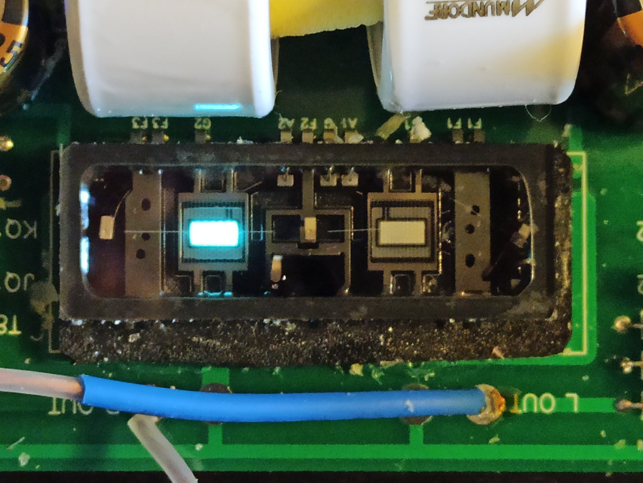

Today I turned on my B1K and one channel is missing, it seems, that Nutube is broken ...
Pre was working since March without any problems ...
Both ...
obviously Dodo
most right filament moustache-halve is gone to travel inside of funny bulb, no more connected to incandescent island
