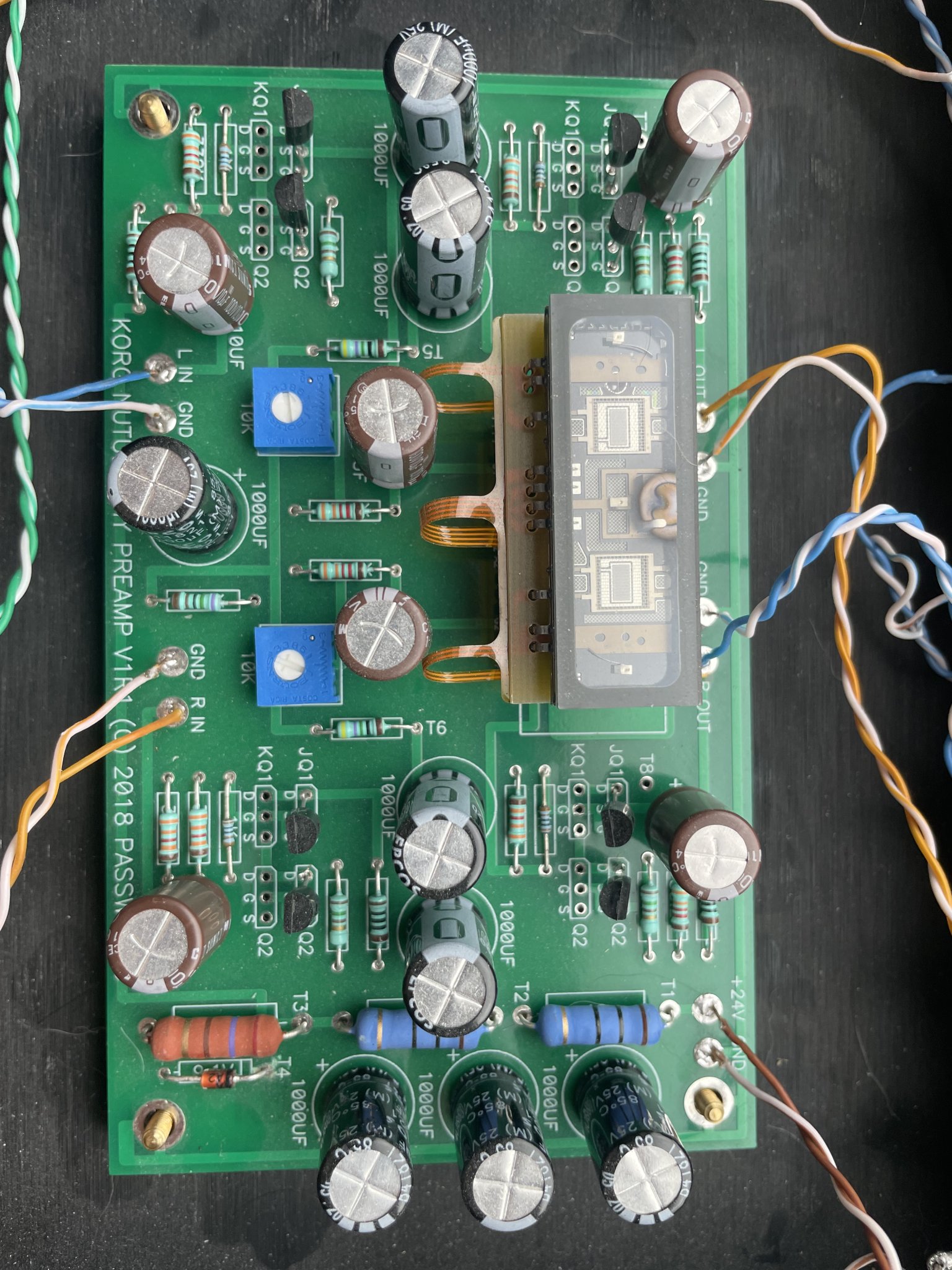

I will test per your instructions this evening. I have some photos here. Excuse the wire length, I wanted to keep them longer during build to accomodate removing the board easily. I'll refit when all is working as it should.
I'm seeing that... I didn't even realize! Funny, looking at this picture I posted it is so clear to to see. While working on the board the pieces are so small and its tough to see some of the detail. I need to get a magifying glass for my 3rd hand tool!
I'll correct the JFETs direction.
Brijac... it is soldered, you just can't see it from the top. That was one of the hardest bits to solder... so tiny!
I reversed the backwards JFETS, all are correctly oriented now. I took the following measurements:
T1 = 23.8
T2 = 22.9
T3 = 22.0
T4 = 8.9
T5 = 9.0
T6 = 8.9
T7 = 19.5
T8 = 19.5
The adjustment pots have no affect on the voltage for T7 and T8.

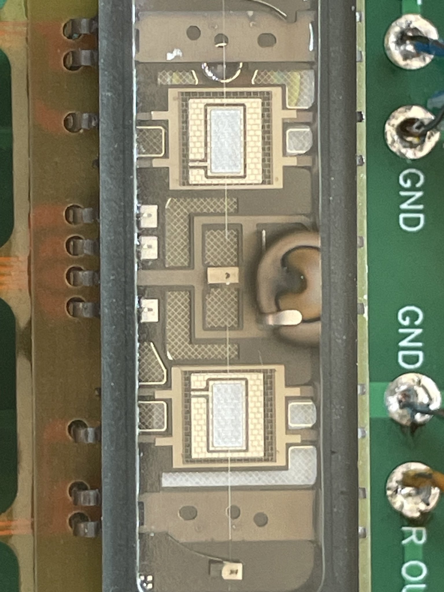

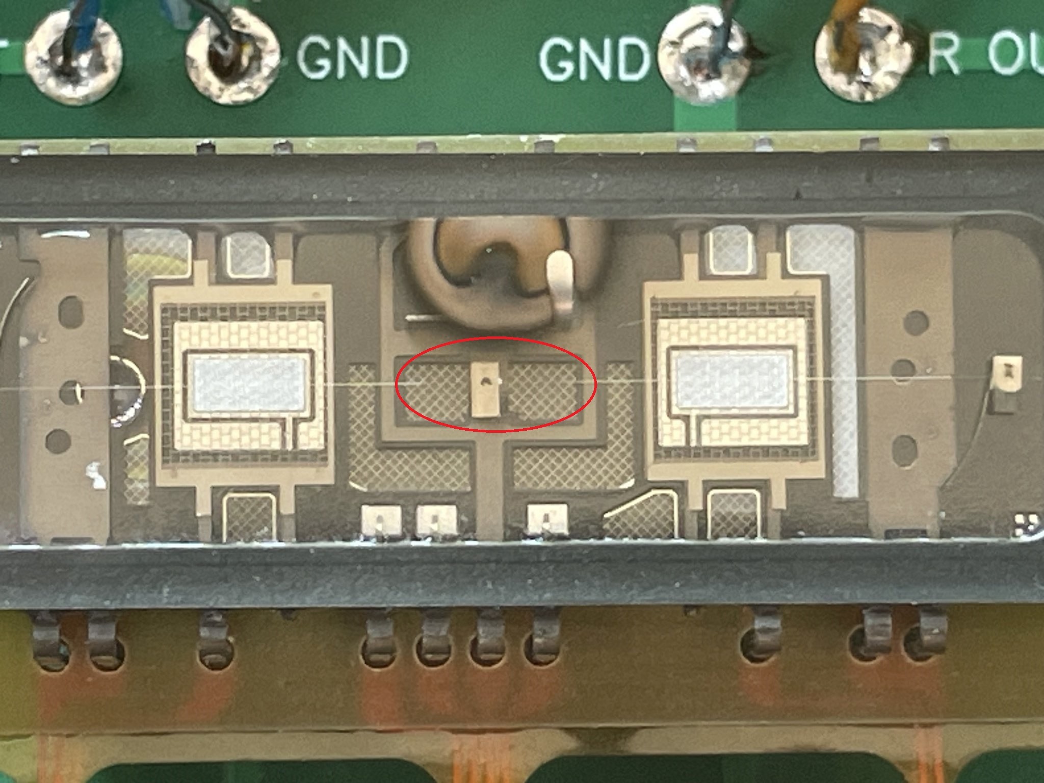

I suspect bad solder joints. Looking at the top side of the board there are many solder pads that show no solder between the component lead and the solder pad. That is a sign of either not enough solder or not enough heat applied to the solder at the pad on the bottom the board.
The T5 and T6 voltages indicate that there is no current flowing through the Korg filament.
Have a real close look at the Korg. The filament should be visible as a continuous thin straight wire longitudinally across the tube.
I can see the filament and it is not looking like it is running continuously across the korg? I'll go back through and flow more solder. I learned less is more with solder but I guess you can do too little. Thank you again Ben, really appreciate your time and help!

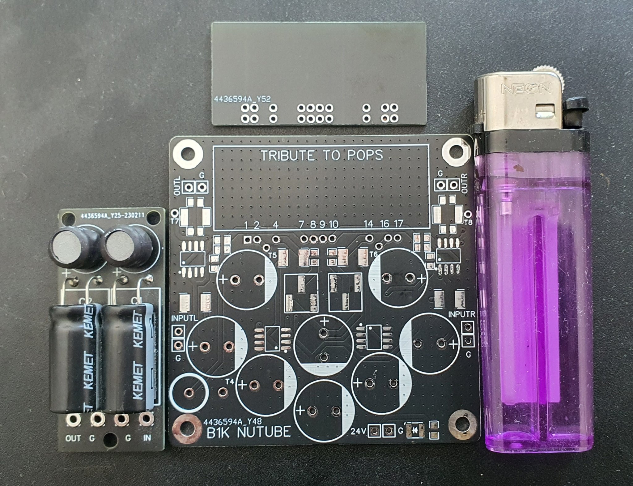

Another alternative is to use a NuTube socket. That eliminates the possibility of damaging the NuTube through heat and makes it much easier to replace NuTube after failure or defect. Apparently some NuTubes have a limited lifespan.
Pete Millet sells the socket on his EBay website.
Well, what a surprise for me. I knew about the carrier board but I distinctly remember a socket as well. In fact, there were a number of accessories which are no longer available. I stand corrected, however, if my memory was faulty.
I guess this raises the Q: could individual socket pins be added to the board to permit easy replacement? Offset from board would allow damping sheet to be added between NuTube and PCB.

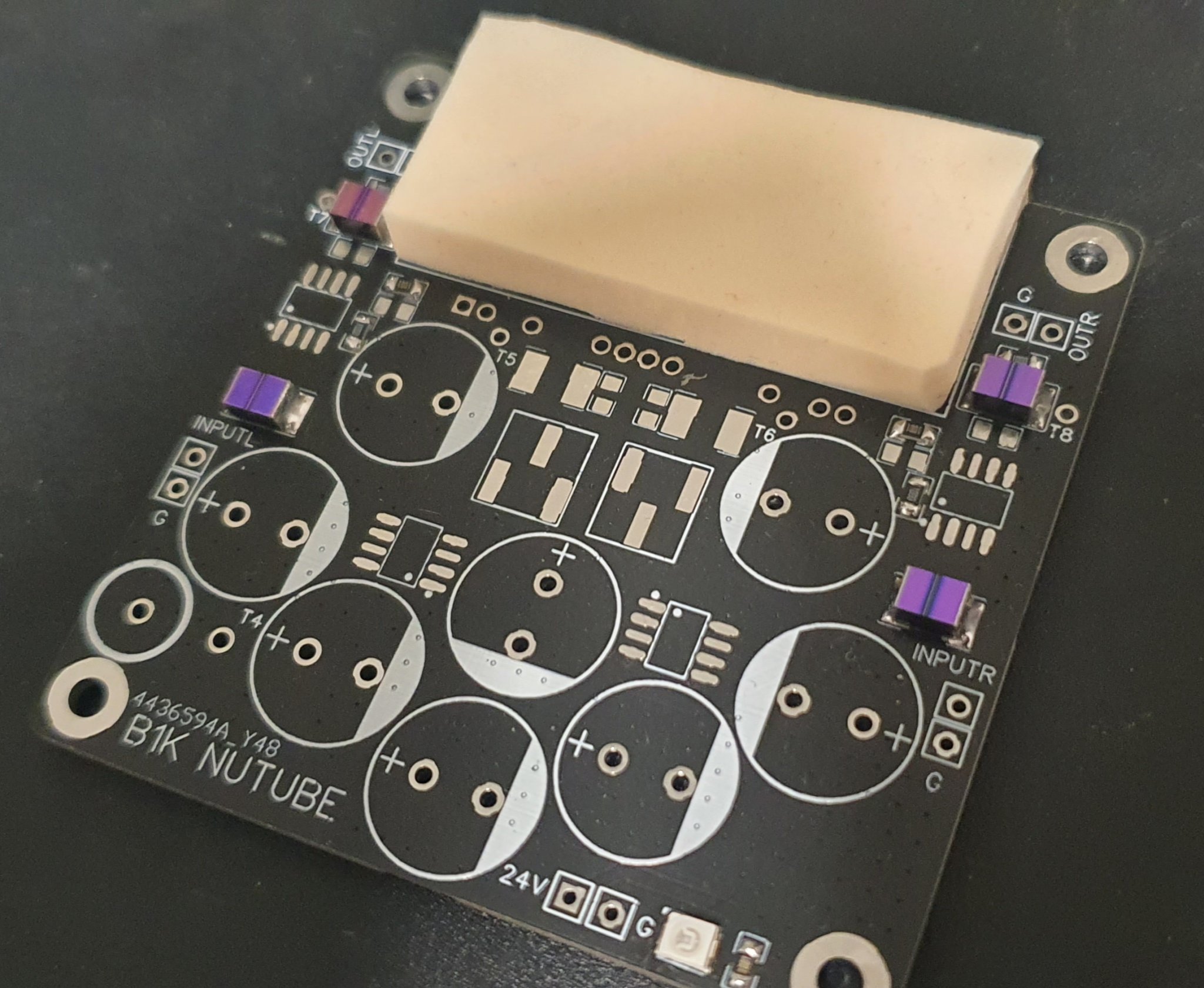

You can use pin socket for this, but legs on nutube are so soft, you risk breaking them. There are solutions to decouple, one above pete's with teflon pcb. And i made decouple board to use with wires (which to me should decrease vibration trough conductor even more with properly thin wires). And then use soft sponge (i found makeup sponge to be amazing in light object vibration dampening) with double sided silicone tape. Eva foam combination with it as also good.
