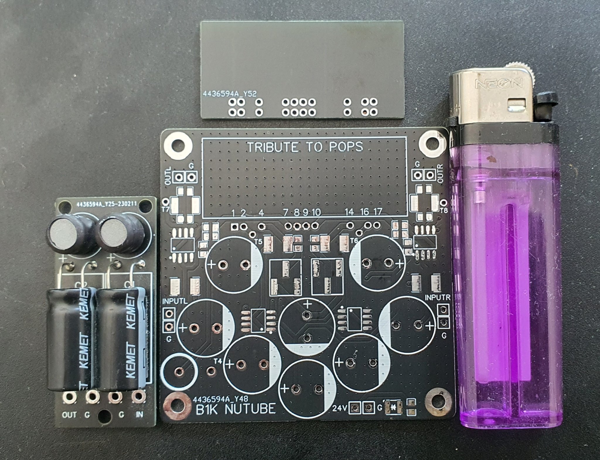

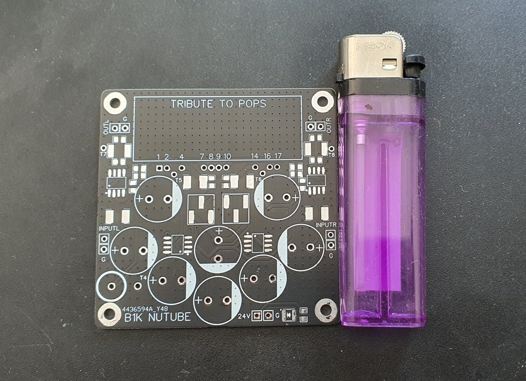

Boards have arrived. I removed the filter part from the main board, as it is as small as can be like this, and you can see my smd version of marks p089zb filter. In general, very tiny indeed. Rest of the parts are on their way.

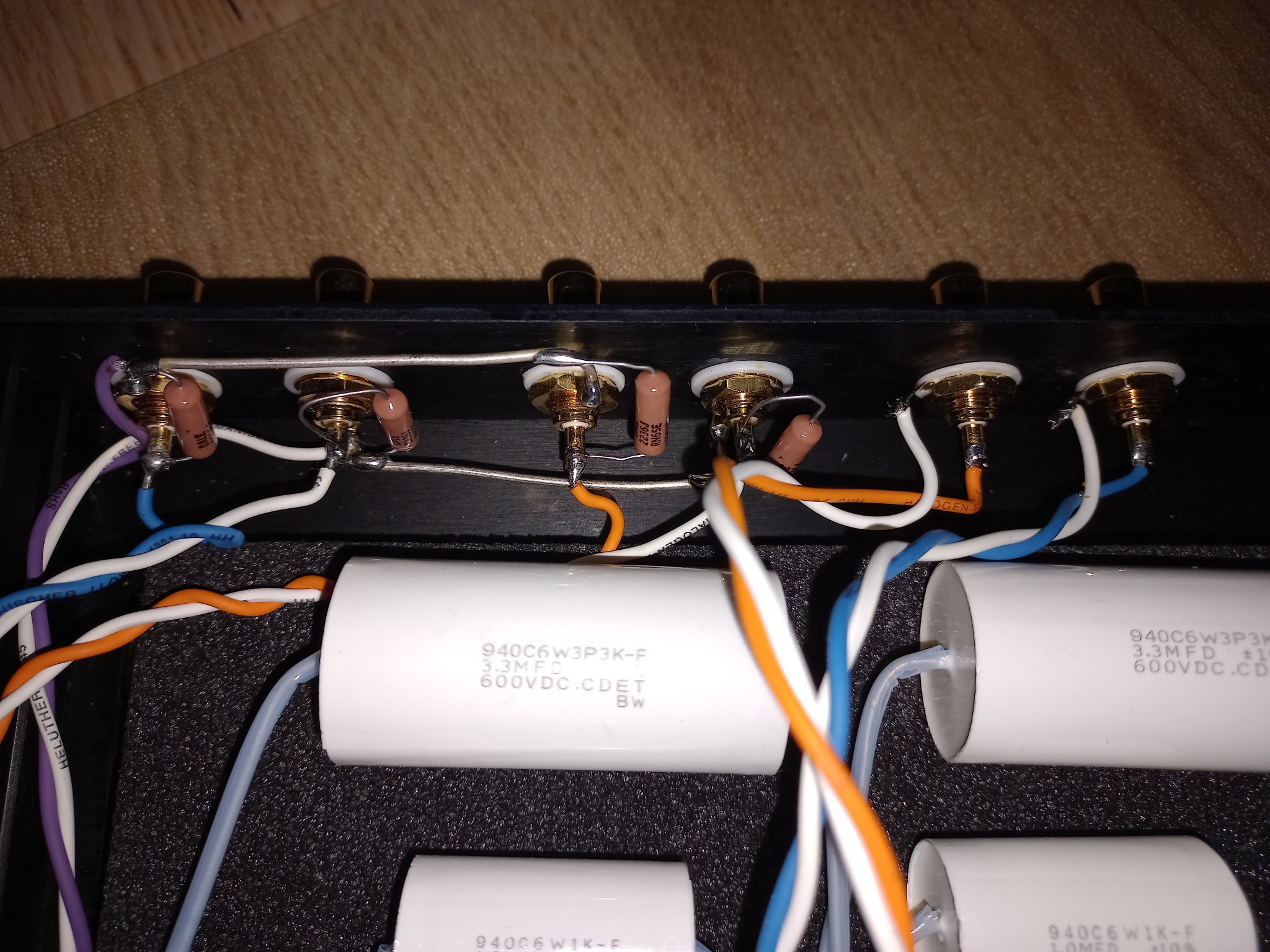

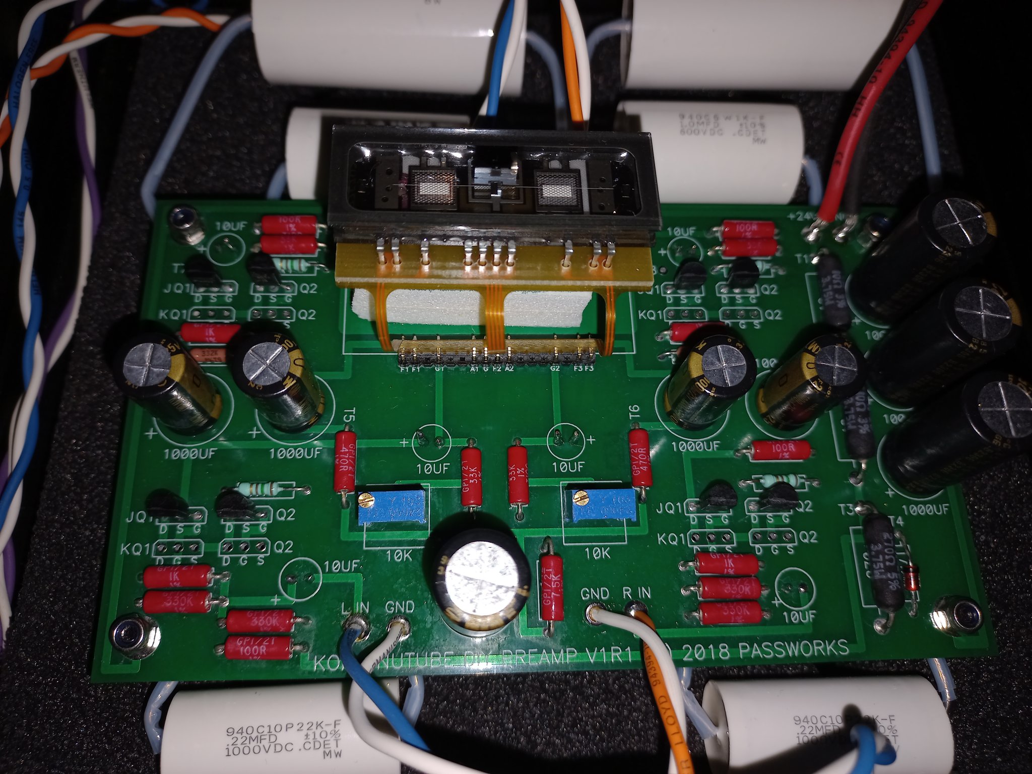

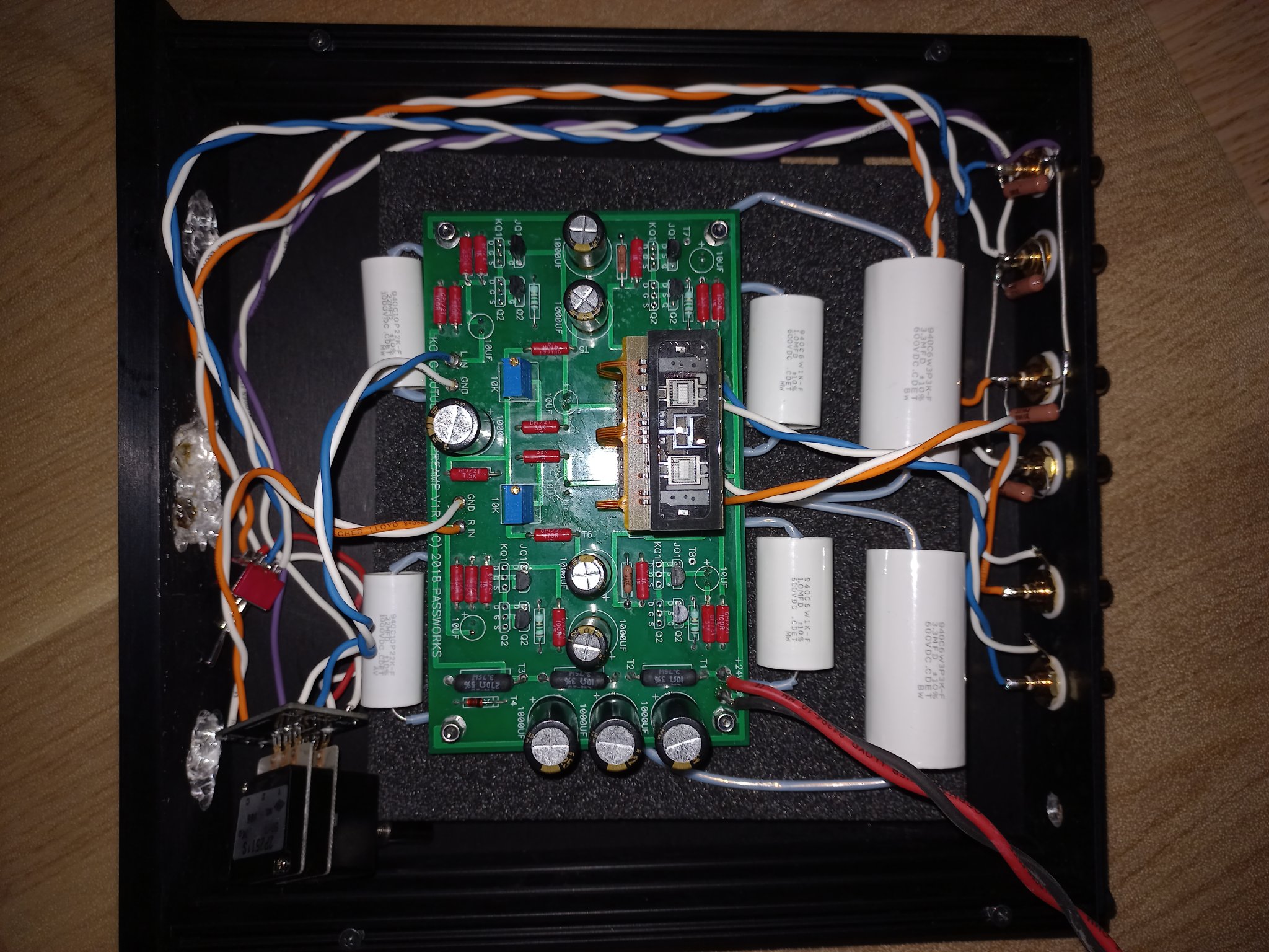

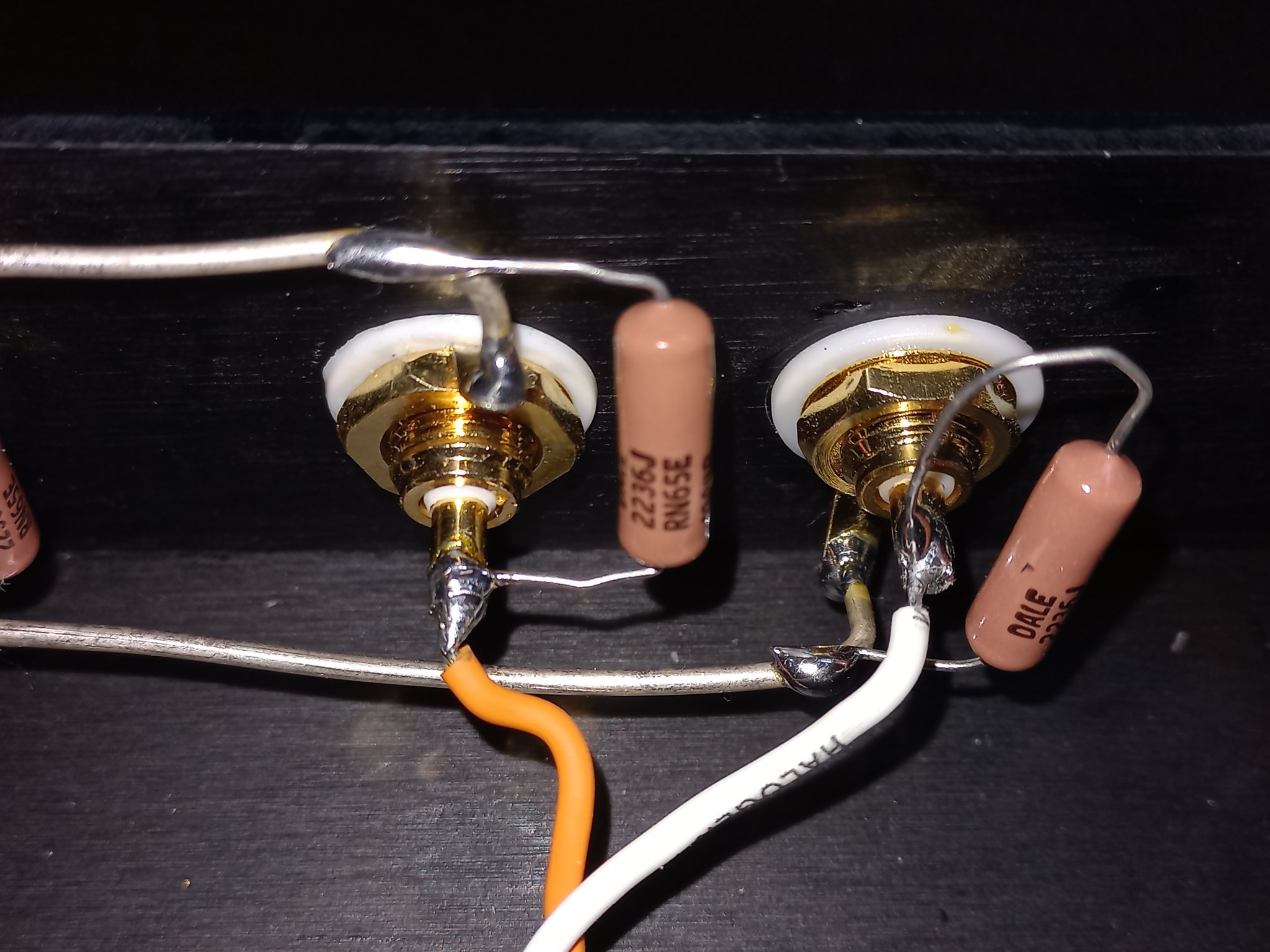

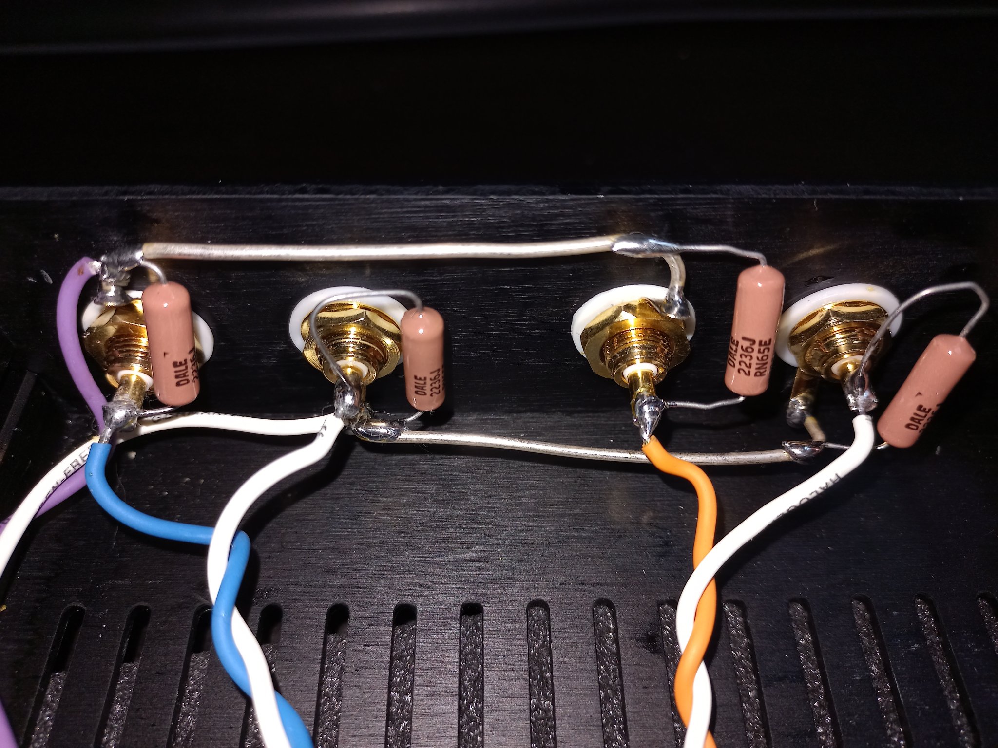

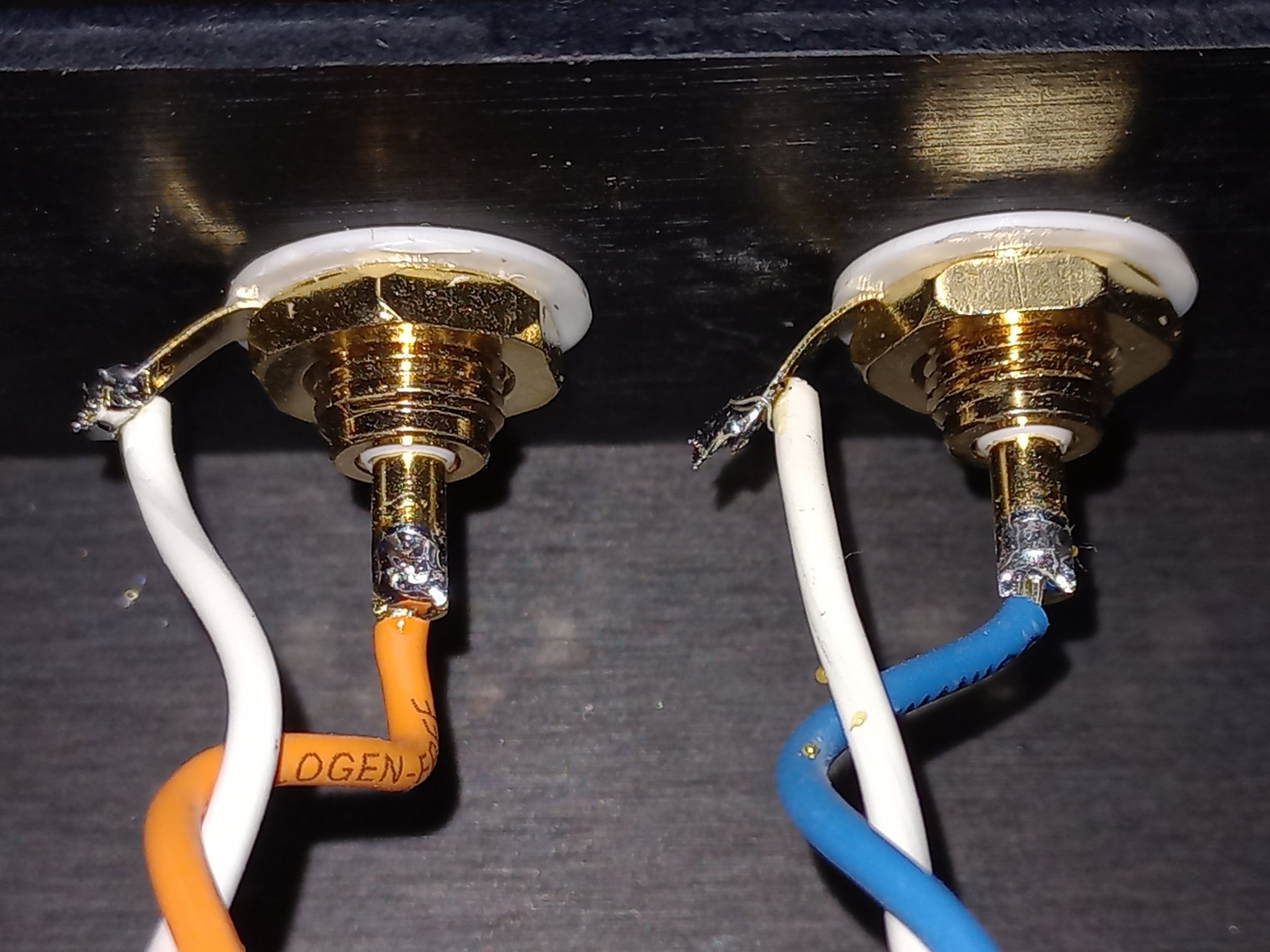

I have 2 stereo RCA Inputs and 1 stereo RCA Output. One channel is "dead" with hum/buzz. Also hum/buzz, when I touch chassis.
Triode lights up normally.
What I have measured, all seem ok from the both channels. Similar numbers from both sides.
If I change RCA inputs to opposite (right to left and left to right), this changes "dead channel" to work. Problems moves with Input RCA cables.
I tested that with PC, which sends sound only to left or only to right channel. I can hear "Left channel" and "Right channel", but not at the same time.
There is always hum/buzz on the "dead" channel.
So, preamp board itself seems to work ok for both channels, but only separately (+ the hum in the other "dead" channel).
To make this a bit more complex, I have added some mods.
-SMPS DC Filter P089ZB Kit
-"GlaudeG" bigger capasitors onboard
-Input, coupling and output resistors located outside of the board
-1Mohm extra resistors between negative and positive of all those Input RCAs; 4x 1M resistor for 2 stereo RCA Inputs).
-TKD 2P-2511S 10k stepped stereo potentiometer with local connection board, made for Alps RK27 (6 holes in / 8 out; 2x GND for both channels).
On board between +24 and GND = 23,96V (same with all ground points).
BUT also connection between GND and R IN and L IN, so R IN and L IN are connected. Should those be like that?
T1 = 23,96V
T2 = 23,22V
T3 = 22,47V
T4 = 9,23V
T5 = 0,667V
T6 = 0,679V
T7 = 9,51V
T8 = 9,51V
R1 = 0,913V (right)
R1 = 0,964V (left)
Both channels of Nutube light up.
But no right channel output (only hum), changing input channels, "dead" channel works.
Working channel sounds normal.
JQ2 = 10,63V (right)
JQ2 = 10,59V (left)
JQ1 = 21,20V (right)
JQ1 = 21,19V (left
JQ2 = 9,53V (right; close to triode)
JQ2 = 9,52V (left; close to triode)
JQ1 = 21,20V (right; close to triode)
JQ1 = 21,19V (left; close to triode)

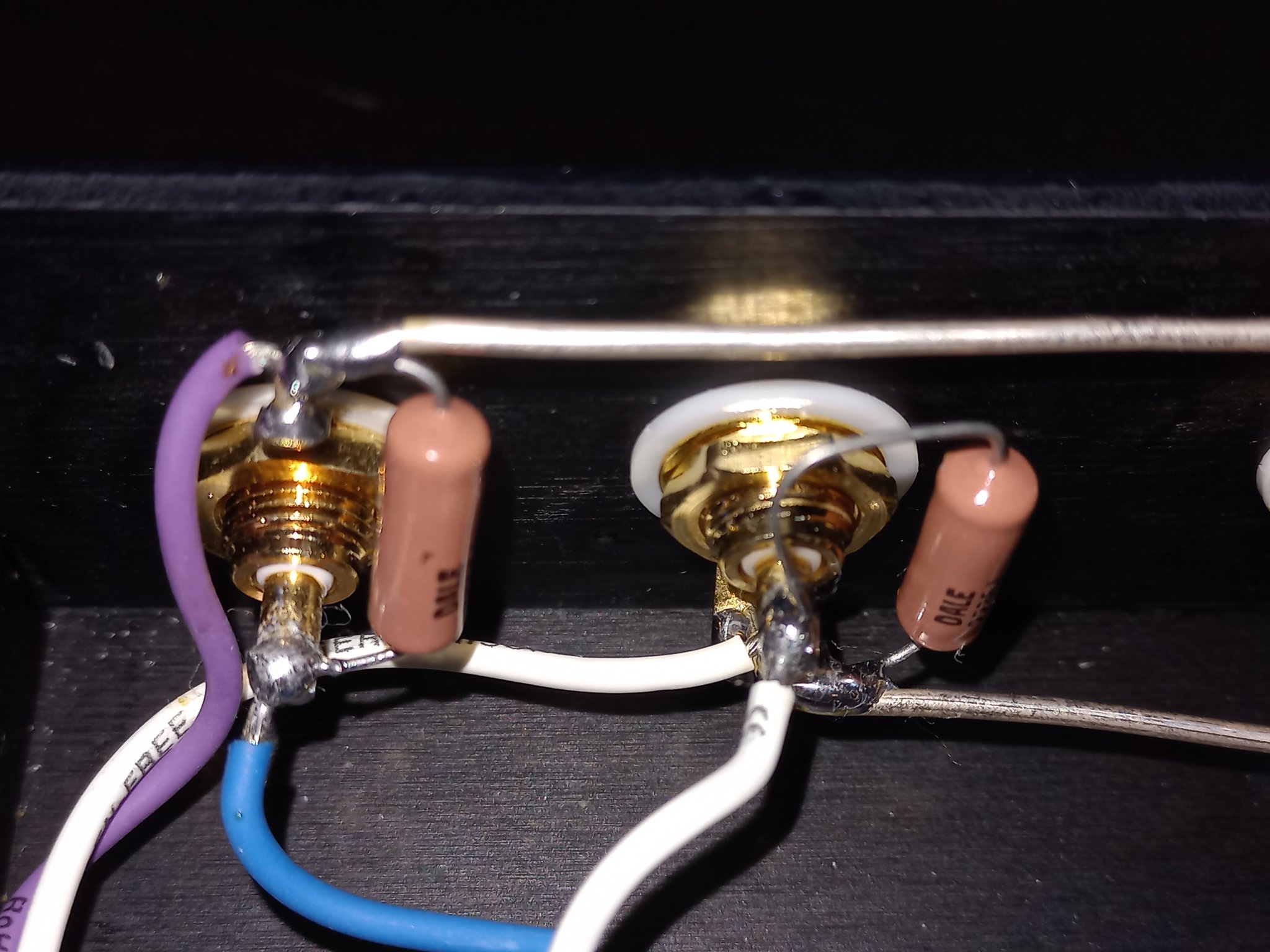

From all RCA Input grounds, I get connection to all ground points. But also to R IN and L IN.
From RCA Output grounds, I get connection to all ground points. But also to R IN and L IN.
Potentiometer 0%:
-All GND connects to all other GNDs.
-GND connects also to ROUT and LOUT (and from ROUT to LOUT).
Potentiometer 100%:
-ROUT and RIN connects.
-LOUT and LIN connects.

Whatever, probably a short between signal path and ground, or a ground missing... if both channels are working when fed independently it sounds quite promising and not necessarly a problem at B1K board (other than input and output wires) to investigate first?
Quote: If I change RCA inputs to opposite (right to left and left to right), this changes "dead channel" to work. Problems moves with Input RCA cables.
=> Sounds like the problem is either the RCA cable or your source, not B1K. Have you tried with another source and cable?
You also said Rin and Lin etc. were shorted to ground, which is defo not normal. Did you measure that with the RCA cable plugged in? Odd did you measure that while the B1K was connected to nothing (neither inputs nor outputs)?
More knowledgable persons will for sure step in and ask also for pix
Good luck!

I think my cables and other components are ok (cross tested). It is this "almost ready" preamp, which is still giving some problems.
Changed my DC IN connector to 2-pin version. It helped with the most of the hum/buzz. Maybe I should have connect the third leg to GND?
I removed extra filter for power and also the on/off switch to simplify search. No change in behavior.
Capacitors are not polarized so direction is not an issue. Markings not an issue.
DC in connector is not visible so cannot comment. However DC power is + and - so only two wires, therefore only two power wires to connector and to board.
Cannot see wiring details of wires to input selector switch, from selector switch to volume pot, and volume pot to board. You should study the build guide and make sure that you have done the wiring correctly.
B1 Korg Build Guide
Post pictures of the wiring to the input selector switch and volume pot.
If one channel and then the other channel works if inputs are flipped, have you tried another source? Have you tried the source on another preamp to confirm the source has two working channels? Do you have another source that you have confirmed to have two working channels that you could connect to the B1 Korg?
