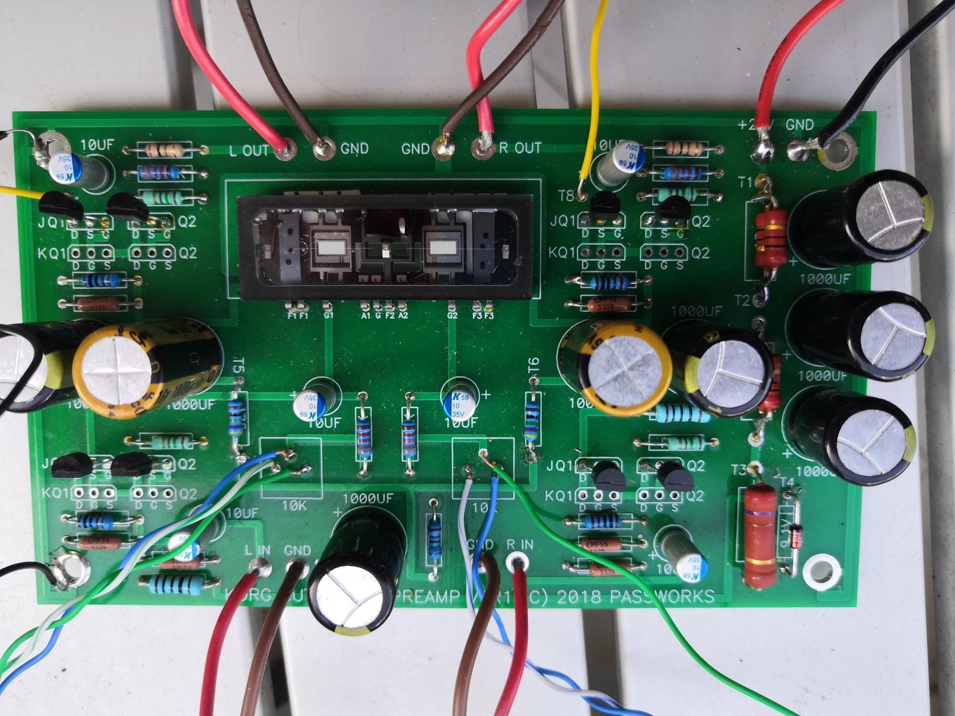

Hi!
I need some help. The left side of the Nutube lights up very very dim. The right side is a nice green.
I do not find the fault as both sides show equal values:
Resistance at the Nutube from F1 to F2 = 11.5 Ohms; From F2 to F3 = 11.5 Ohms - so I assume the heaters of both triodes are OK.
Voltage before the 475 (!) Ohm resistors is 9.2 Volts for both sides. Voltage at T5 and T6 is 0.67 V. So both heaters consume the same current but one side does not light up.
Which part of the tubes emitts the light?
I worked quite some times to find cold solder joints. Found some.
Any Ideas? Broken Nutube?

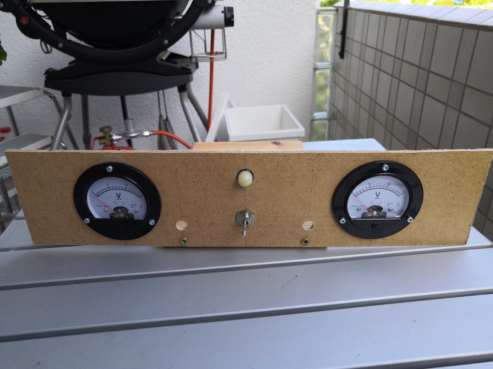

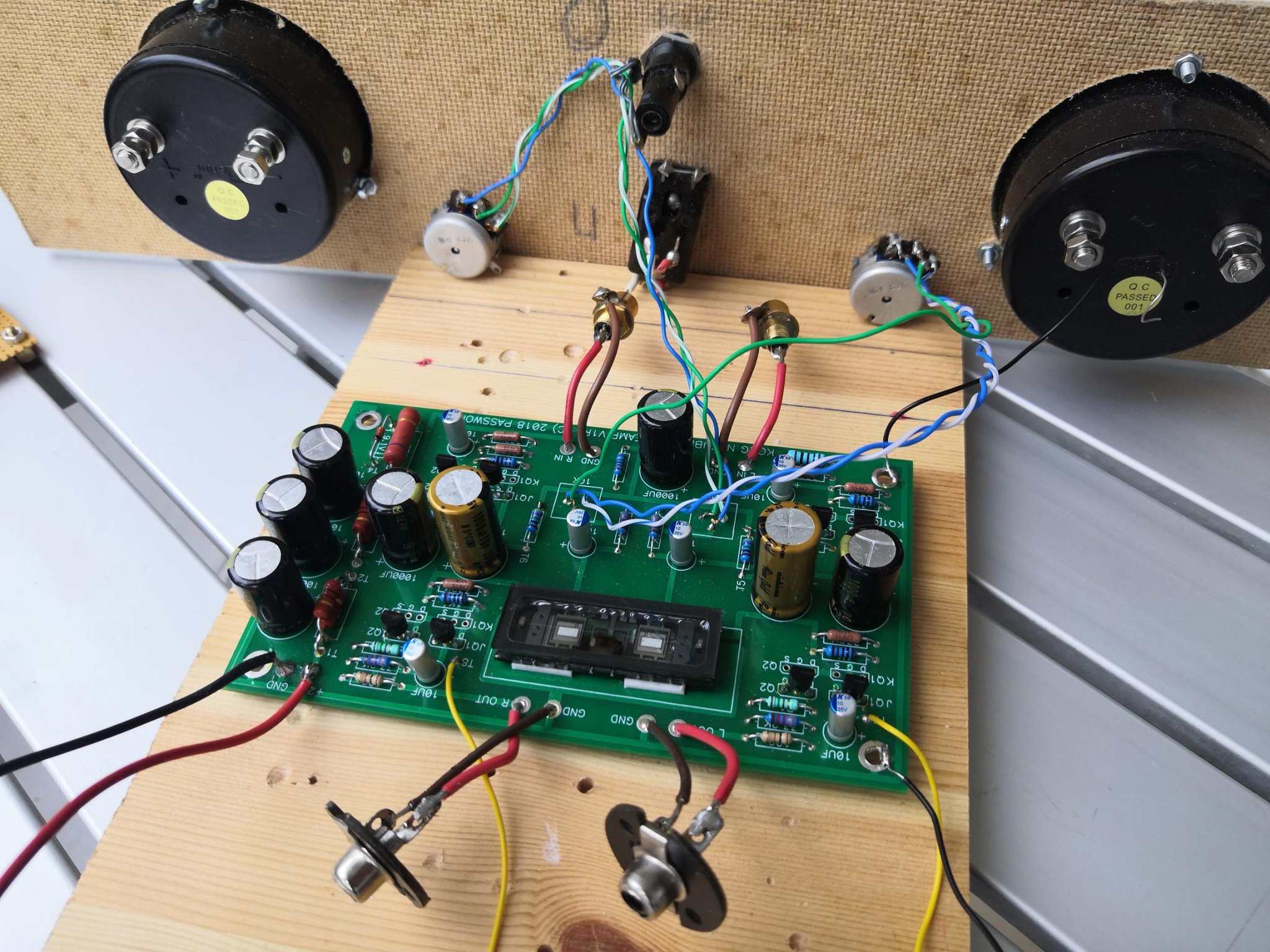

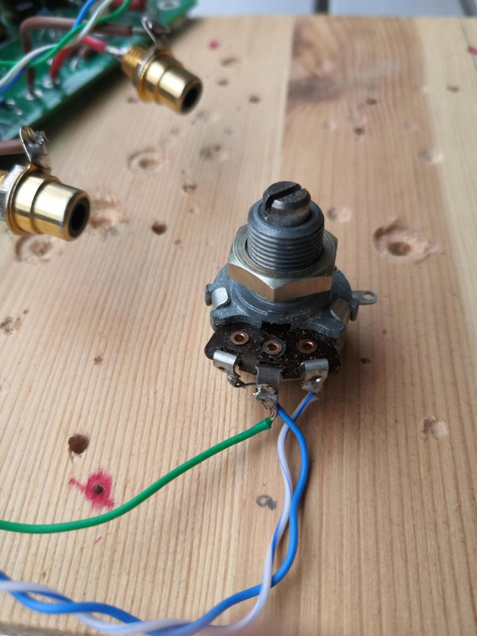

Hello
here are the pictures including the provisory front. I want it to look very retro with the pots sticking through the front.
And no I did not adjust T7 and T8. At T7 and T8 I have 19.6V. I tried to adjust T7 but I could not. As the value is so high I did not try to adjust T8. May be the potentionmeters are to old.

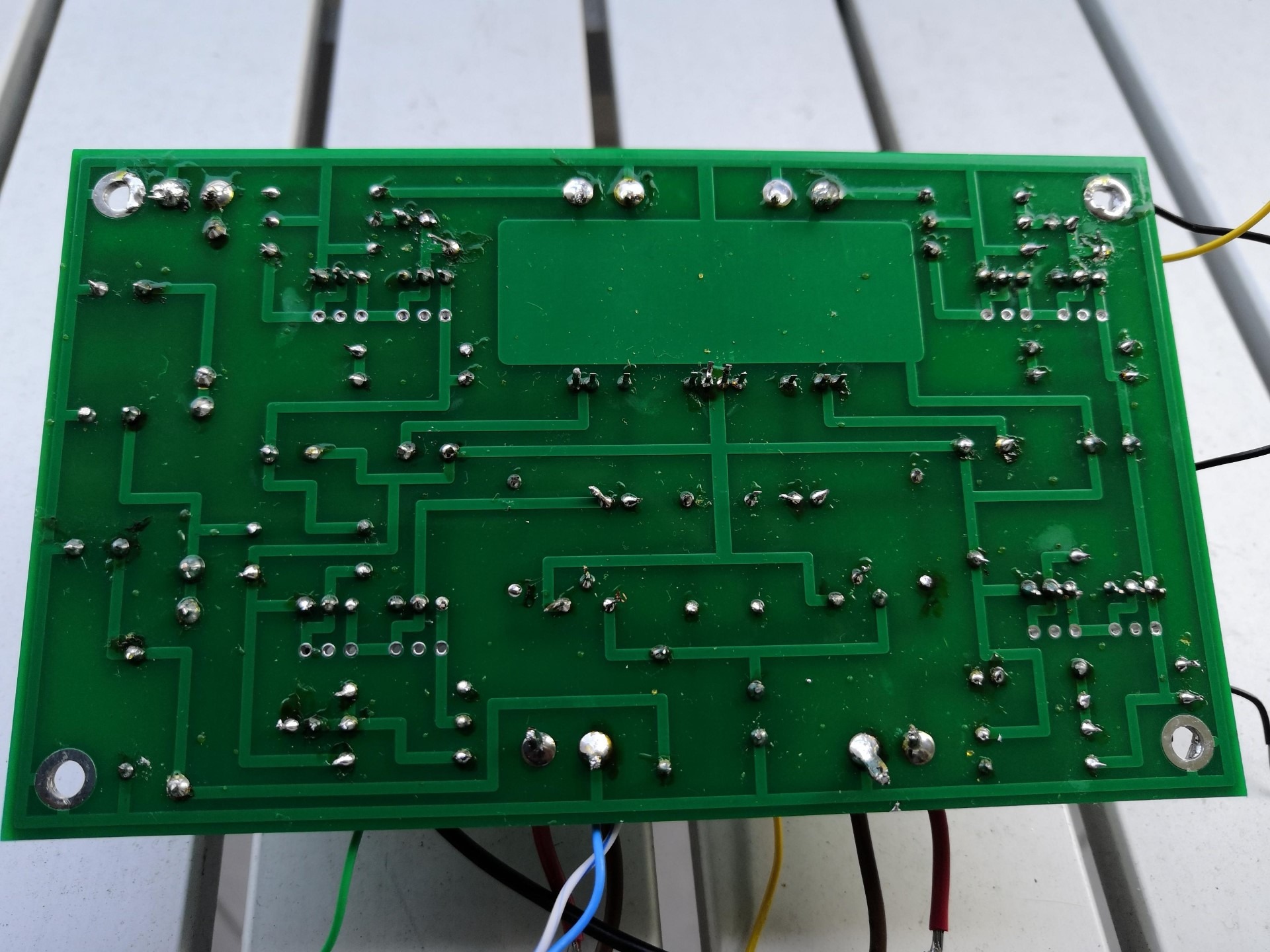

Here are more pictures.
I removed the potentiometers (Preh) from the circuit. With 9K8 and 9k55 they measure OK. They travel smooth.

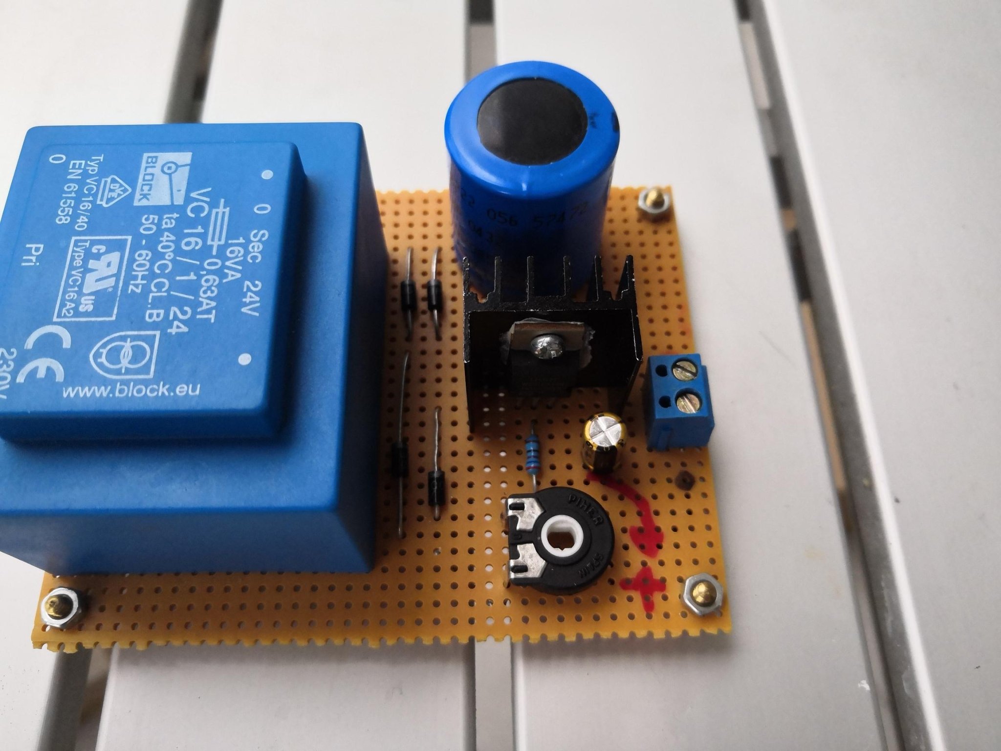

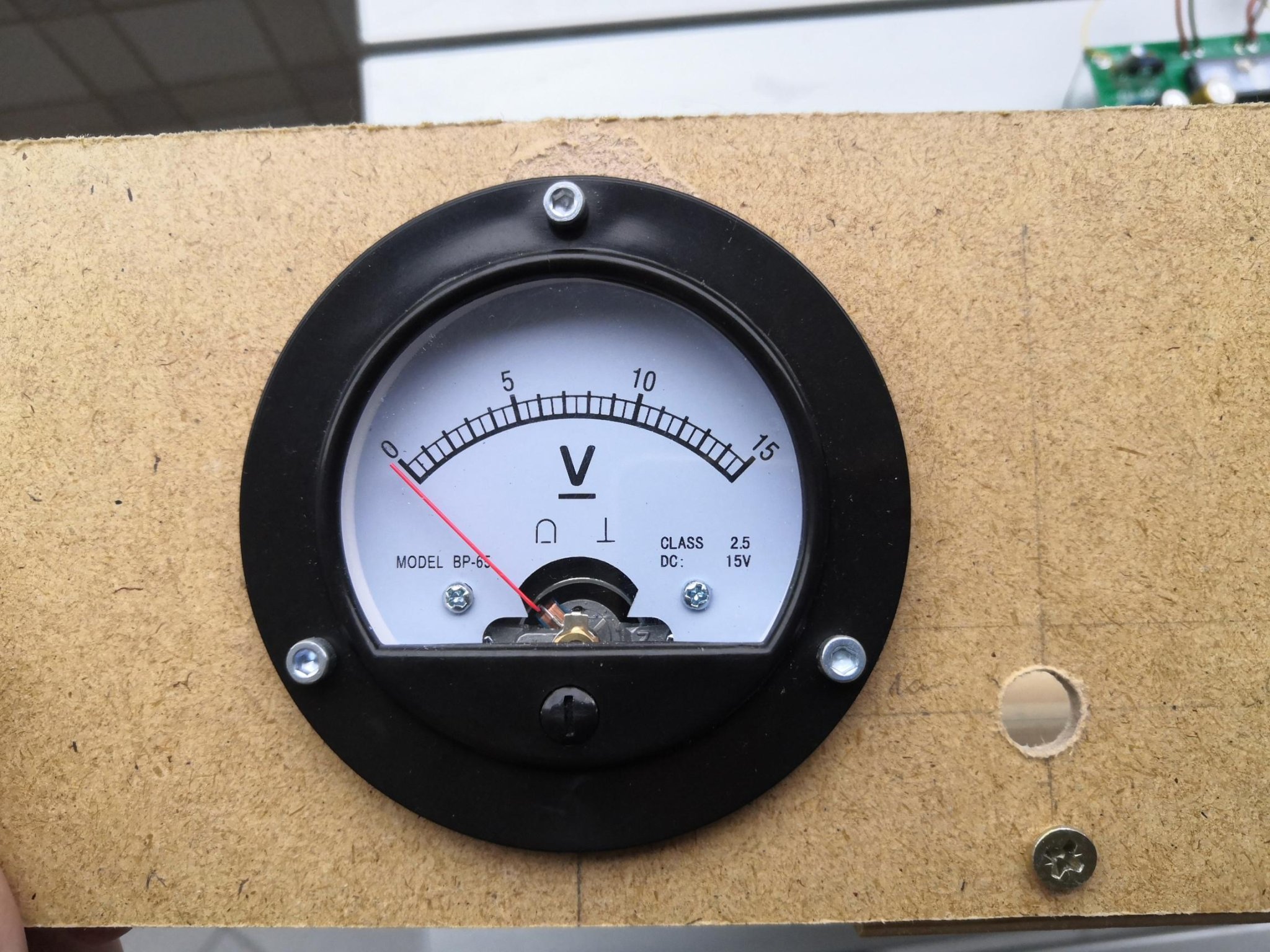

The power supply is nothing special. Just a basic LM 317 circuit. The meters are new bought from ebay.

Capacitors are inserted correctly. Resistors I measured in the circuit. They are all the appropriate value (except the 270 Ohm resistor which measures 150 Ohms in the circuit but is clearly marked 270 Ohms). The R's supplied with the transistors measure all the same about 92 to 95 Ohms in the circuit.
Transistors are Fairchild. So I think they are in the right position. I bought them paired from the diyAudio store. When I checked them with my cheap transistor checker, three of them were nearly the same, one measured differently. They are not shorted
16.9 V at T7 and T8 seem like the same problem in both channels. How can I proceed?
