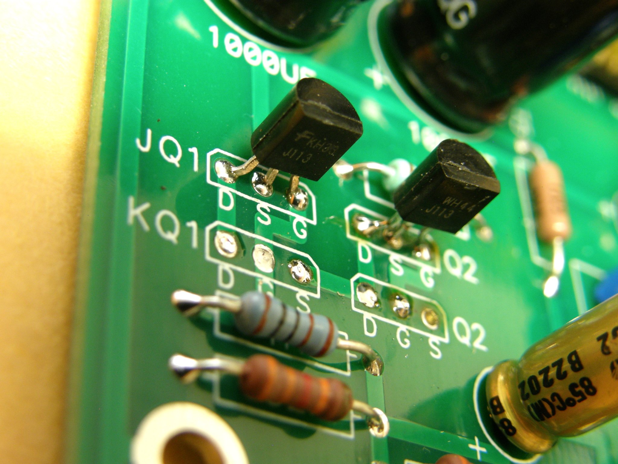

Ok, now to be a bit more serious, let me tell y'all a story. Got two B1K boards and transistors in the other day. Did all the mounting of the parts, and made a mistake that probably means I need new transistors. Yah, I put ALL of the transistors in the K positions instead of the correct J positions! Yah, applied voltage and at that moment (after neither B1K board would work) I felt like a fool. Getting the transistors back out is a crap shoot. So having done all that and 'carefully' placing the transistors in the correct J positions, I tested again. Of course, I had no confidence that anything would work. Test points T1, 3 and 4 are great. T5 and 6 are at zero volts, and T7 and 8 are both at 21 volts. T7 and 8 are NOT able to be adjusted by the pots.

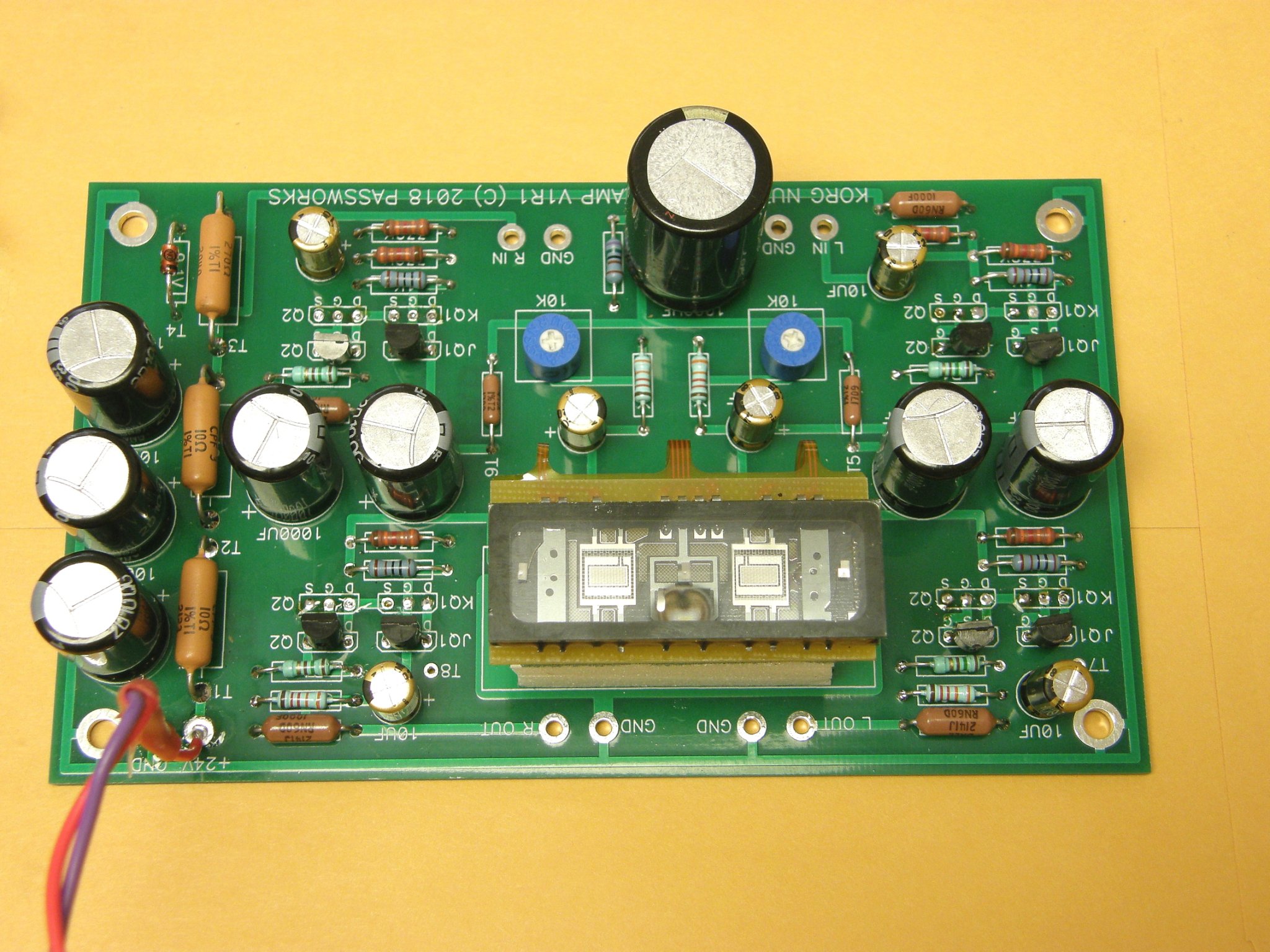

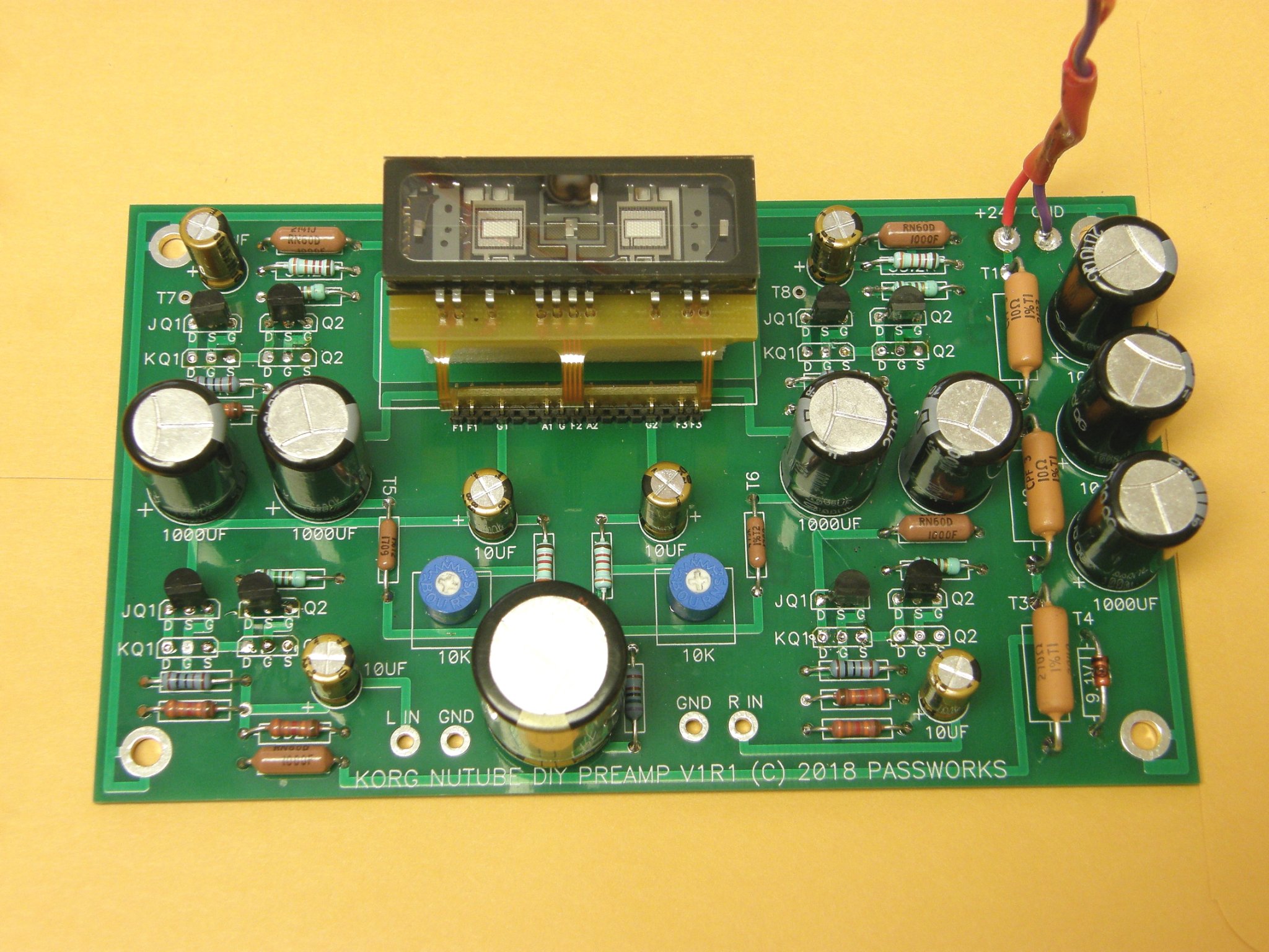

I am including a few photos that might help.
One more observation. The 3 watt 270 ohm resistor is hot, at 150F.

Pete connected both far end pins (which is as should be). He could have connected gnd in mid as well but it works the same.
I would start by reflowing.

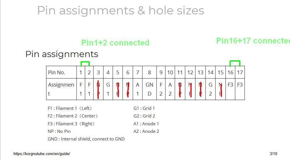

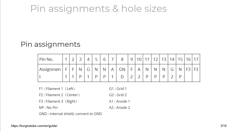

Hello elwood625,
8 connections are enough. The KORG NUTUBE has the the two outer left and right contacts tied together.
Pin 1/2 = filament 1 (left)
Pin 16/17 = filament 3 (right)
Cheers
Dirk 😉

Ok so I decided that I would lift the leg on the 475k resistor, and of course, I get the 9 volts on one end, and now I see the drop to 8.5 volts on the far end of the resistor. It wouldn't be a defect in the board, would it? I will check further. OTOH, I have a ballpeen hammer just within my reach...
I don't know whether to laugh or cry but THANK YOU! Am I that far gone? Ok, putting the ballpeen hammer back on the shelf now. It (the answer) was right in front of my freaking face. I may have to turn in my driver's license and voting card in the morning. Thank you for your patience. You saved a couple of circuit boards from getting smashed.
