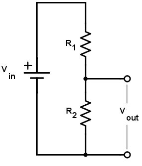

So if I understand correctly in practice with just a voltmeter I should put the old 50K pot back in the KB1 circuit, with volume maxxed out the Dac (there are no dB markings) and measure Vin and Vout at the pot at the loudest tolerable level? to get the R2 value of the divider?
YES
Apart that you don't need to measure voltages, just leave the unit unpluged and without changing the pot position measure the resistance values.
You need to measure R1 and R2 as described. Well, if you know that your pot is a 50k pot, then once you have R1 you can easily deduce R2...
Once you have R1 and R2 you can either go for fixed resistors with exactly these values (or close to, as Rs don't come in any value)...
...or, should you want to change the impedance to something close to 20k (for example), go for R1B and R2B that are sclaed down from the previous ones (same ratio, that what matters) and respect "R1A+ R2B" = 20k (instead of 50k)
Goind that way enables a 20k pot (or close to 20k, or any value you wish depending on what resistors you have handy)
Good luck
Claude
Hmmm... you may want to read the entire thread.
I don't think the original design "calls" for a 50k input impedance. I think this has been given a std value / as rough baseline, as many other bits BTW. 50k is a no brainer inded, but indeed the B1K needs to provide some load on the other side so you can't play it silly. I am quite confident any value between 15k and 50k should work in this set up, if just considering trhe B1. Oh, and if considering any modern digital source - but well, this isn't making a lot of difference probaby to your ears anyway in terms of noise etc.,, so take any value around of 50k if you are confident with it.
All I want to say is that you have flexibility there: don't take 50k as a critical spec, on the contrary. NP commented on that in this thread if you don't trust me... You have a flexibility here and don't need round figures... comes handy when chosing existing Rs...
Now, if you take R1 and R2 as you said, that is going to provide you with a small attenuation in terms of dB, as these, as your ear+brain combo, aren't linear. I mean don't expect a massive change in terms of attenutation or volume pot psition... Me, I wouldn't even bother with these values, they are within your practical safety margin.

So that would mean there is little headroom, ie. if you have a (correct) log volume pot you were probably already past 2 O'Clock...
In that case IMHO little point in building a voltage divider, you are close to needing full pot amplitude...

You do realise that 20k, or 30k, or 50k or "whatever Ohm" pot gives us just an info on its constant impedance as seen by the circuit upstream (source for you, the output of your DAC neglecting cable impact) and that has NO relationship whatsoever with the attenuation
(OK, being pedantic it has a small impact depending on the downstream circuits impedance, but let's not get into that detail, in our case it is quite independant of the attenuation).
In short a 20k log pot will give you the same overall attenuation range as a 50k pot roughly, what makes the attenuation is not the pot impedance but the position of the pot as it acts as a variable voltage divider...
Going for 20k Rs instead of your existing 50k Rs is likely to make no change at all to your ears (perhaps a very tiny less noiser, but quite pointless on a B1K IMHO).

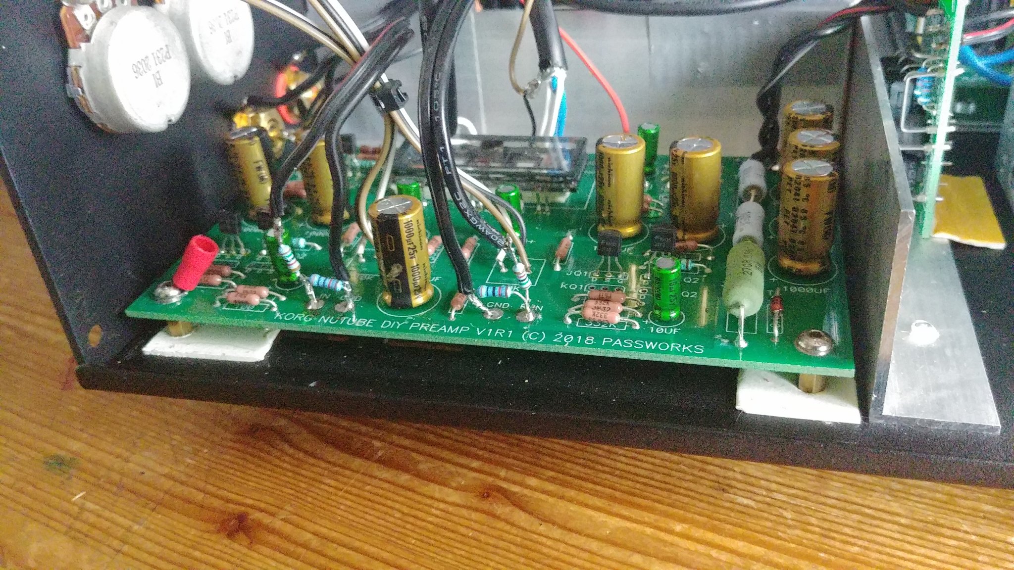

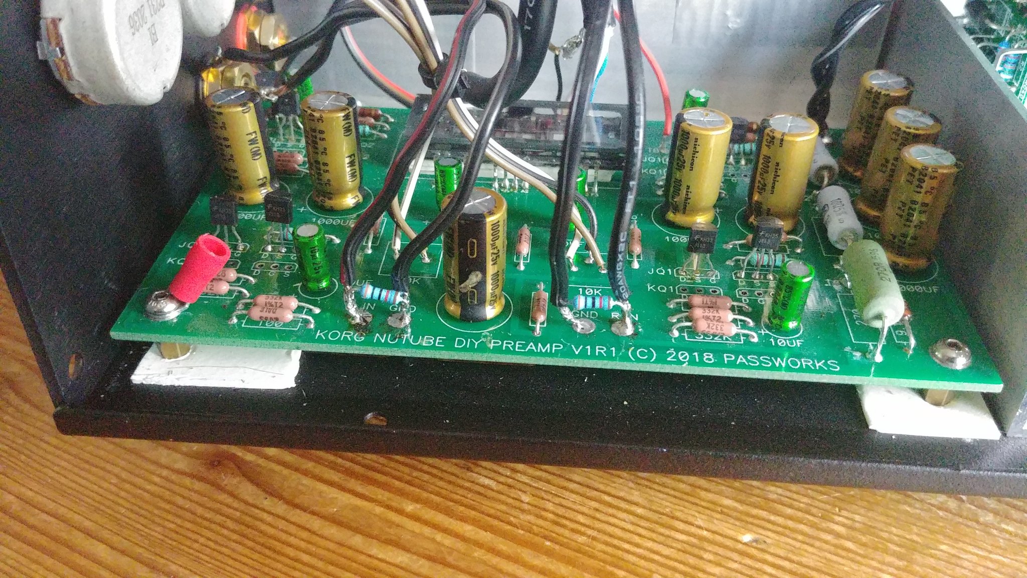

I think that in the future I will put the tube in a socket. They are no fun to remove as the leads are far from sturdy. Also, mounting could be improved by isolation if a socket were not attached to the board.
Some of you have placed 10 turn pots on the rear panel of the pre. That seems to be a very good idea for those of us who always want to know 'the difference'.
I've tried using the socket system you can buy for the Nutube (so no soldering is involved) but it's really a noisy connection. I gave up upon that concept. One of the best isolation techniques for the Nutube is Pete Millett's isolation mounting board. In my experience with building several varieties of these not soldering the tube directly into the PCB reduces noise & microphonic issues down to nil. JMHO. Cheers
