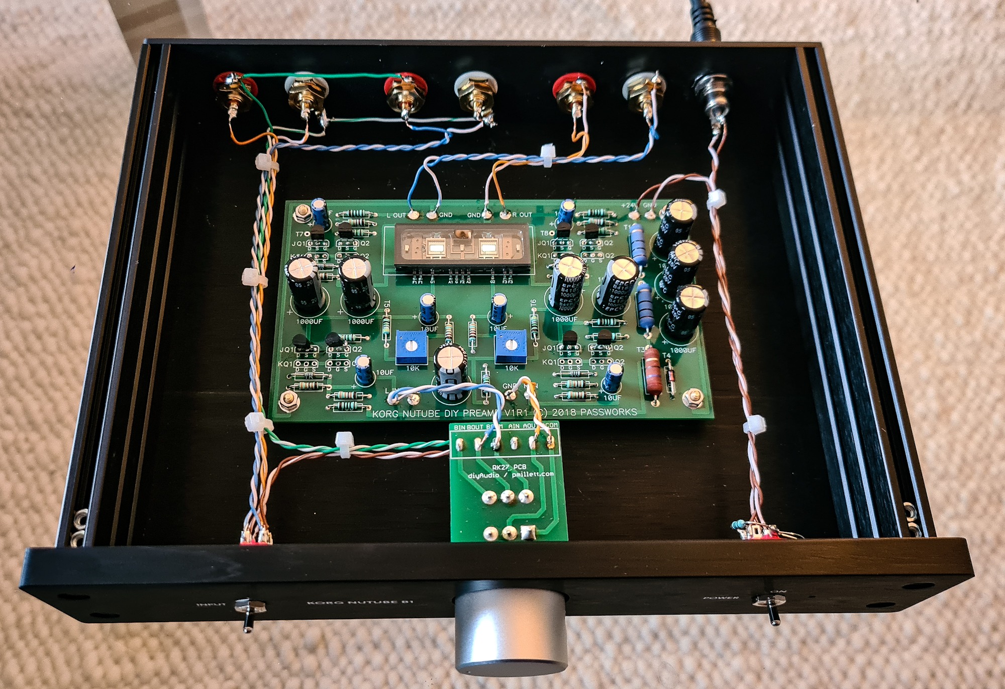

Finished mine just before NY, not my best work, but i expected worse 😀
Bias is set to ~9.5v
Bit dodgy filter board setup, its held by a hot glue. Signal Caps were too big to fit on original PCB, so they had to go flying above in "3D" arrangement 🙂
Mod's replacement as recommended by @Brijac , main resistors, main caps, and signal caps.
Only issue i have is bit with ground when touching pot/chasis, so il have to ground pot and filter pcb, at some later point 🙂

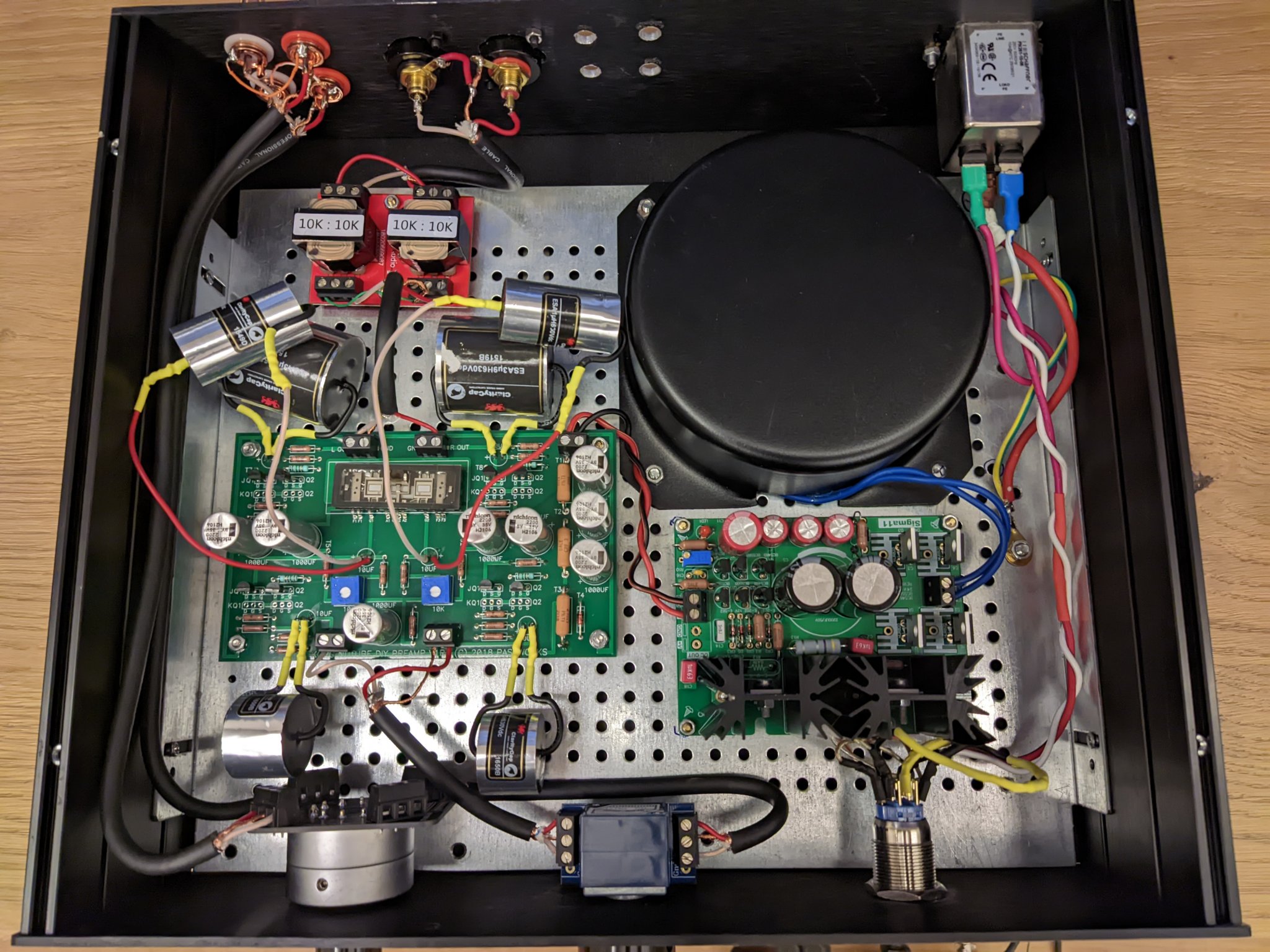

Similar "3D" arrangement here with my build which I finished some months ago. It sounds good! Have fun!! 😀Finished mine just before NY, not my best work, but i expected worse 😀

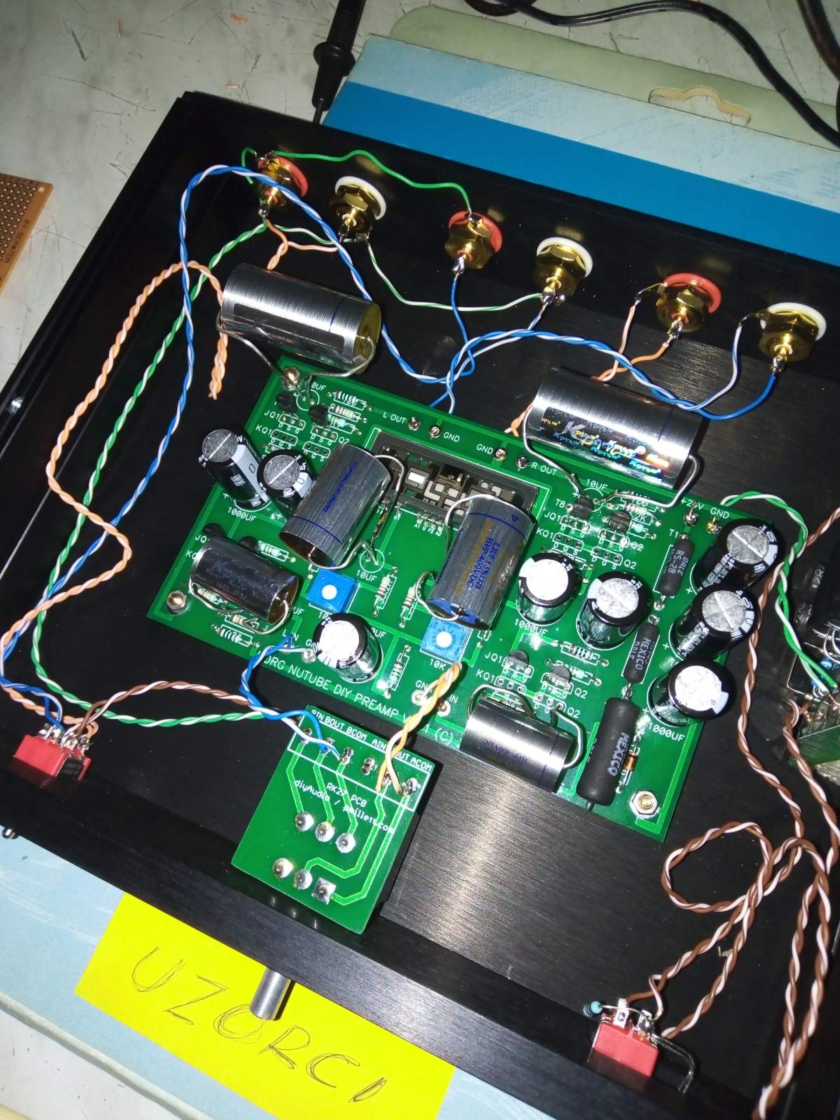

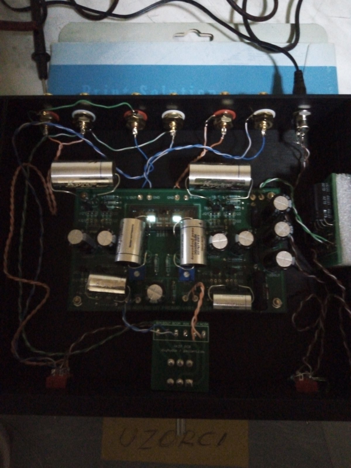

Yeah, that was a quick one, it took 6,5 hours 😀
Green glow, no smoke, so measurements can start 👍
Many thanks, also for the advice 🙂Nice wiring, but you might see a little crosstalk on the input.
I can't hear nothing until now, apart from great music
But I will separate the input wiring, just to be sure there is nothing. However, I use/need one input only.
