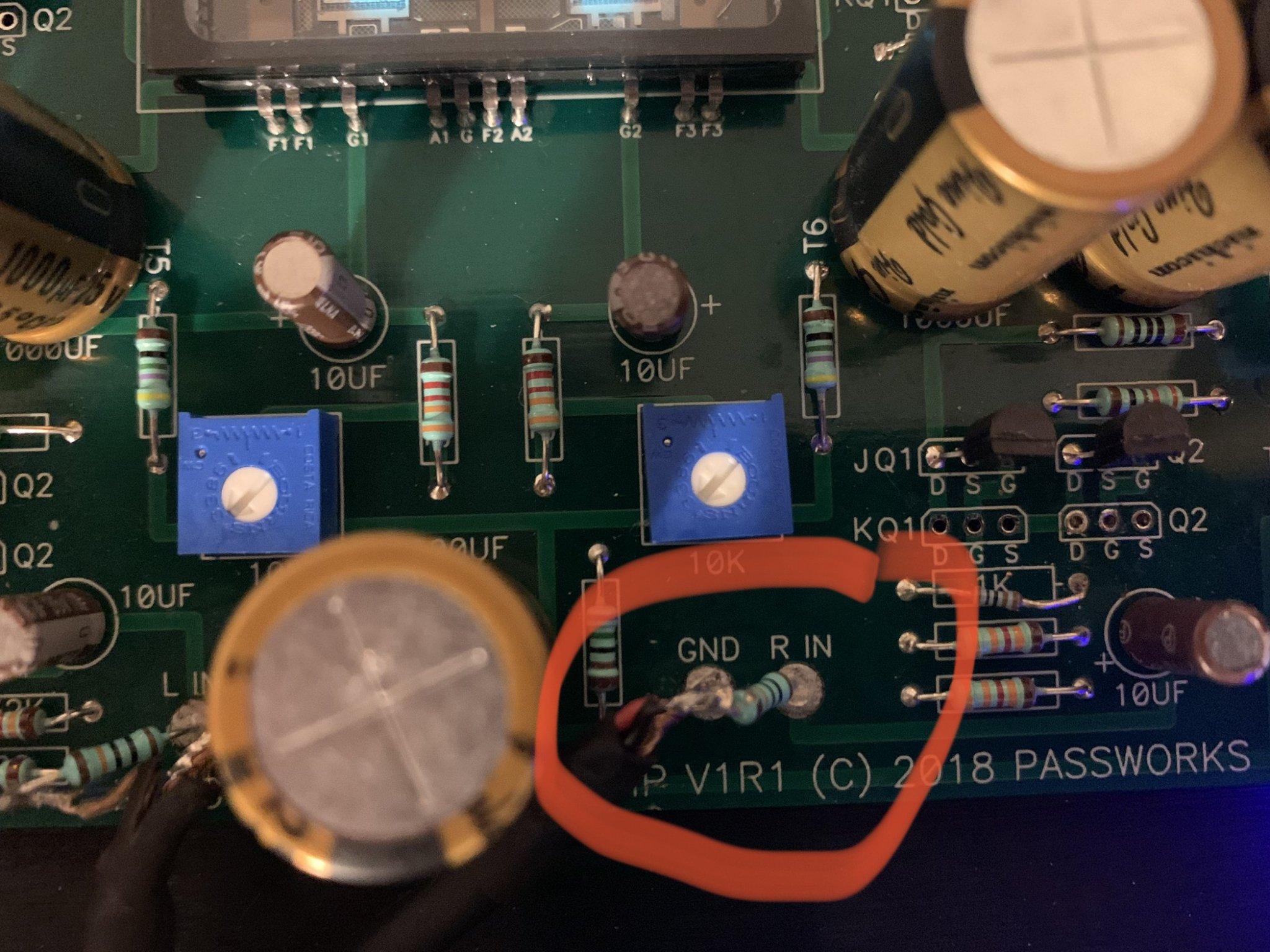

Hello folks,
I wanted to bypass the Alps 50K pot to connect the B1 Korg in series between my Metrum DAC preamp which has already a volume control and the ACA Mini amplifier.
Assuming it's not as simple as just disconnecting the Alps and adding a 50K resistor in series to the B1 input.. My Preamp/DAC has low output impedance of only 100 Ohms. Tried the bypass with a 100K resistor and the volume control gets quite loud at about 10 o'clock or 1/3 of the way.. Concerned here about the impedance mismatch between the 3 components affecting audio performance. Only planning to use the Korg with one input for digital so fixing the input makes sense as I don't need 2 volume controls.
Have you guys tried the B1 Korg as a "buffer" only without a pot ? I find it warms up the ACA nicely for long listening sessions much less fatiguing for my old ears than the ACA mini connected straight to the DAC.
Any experiences with this?

Thanks for the response. Just to be clear, the 20K resistor is going between the Ground and the L and R line input on the B1 Korg? The way I have it wired now is in-line with the input to either L and R. Which method is correct to maintain 20K input impedance?
Quote :
"Assuming it's not as simple as just disconnecting the Alps and adding a 50K resistor in series to the B1 input".
The R is not in series to the input, but runs from Line to Ground in parallel!
If in series then indeed you could have some possible impedance mismatch and load problems sides B1K... If you put the R in teh right place, there is no reason you shoudl experience a problem based on the data your provided.
The loudness is another matter, linked to your gain chain. Indeed, the B1K has a lot of gain, possibly more than you will need and possibly in your set up a problem for a 2V source (and a prob anyway if using these 2V inputs due to distorsions once passed 4V at the B1K output). In that case you can't use wisely your volume control, better put a voltage divider instead of a pot at the B1K input, to give you more usefull digital vol control.
Nearly there, 2 more resistors (and replacing accordingly the 2 others you fitted) is all you need, but calculate what you really need as you don't want to overdue your attenuation.
Good luck
Claude
OK, again...
2 different matters, impedance andB1K load on one side and gain chain (volume setting) on the other
Quote: "Where shall the 20K resister be mounted?"
=>NOT where you did. Signal Line input goes into B1K Line input (as it should), Signal Ground to Ground (as it should), and your 20k R goes between Ground and Line. So in parallel, not in series
Do that first, the rest is more complicated and you will need to address that first to go step by step safely.
Then you will still have a gain chain problem, that is the volume adjustment issue you mentioned... should that really be one to you of course. That is adjustment of volume. I suggest you consider digital volume control doing low attenuation levels, running in a fixed attenuation thanks to a voltage divider. A bit like a volume pot that is frozen in a given position, hence made out of 2 Rs per channel. Both attenuations together are IMHO a very good puristic non expensive way to address volume on a digital source with volume adjustment.
