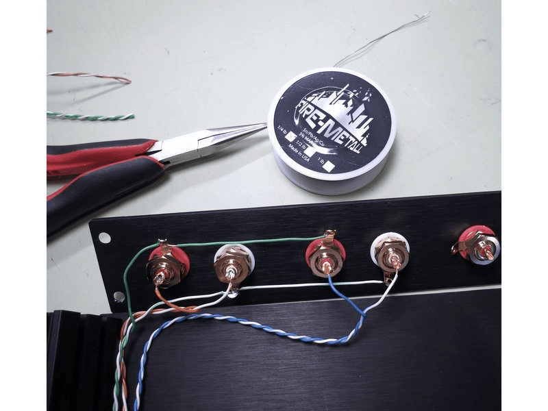

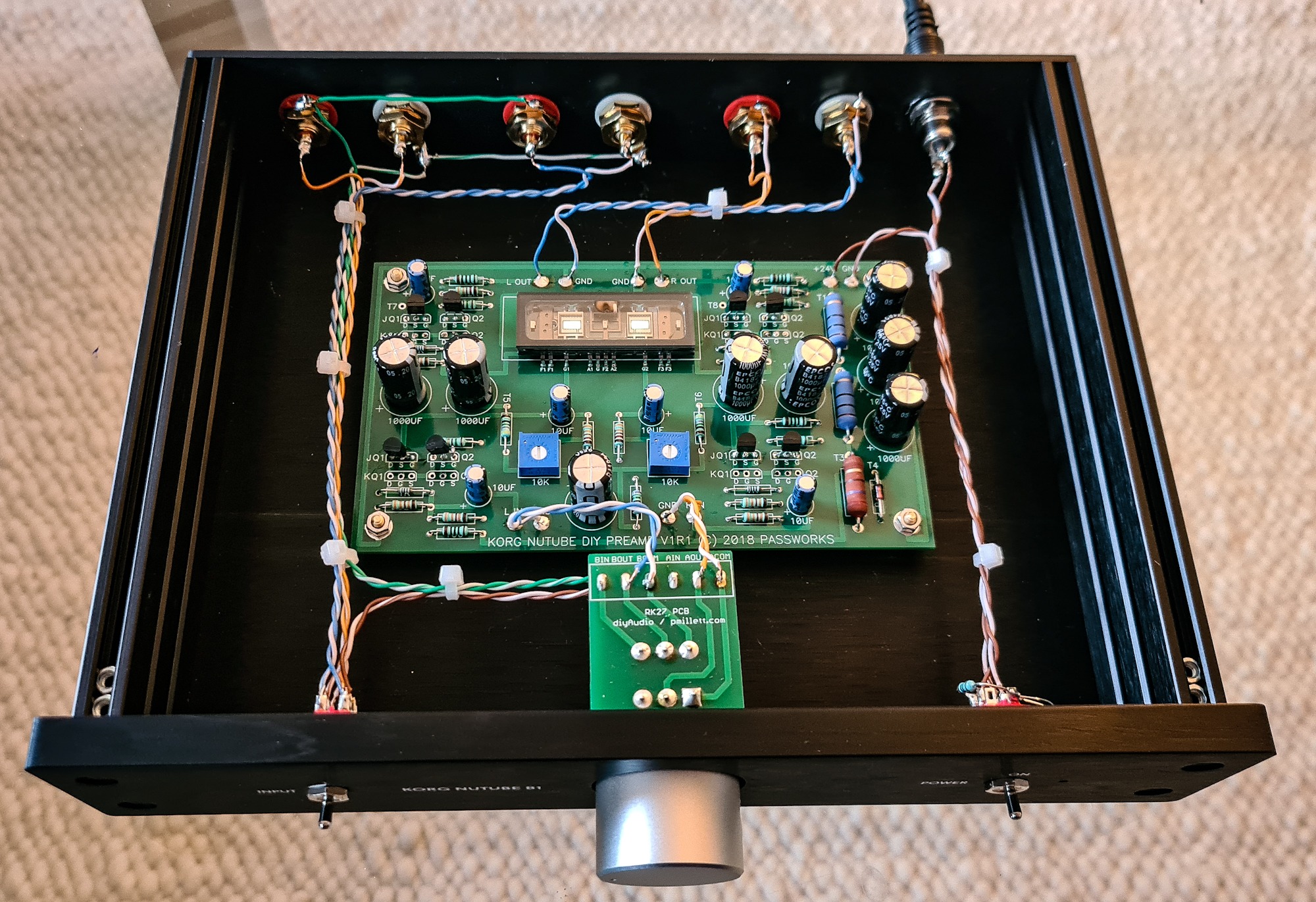

Hi, what did Nelson mean when he said you might see a little crosstalk on the input, I looked at the photo's in the build guide and I can't see any difference. Thanks.Yeah, that was a quick one, it took 6,5 hours
Green glow, no smoke, so measurements can start
Exactly what Ben Mah wrote. However, I really can't hear any crosstalk.Hi, what did Nelson mean when he said you might see a little crosstalk on the input, I looked at the photo's in the build guide and I can't see any difference. Thanks.
Nevertheless, I will change the wiring soon, because I will change some other things too.
What I don't get is that this is the photo from the DIY build guide, it too shows input jacks twisted together.The left and right channels input signal wires from the input RCA jacks are twisted together.

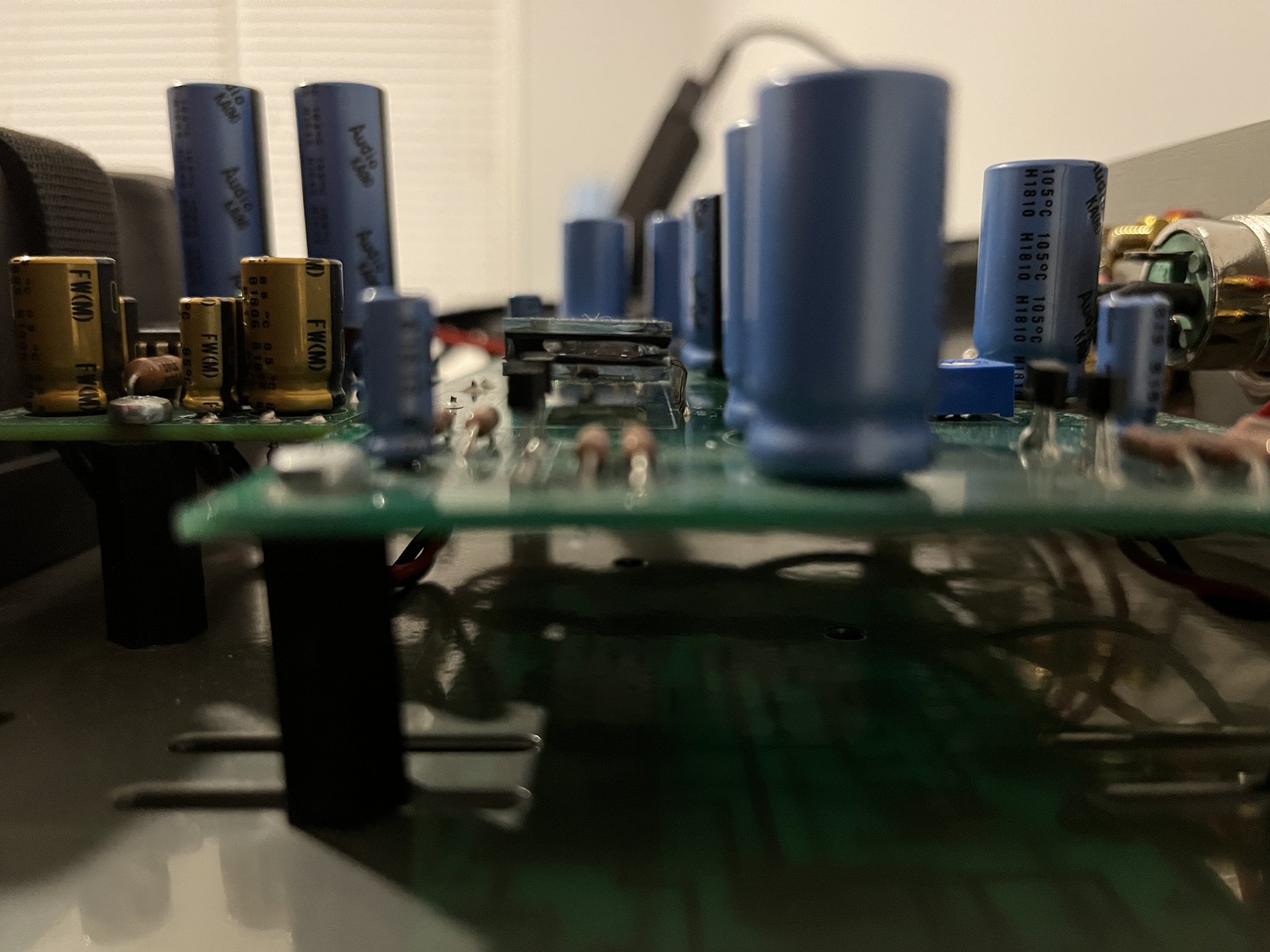

Long ago, I recommended the idea of floating the Nutube. This recommendation was based on my experience with it taped down (as originally instructed). So I finally bit the bullet and followed my own recommendation. Removing the foam tape was difficult and risky. However, it solved pretty much all microphonic problems. Floated is undoubtedly much better than taped.
