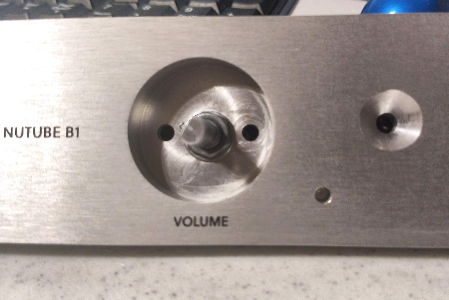

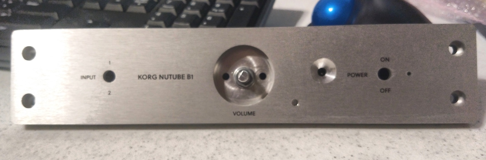

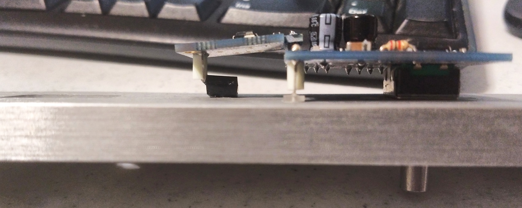

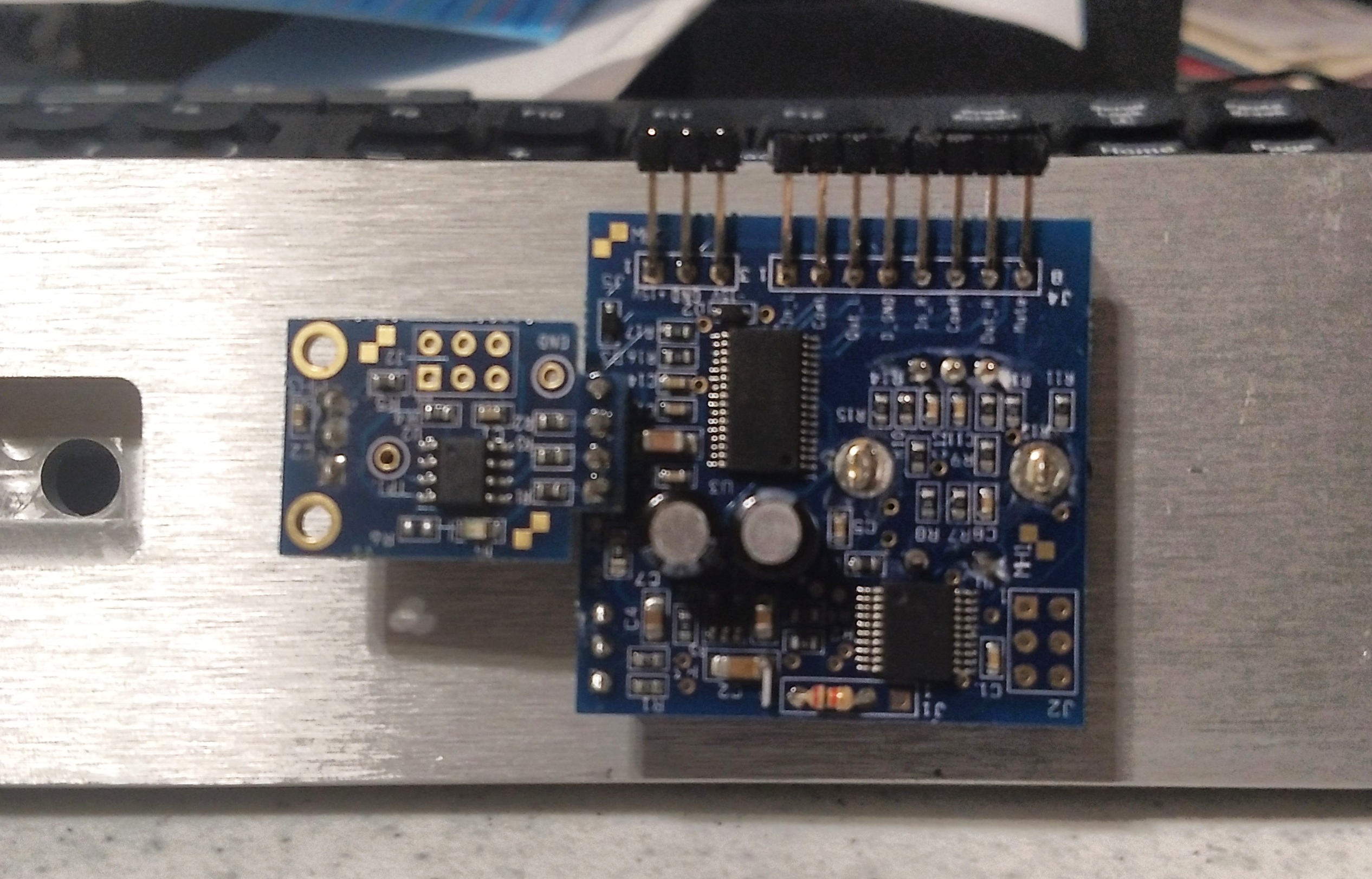

Since others seem to be headed toward using this control in their Korg builds I thought I'd share my mechanical installation of the IR version of the control into my standard Korg chassis.
I had to drill two holes -- one for the LED which shows balance position, and one for the IR sensor.
The LED fit perfectly in a straight hole drilled to fit the diameter of the LED.
For the IR sensor, I drilled a straight hole the diameter of the sensor "bump" and then, because the front panel is 10mm thick, I used a counter-sink drill to open up the hole most of the way to the tip of the sensor. In order for the sensor to fit exactly in the hole I had to first bend the daughter board a little bit to get the sensor closer to the backside of the panel, and then bend the sensor legs a little bit in the other direction to get the sensor to sit flush parallel to the front panel.
Lots of measuring and re-measuring, and it fits perfectly.
Note from the images that the right-angle connector pins will not work in this chassis, they will have to be replaced with straight pins or removed so that wires can be soldered directly to the pads.
Now waiting on some further parts so that I can wire it all together.

Hey that is great! Looks awesome so far. I am waiting on my control board and my dc/dc converter. Converter will not be here until around the 24th or so. Thanks for sharing. Love to see when it is done🙂

Looks great. Are you going to split the incoming 24v supply into +12/-12v for the muses? Let us know how it sounds...I would really like to have the balance control the muses chips have.

Very nice wapo54001. I ordered the same volume control yesterday and digging through my parts box I found a suitable power supply. Looking forward to your impressions of the controls function.
I'll use the 24V 500mA supply. The converter itself draws 11mA at idle, the encoder board and the IR board together draw < 15mA (at +/- 12V) so the supply should be able to handle the load without difficulty.
Since I'm not stuffing the LDR setup in there I will use the existing pcb holes for the Korg and try to install the converter (1x1x1/2 inches) on the side wall next to the Korg power resistors.
I'm considering wiring the power switch to be always on (making the switch on the front inoperative). I'd rather consume the power than deal with inadvertent switching and the resulting thump through the system, or is this milder than I imagine it to be?
