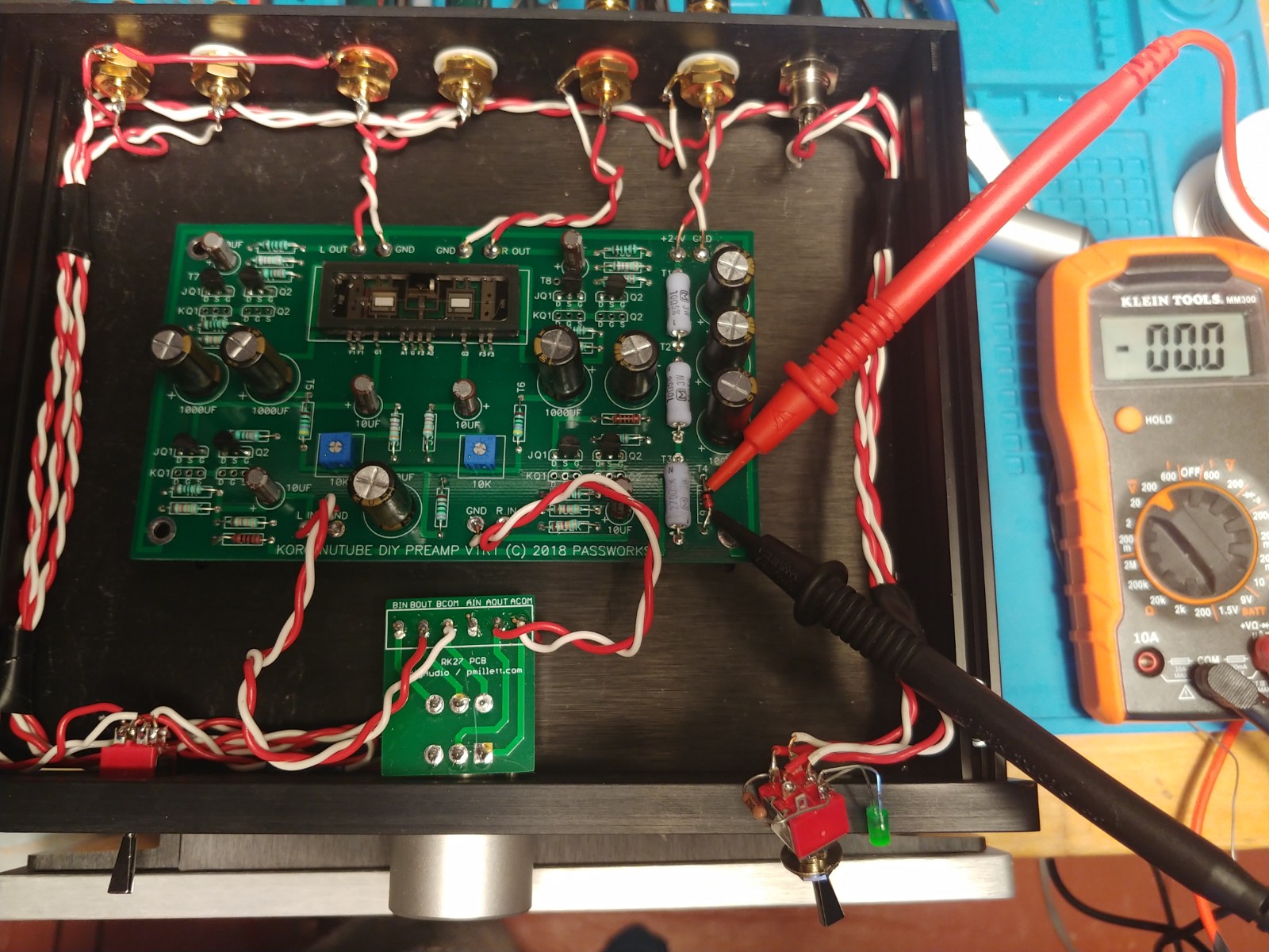

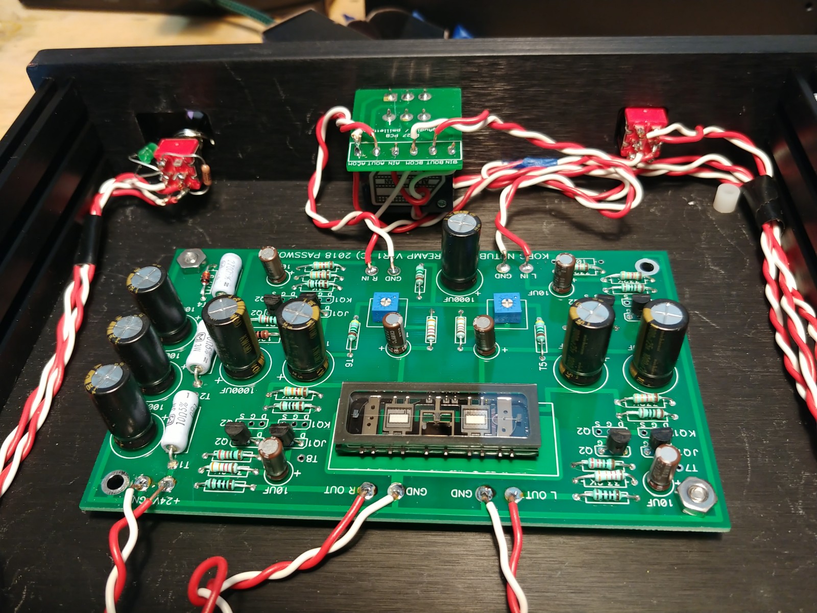

Good evening,
I am testing the PSU (step 42 in the instructions) for the Korg nutube and am getting funny readings. I power on, the LED flashes bright green then slowly fades. I connect the multimeter to the places shown in the instructions and it jumps to 40-50, then settles down to 24 briefly, then down to zero. Oddly, I twist the plug into the power jack and the LED grows bright for a moment, I read power briefly.
What is going on? is it the wall wart, the power jack, the switch or the capacitors or resistors?
Any help would be much appreciated.

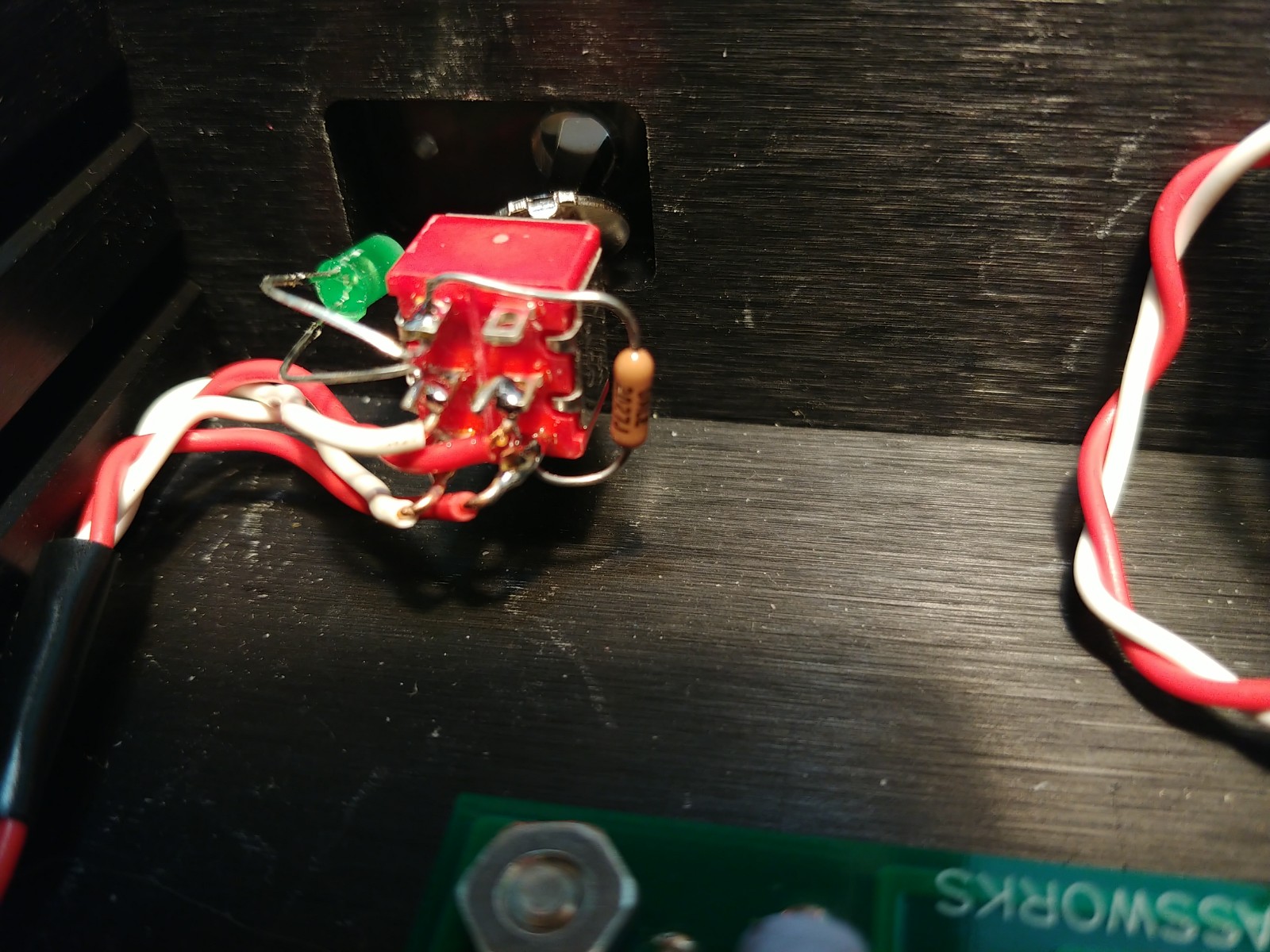

Berkbear - sounds like a poor connection on the PSU jack or in the switch wiring.
Also, what is your meter set to where you can read 50? 50 what?

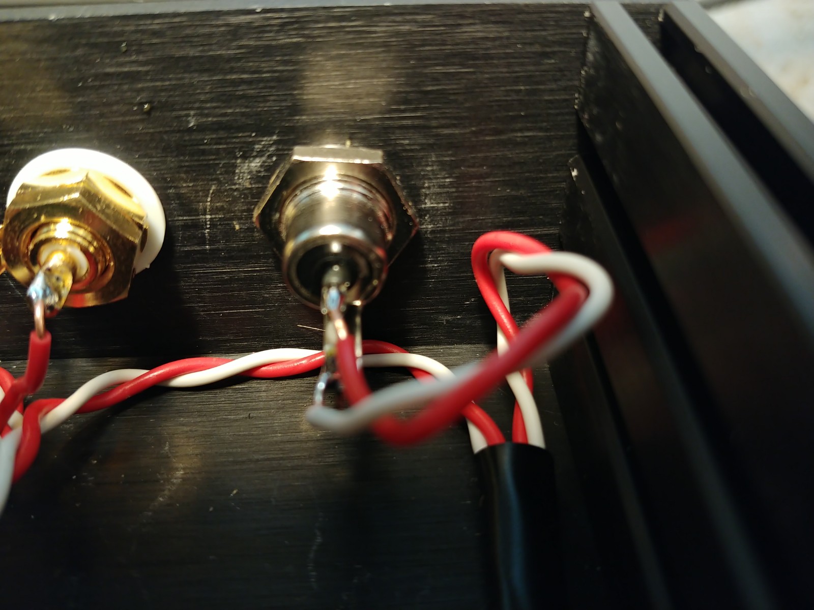

Thanks, 6L6. I have it on my to-do to send you a “thank you” for help with the Pearl.
Attached are photos of my wiring. Unfortunately, I moved ahead and completed all steps. I have set the multimeter to Ac Voltage (less than 600V.)

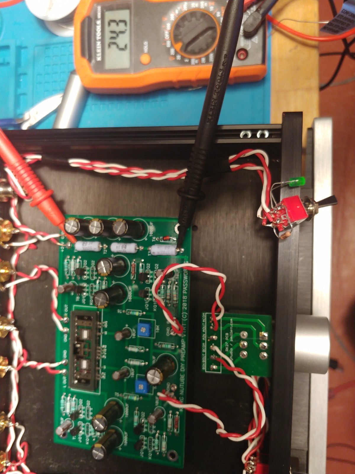

Okay. It was the wall wart. After cleaning up my wiring around the switch, I realized I had an extra WSU240-0500 from the ACP+ I built. Powered it up. Hooked up the DC voltage on the meter, not the AC voltage and PRESTO 24.3V. LED shined bright.
So happily, I moved on to test the Diode and... NOTHING. Could it be the diode was ruined by the old wall wart? Is it a faulty diode? What is the best way to verify this beyond checking voltage of the diode?
checking voltage at zener is enough for test
if too much, no good
if none, no good
presuming that there is voltage at other end of preceding resistor
if none, no good

Thanks, Zen Mod.
To be clear, I am measuring 24V at the resistors, but am not measuring voltage at the Zener diode. Nor is the nutube glowing blue. I can assume (most likely) then that the cause of the nutube not glowing is because voltage is stopped at the bad diode, correct?
I say most likely because after I posted the pic last night I realized I was missing a 100 ohm resistor that I have since installed on the PCB.
Unless there are any other suggestions, I will order another Zener Diode and hope for the best.

remove diode out and test with diode test, if nothing else
it must show something bellow 1V drop
if not, it's toast

Thanks, Zen Mod!
As you can probably tell from my twisted diode, I did remove from the PCB and diode test. Unfortunately, nothing...toast. And so, I guess no "blue glow."
I placed my Digi-key order for the following and will roll the dice again next weekend.
1N4739AFSCT-ND
1N4739ATR
DIODE ZENER 9.1V 1W DO41
+ (4) 100 ohm resistors

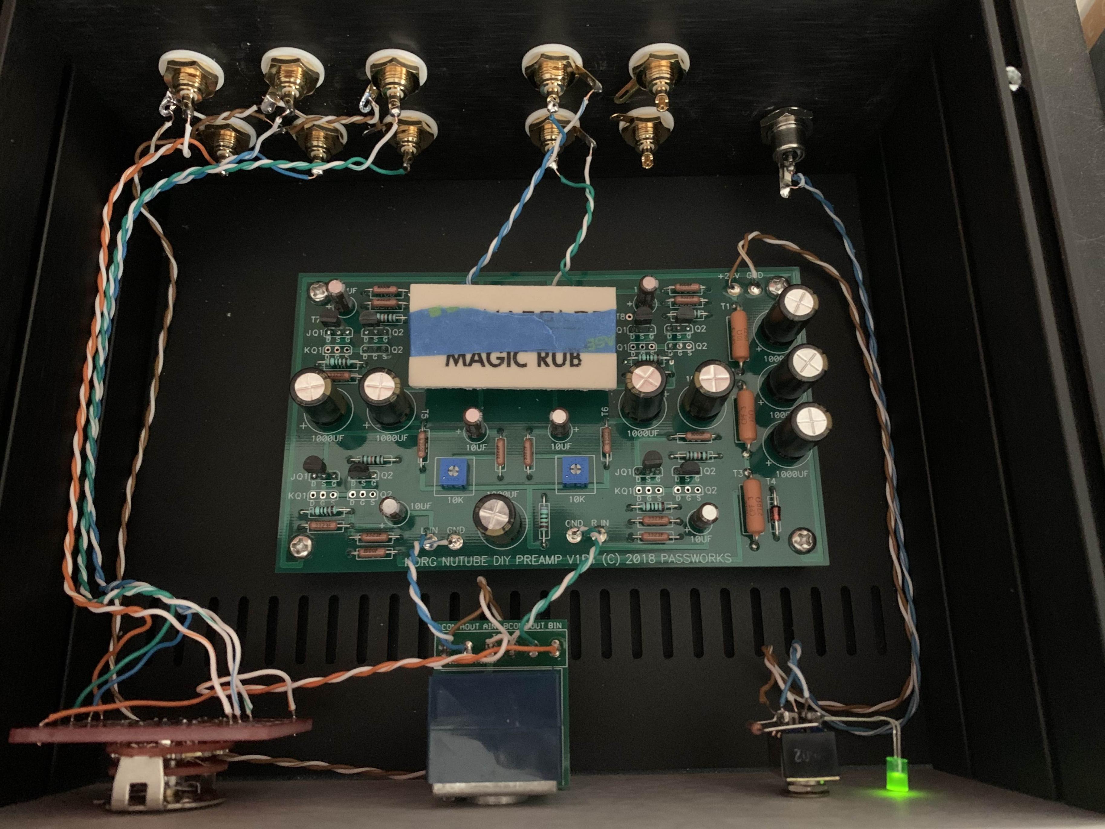

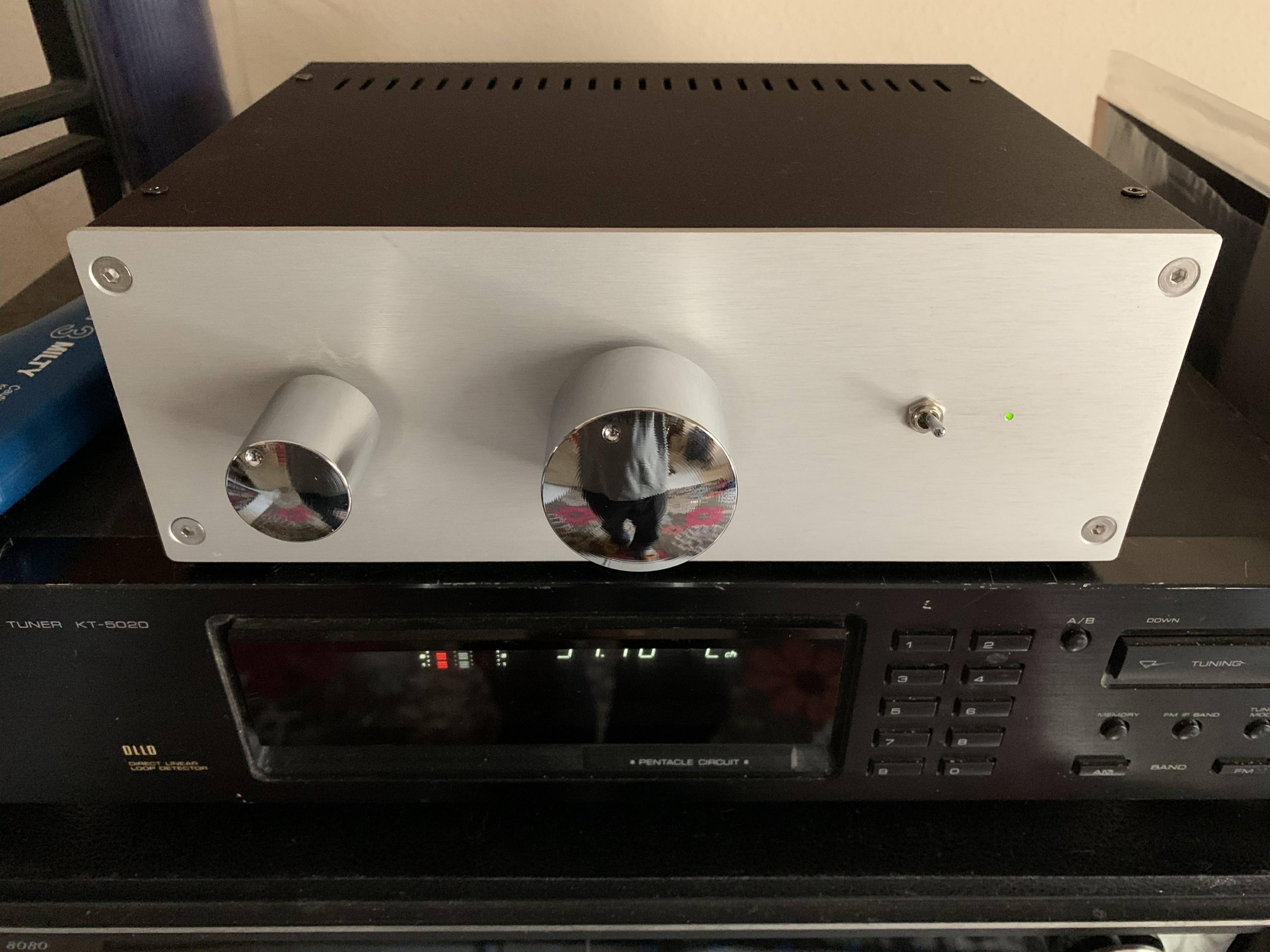

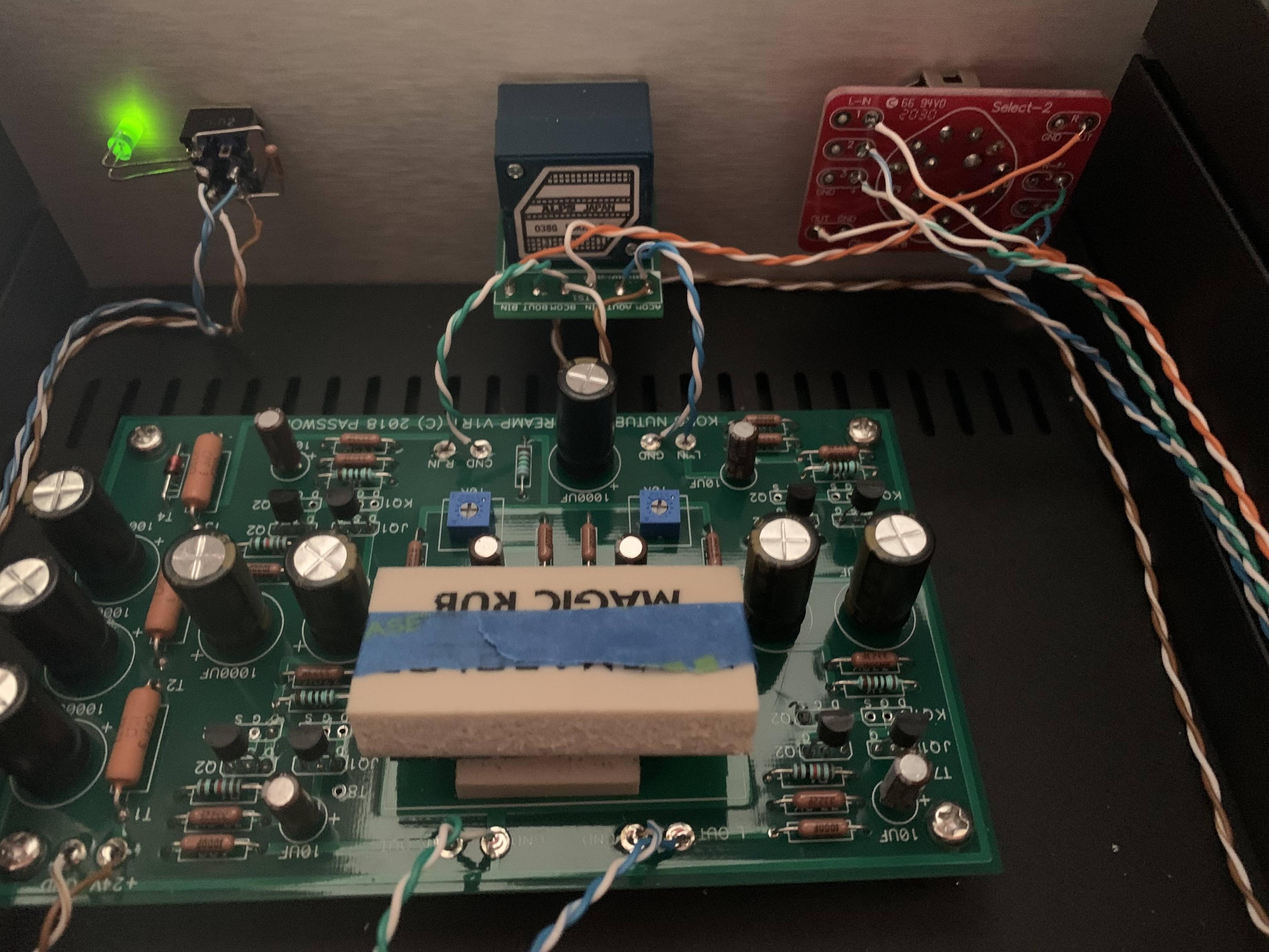

Coincidentally I finished this one last night.
I may be slow, but I'm steady.![]()
That looks pretty good - you ever think about doing this professionally?
This board looks easier on the eyes than the kit version.

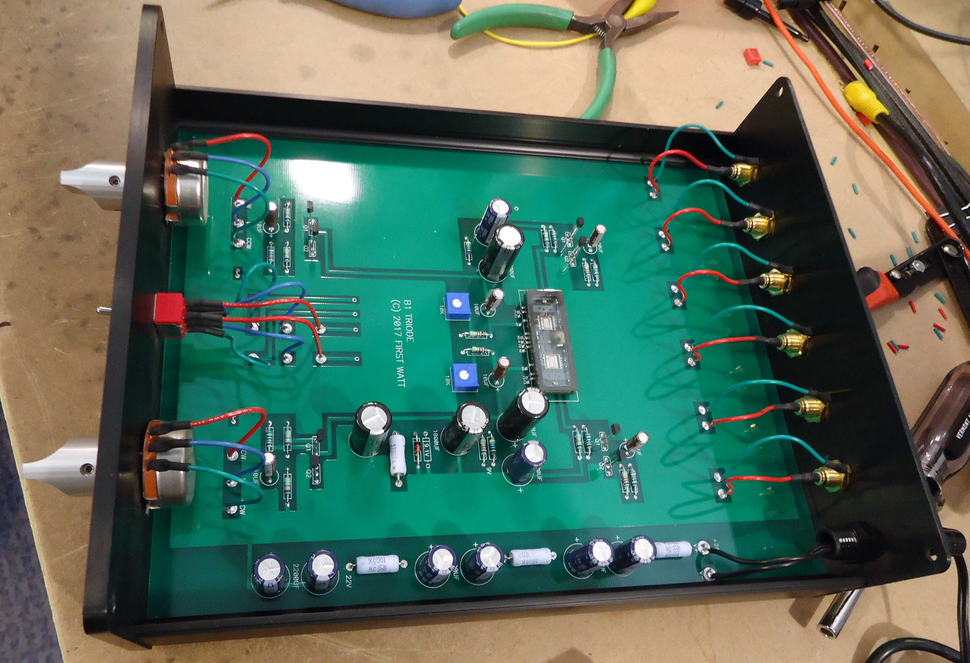

- B1 with Korg Triode
