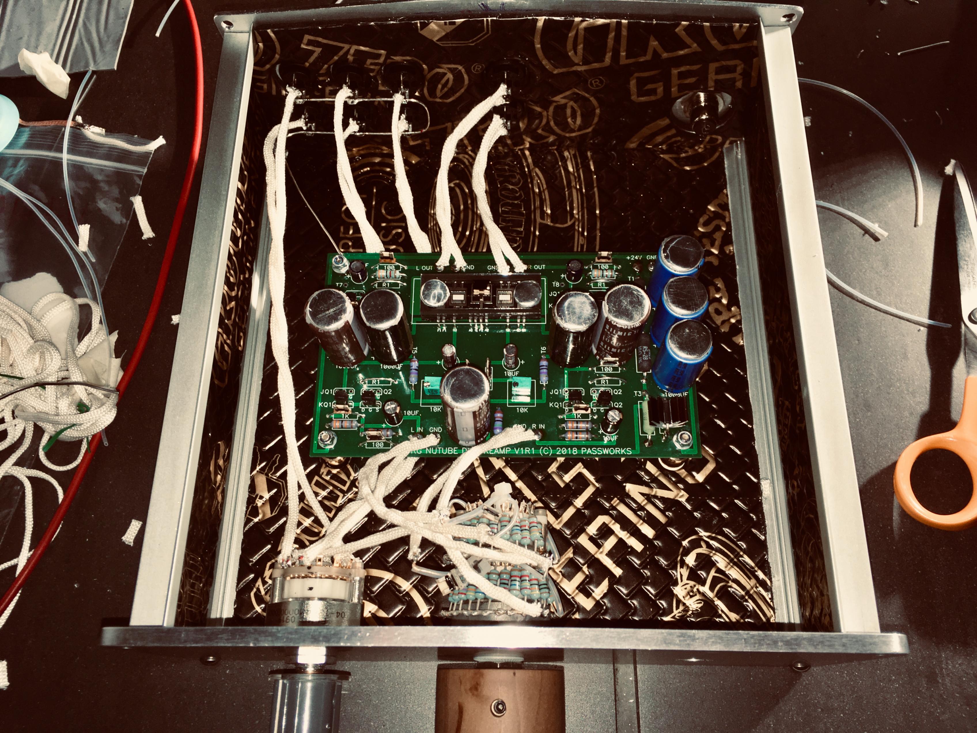

Played for 500 hours now, love it.
Runing at 11.5V.
Change the signal cables from 0,5mm solid silver+teflon to 0.5mm solid silver+silk tube. That give so nice natural sound in high freqency.
