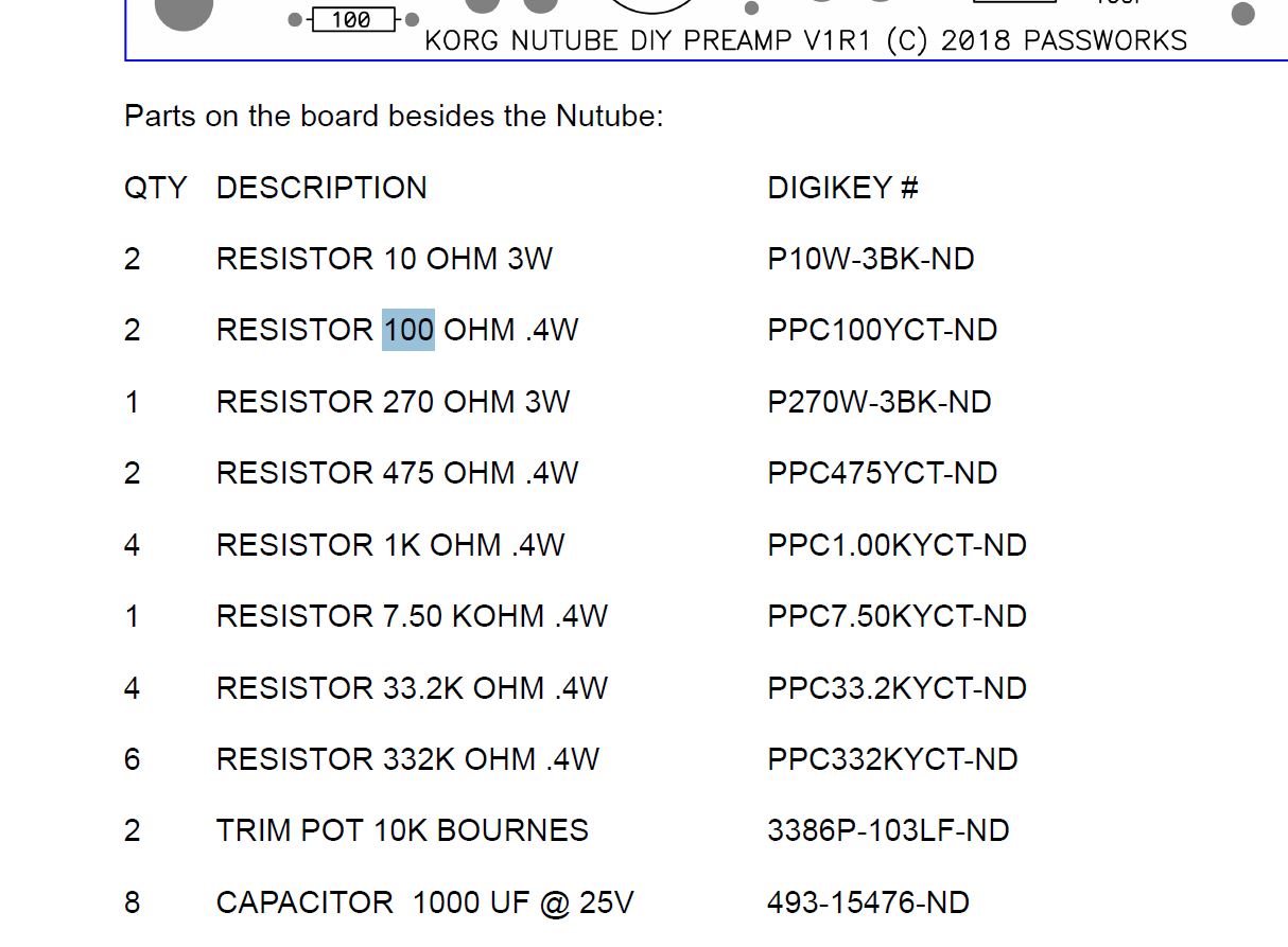

I have started stuffing my PCB and all was going fine until I got to the 100R resistors. I ordered the two specified in the BOM and find that there are four locations for 100R resistors on the PCB and the schematic shows two per channel.
Is there something here that I haven't grasped, or is the BOM simply wrong?

I don't have a specific answer to your question about an error in the quantity indicated, but the easy thing to do in the future is just buy more than you need. The minimum number of resistors that I order is always 10, sometimes 20. Yep, it costs more up front, but prevents frustration, an additional shipping charge, and waiting the extra week for more parts to come in the mail. Nothing like an $8 shipping charge for $0.20 worth of parts...

This is my first post-move project, I've made a couple of blunders, the worst is misjudging the height of the Korg chassis so my beloved LDR volume control with display won't fit. And tubes is a whole new world for me so not as confident as I might be, and since there seem to be other "adjustments" on this board (fets & resistors) I thought I'd better ask before moving ahead. But the more I look at the schematic it's pretty clear that all four 100Rs do belong there.
