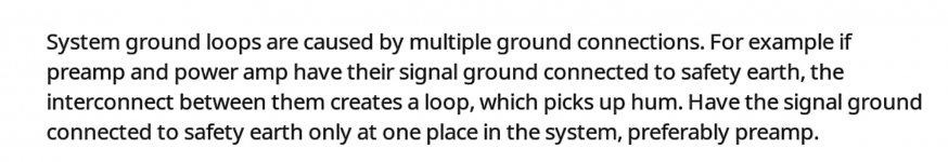

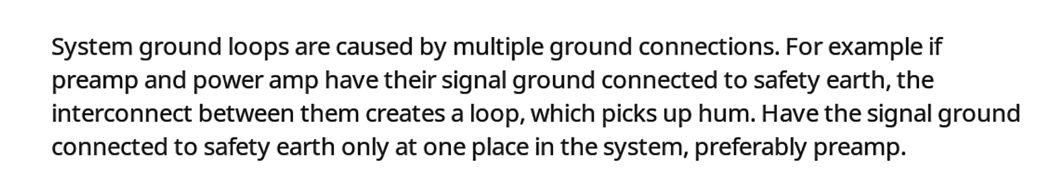

VinylSavor article >>Trouble Shooting Hum<< with step by step approach solutions VinylSavor: Technical guidelines
Edit: Article important information extract
