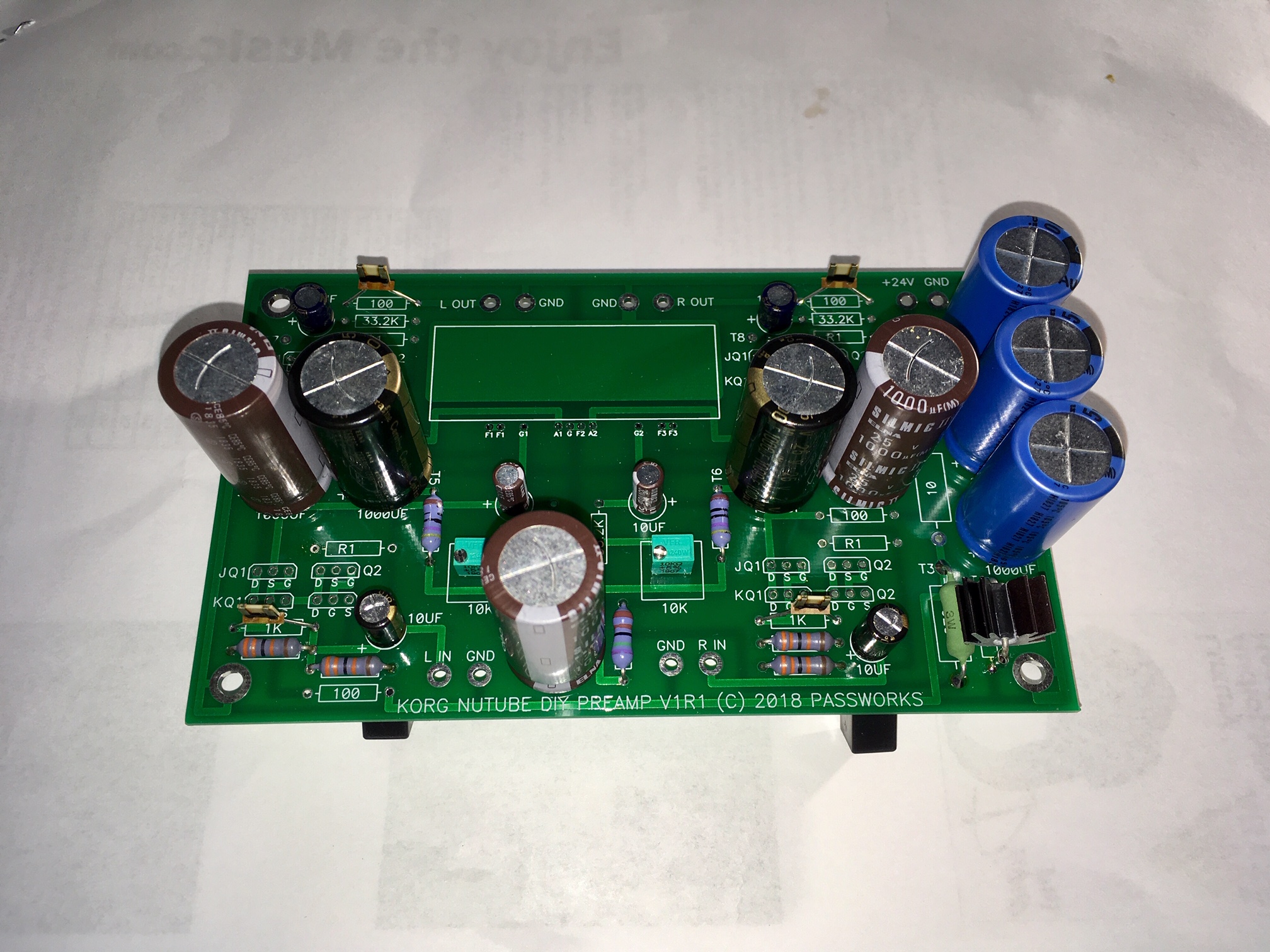

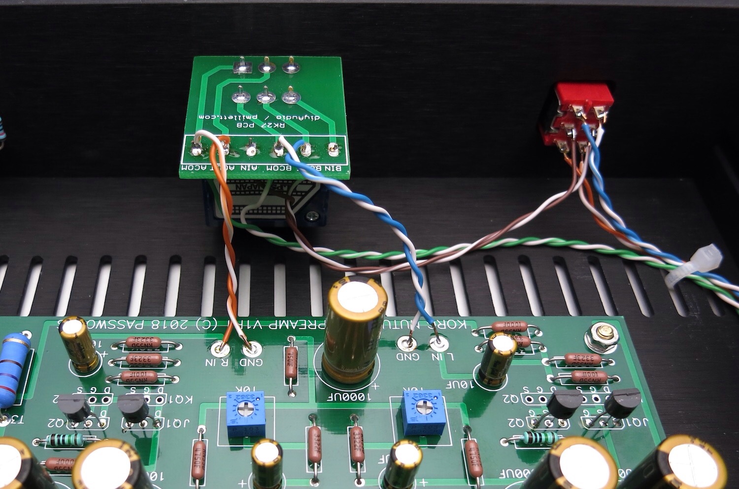

B1 with Korg Triode
tried with any other amp?
even active PC spks will do the job for test
I did not take the risk of running with any other amplifier. Looks like the old test speakers voice coils are damaged testing this preamp with the loud sounds coming in, and I do not have any powered speakers. Will give another shot by removing from this enclosure and putting it outside as my other Korg which is my main preamp works perfectly fine with a LDR source/volume control. This is for a friend that I have built in a case similar sized as in the store.
Part by part, wayting for some resistors and pot from HFC.
Fire it up before Christmas :santa2:

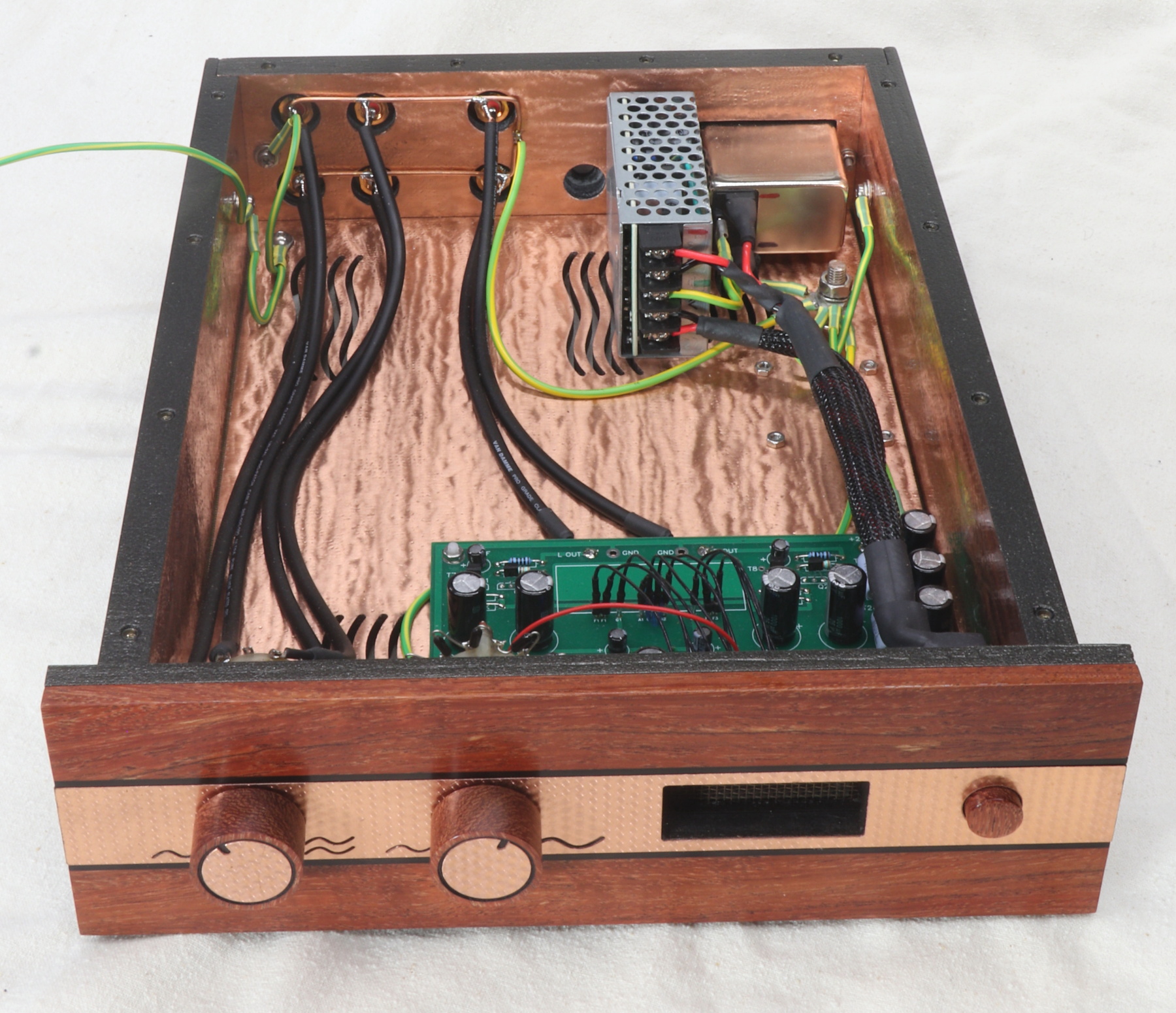

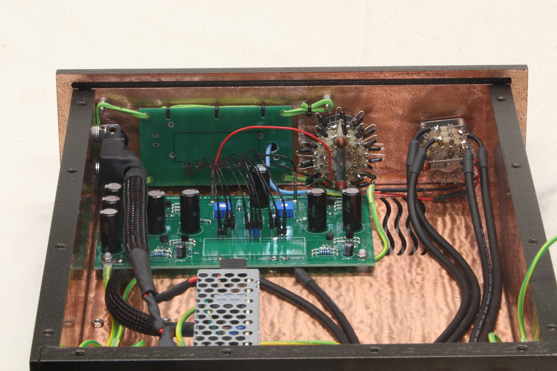

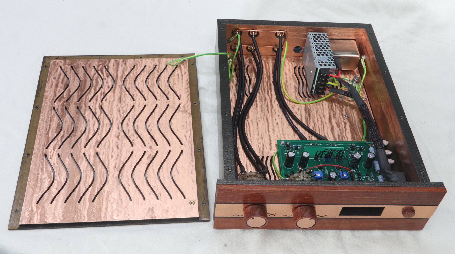

The preamp I made for my son has come back to have a Trigger input connected which was always part of the plan but didn’t get done at the time.

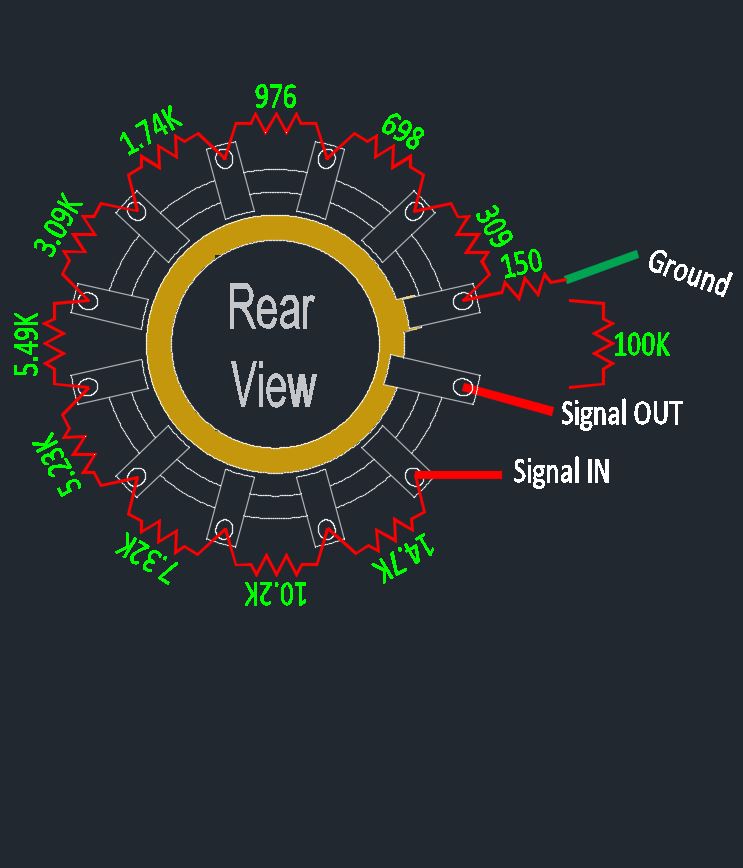

My son was also hoping I could reduce the overall noise floor. When nothing is playing there are a variety of noises that the preamp emits from, a hiss, a steady tone, high pitched ringing etc! The noises stay the same even when there is no source connected. The noise variety changes depending where the volume is set, with the lowest volume setting having the loudest noise. The stepped attenuator I have cobbled together used good quality resistors.
If anyone has any thoughts on how I might go about reducing the noise floor I would be very glad to hear about it.
Thanks, I will have a play with the grounding as you suggest.
The long wires were a design comprise to get the tube visible from the front, it would be very interesting to see how much difference that made. Maybe I can make anotherone to see.
Or I could buy another Korg, mount it on the PCB and just have the front one for show 🙂 So wasteful!

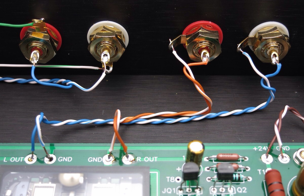

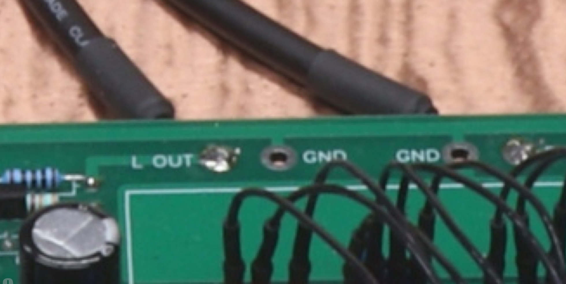

..If anyone has any thoughts on how I might go about reducing the noise floor I would be very glad to hear about it.
I see GND OUT L R are empty..the best quick way to correct all wiring check great Korg NuTube B1 guide
with lots of photos and construction details .Thanks to 6L6 🙂 Have a nice day

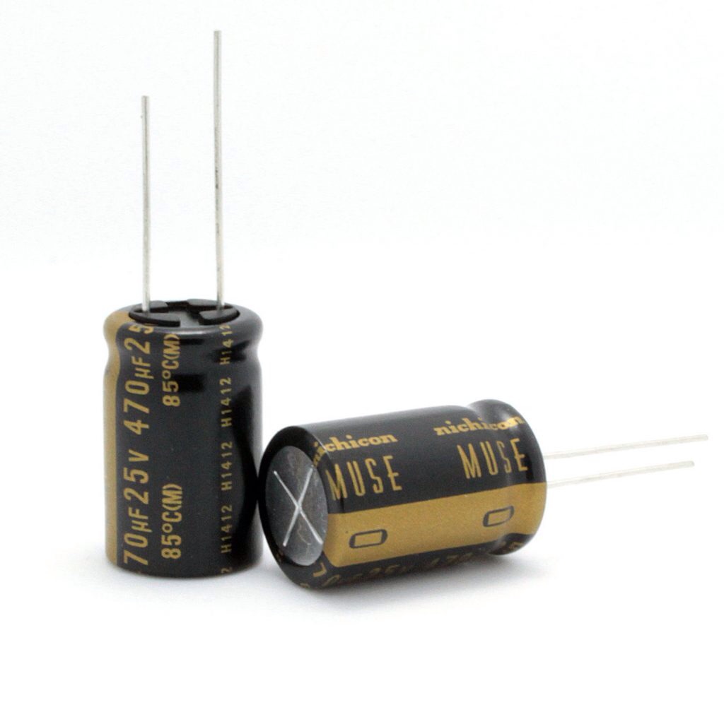

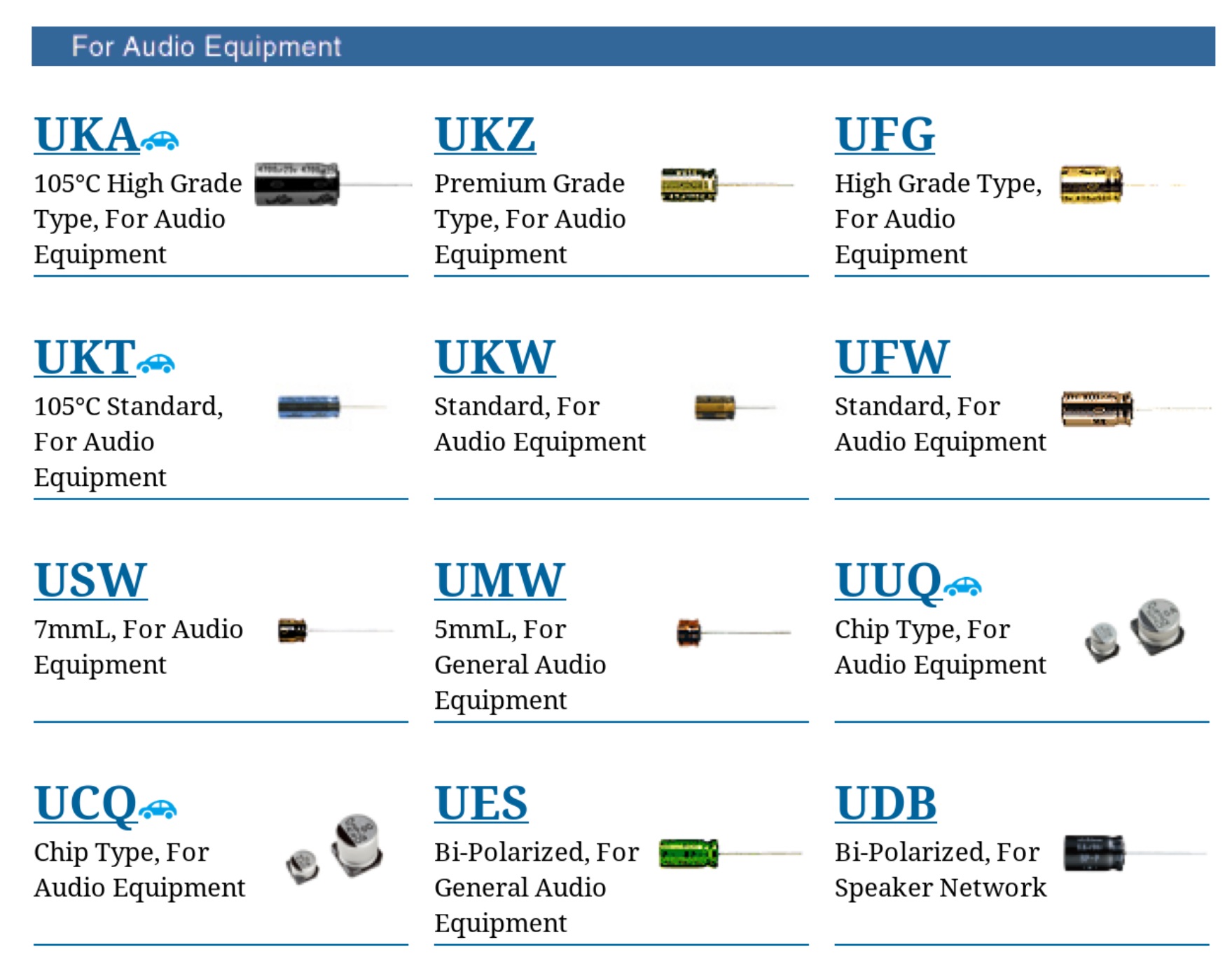

Could be an interesting upgrade at small cost change 10 uF caps for Elna Silmic II, Nichicon " Fine Gold " or a mixture of both.
Congratulations your chassis DIY work is beautiful, I like it this wood with cooper style very much :cheerful:
Edit: Nichikon KZ Muse are hi quality audio grade

The high pitched ringing is probably the resonant frequency of the nutube filament. You need to suppress the microphonics.
Yes, I too was confused about this for a while. I think the MUSE are the highest quality they make.
