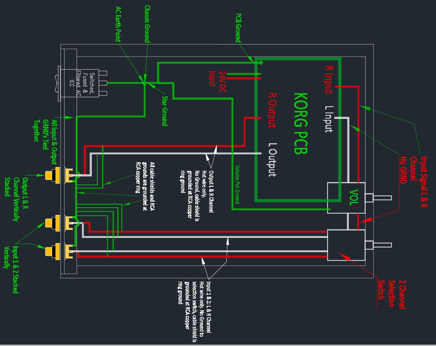

B1 with Korg Triode
..The noise variety changes depending where the volume is set, with the lowest volume setting having the loudest noise.
The stepped attenuator I have..
At the preamp RCA inputs we find audio signal from source DAC, CD player or audio card etc.
Input RCA center is "hot" (+) wire and another connection in the same RCA is " cold" (-) aka "audio path ground".
This audio GND wire are connected directly to the stepped attenuator ground connection point ,
nothing else , not psu ground yellow green wire.

Edit : Cooper colour inside the enclosure are metal foil or just painting ?
Get some metal shielding can quiet noise level
Thanks for all of the reply's.
The copper colour is actually thin copper sheet, that is all grounded to the star ground near the AC power entry.
I generally try and use a single star ground to keep things simple but I'll have to saty I spend my life confused about grounding no matter how much read!
I'm terrible with instruction so I'll do a drawing of how all of the grounds are connected to show the actual setup.
Ok this is how it's wired, simple right 🙂
All thoughts welcome

@ DQ828
Can you compare noise with other 24V psu?
B1 Korg kit chosen the verified special quiet model.
Try experimenting if so wires who are connected to power on-off switch
can be more distanced from Nutube wires..

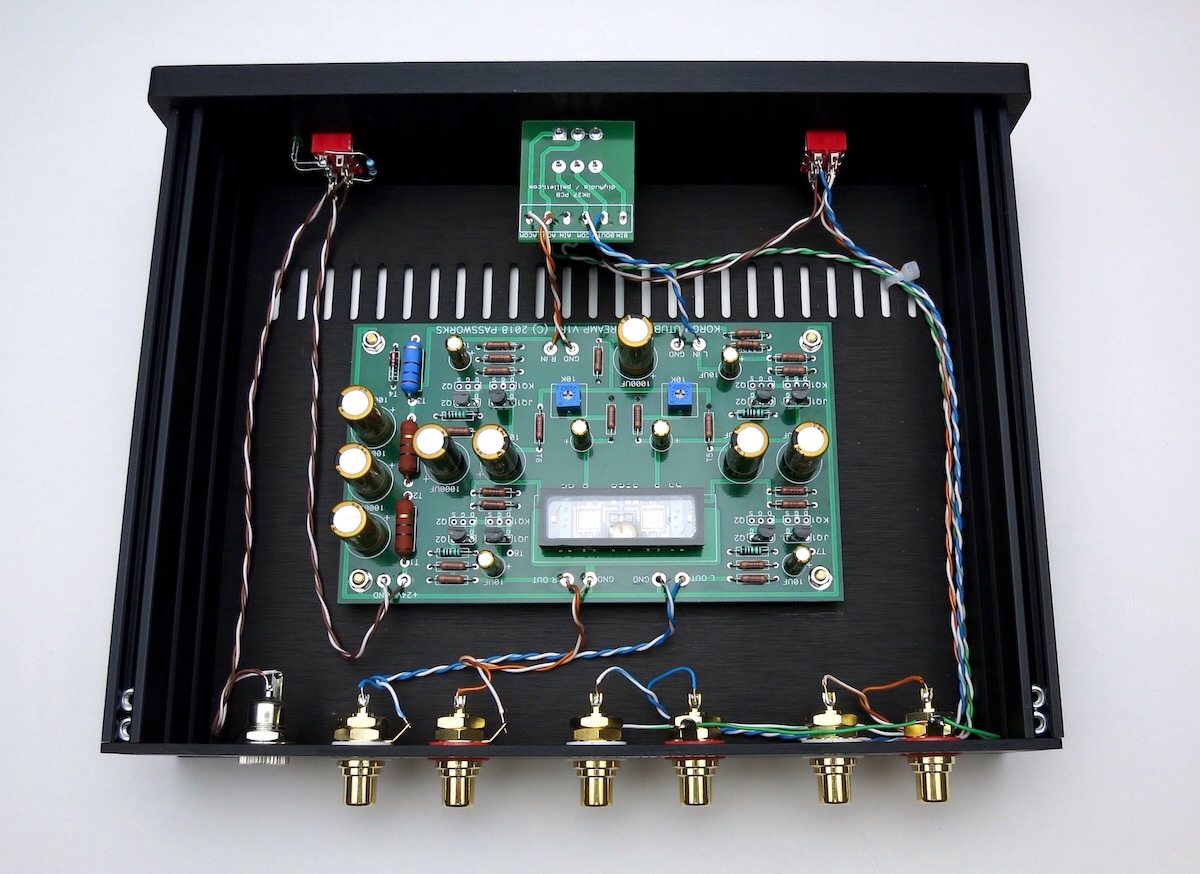

Air Gap
Please follow 6L6’s B1 Korg Nutube build guide to create an air gap between the Nutube and the PCB.
B1 with Korg Nutube - diyAudio Guides
In my original build, I used the foamed double-sided tape that came with the Korg Nutube. Not sure if this contributed to the microphony, but it sure did ring whenever I turned on the preamp or switched sources.
When I replaced the Nutube with a new one (original was damaged by a lightning strike near my home), I followed 6L6’s build guide and I haven’t had any problems with microphony.
I used the included foam between the NuTube and circuit board and my preamp is absolutely dead quiet. I think there is a huge variation between tubes and it just boils down to the luck of the draw.
.. I will have a play on the weekend.
Power supply inside the chassis can bring transformer mechanical micro vibrations,
pollution with his magnetic field and some heat too.
The kit version external SMPS power supply is a better solution to avoid unwanted noise.
Maybe try how your psu perform outside of the enclosure.
Less noisy ?
Close all air ventilation holes with more copper sheet around.
🙂 Kind regards
