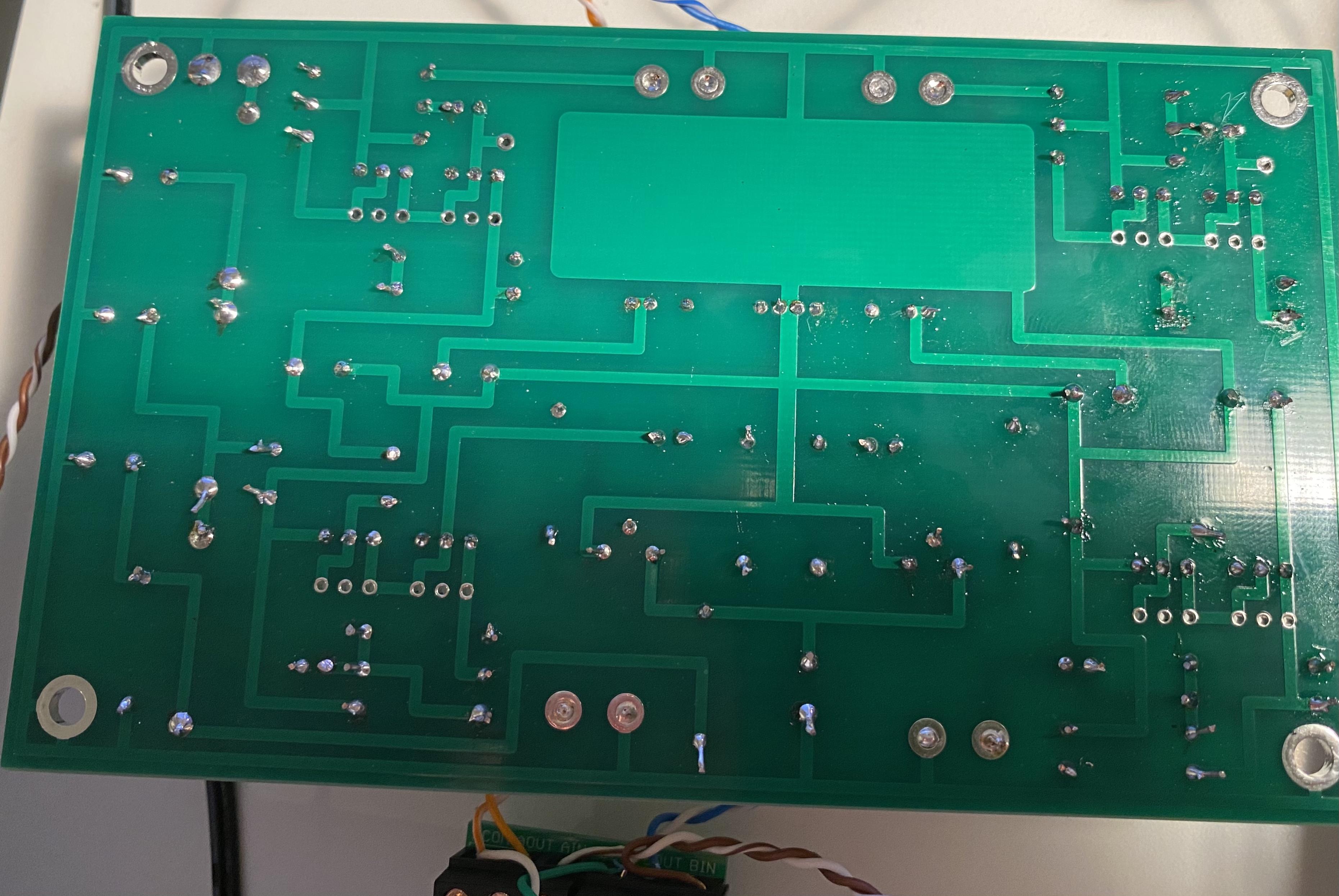

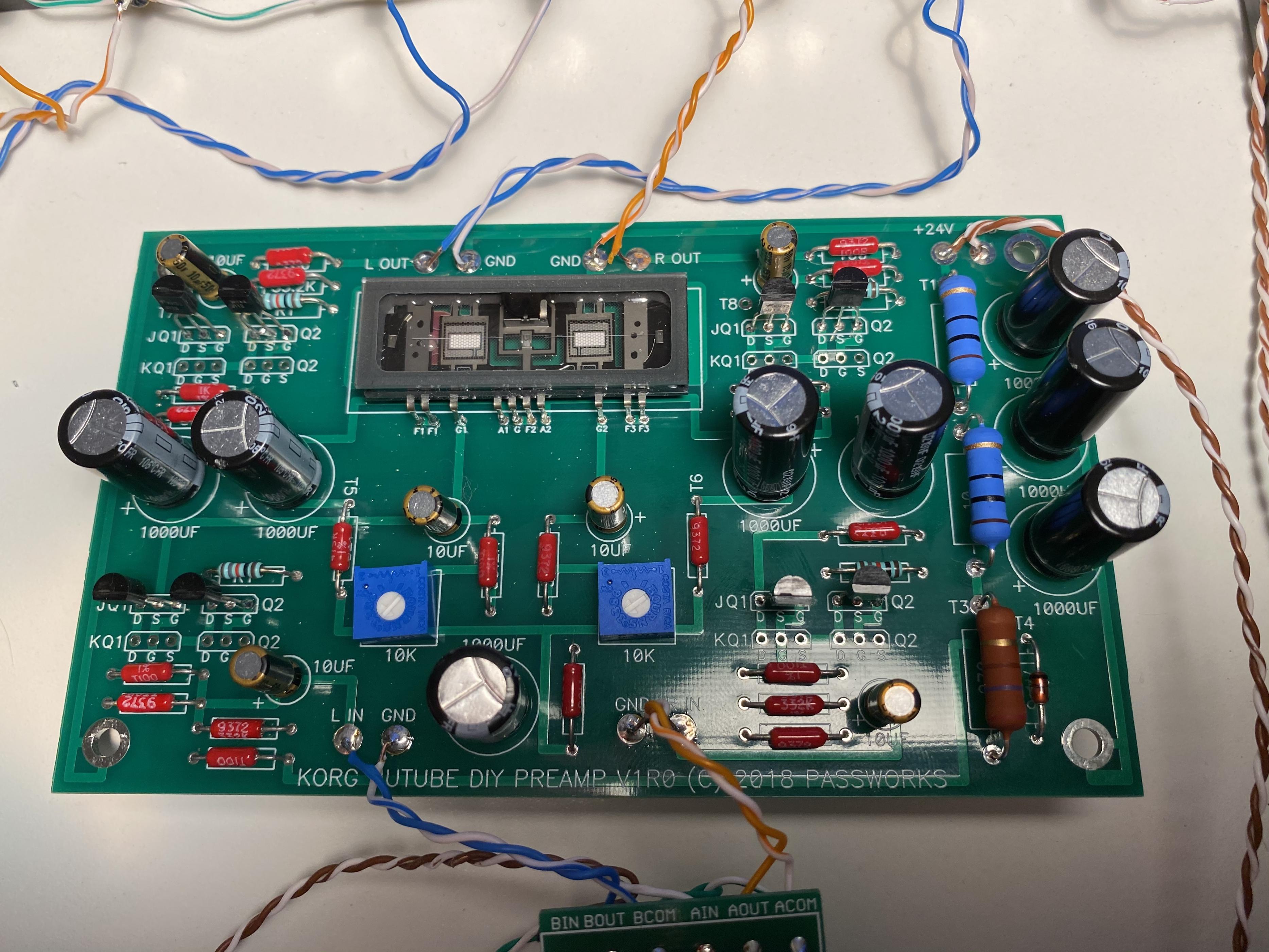

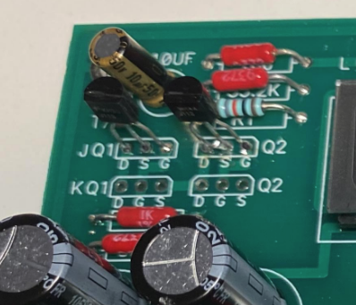

Finally sat down to build this preamp, from complete set.
One channel only lights up, no voltage at T7.
Trying to measure many places, but cant seem to see where it stops. Q1 and 2 near T7 has no power what so ever, power at other Q1 and 2.
Any pointers appreciated!

Check continuity test on all Nutube pins,
probably some soldering joints need to be reflow gently from both sides 🙂
Reflowed everything from top and bottom, still nothing.
What continuity am i looking for on the pins?

Continuity fine at those points.

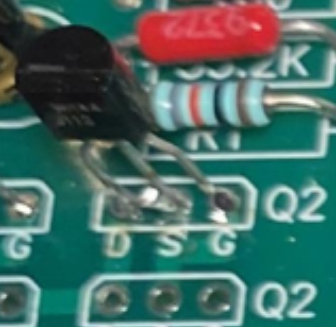

Suspecting the jfets near t7.
There is no voltage at any of the feet.

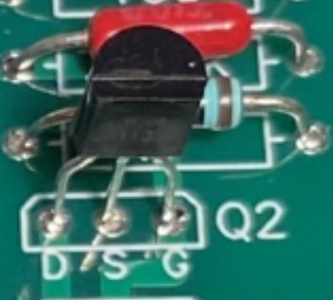

No short, just excess solder. Did a little cleanup. It was like the other Q2 before i started solder from top.
No, i meant there is no short. Just looks like it from my shoddy top solder.
There is no power on any of the jfet feet here, or any side of the resistors, or the 10 uf cap.
There is power on the + side of the 1000 uf caps.
Where does it stop😱
Where does it stop😱
Can be around 1000uF caoacitor some cold joints..check all connection both sides ?
Make continuity tests of all components soldering joints together with pcb tracks if doubts..
🙂 Anyways always useful tests

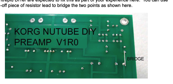

If i do a continuity test from q1 D to q2 G, i get some beeps at the working channel, other channel is silent.
EDIT: HAHAHA. found it.
I have the V1R0 board 😉
