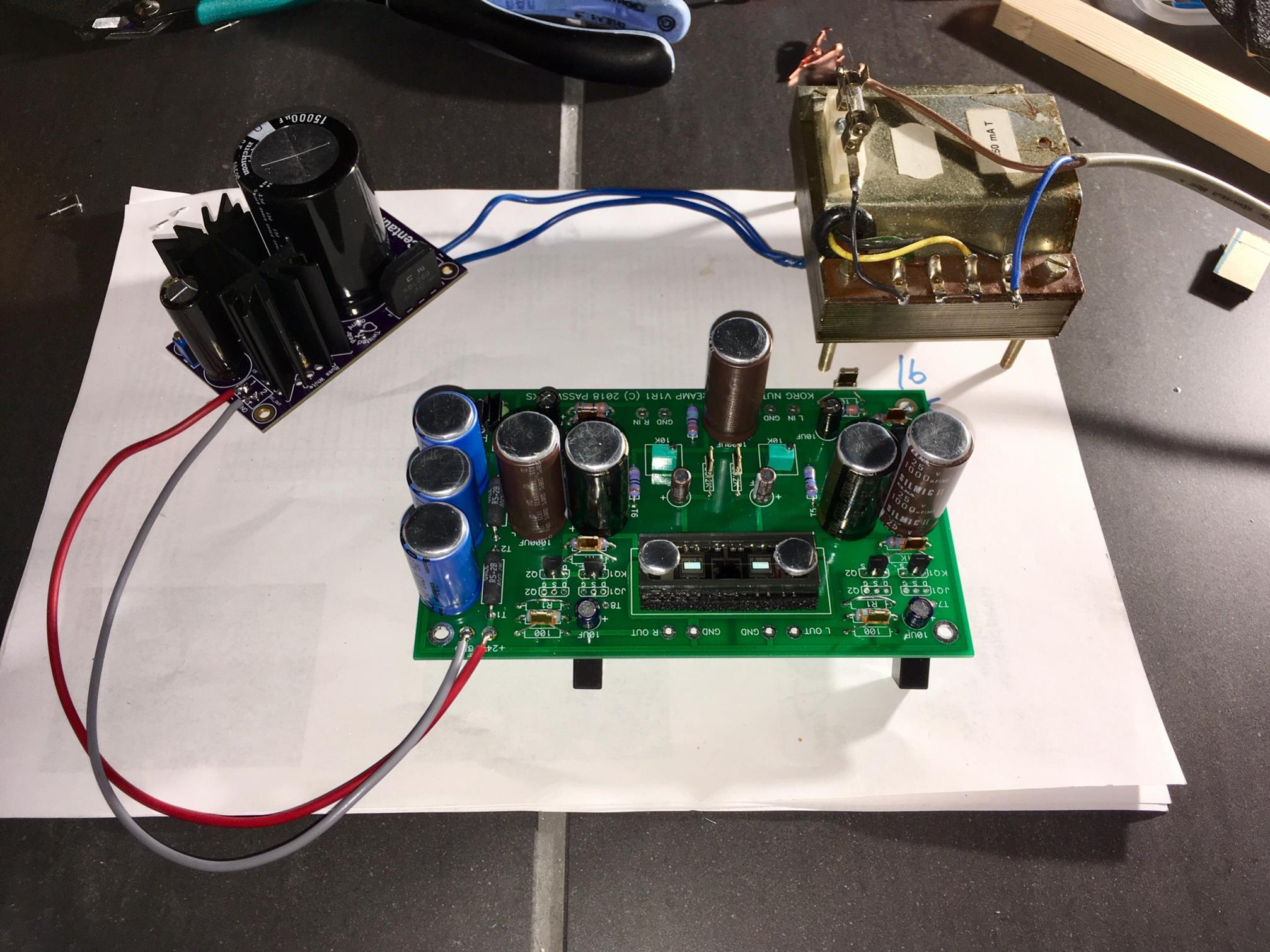

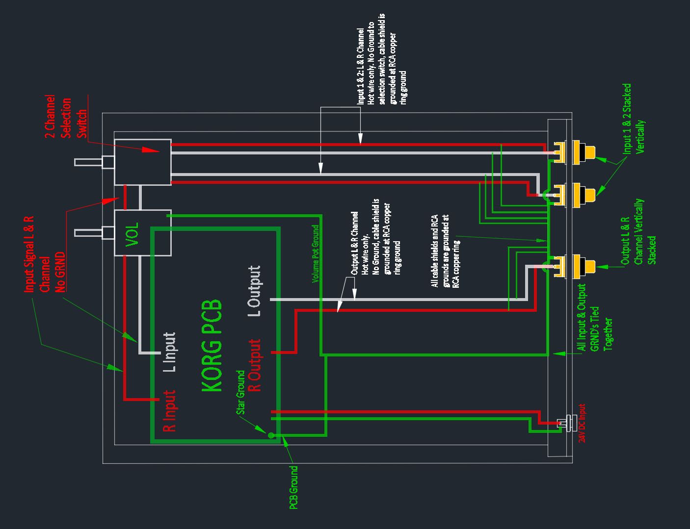

B1 with Korg Triode
The plan is to take the PSU out and feed it from the power amp with a seperate supply.
I will rewire the ground like the images, for the moment I'm going to leave the Korg where it is and see how things go.

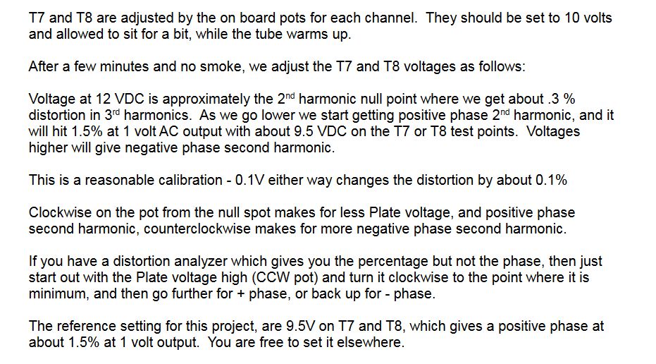

Hi, start up the Nutube today. The value I got was.
T1 - 23.99 V
T3 - 22.33 V
T4 - 9.15 V
T5 / T6 - 0.668 / 0.684 V
T7 / T8 - 15.2 / 15.3 V
Adjusted T7 / T8 to 12.0 V.
Looks ok to me, hook up and test it ( :

12v is the null point right? Pass also say that the pos/neg 2 harmonic is a psycho-acoustic trick that not everyone can hear or like. Or am I wrong?
I will play with the voltage for sure.

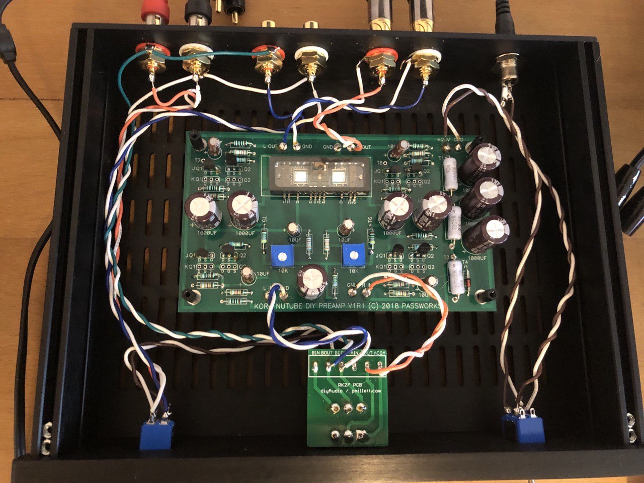

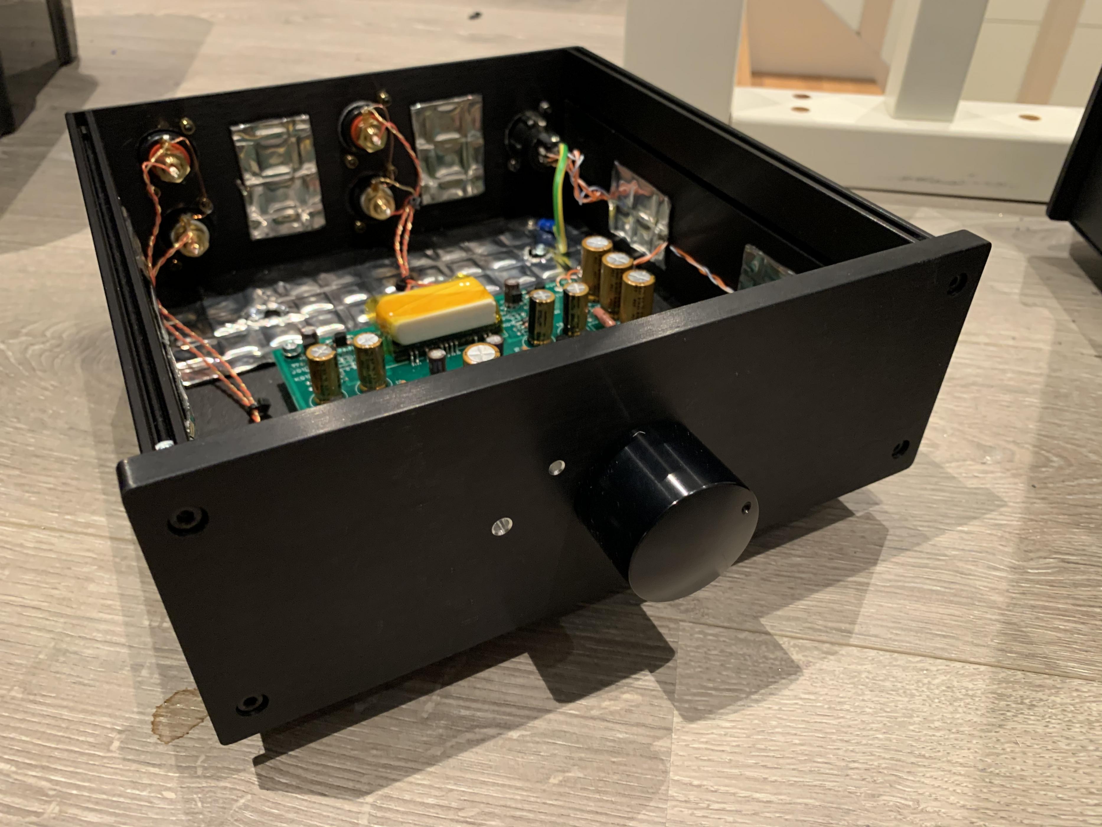

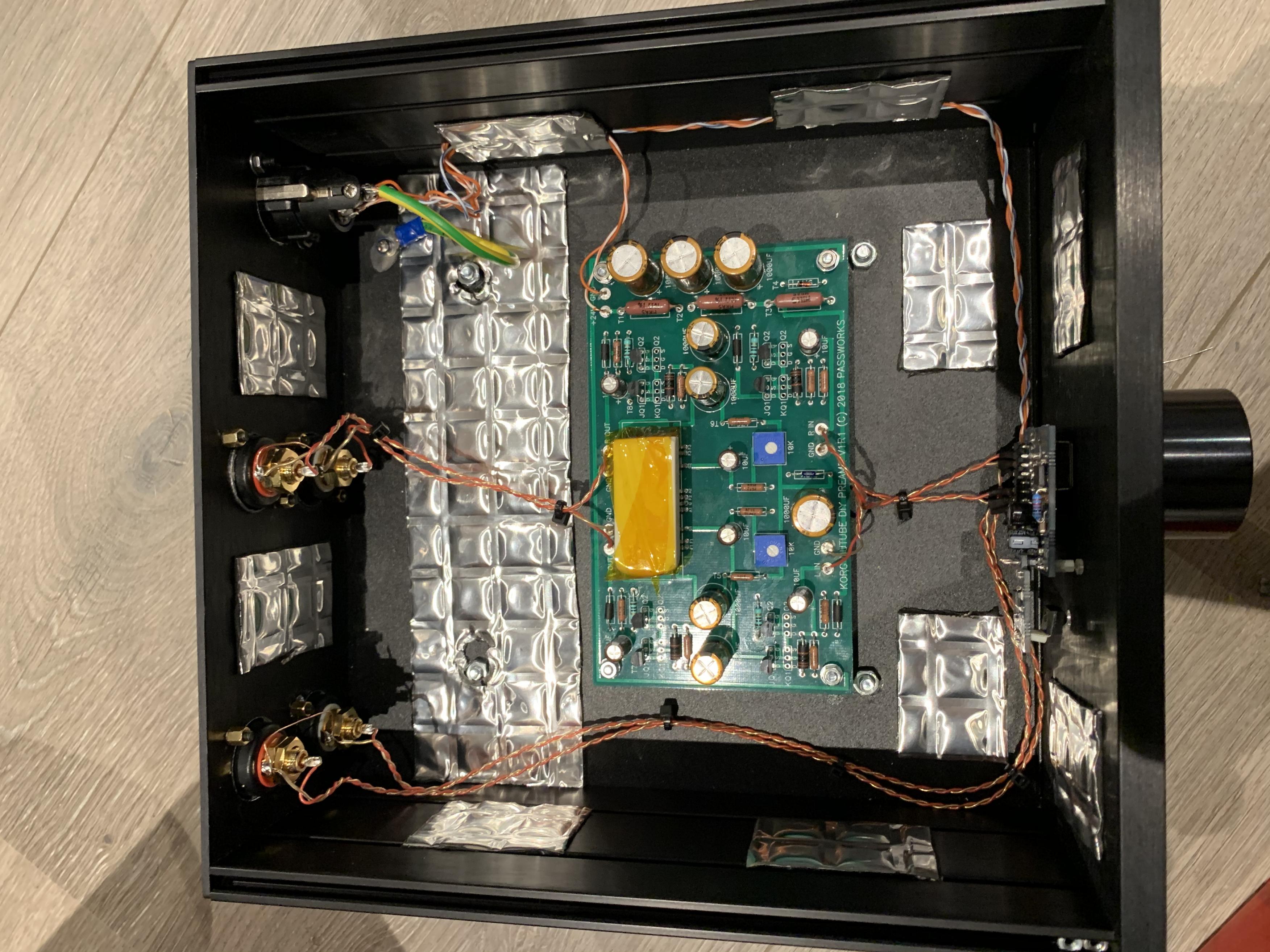

Her is my Korg b1
It sounds god with my new f5 turbo 😉
- Academy audio vcu volum pot
- Elena slimic 2 10uf bypassed On the underside with Cornell Dubilier Polypropylene caps.
- Amtrans signal wire
- neutrik connectors
- separate psu case whit amb sigma 11
- modulshop case
Her is my Korg b1
- modulshop case
High quality build , some great components inside too 😉
Bypassing Elna Silmic II with polypro that is the best imho.
This B1K preamp is one excellent compagnion for F5 Turbo.
Congratulations :xmasman::xmastree:

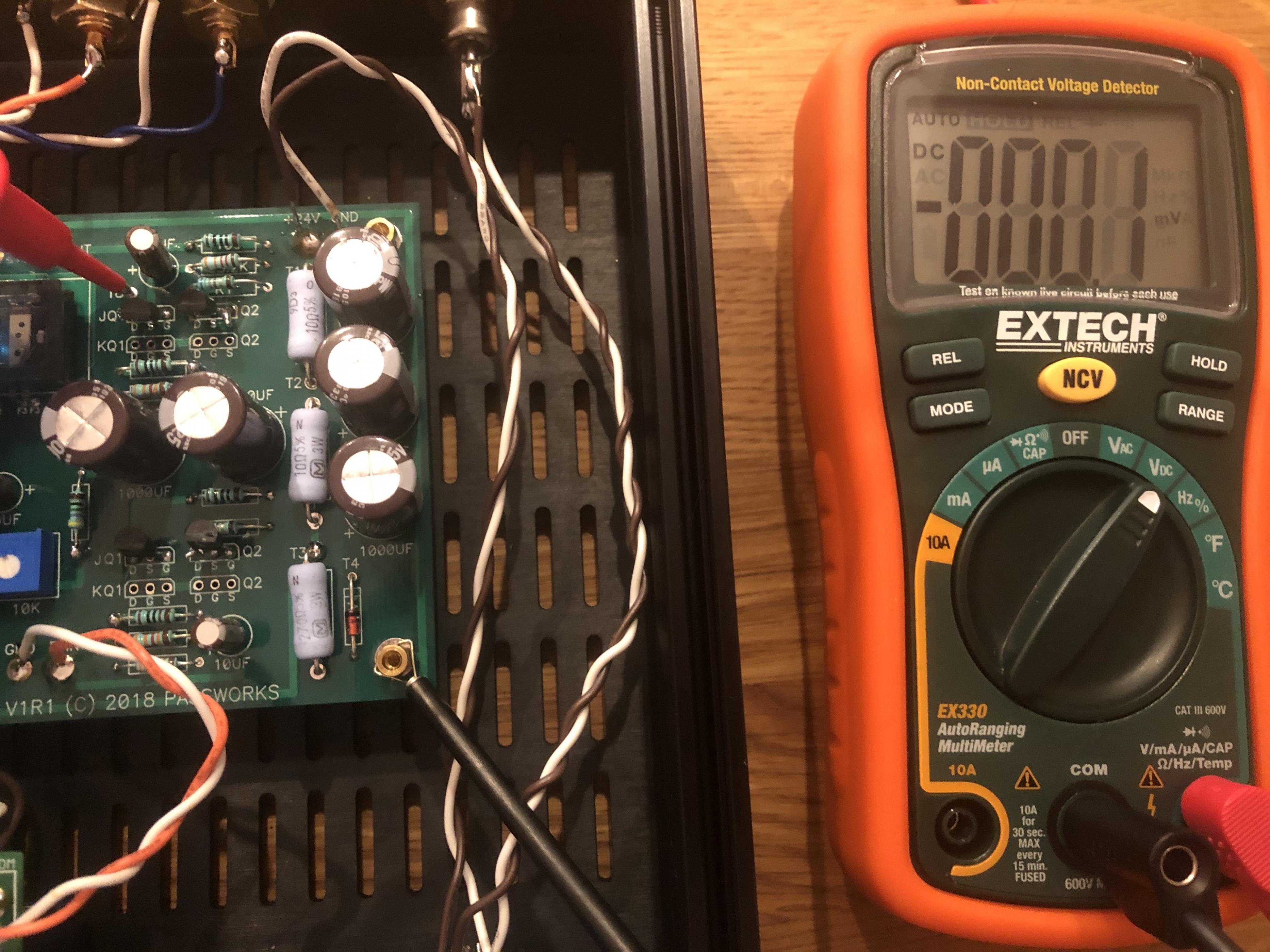

Hi, this is my first post in the forum.

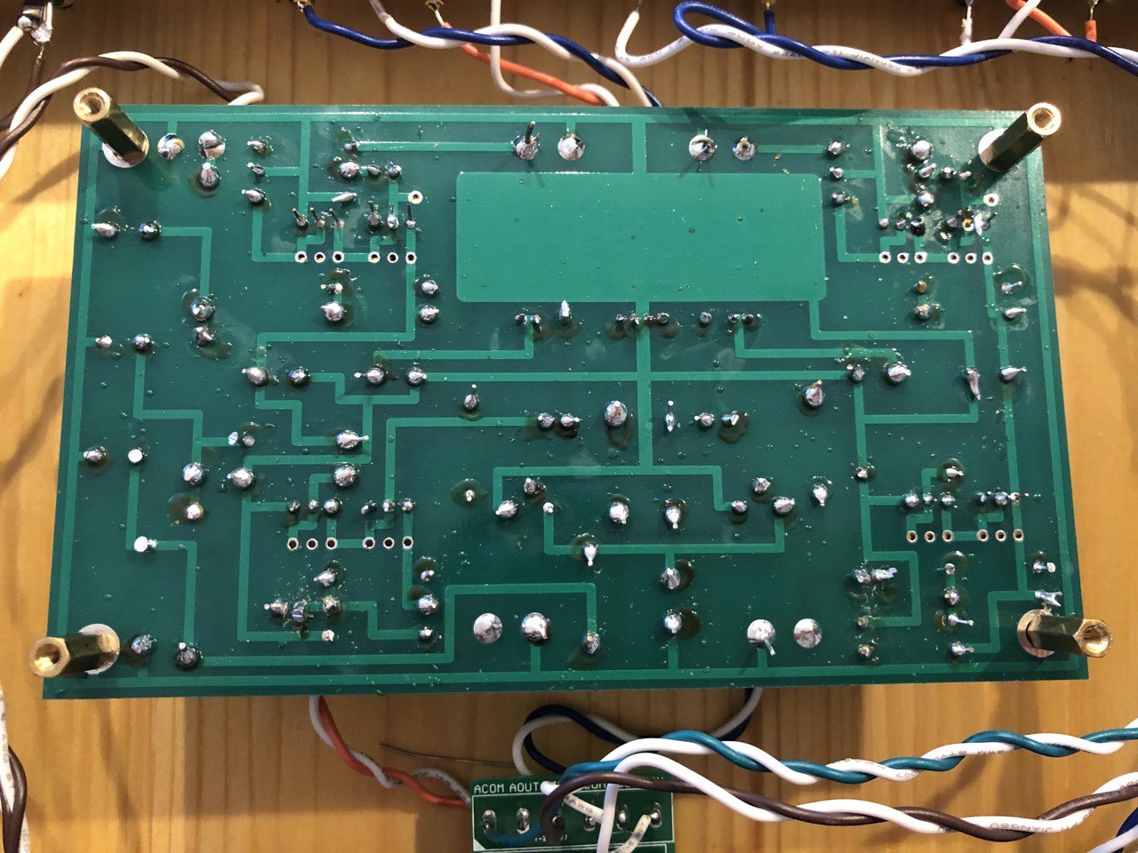

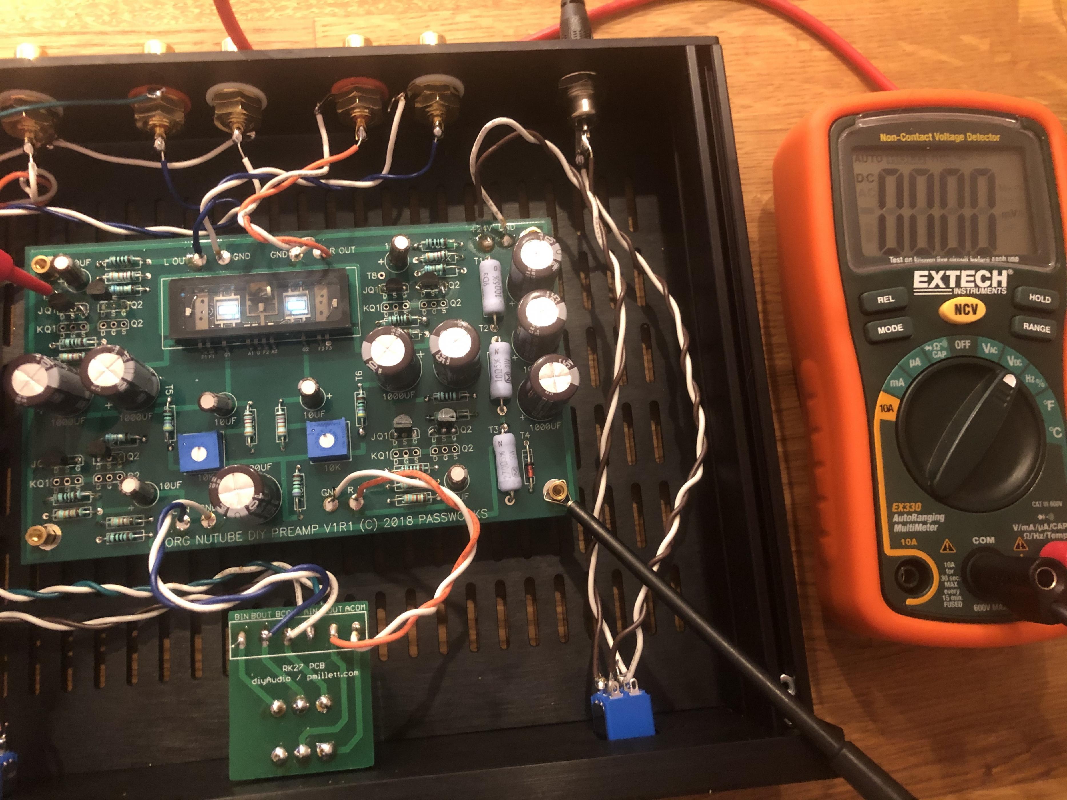

I built the Korg B1 Nutube preamp. I connected everything and I have no sound/no output.
My measurements are:
T1: around 24V
T4: around 9.5V
T5 and T6 are at about 0.6 VDC.
The values from T7 and T8 are not right.
T7 changes from 000,1mV to 000,0mV and back again.
T8 is at 000,1mV constant.
The Nutube lights up blue. Both sides.
I dont know but, can it be that there is a warm up time for the Nutube thats longer than 30 minutes? And then T7 and T8 will show a normal VDC? I had it running 30 minutes and still no sound/no output but didn't meassured T7 and T8 then.
I testet it with two Amp Camp Amp Mono first, then with one ACA, and then with my active Computer Speakers. No Sound.
I attached Pictures for T7 and T8 and front and back side of the PCB, maybe its the soldering.
I hope you can help me. Thank you.
